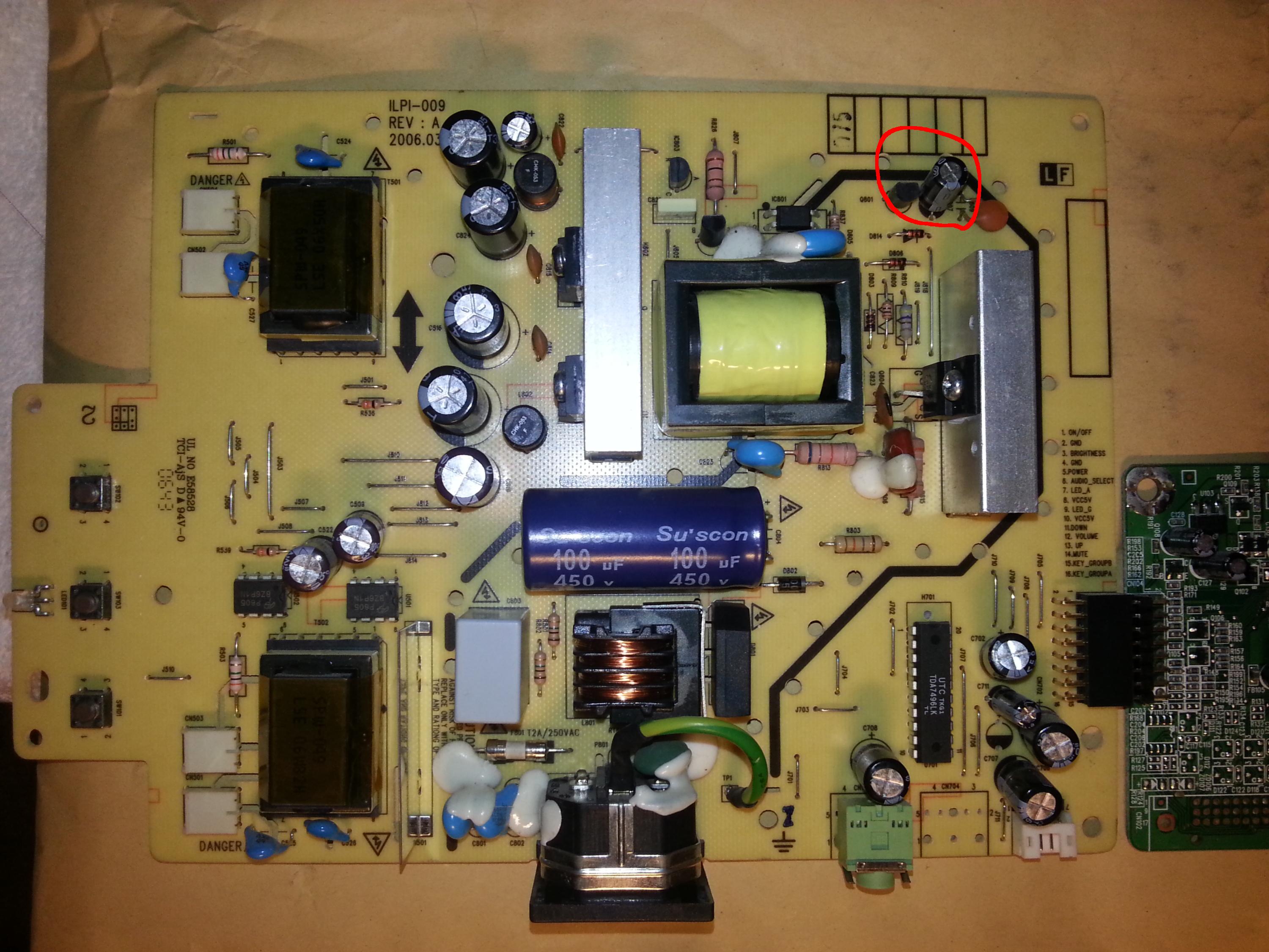

    Whilst i continue my search for main board for another monitor i own i thought I'd try another monitor i have sitting on my shelf.
    It's a Cibox 1922C with no signs of life. LED doesn't light, no flicker from the back light.
    I've removed and tested several components, fuse, bridge rectifier, mosfet to the right , big cap and the 3 to the left of the heat sink.
    If someone could give me some pointers and advice as to what to check next that would be greatly appreciated.
    thanks

    OK, start by running the power supply-inverter board combo by itself, no connection to the logic/scaler board. Read the Basic LCD monitor troubleshooting guide.
    Measure the DC voltage right AT THE TWO LEGS OF THE MAIN 450VDC filter cap and report the reading.

        That is Ok can you test the voltages on the connector to the main . There wont be many perhaps just on the 5v pins so meter on 20vdc use a ground screw or ground pin on the connector.

          On that black conn. on the 1st image, measure pins 1, 5, 8, 10 to the GND.
          note: do it with logical board connected

              There are a couple that say VCC5V but they are both fluctuating between 2.5v and 2.7v.

                I would test those DC voltages on the black connector without having the main board attached since the main board can have shorted circuit that caused the power board to be in shut down mode. Since voltage is fluctuating, I would suspect bad start up cap. Try heating it with hair dryer or replace it.

                  Re: Cibox LW1922C dead, no power
                  Nothing showing on 1 and 5 fluctuating between 2.5 and 2.7v on 8 and 10.
                  The buttons are for power and making selections in the menu.
                    1 and 5 and other voltages will not be correct until the 5V is corrected first.

                      Cheers for the help, i shall purchase some caps tomorrow and replace and let you know how i get on.

                        Any caps will not do the job you need to buy low esr ones for this application.
                        We usually recommend Panasonic FR FM or FC remember to check you have room as they come in different sizes - sometimes for the same value.

                          I've removed the Su'scon cap. it's 47uF 25v, tested on my ESR it gives a reading of 47.84uF and and ESR of 0.84 ohms but his doesn't seem too high ?

                            I replaced the cap with a KY low esr, with a value of 0.4 ohms and the 5v has come up to near 3v now instead of the 2.5 to 2.7v although it still fluctuates but only by about 1v

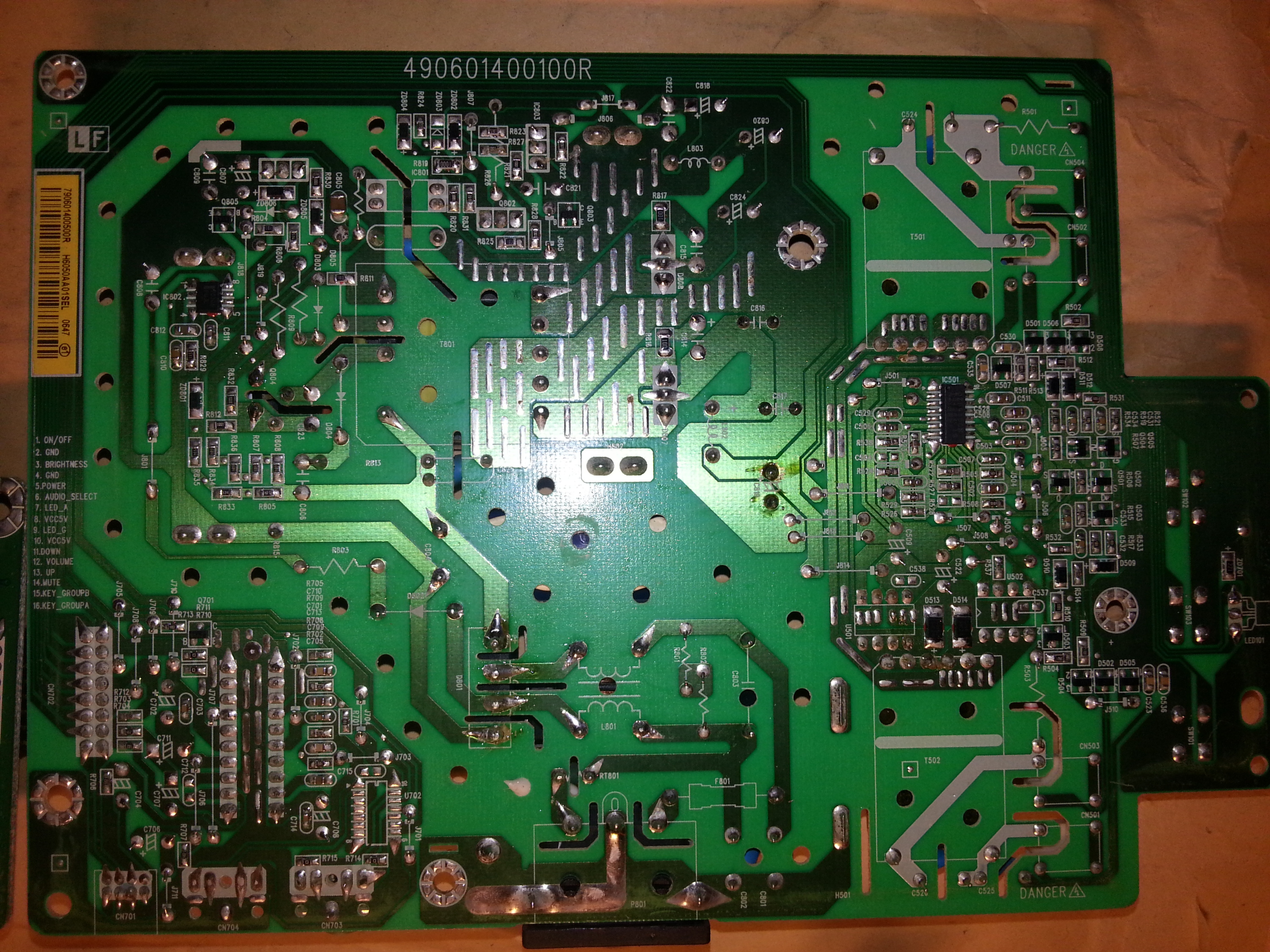

                            I have noticed on the other side of the board an 8 pin chip marked 203D6. It's referenced in another post and leads to this data sheet, some sort of power supply ?
                            https://cdn.badcaps-static.com/pdfs/...93618ef001.pdf
                            Is it possible this is at fault ?

                              Possibly but I dont know how to test - Budm will. If he doesnt come onto the
                              thread I will try and look it up tomorrow.
                              Is that 3v with the main board and lights connected? have you tried with
                              just the power supply board. Also just to check you are testing on pins 10 and 4 or 10 and a ground screw?
