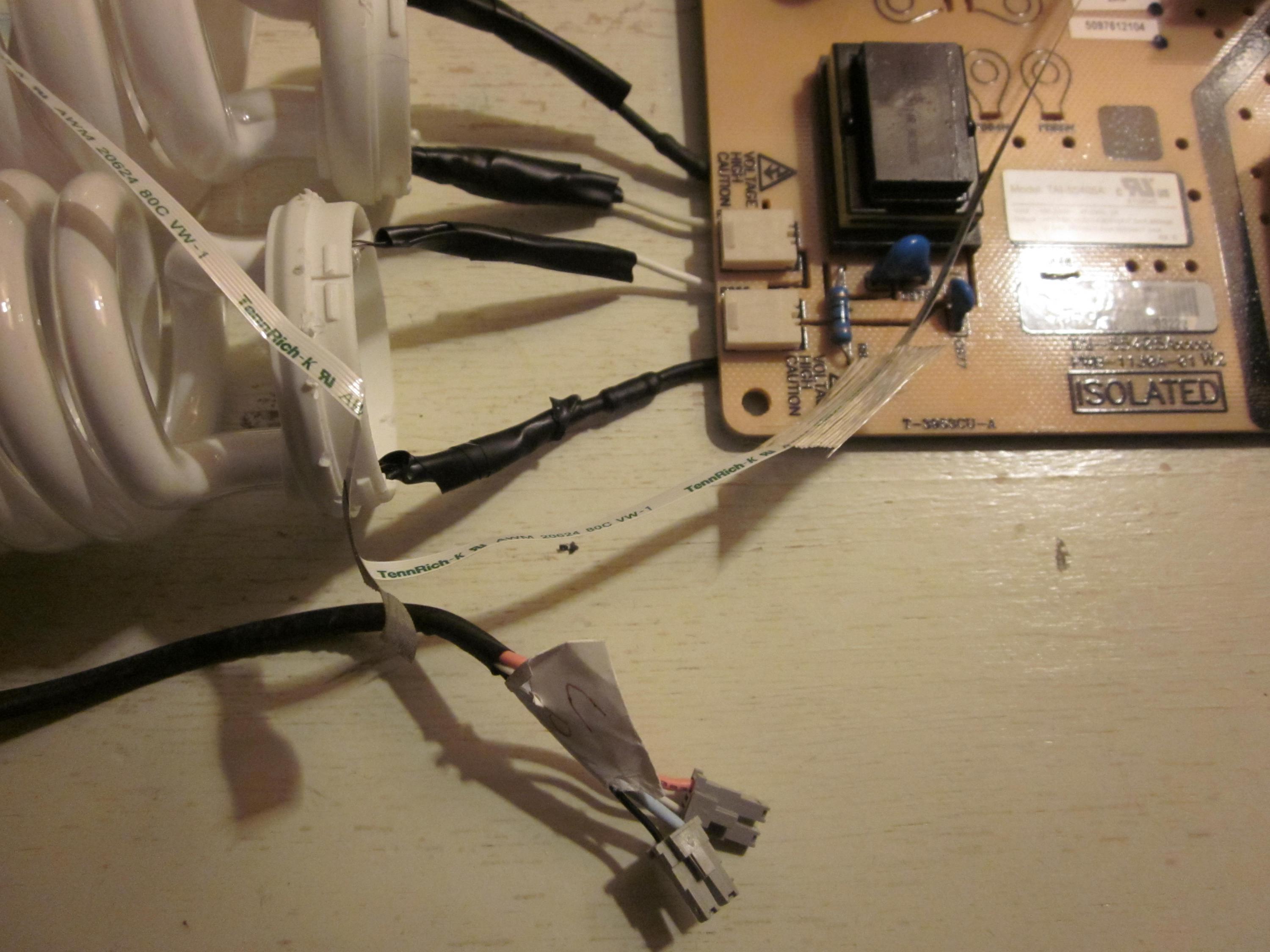

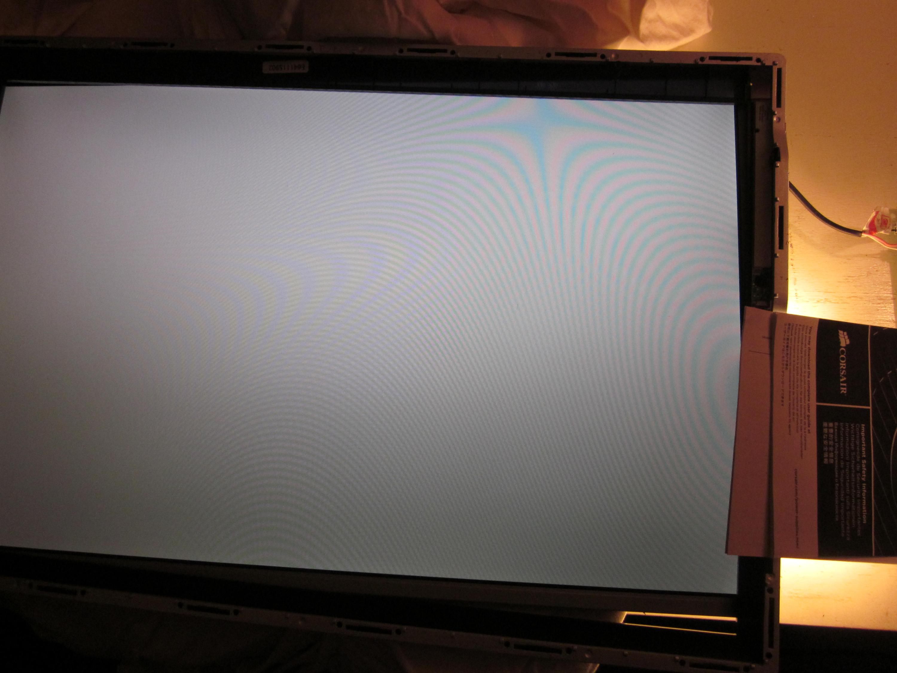

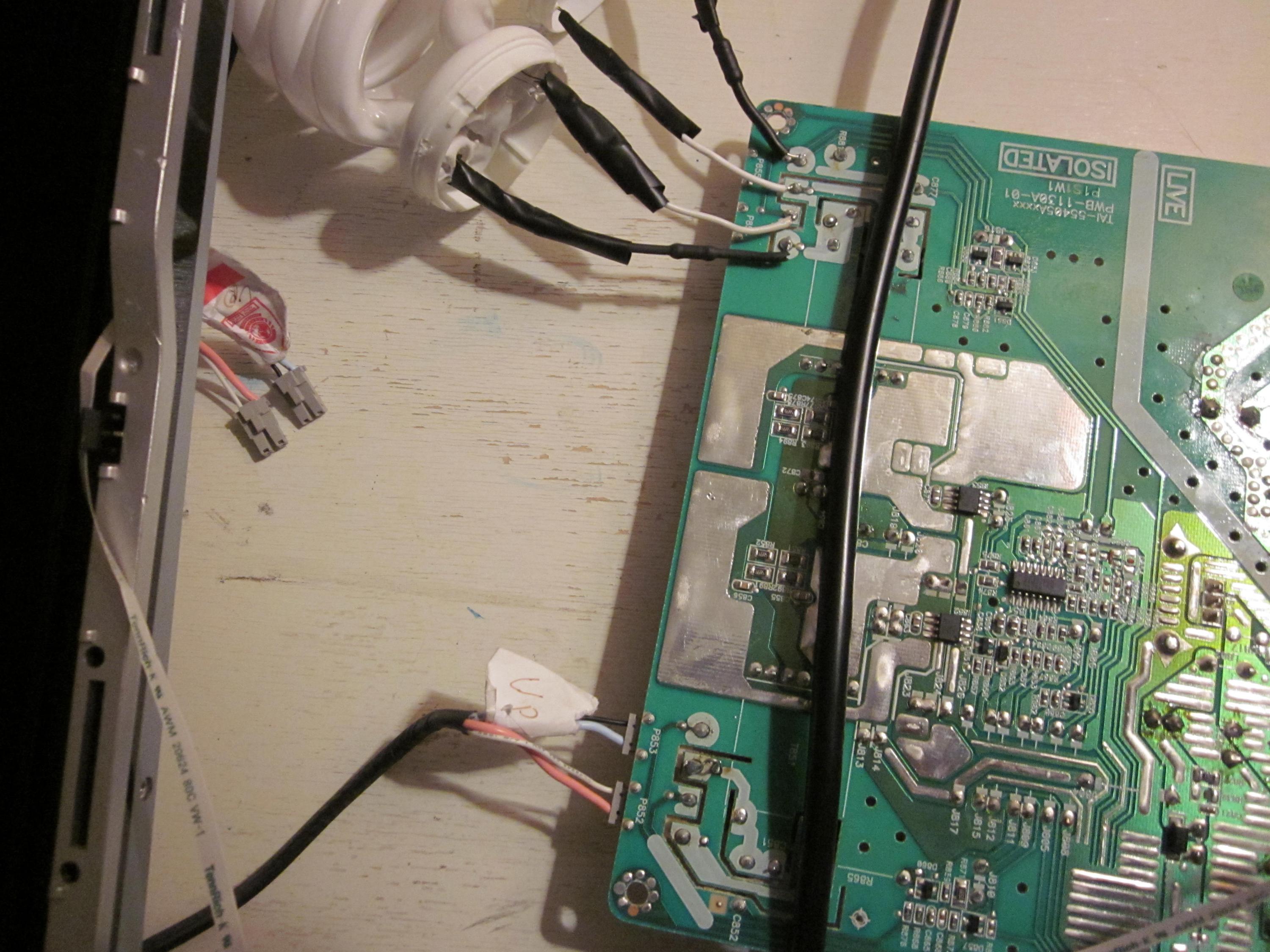

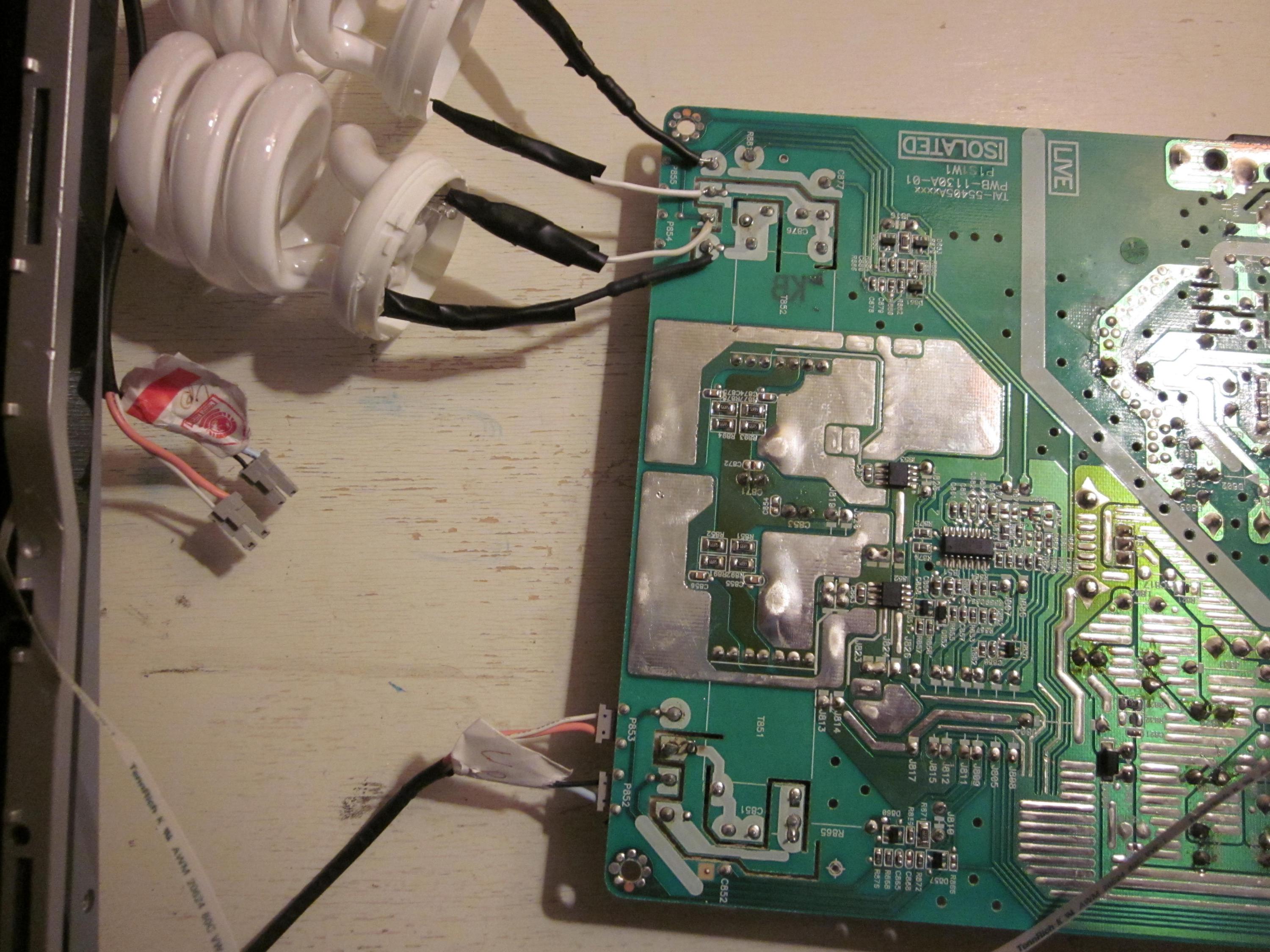

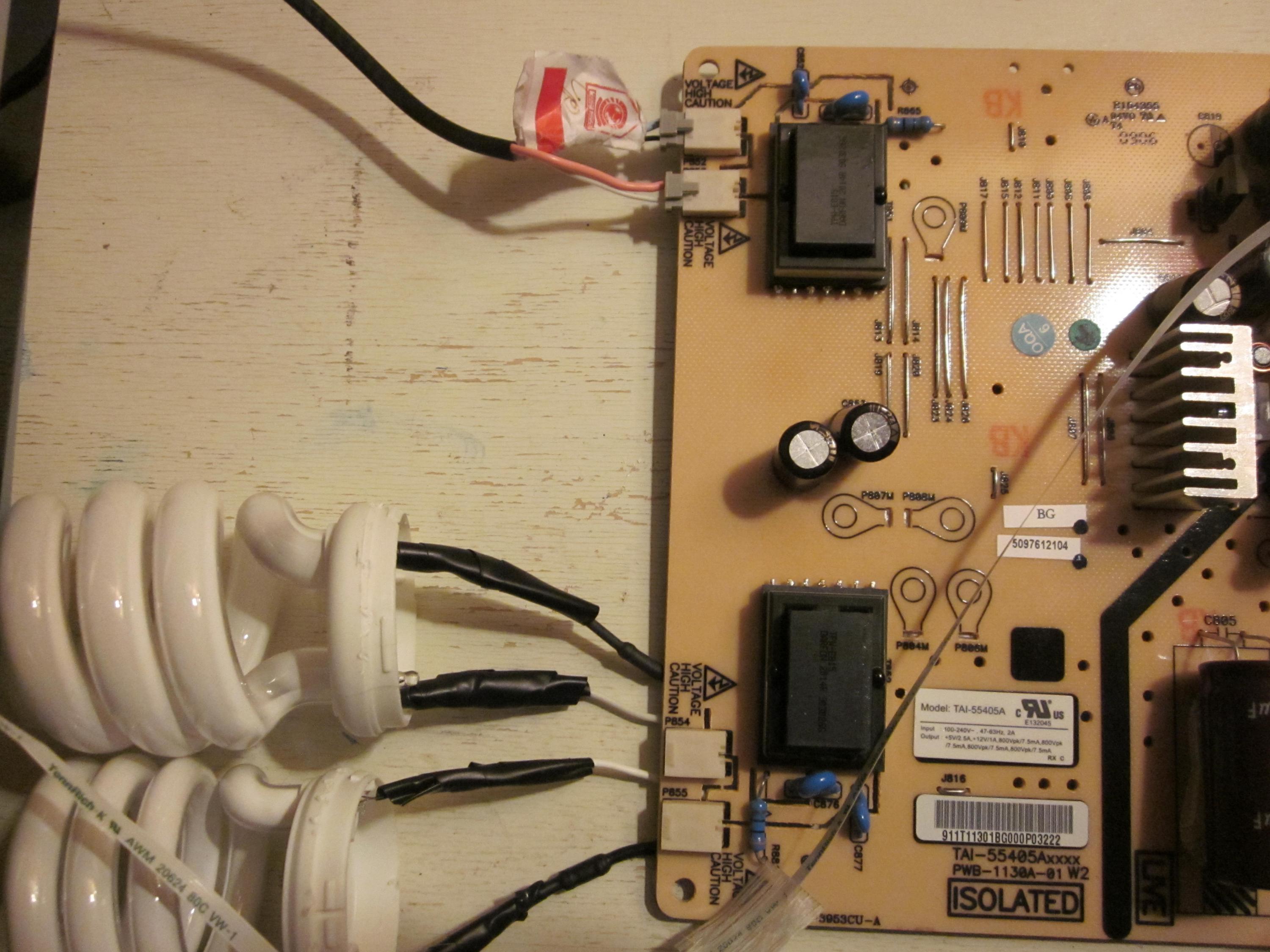

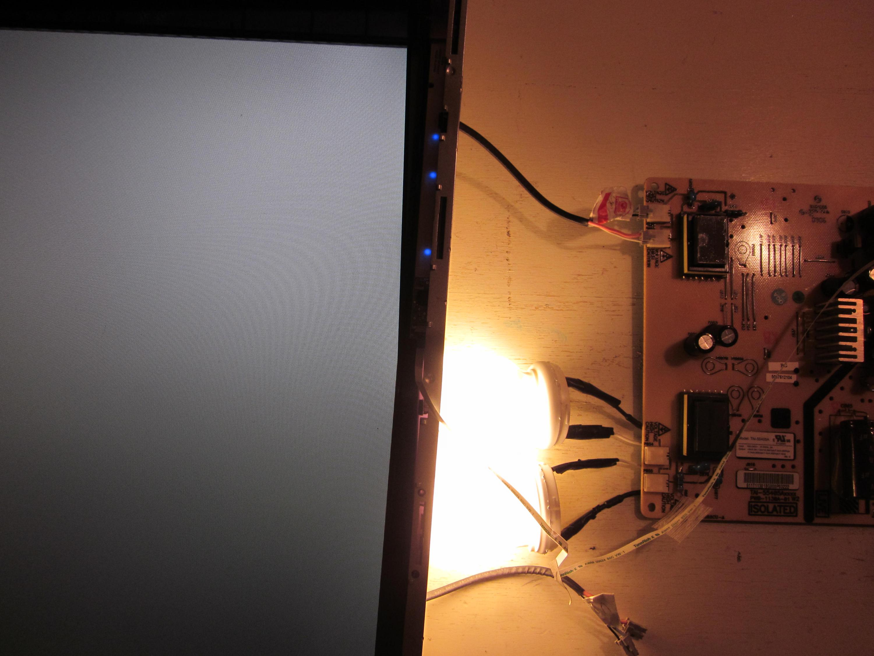

                                    SO..... DID I FIGURE IT OUT BECAUSE OF YOUR HELP!?
                                    Im so excited! Here's the update and the pictures... please tell me the one thats not turning on is a failed lamp...
                                    Soldered 2 test bulbs, connected the monitor lamp to the other side, and it worked. Flipped the board (instead of moving the test bulbs to the other 2 connectors) connected monitor lamp, it failed.
                                    What's the verdict?
                                      #38
                                      Re: Gateway HD 2201 Monitor 2 Seconds to Black
                                      You did it right, that is how I test with a pair of lamps. So which set of lamp is bad, the top set or the bottom set? Did you leave them on long enough like 2 minutes to make sure they stay on?
