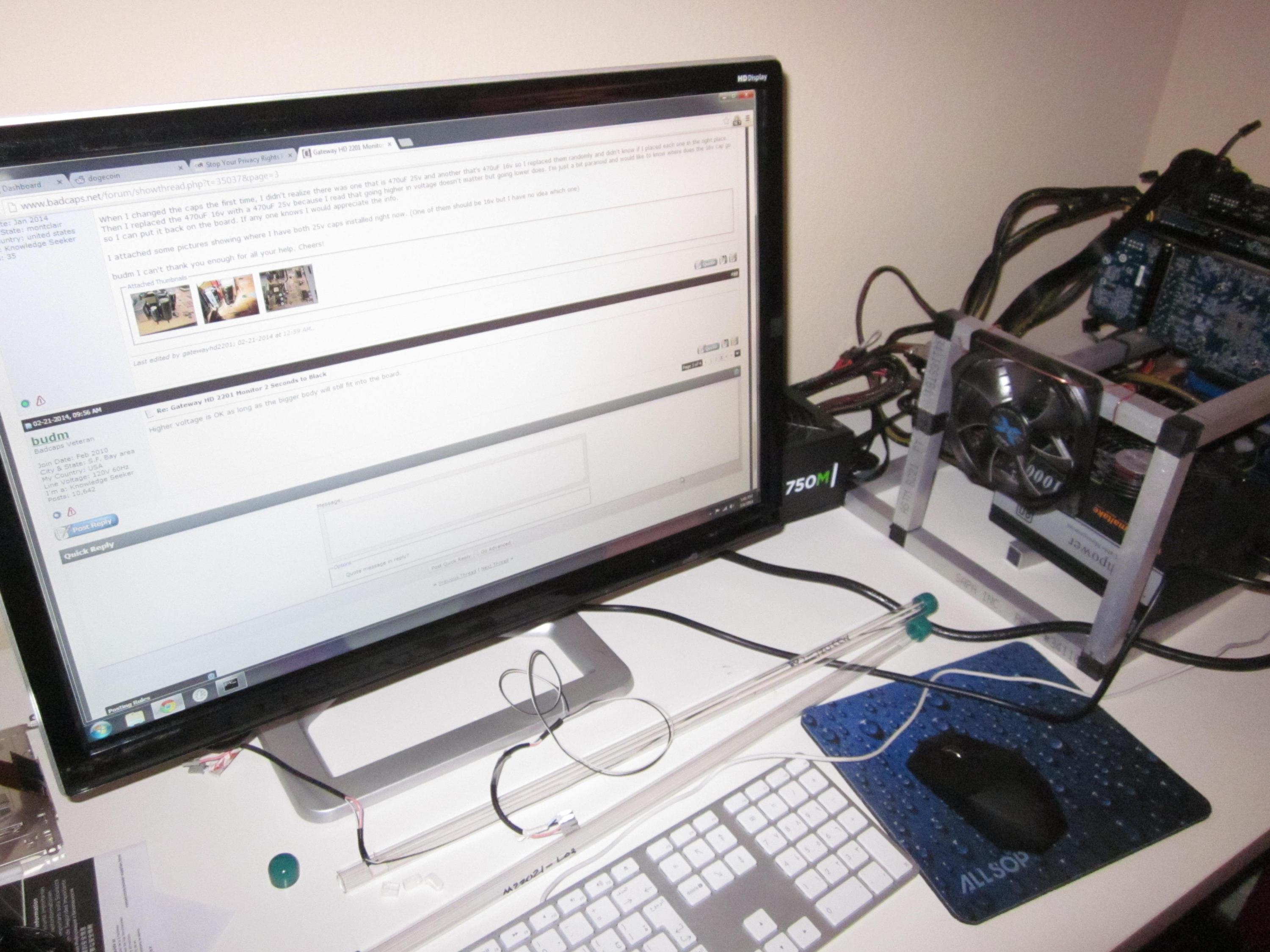

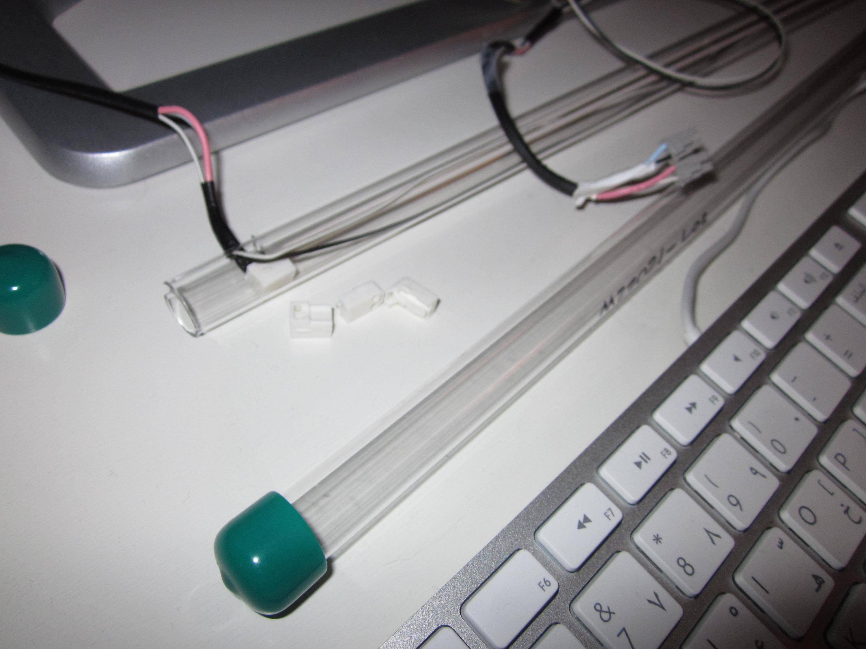

    I got a reply from CCFL warehouse saying that they are not 100% sure if L03 would fit L06 model, it might fit but sometimes there would be a very small difference and it won't work. They said they have the CCFL tubes that match my model but did not provide a link so Im waiting for a reply now.
    If the price difference is worth the work of removing the wires from the old lamps and soldering to the new ones, I might go with the tubes only. If the price is close to the assembly, I think I will take a chance and order the assembly.
      #62
      Re: Gateway HD 2201 Monitor 2 Seconds to Black
      Higher voltage is OK as long as the bigger body will still fit into the board.
      Here's the result of all your help.... thank you all who replied
      I had to switch the rubber legs that came with the kit I ordered with the original ones that came with the screen as the new ones are bigger and the screen would not fit if I kept them, but in the end I managed to make it work...
      Cheers all
        #63
        Great, replacing the lamp is very delicate works since it is so easy to break them, but you did it which great for someone that never done it before. 62 posts but we got it done!
