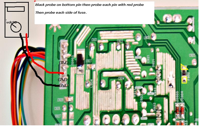

    As post 23 with picture

        Tested as directed 0 volts on each pin and 0 both sides of fuse with meter set on 200 dcv

          Ok - meter should be on 20vdc not 200vdc - you did have it plugged in to the mains ?

            With meter on 20vdc plugged in power socket just with black probe on ground
            I get a fluctuated reading of -0.00 thru -.001
            While checking all pins with black on ground 1thru 8 is -0.00
            fuse -0.00 both sides
            On my meter minus is flashing with no power is this normal
            I test a 12v battery and show 12v so I assume my multi meter is working
            also tested my battery in my millimeter is ok.

              ok back to the start. power board only plugged into mains.
              meter on vdc600 very carefully test across the BIG cap.
              You have replaced the .39 resistor?

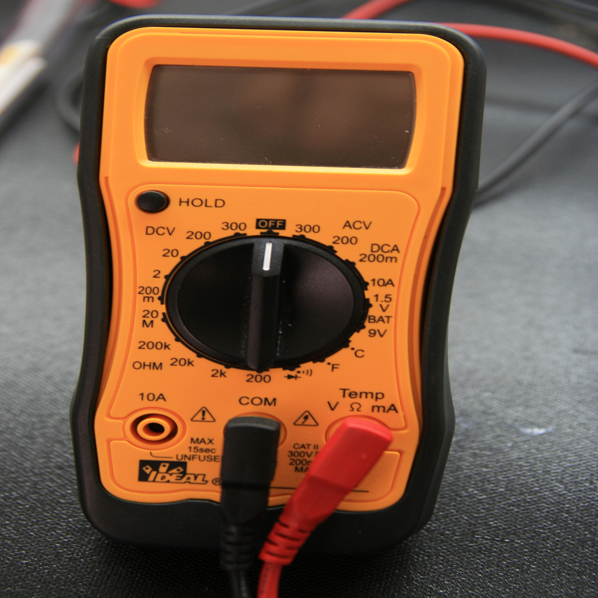

              EDIT - perhaps post a picture of your meter with the leads in where you normally have had them

                I only have 300vdc on my meter big cap show 167v didn't replace .39 resistor
