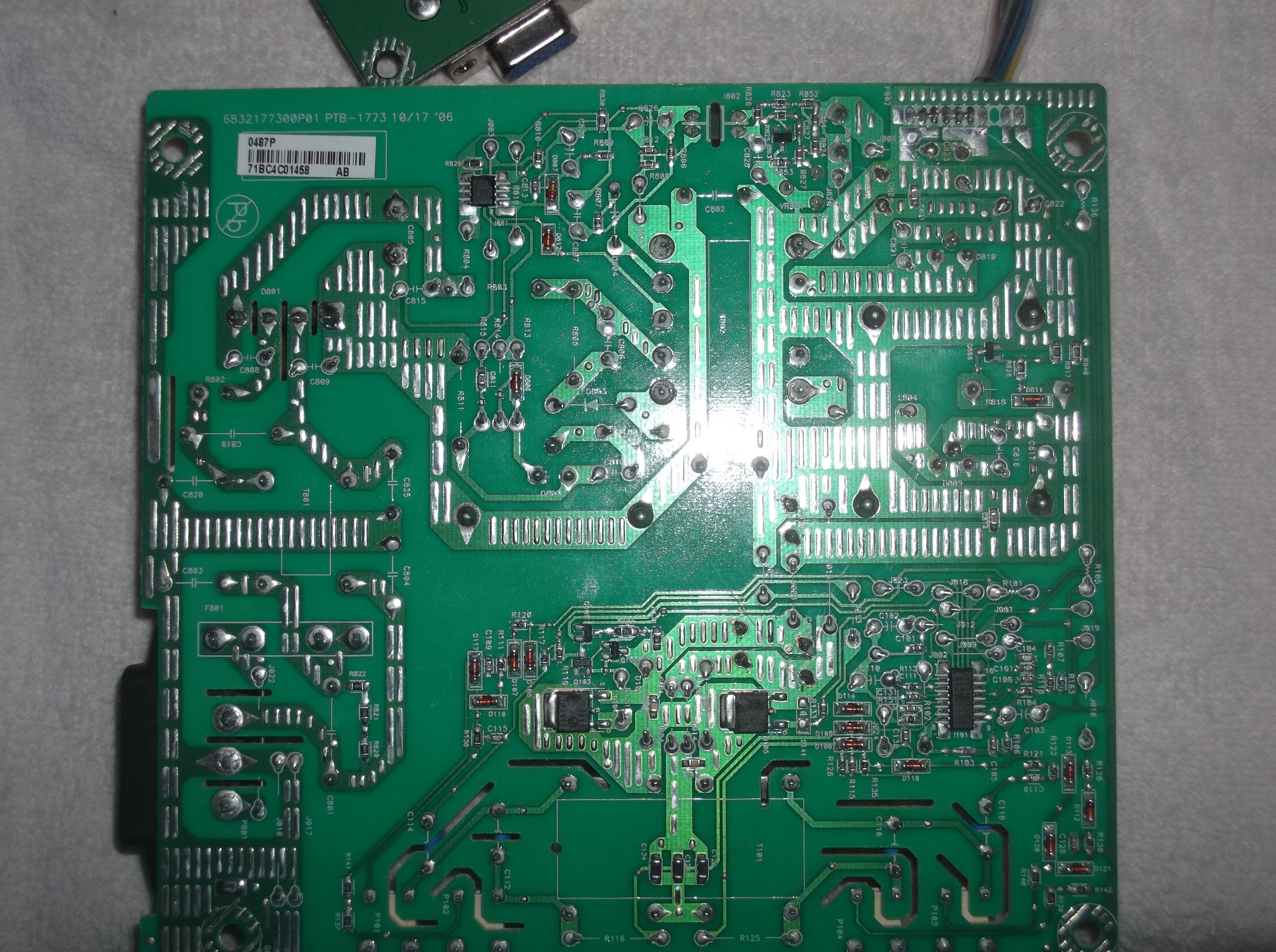

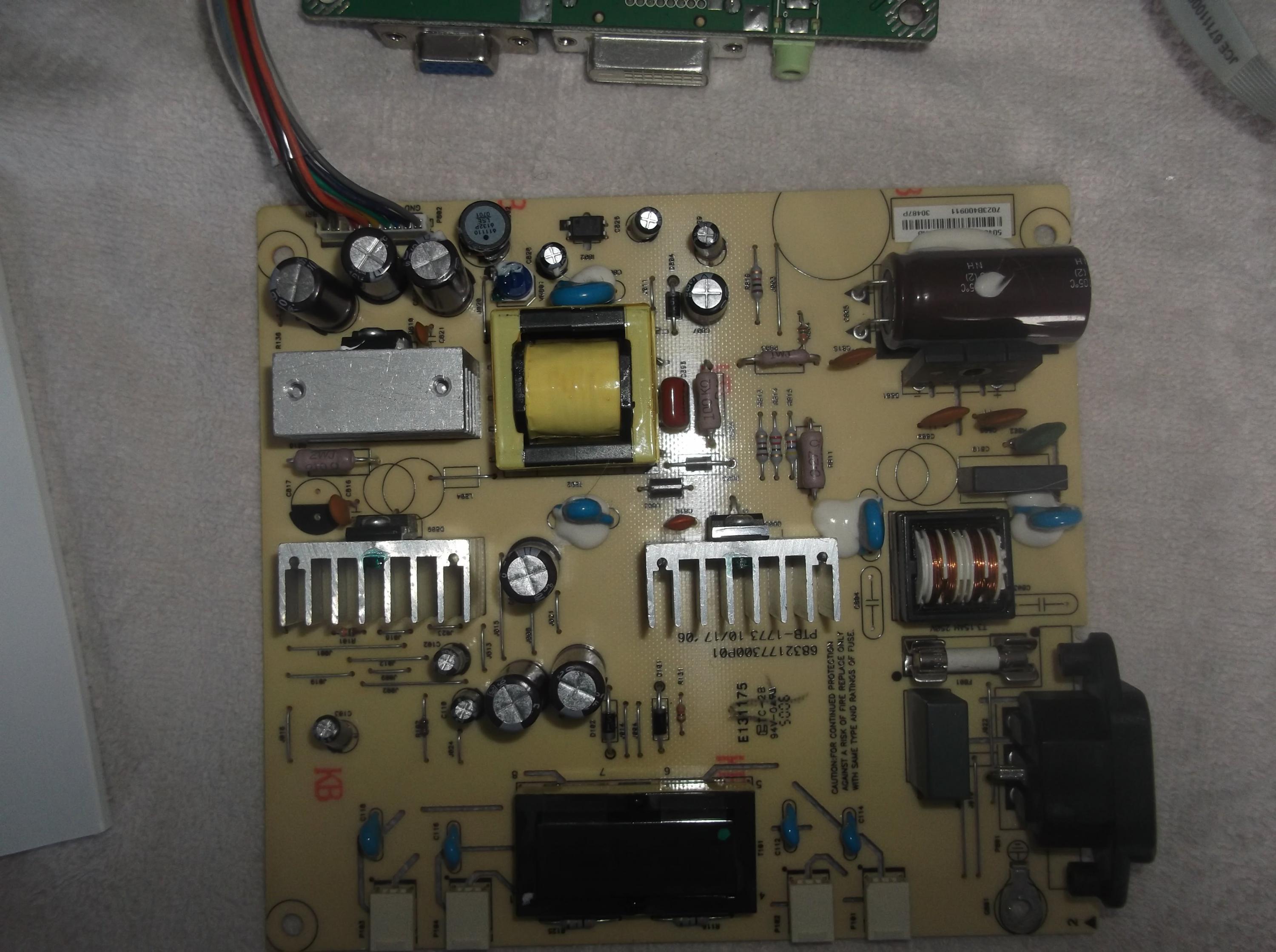

    first of all, I like to introduce myself as a beginner in the monitor reparing world!!
    I've got and HP W1907 monitor, everything went black, the monitor is really of, when I try to see the screen with a flshlights, there is nothing.
    I open it and got a E131175 power board
    No capacitors seems broken, i remove the C124, C125, C818, C822, C823, C824 ans test it on OHM, no one was short.
    I test the fuse F801, it was ok

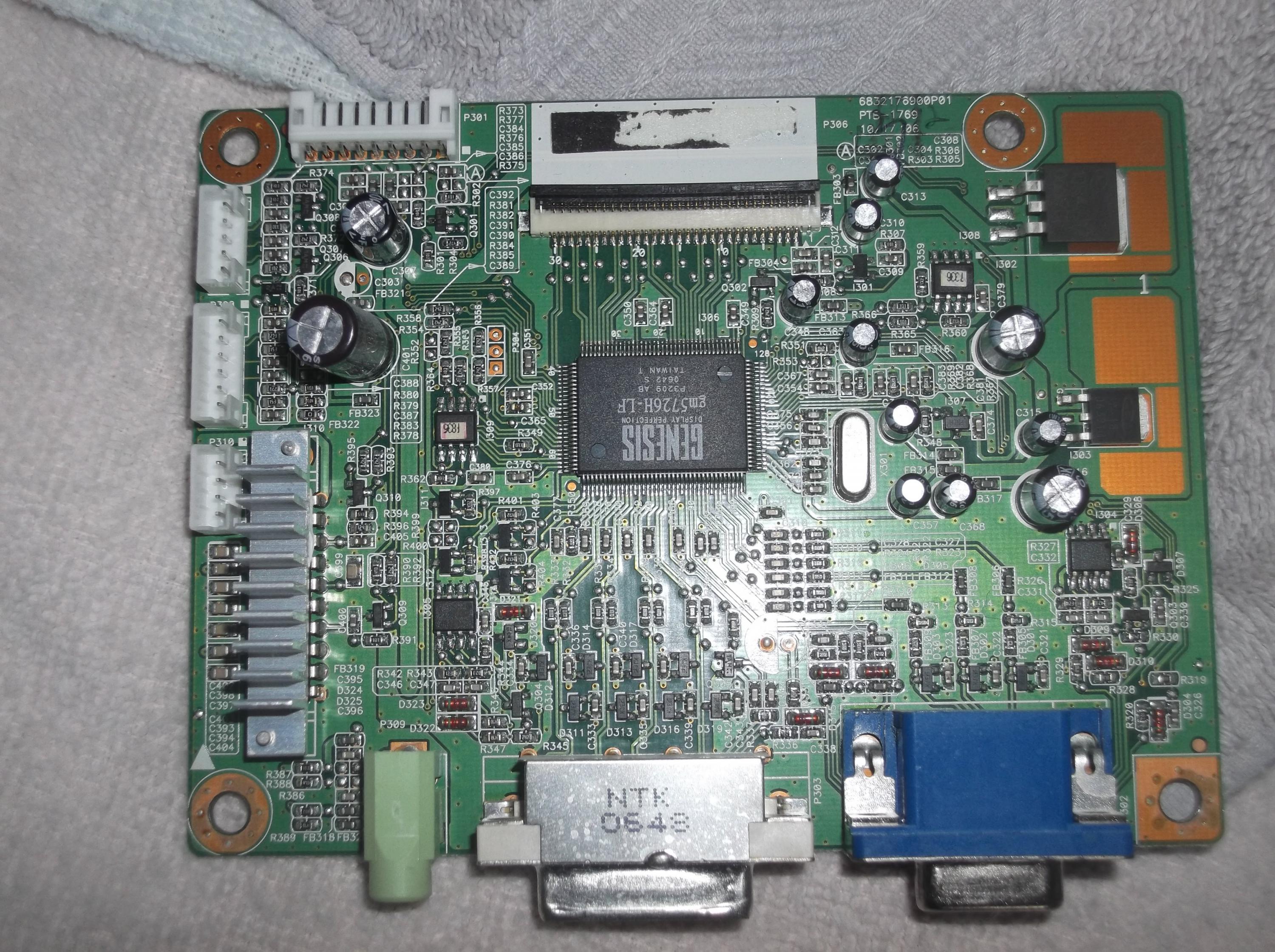

    I test the 5.1V that goes on the Logic board ; when the logic board is plugged I read 1.6 to 2.3 VDC and when the logic board is unplugged I read 8.4VDC.
    All thoose test were made with the monitor unplugged, i dont know if it change something??
    Sorry for my not terrible english
    Thank you for you help

    First, check the battery of your meter first (reading 8.4V is an odd reading, when meter's battery is low, it will give higher voltage readings). I cannot zoom in your pictures to take closer look at the cap. You need ESR meter to check the cap.
    Do you get any LED indicator on the front of the monitor?

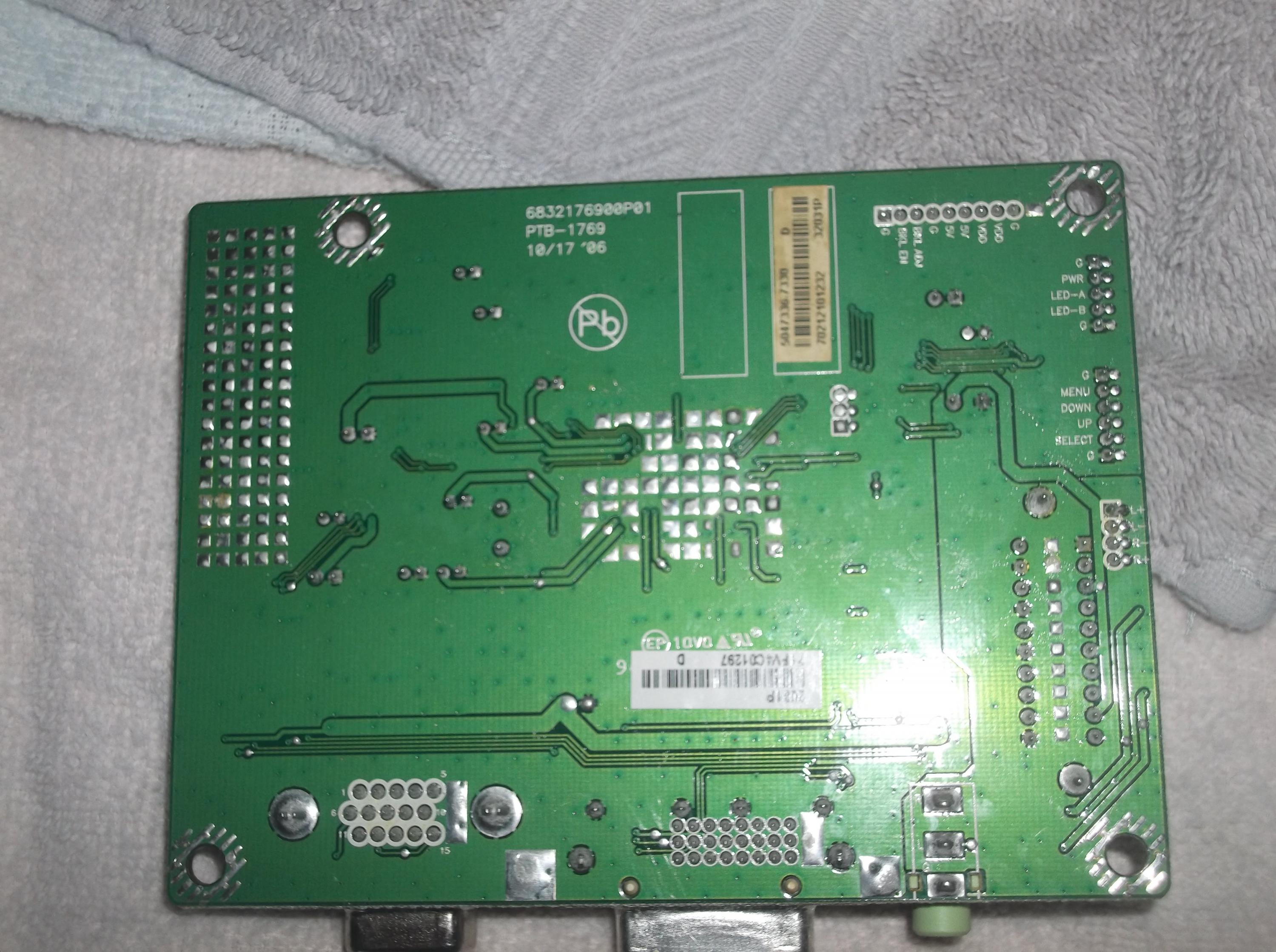

      Hi - First off is it a w1907 only your first pic is labelled w2007
      Second - your pictures are only thumbnails - go into edit and try and reload them

              Pictures are good thanks - There are a few solder joints that I think could be improved
              but first the meter - does it have a zero control. What does it show when the probes are
              together . Please test a 3v and 1.5v battery.

                      I think your meter is more probably ok, on the psu board there are 2 double diodes on heatsink, to220 package, test in volts between secondary gnd and its central pins, if yor read strange values you can try to supply the mon. with a at/atx psu, 5v to the central pin of the upper diodes, 12v to the central pin of lower diodes and switch on the monitor. This is a test only.. the ac plug must be disconnected from the monitor psu.

                          I have several of these monitors tossed from work. They were sold as a debranded TSSI model TS-19W7. Both would not power on. Upon disassembly, C815 on the power supply board was found puffed. 1000uF 16v electrolytic. I replaced with 1000uF 35v
                          and the monitor is alive. Hardest part is pulling the front trim bezel off to get inside.
                            Re: HP w1907 monitor
                            I would suggest you to replace the set of cap, except the large main cap in the primary side, bad caps can look normal, also make sure to use low ESR caps like PANASONIC FM/FR/FC series not the general purpose caps.
                              So,
                              I test it again with a Fluke 787 and get the same reading
                              I also check the two double diode with the meter and it seems alright, i didn't put the power on with the 5v and 12v, still need to find another power supply. I read on the common pin on the D810 8.40Vdc. On the common pin of D809, 27 - 30 Vdc.
                              I replace the set of cap of 470uf(3) and the 1000uf(3) but i still get the same result.
                              All my measure are read when there is notrhing connect on the power supply .
                              When i connect everything i get a readind going from 0.9vdc to 3.6vdc

                                    thinking it better the external power supply test is not useful, check the vcc pin of smps ic in the primary side and also the pin for start voltage, if you don't know which are download the datasheet.. test also the voltage carefully at bigger capacitor, there are 160v so attention..
