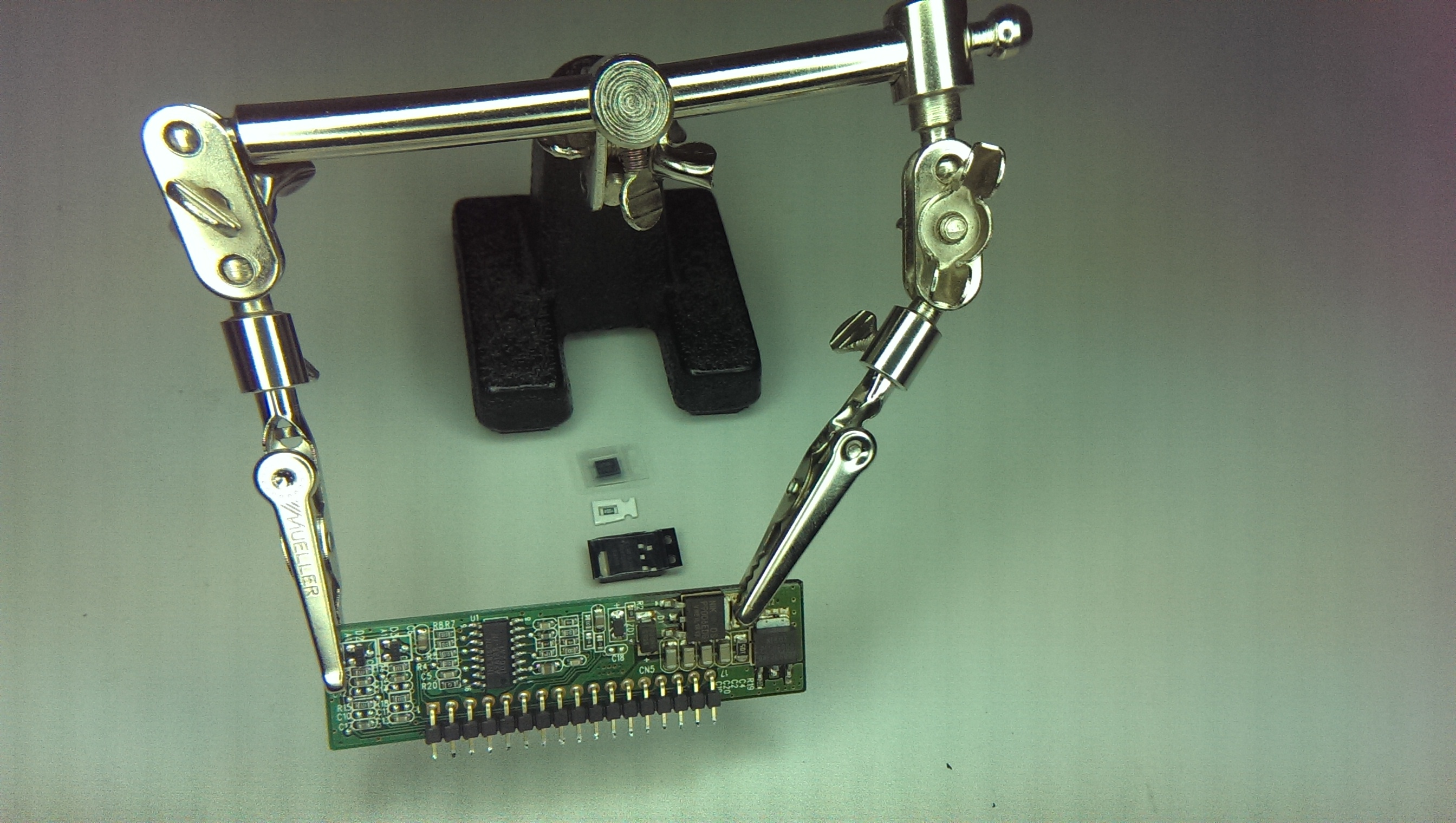

    Hi guys, I found an HP 2509m in the bin, and would like to try and fix it. The large size and built in speakers seem like it would be good screen for my father.
    So I've read up a bunch on this beast, and it seems like one or both mosfets on the daughter board are shot, as well as the accompanying diode, maybe an IC, and maybe a resistor. Also, I'm certain once I get the board working properly, the bulbs will be shot and I'll have to replace those.
    I've read through many threads, including:
    https://www.badcaps.net/forum/showthread.php?t=24866
    https://www.badcaps.net/forum/showth...ighlight=2509m
    https://www.badcaps.net/forum/showth...BDG#post117302
    http://h30434.www3.hp.com/t5/Desktop...s/td-p/1210387
    http://h30434.www3.hp.com/t5/Desktop...D/td-p/1643025
    which seem to capture the gist of the problem.
    I am comfortable with the component replacement on this tiny board, but unsure of which parts to buy.
    The components in question on the board are:
    mosfet #1: Nikos P5506BDG N-channel
    mosfet #2: Nikos P9006EDG P-channel
    Diode: SR26 PJ039
    IC: INL816GN AA3113.1N 1016A1
    and 105 ohm surface mount resistor
    I've read that for the P5506BDG fet, I can use STD20NF06L, FDD8451, or FDB6030L
    for the P9006EDG, the only thing I've seen is AOD413
    for the diode, I've seen STPS2L60 and SS26, easy enough
    No idea about the IC, or if it's even required
    and the resistor has 105 on it, so I assume a 105ohm surface mount is what I want, but digikey has so many options that I'm unsure of, like wattage and such.
    If requested, I can desolder the caps blocking view of the daughter board and get some pics if it'll help.
    Thanks in advance!

      Sorry, symptoms are standard 2509m stuff. Seems to have no power. No indicator (on/off LED) power, no response to buttons, etc. There is 165-168 at the big filter cap. Replacing the parts I mentioned earlier is supposed to restore everything to working order except the screen.
      I expect once the fets are put in, I'll have a screen that is darkened on the left side.
      What I need help with now is identifying the proper replacement #s, preferably from digikey.
      Thanks!

          Hi - I was just going to say we dont need to know any symptoms as they are covered in the links you posted and in the heading.
          I did do some research in the previous posts and it was hard then, 12 months on I think parts are like hens teeth tho someone has a "hardly used"
          monitor on amazon for 150US.
          I dont have a lot of time at the moment to help you and as you have seen from the slow response on the other threads, I think it will be hard going.
          Easy start - the resistor is unlikely to be 105ohms - I suggest 1Mohm
          ie 10 to the power 5
          see here
          http://www.hobby-hour.com/electronics/smdcalc.php.
          Scroll down and it has some clues about power. As with old series through hole resistors the wattage MAY be relative to size. So try and measure the resistor and that will narrow your search down dramatically.
          Is it completely burned or were you testing it for 105 ohms - if so try testing it for 1mohm

            Somehow I missed this last post. Thanks for the very helpful info, Selldoor. After measurement, I've added this this to my cart. I don't think I'm going to need to replace the IC, so that's on the backburner, unless I can't get it going. I'm having a hell of a time finding a replacement for the 2 mosfets though.
            Selldoor, in a previous thread, you had suggested using FDD8451 and AOD413 as a pair. Do you still think it these are a good choice even though P5506BDG and P9006EDG are 60V and TO-252 and FDD8451 and AOD413 are 40V and TO-263?
            I'm very much a beginner at component level stuff, so I have no idea one way or the other, it just seems like too much doesn't match up.
            It might be in the interests of time to just go ahead and order exact replacements off ebay, even though they are kinda marked up. I think it was a bad batch of bulbs (that I'll have to fix later) that caused these components to fail rather than the components themselves being particularly poor. That said, most of the matching stuff was bound from china, so who knows what it actually is.
            Thanks so much for your help!
            Alex

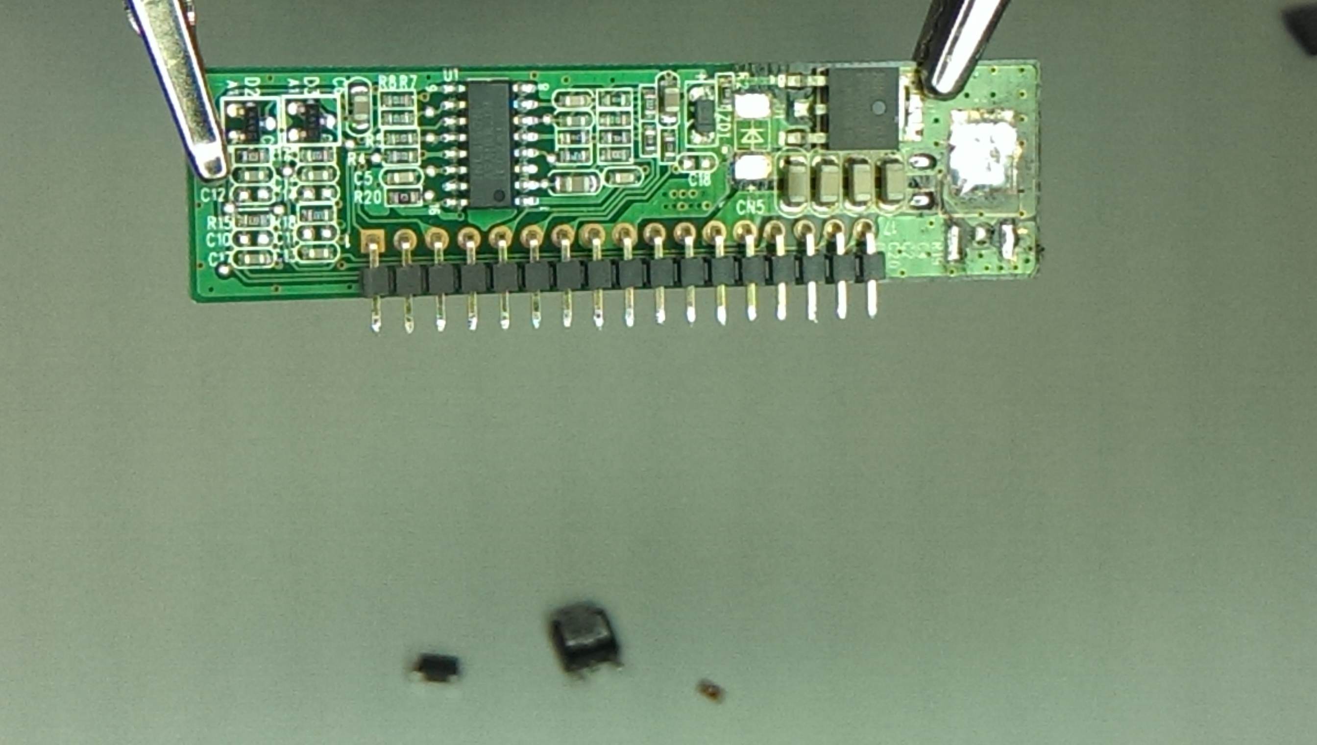

                Ok, update for anyone's future reference that intends to follow the same path. I replaced the diode, the resistor, and the P5506BDG with an exact off ebay (links to what I bought on digikey). It now sees power and the button lights up. The screen powers on and flickers constantly. I am now going to order the CCFLs and report back when that's done.

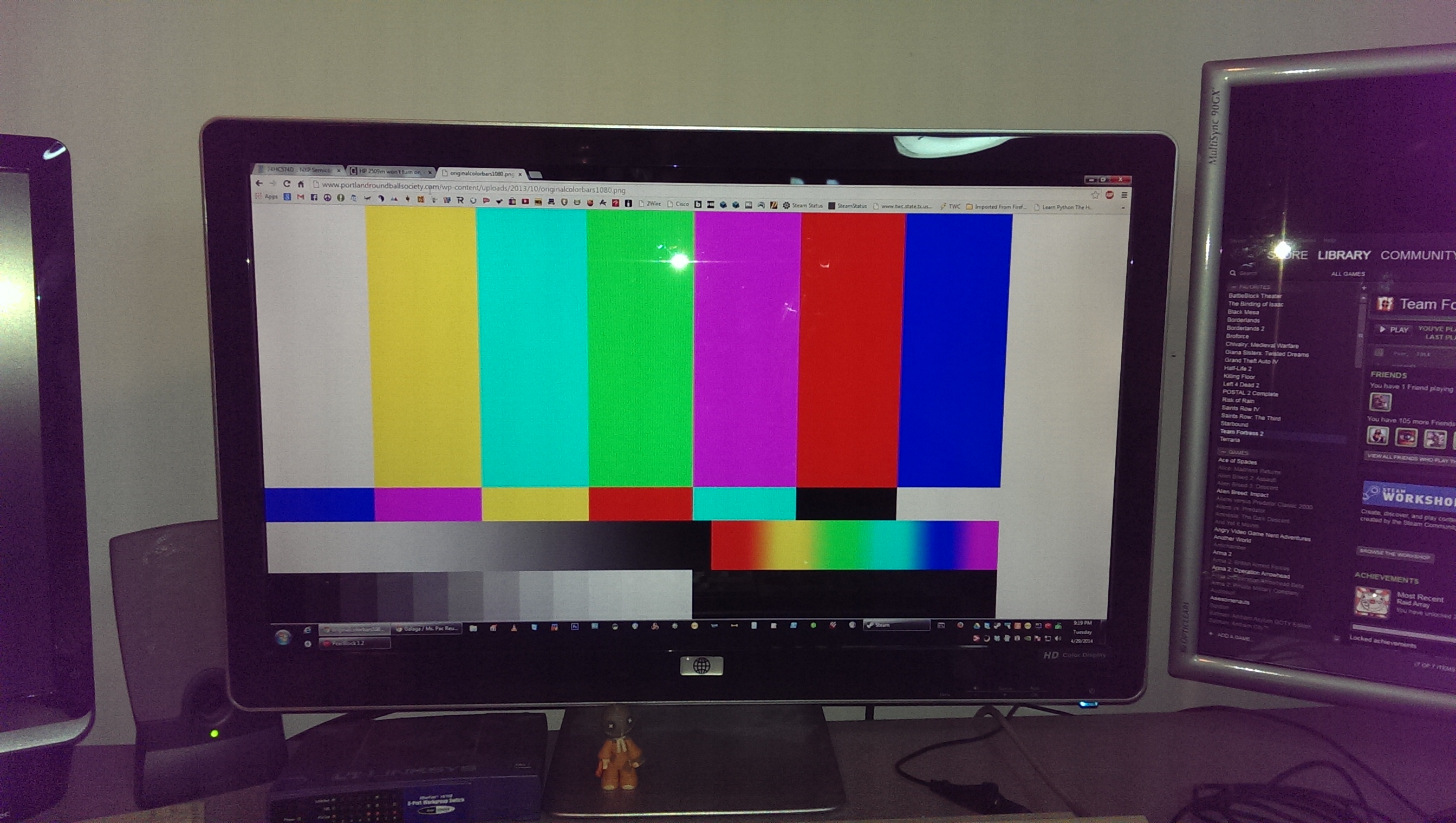

                  I FINALLY got around to fixing this. I replaced all four CCFLs but I probably only needed to do the bottom 2. All four doesn't hurt though, as these from the factory are notoriously prone to shorting, as the guys at CCFL warehouse told me. The correct size is 2.4 x 570mm, and I bought a 4 pack from them for 35 including shipping. I really screwed up on the first set, and broke both. I learned a lot though, and got a good methodology going, and the second attempt on the first set went smoothly. I then had to order another pair to finish the bottom set, which went well, and now I have fully working monitor with a backlight that will hopefully last a long time.
                  Some tips to anyone attempting this repair:
                  (sorry for not taking pictures, I should have documented the job)
                  Go ahead and cut the small wires a few inches between the plug and the bulb. You WILL need some slack to work with these very fragile bulbs. You can always solder them back together after. I cut out a few centimeters from the ends where they were heat damaged, and soldered in a section of thin wire off of a case fan into the initial cut.
                  Don't worry too much about saving the silicon caps. I was able to save the more pliable ones by making incisions in the outer part (conserving the part inside that divides the two bulbs) and pulling out the bulb and wire connections laterally. When soldering on the new bulbs, be mindful of the orientation of the wire leads. They will only fit one way, and each end is different. After you have them inserted back into the silicon ends, use some silicon sealant to repair any damage to the end caps you may have done. Two of my end caps were so brittle from heat, that I destroyed them entirely. I simply encased them in aquarium silicon and then trimmed them to fit after they had dried.
                  Overall, I would do a bulb change again, but the first attempt really sucked, and was very frustrating.

                                Hour 1. So far so good.
                                I have replaced the Diode, Resistor, and the Transistor on the daughter board. I got VERY worried about the transistor replacement, because although it was removed easily with almost no energy at all, the pad under the Gate pin (Pin 1) lifted. Even before the entire process the board was a dark brown on that side, more than likely heat generated from the P5506BDG.
                                The Diode and Resistor came from DigiKey, and the new transistor from Ebay (see withalligators' exact item replacements).
                                Not sure why, but I did not see any dimming or flickering CCFL afterward.
                                History of this "Rebrand": I got it through Woot during one of their wootoffs. When I received it, there was some rattling around inside. When I opened it, there were two screws that should have been holding the power board in, free-roaming around. I would think if it was a short it would have happened immediately, because the monitor was perfectly still crapped out. But it's working now. Time will tell!
                                Thank you for your valuable input, withalligators!
