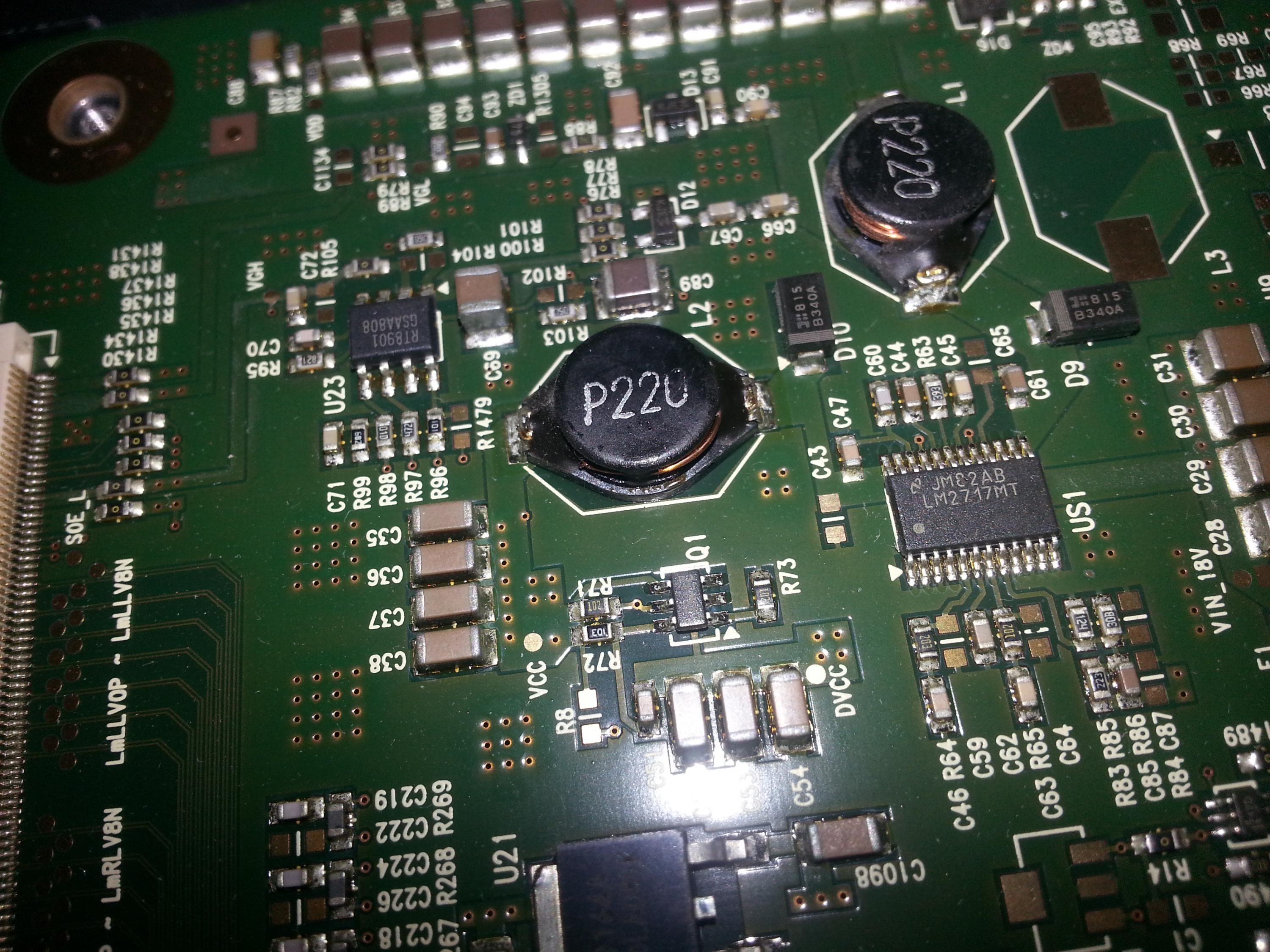

    Could you please help me with my dell 3008wfp. the cable between main board and LCD controller the one with isolation flaking away. I will attempt to repair it using your method. could you tell me if your L2 fuse on the lcd steering board looked like mine? I am not sure that it is blown, i can see bare copper wires but it looks just like L1 next to it which suppose to be fine. Where I can buy a P220(L2) fuse from? Please see attached pictures thanks hope you can help.
      P220 is an inductor, not a fuse, they don't fail that often.
      You can test it with a multimeter easily.

        I have repaired a lot of 3008s in the last 4 years and this issue does happen but only on rare occasion
        It is not the most common issue
        to plecak --The copper wire is supposed to be visible on this part
        And, as 3d0 noted, that is an inductor and if that would have failed, you would have a lot of other problems

          Right; those are inductors. And if he doesn't know the difference between those and a fuse he better be careful when working on that monitor.
          plecak, I'd probably do a little reading on board designators, and read some threads out here.

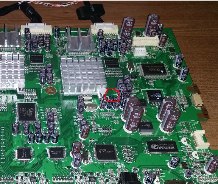

          But since this thread was brought back up, I do have a question on a Dell 3008WFP main board I am currently testing.
          I was testing voltage regulators and I tested a part labeled -- AK25P
          I can't seem to find that exact datasheet. I believe its an adjustable regulator.
          Here's the voltage readings.....
          1. 0v
          2. 2.28v
          3. 3.28v
          With the input voltage being 3.3v; how can the center tab be 2.28v ? (Fixed or adjustable. Unless I'm missing something)

              Re: DELL 3008WFP repaired!
              Originally posted by bammbammfran
              can you post a picture of the AK25P and where it is on the board then I can take a closer look at one here
              OK, I don't have my camera here. But I found one sold on eBay, but the pic doesn't exactly show it. It's in the area circled in red, behind the 4 little caps. AK25P
              • bammbammfran
                • Apr 2014
                • 476
                That is an sot223 2.5v 800ma fixed voltage regulator
                I checked readings on a working one and I get almost the exact same that you get. My board works fine even though it is reading below 2.5
                so this may not be your issue

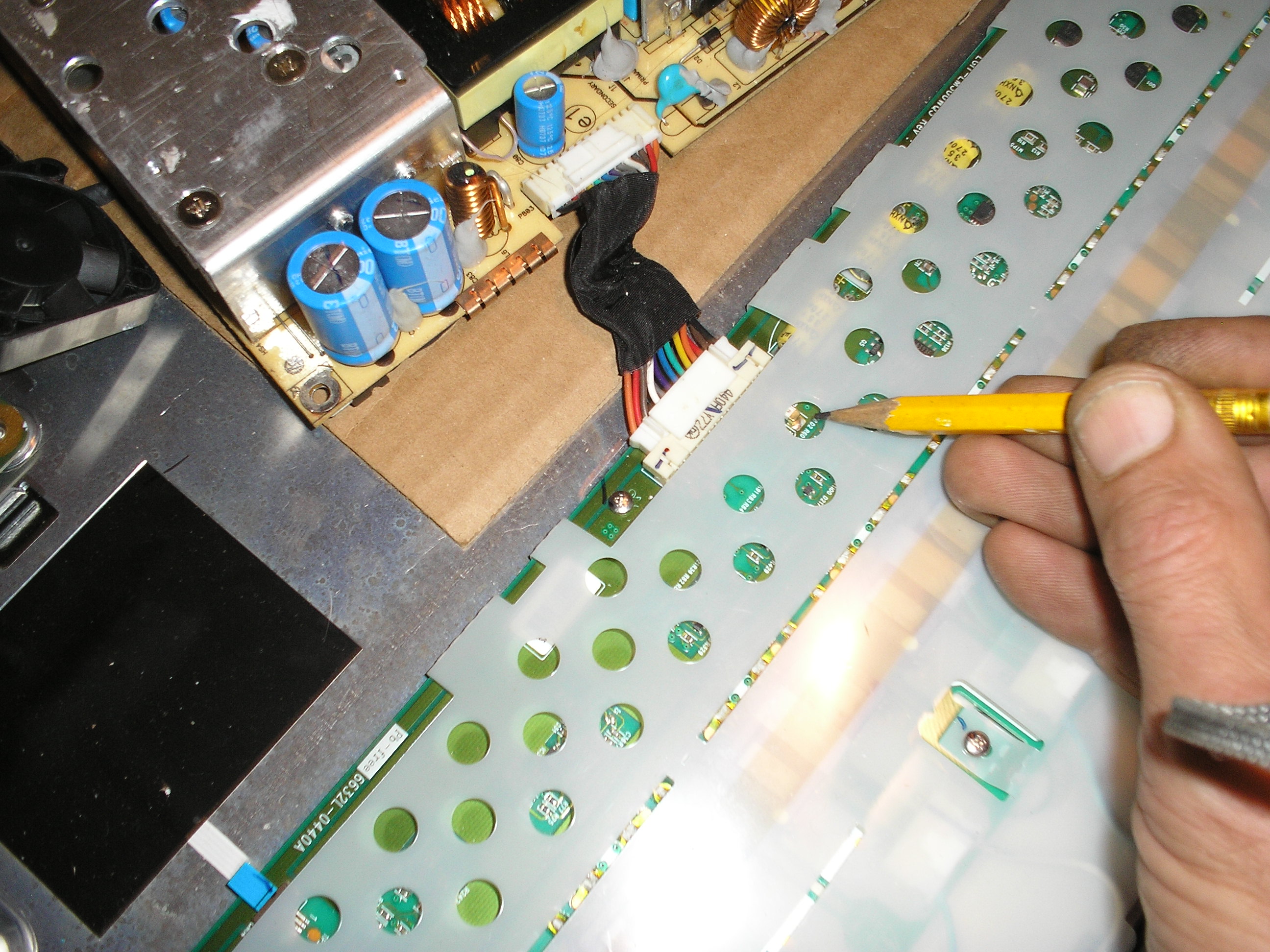

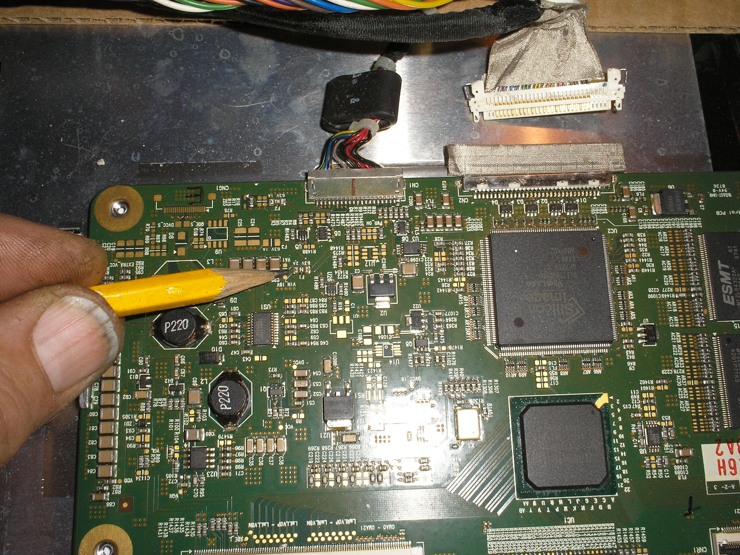

                      To Lumberjack:
                      Sounds like maybe a power issue.
                      Lets try basics
                      disconnect all input sources and usbs
                      Remove the two plugs that lead to the controller board in the pictures .
                      Then power the unit up and see if you have 24 volts at the inverter fuse in the other picture (pencil is pointing to it). then check to see if the screen is glowing . This will verify power to the inverter and will show if the inverter is working.
                      If that is ok
                      connect only the small connector to the controller board. now turn it on and check for 18 volts at both sides of the fuse at F1 on the controller board (pencil is pointing to it) At this point you should see a full solid color cycling screen
                      if that is ok
                      plug an input source into the last known input that the unit was using and recheck the 18 volts on the controller board
                          I assume that you checked all the voltage regulators ?? There are a lot of them !!
                          I doubt it is caps.. I have seen these work with a few bad ones.
                          assuming the t-con and screen are ok- You should get 5 color screens with the 30 pin disconnected Bk-W-R-G-Blue
                          if not, the 20 pin connector might be a place to start to backtrack from
