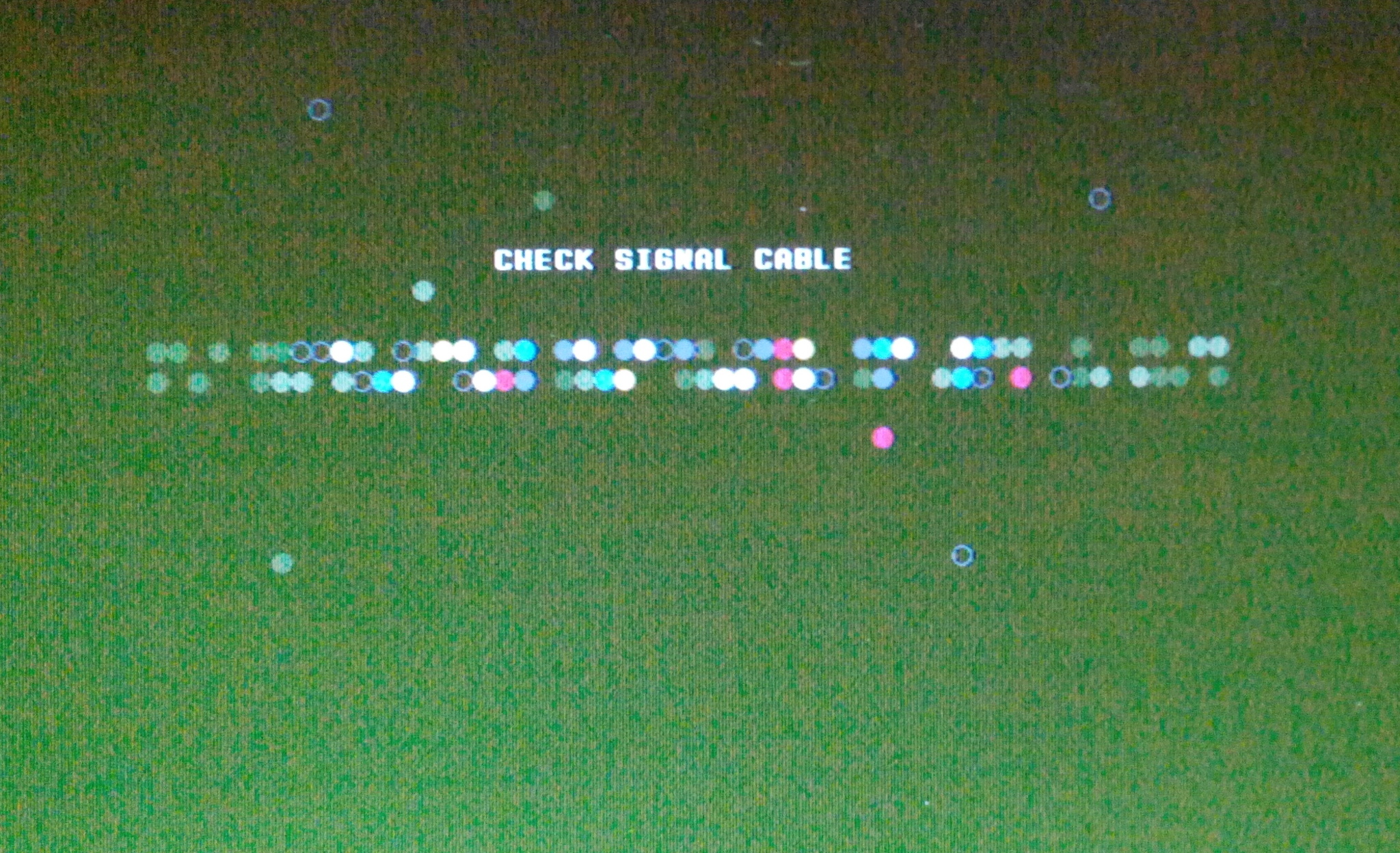

    I have a LG W2453V that initially did not start up. I found several bad caps so i changed all the caps on the secondary side. After this the monitor actually shows picture, but it is blurred.
    Check the attached picture, there shouldn't be green/red dots everywhere. There is no signal cable connected, that is why it says so, but the same problem remains when connected via VGA. I have not tested DVI/HDMI yet.
    What should I do about this?

    Did you already re-seat the LVDS cable between the logic board and the LCD Panel?

      Re: Lg w2453v
      Yes, twice.

        Re: Lg w2453v
        i don't know if is possible to test it, but if you provide it a black screen signal from pc maybe you must measure 0v on all data lines on lvds cable, if you provide a red screen you can measure for example 0,2v on one line and a 3,3v on another, this for a well working monitor or in case of damage on the tcon board, if it isn't is maybe a scaler bd error..

          Re: Lg w2453v
          The controller IC is obviously a suspect here, but can it be something else?

            Re: Lg w2453v
            You are probably correct - but is the pattern of the extra image always the same.
            What do you get with an all black image or all white.

              Re: Lg w2453v
              the test that i've suggested is not suitable. you must use an oscilloscope with better 100mhz freq.

                Re: Lg w2453v
                Hi guys,
                Me also have a LG W2453v with the same failure symptoms.
                I have changed all capacitors on the power board (bought a kit from Ebay).
                Today I received a new logic board from China ..... still the same failure.
                When the screen goes black I use a flash light but I can´t find any image in the background. What´s wrong? Why no image in the dark background? I guess the logic board need some voltage supply from power board....
                How do I fix this problem?
