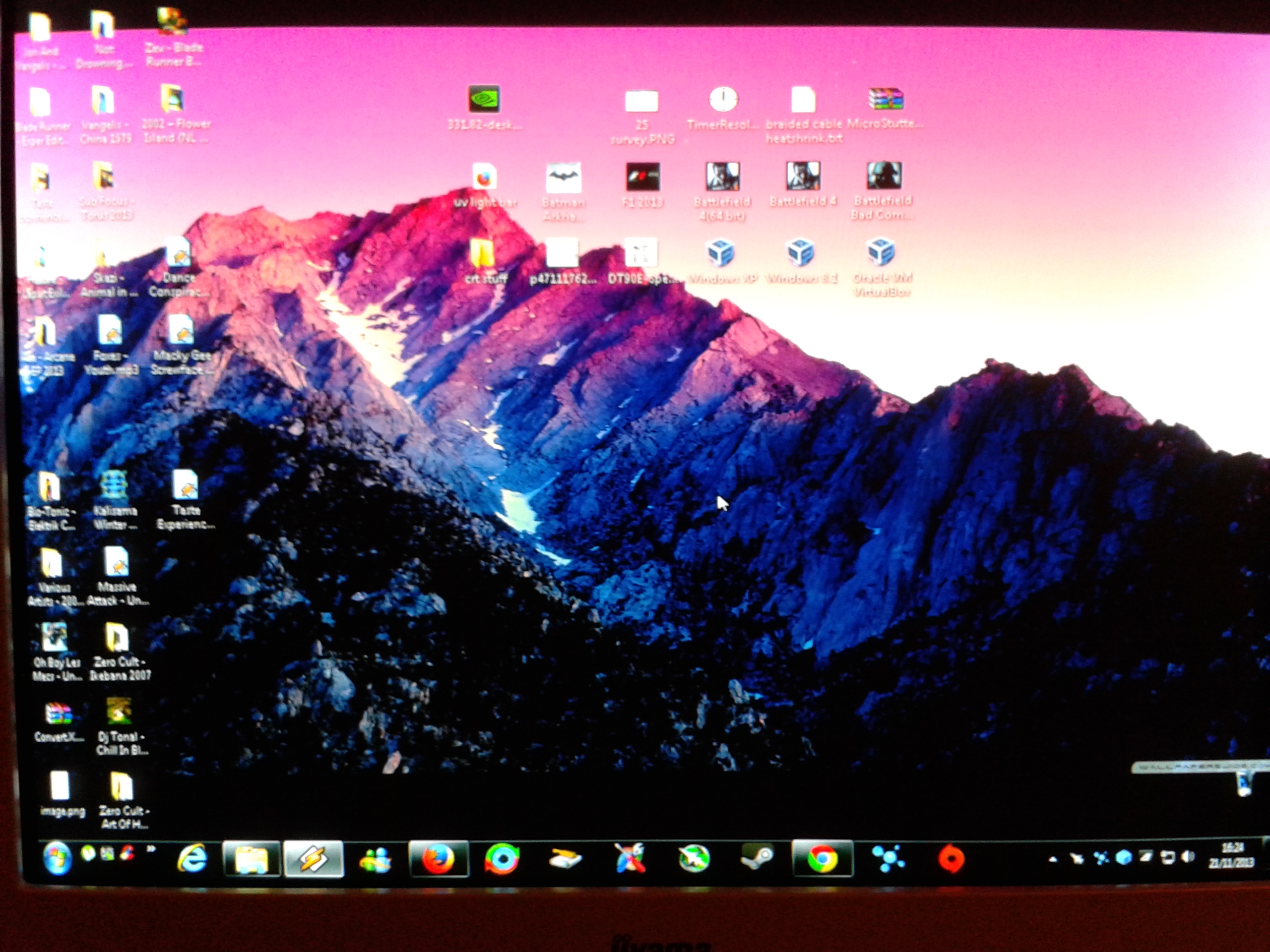

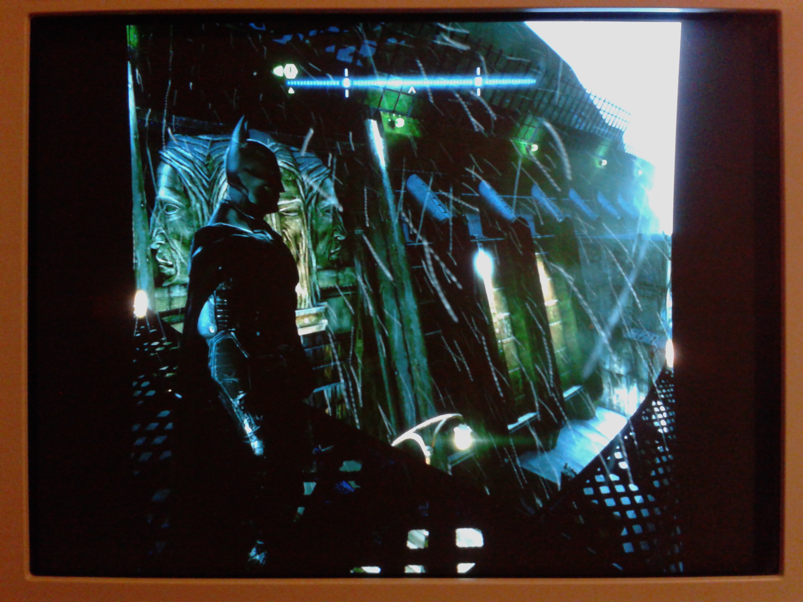

    Hi guys, hoping you can diagnose the problem I'm having with my monitor. It's a Iiyama Vision Master Pro 454 aka HM903DT I've had from 2003/4. Awesome monitor and picture quality to this day even with it's current problem. So, the problem is this, yesterday whilst playing Batman at 1600x1200 @100hz the screen suddenly squeezed in on itself horizontally leaving 2 huge black bars either side of the image, see pic 1. I closed the game and went back into windows where the native resolution is 1280x1024 @100hz and noticed the screen was now slightly oversized whilst also being stretched in the middle and somewhat squeezed up on the left and right sides, see pic 2. The problem persisted after entering back into a game so I knew something was broken in the monitor.
    Can anyone provide me with info into what has happened and also if you believe it's repairable, possibly blown caps or something else that could be serviceable??? I would love to keep this monitor as the picture is still fantastic for its age and really don't want to replace it yet if it is repairable.
    Any help much appreciated and thankyou.

    CRT monitor.Normally if the screen does not fill width wise,ie your Black bars either side, then that looks like a reduction in High Voltage,but these would be symetrical and straight lines.Its a long time since i worked on CRT Monitors or TVs, but no doubt some member will be able to help more.

      ic401 controls the ew/pincusion, on mine i had dry joints on the tube base panel and the deflection yoke connectors, blanket resolder cured it.

            Rtech gives a good clues about reduced high voltage and I want to add extra information maybe the problem is on horizontal output section. maybe a changed value caps or resistor, but your second picture looks like just a cold solder joint. I am not experienced, just give a clues and hope you could fix it. be careful when discharge the tube. You can try search my country site because there are still many CRT tv and monitor technician here.
