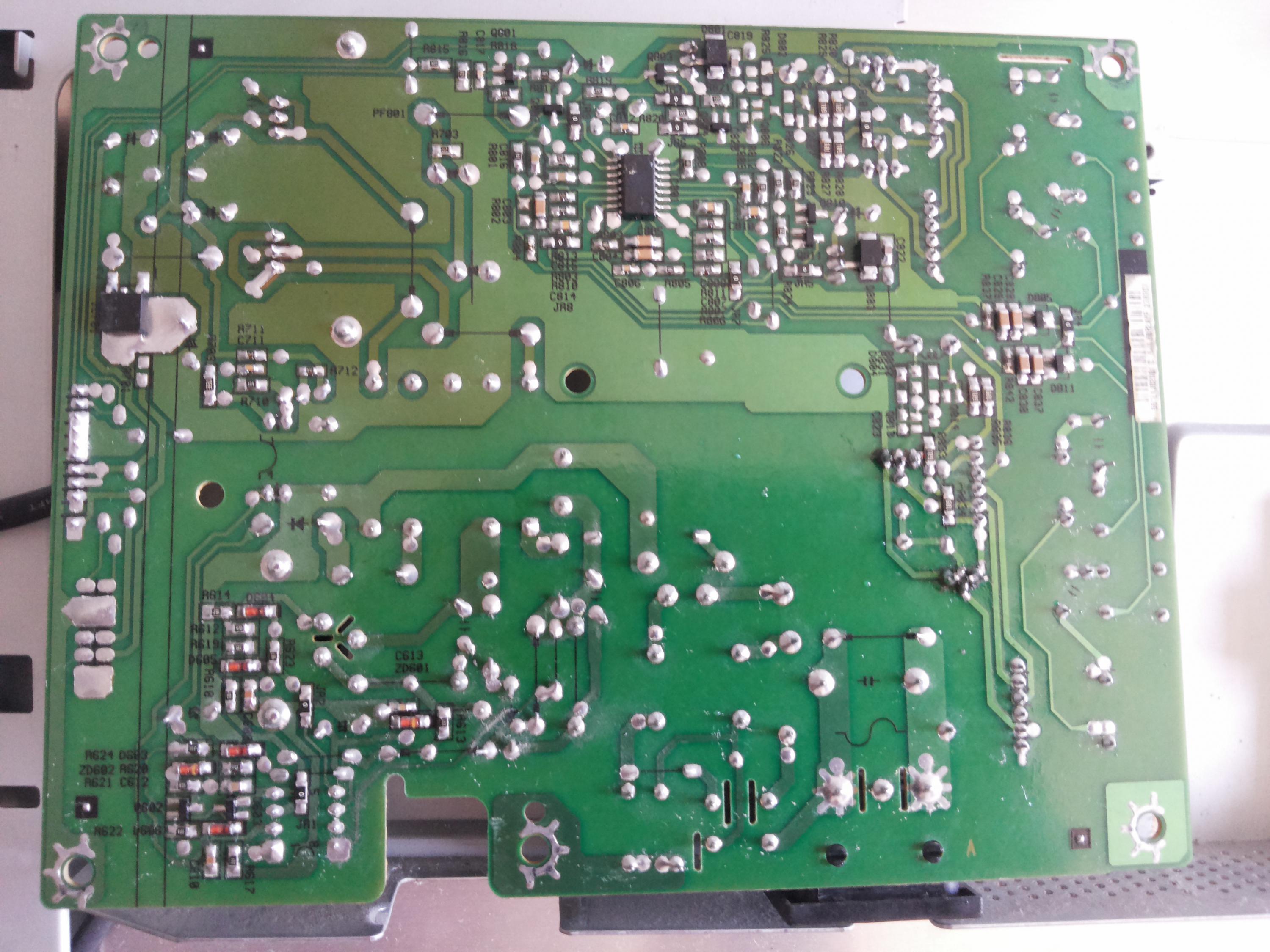

    Hi Guys,

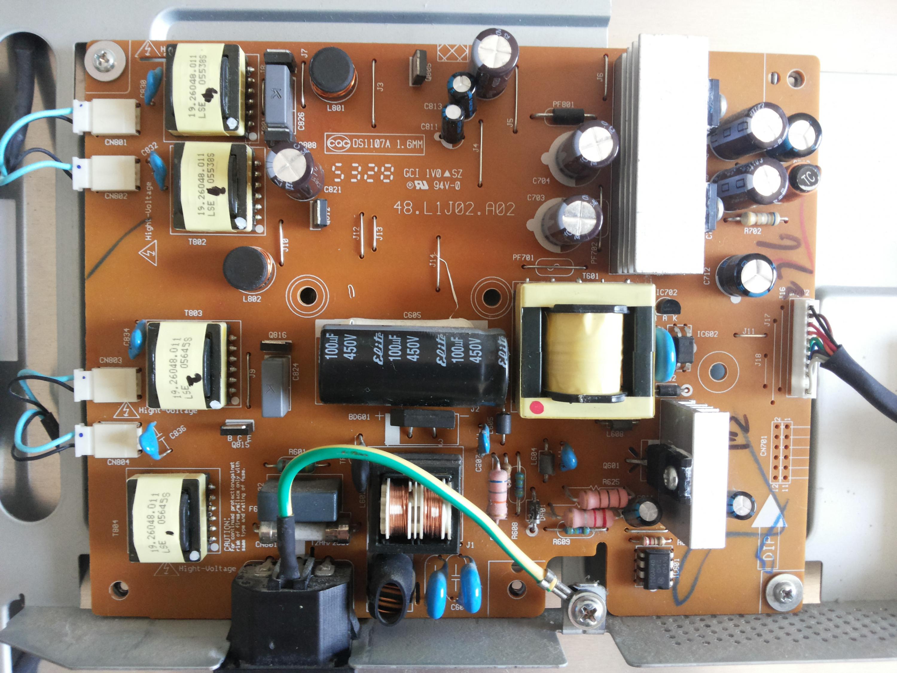

    I have a Benq FP91G+ Monitor which every now and then sort of freaks out.
    When I bought this monitor it had a fault which was 2 seconds to black so I followed the post of retiredcaps and found 2 bad C5707 transistors. When replacing the bad transistors it started to work good for 2 days but it started to freak out.
    Sometimes I try to turn it on and doesn't turn on. Sometimes the power button turns on and remains on with no display and if you try to turn the button off it remains on.
    Sometimes it just works fine and sometimes even 2 seconds to black.
    None of the transistors have a reading less than 50 ohms so they don't appear to be faulty.

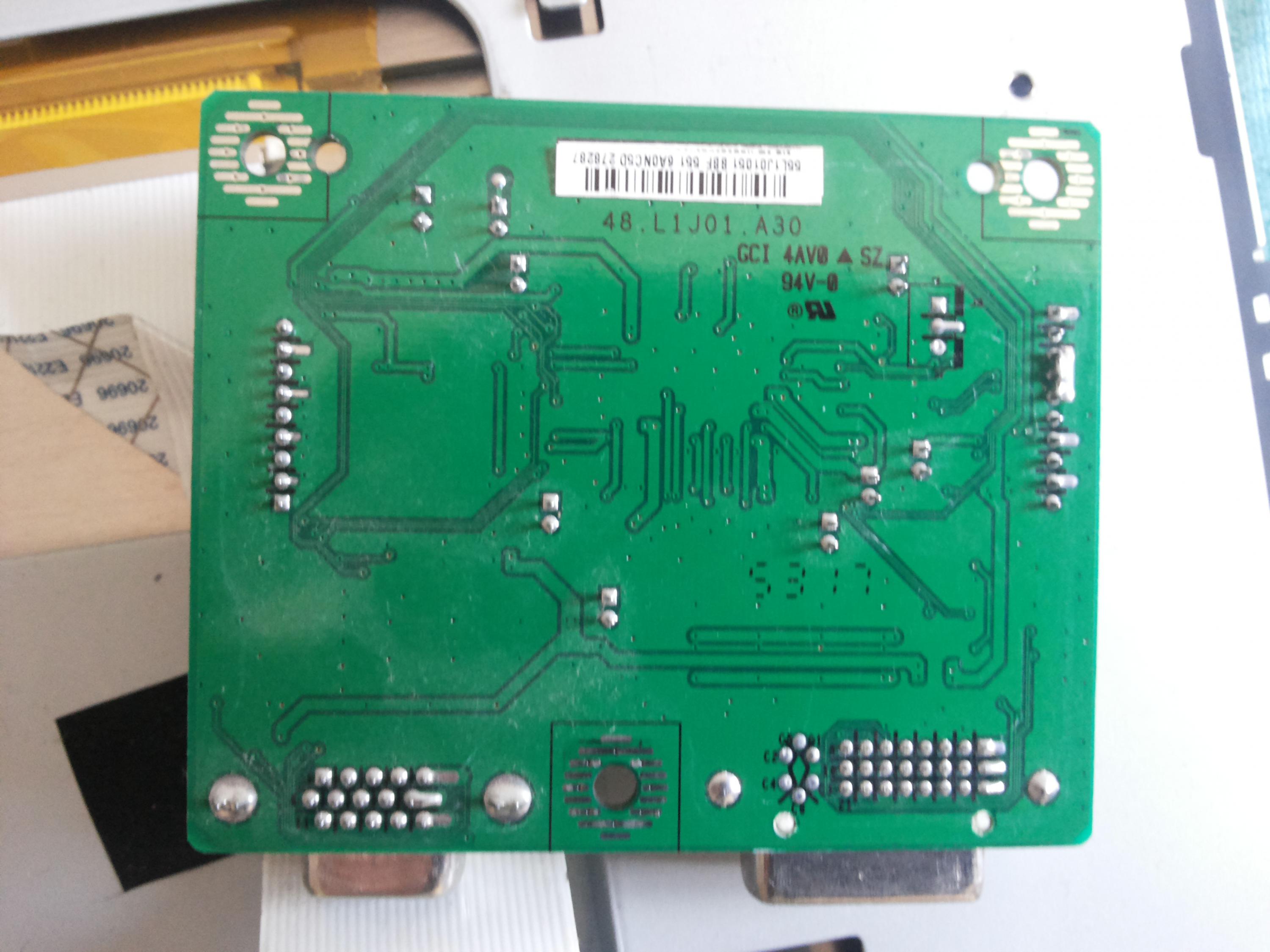

    Please find attached photos of the back of the monitor, the power board (front and back) and also the video board (front and back).
    Any suggestions guys?

    Did you resolder all the connections on the inverter transformer, transistors in the inverter section.
    Look for small rings around the joints.
    http://s807.photobucket.com/user/bud...?sort=3&page=1
    Also check the resistance of the PF801 to make sure it is less than 1 Ohm.

      Yes everything is resoldered including the transistors.
      The PF801 is giving the reading 000 both ways when connected on the board. Is that fine or should I remove one leg from the board?
      • Lumberjack777
        • Dec 2010
        • 464
        Re: Benq FP91G+ Monitor
        That's a pico fuse and should have resistance of 1 ohm or so. Now if that 000 means out of range, then the fuse is open. You can also use the diode checker and it should give a very low number. Like 1 or so.

          I don't have a diode tester. how can I check it with a normal meter? On my meter 1 means out of range.
            In Ohm mode, touch the two probes together and see what you get (it will show the probe's leads resistance), the fuse should show about the same reading.
            • matthmal
              • Nov 2012
              • 306
              • Malta
              I got the same reading when touching the probes together...000
                That fuse is OK.

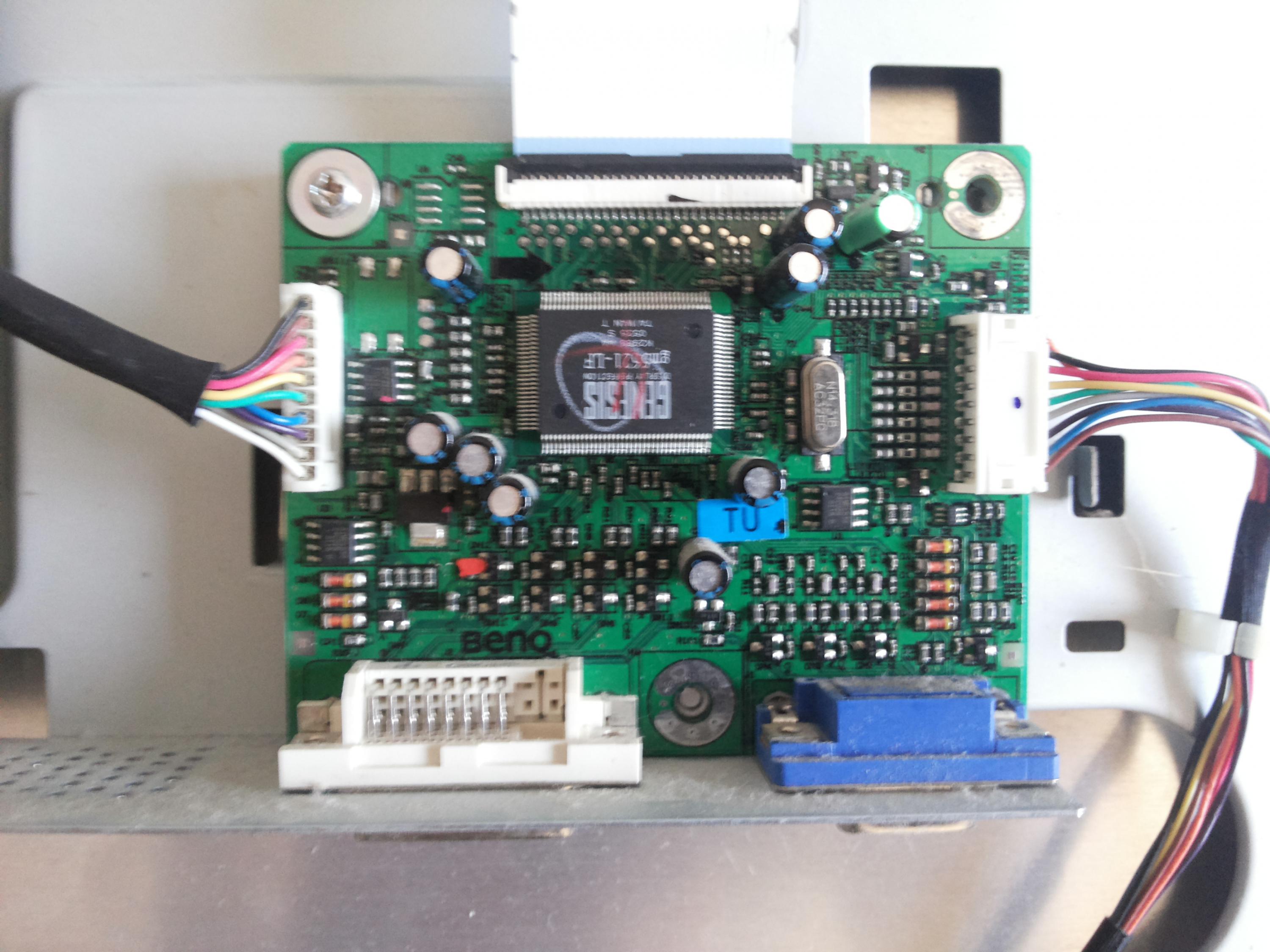

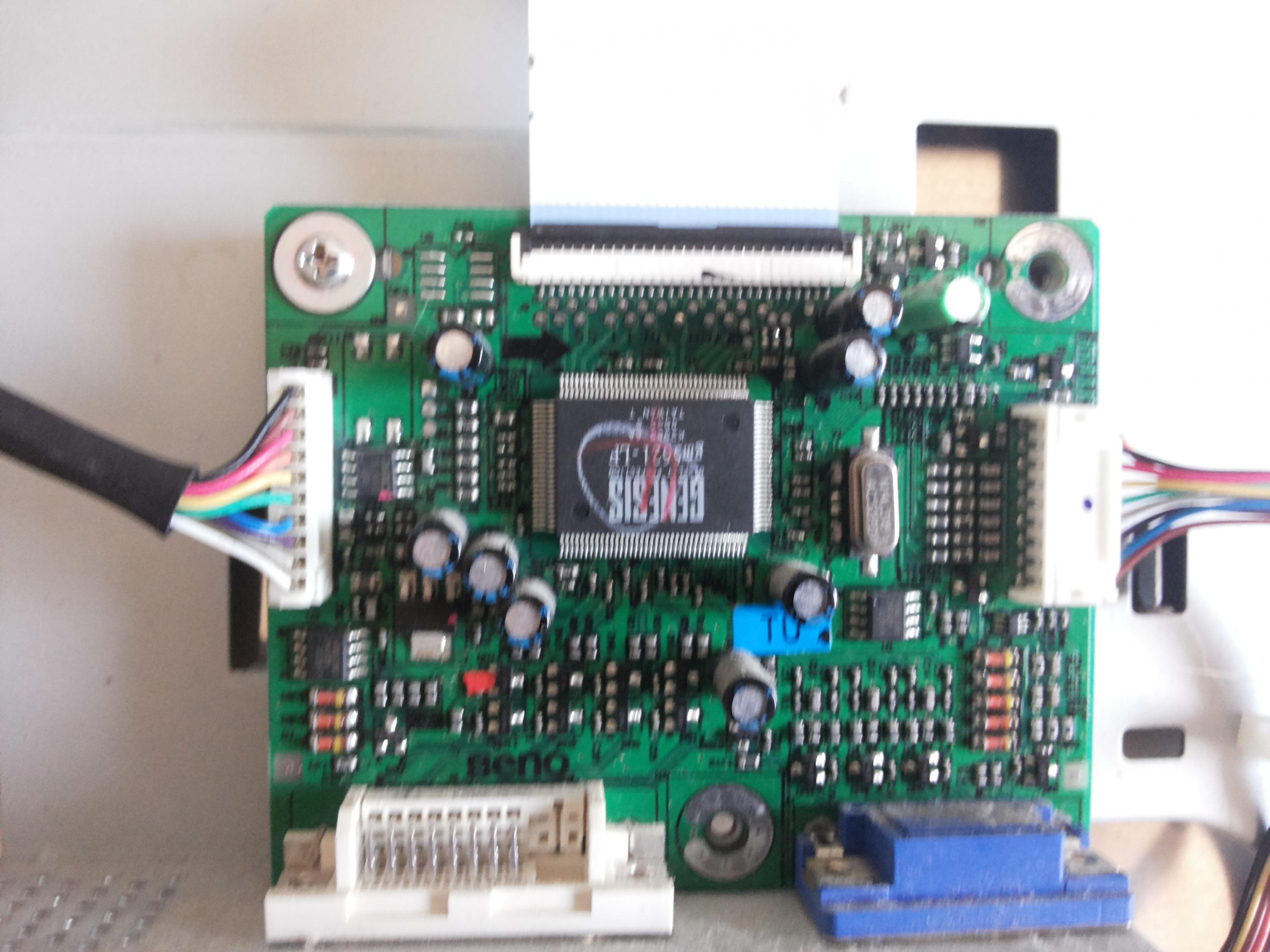

                "Sometimes I try to turn it on and doesn't turn on. Sometimes the power button turns on and remains on with no display and if you try to turn the button off it remains on." That seems like the main/logic board is not responding correctly. I see 3-pin voltage regulator, you should take the DC reading of all 3 pin (the middle pin is connected internally to the big tab on top) when it is working and when it is not working.

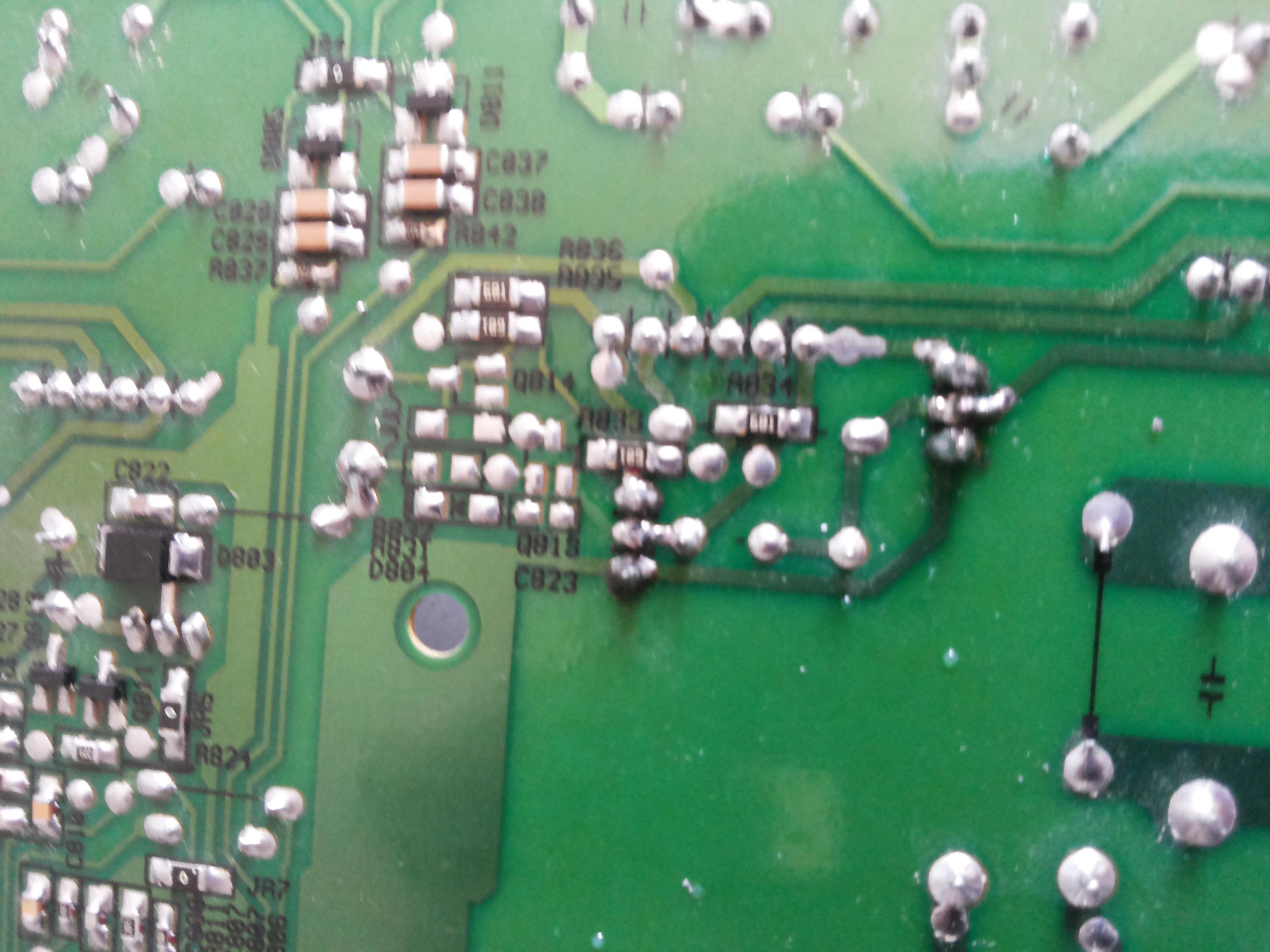

                      check thes mosfet in the inverter FU9024N e c5707 ! and 'success that face to the white screen to monitor. controls the condensers 0.22 between the C5707.

                                i noticed a small crack on the solder of one of the C5707s that I replaced so I resoldered it. I will keep it 2 days for testing and if it fails again I will do your test buddy and will post the results.

                                    After re-soldering the C5707 transistors, I now have a new symptom. The monitor works for a while and then turns off. I switch it on again and works for a couple of minutes or hours and shuts down again.
                                    I tested the 3 pin voltage regulator and got the below results:
                                    Pin 1 -> 3.3V
                                    Pin 2 -> 1.8V
                                    Pin 3 -> 0.00V
                                    I still need to test the regulator when the monitor fails though as I tested it while it was on and working.

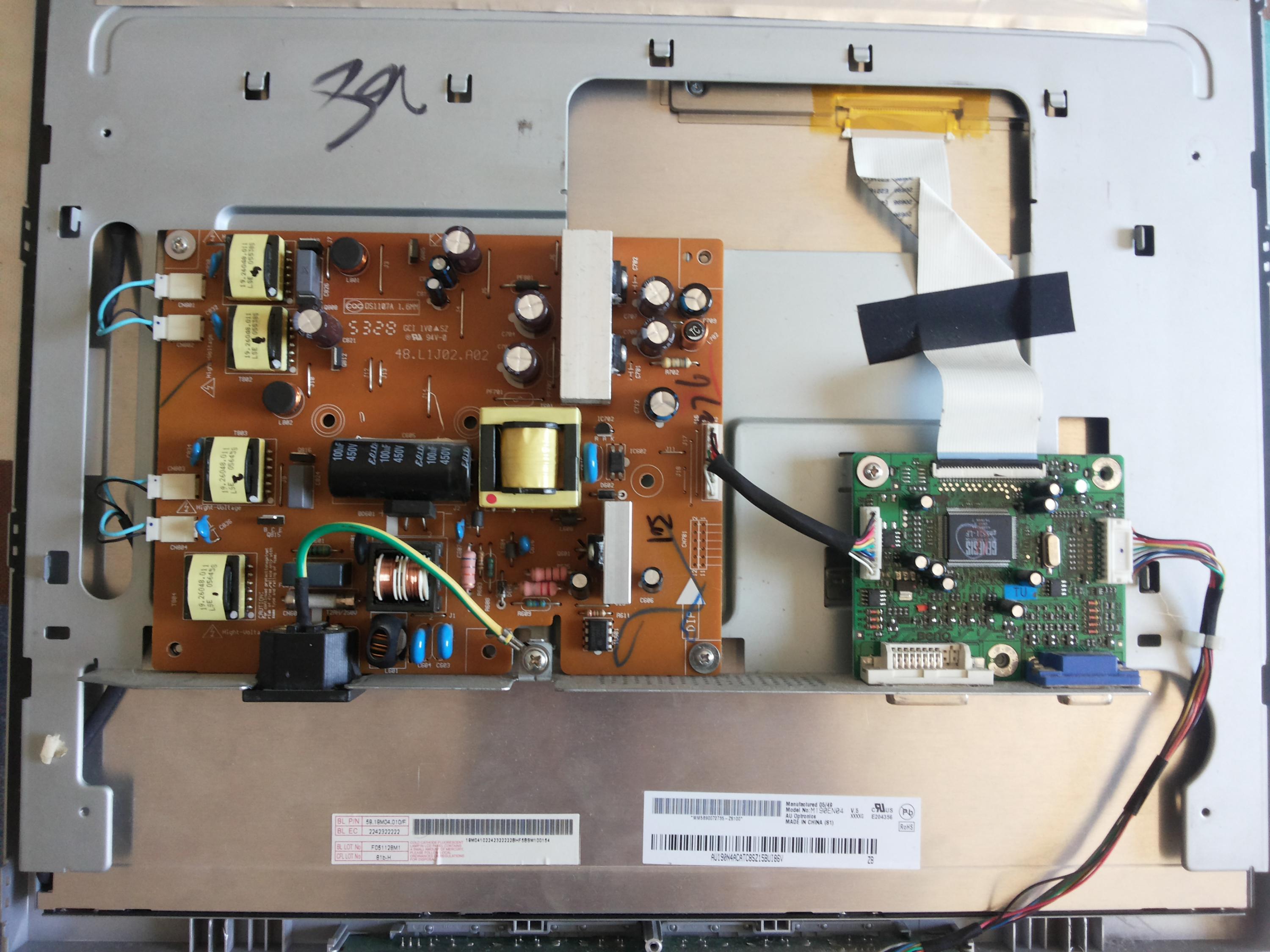

                                      Service manual, not sure if it matches your boards or not.

                                        They don't seem to match as my PCB P/N is: 48.L1J02.A02
                                        Please correct me if I'm wrong
