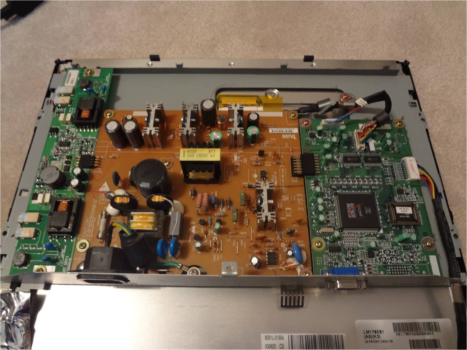

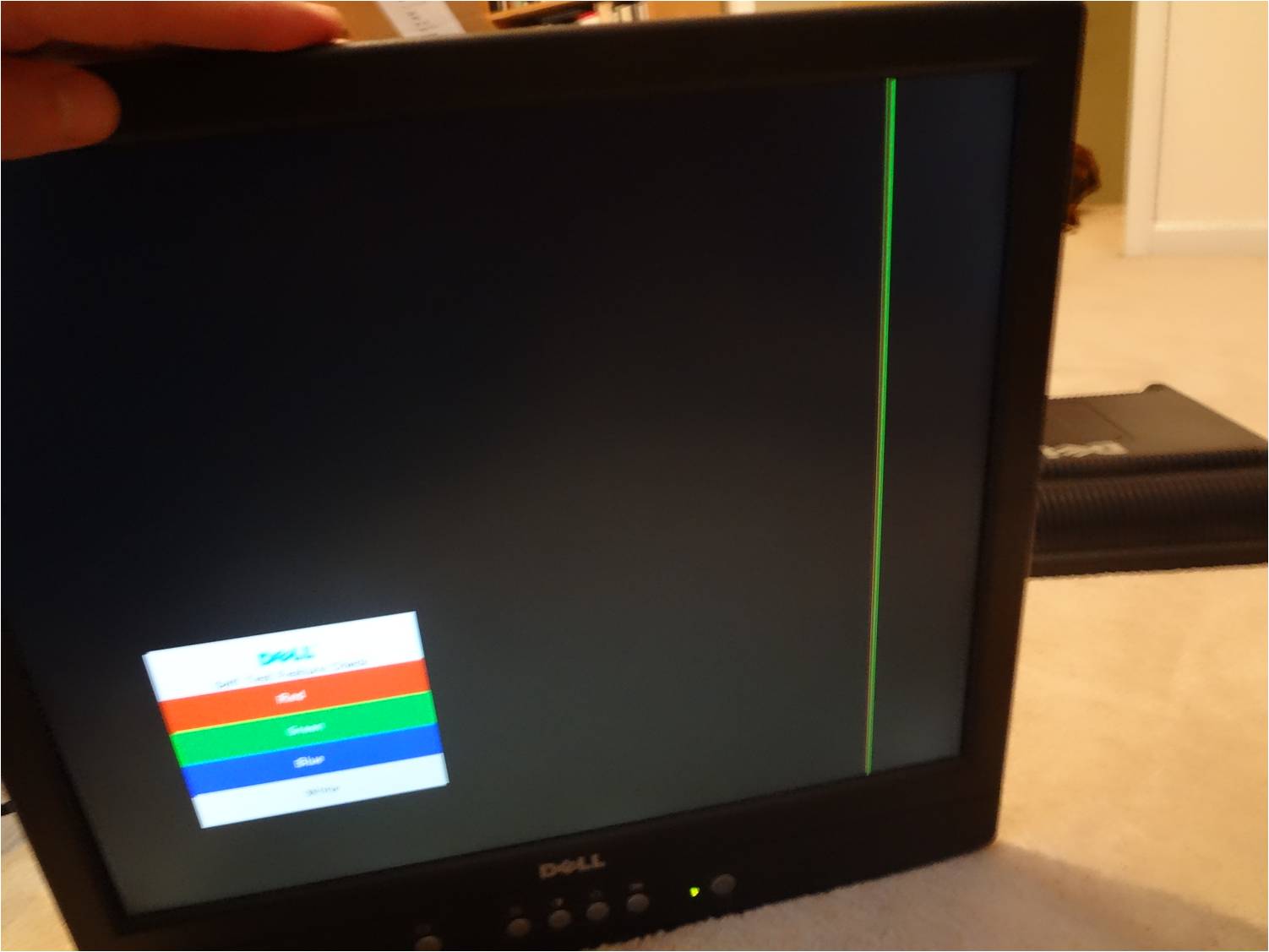

    i have a dell E171FPB which powers on fine but when on has a "greenish" veritical line on the screen....see enclosed picture
    any ideas? is this a cap issue? my gut tells me its not.

      Re: E171FPB vertical line issue
      Clean & check lvds cable if line is still there it's possible bad screen
