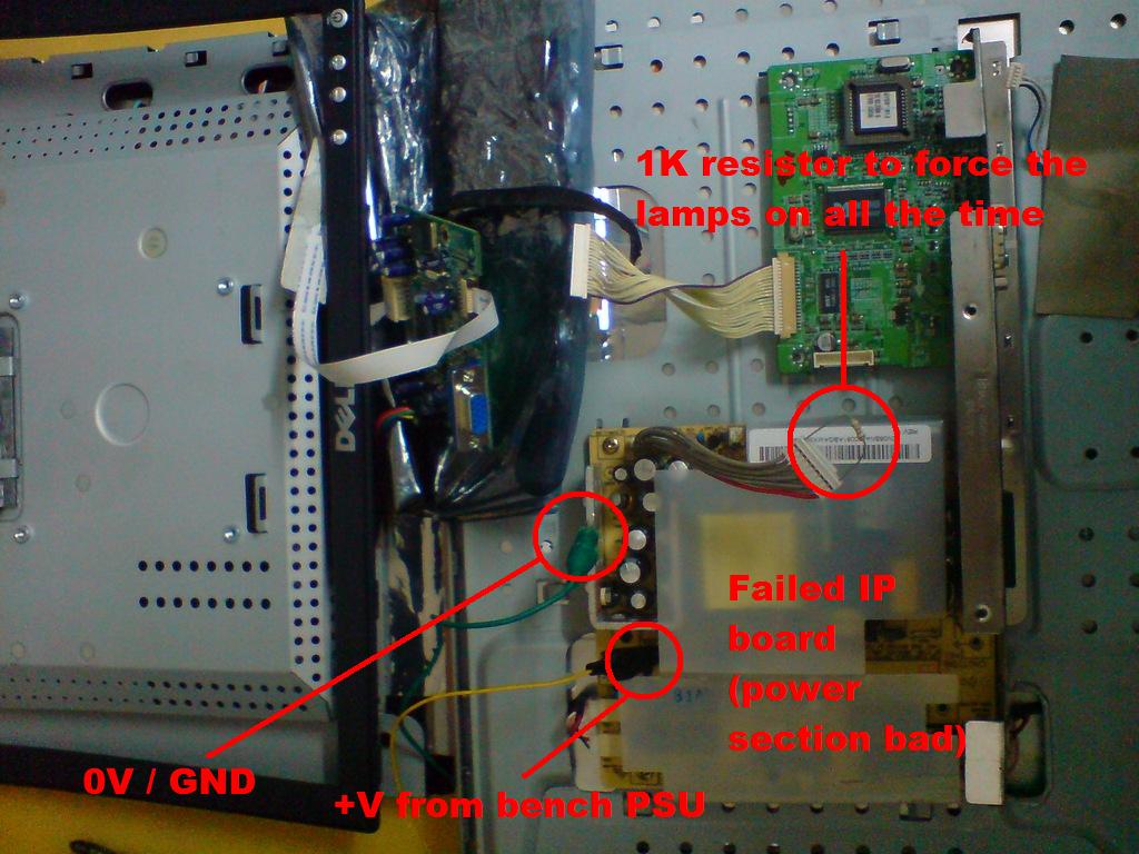

              You could hardwire those Lamp enable control pins. Usually I would use a 1K resistor between the +5V line and the control line to force the backlights on. If it stays on then the problem is not the inverter section.

              If you have a bench power supply, try powering the inverter section directly, plus the hardwired lamp enable to keep the lamps on. Make sure to disconnect the mains power during this test.

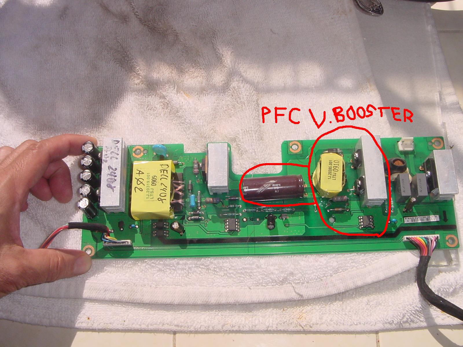

                  "Is that the big smoothing/filter capacitor right after the bridge rectifier? Usually the voltage across that big capacitor should be quite constant, no matter whether its on or off. The voltage should be roughly 1.4*Vrms where Vrms is the mains voltage."
                  This power supply has PFC Voltage booster, at standby the voltage on the cap is 120 x 1.414 = 169Vdc, when power switch is activated, the PFC will kick in to boost the voltage to around 380~390VDC.
                  "You could hardwire those Lamp enable control pins. Usually I would use a 1K resistor between the +5V line and the control line to force the backlights on. If it stays on then the problem is not the inverter section." You will have to first disconnect this control line that goes back to the main board since this signal line is held LO (or stuck LO) by the switched transistor on the main board.
                  The power supply only has one output (rectified by 3 diode in parallel), the output is then step down (done by the main board) to multiple voltages to run the main board.

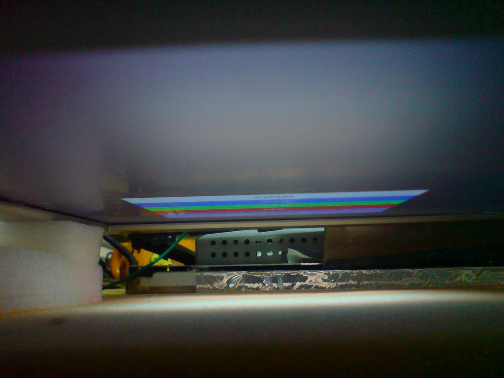

                    I reconnected the monitor to the PC's VGA port as a secondary display and lo and behold the Dell logo popped up followed by the "check the input" prompt. I switched to VGA and voila - the monitor came to life.
                    So looking back I'd venture a guess that at first it was indeed the "2 seconds to black" because several CCFLs jumped out of their nests. When I fixed that the monitor switched to the "7 seconds to black" which was nothing else but the sleep mode. Of course I didn't know that because the monitor was not connected to the PC and I didn't see the prompts on the display because the monitor was lying face down.

                        That's the usual routine, simply disconnect the Dscaler board first. See attachments. That's one of my "franken" testing to check the LCD panel, kinda messy but you should be able to make out the setup there. The diodes are blocking the DC to the transformer, and I just power up the inverter section only. With this method, I could test the inverter section, Tcon board and Dscaler board easily..

                          If you remove the cover off your power supply board, then I can tell if it has PFC Voltage Booster or not.
                          See PDF of example of the PFC V booster.
