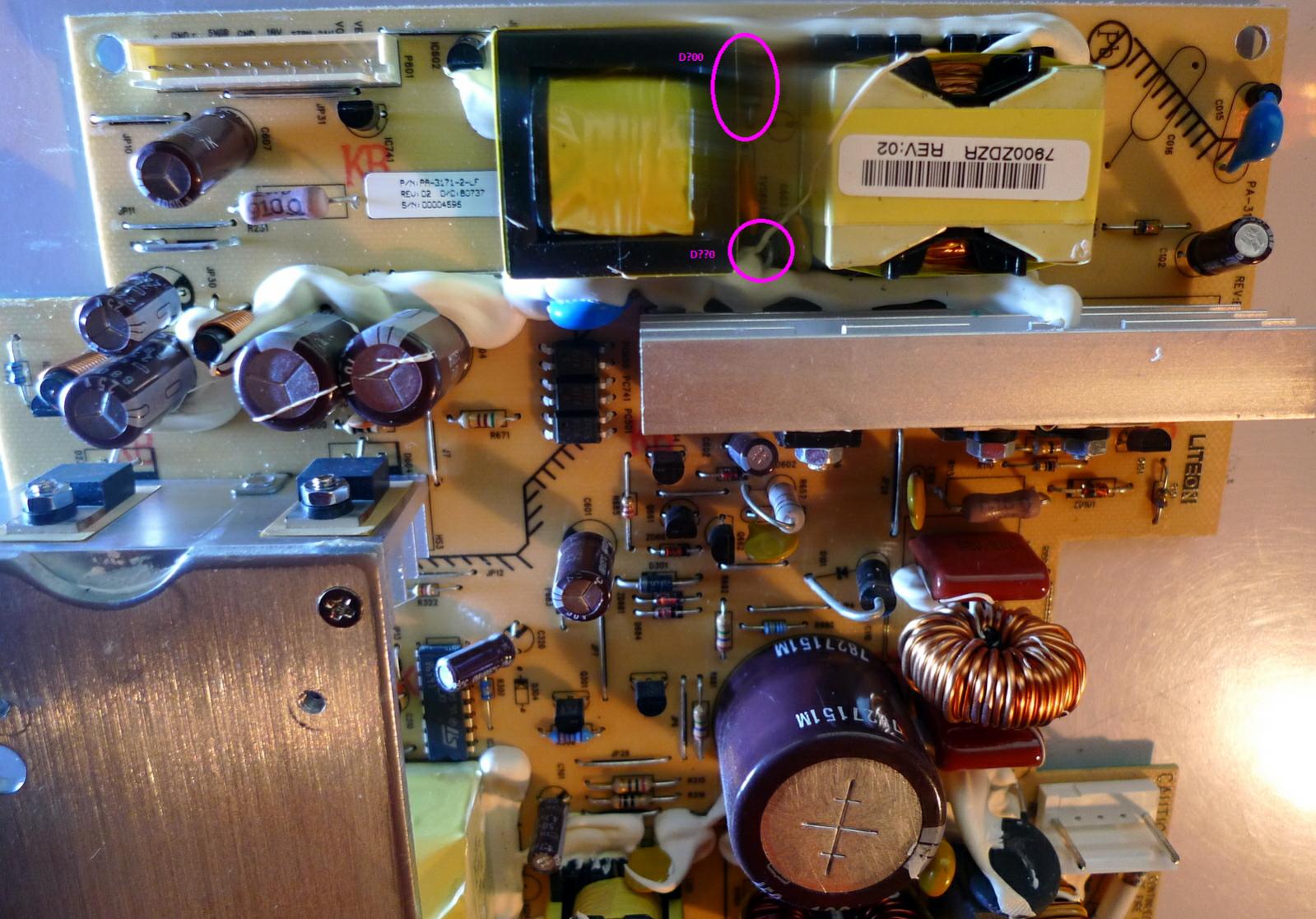

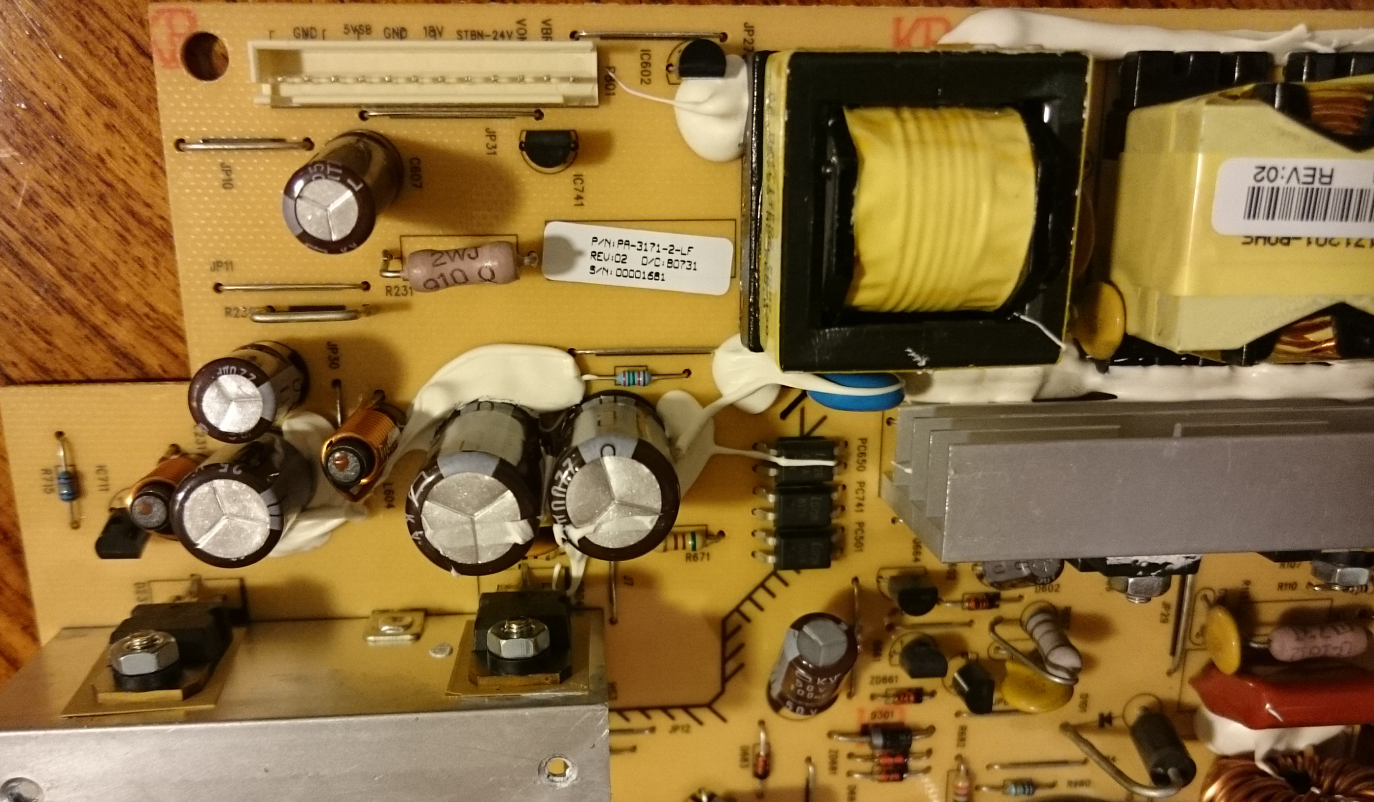

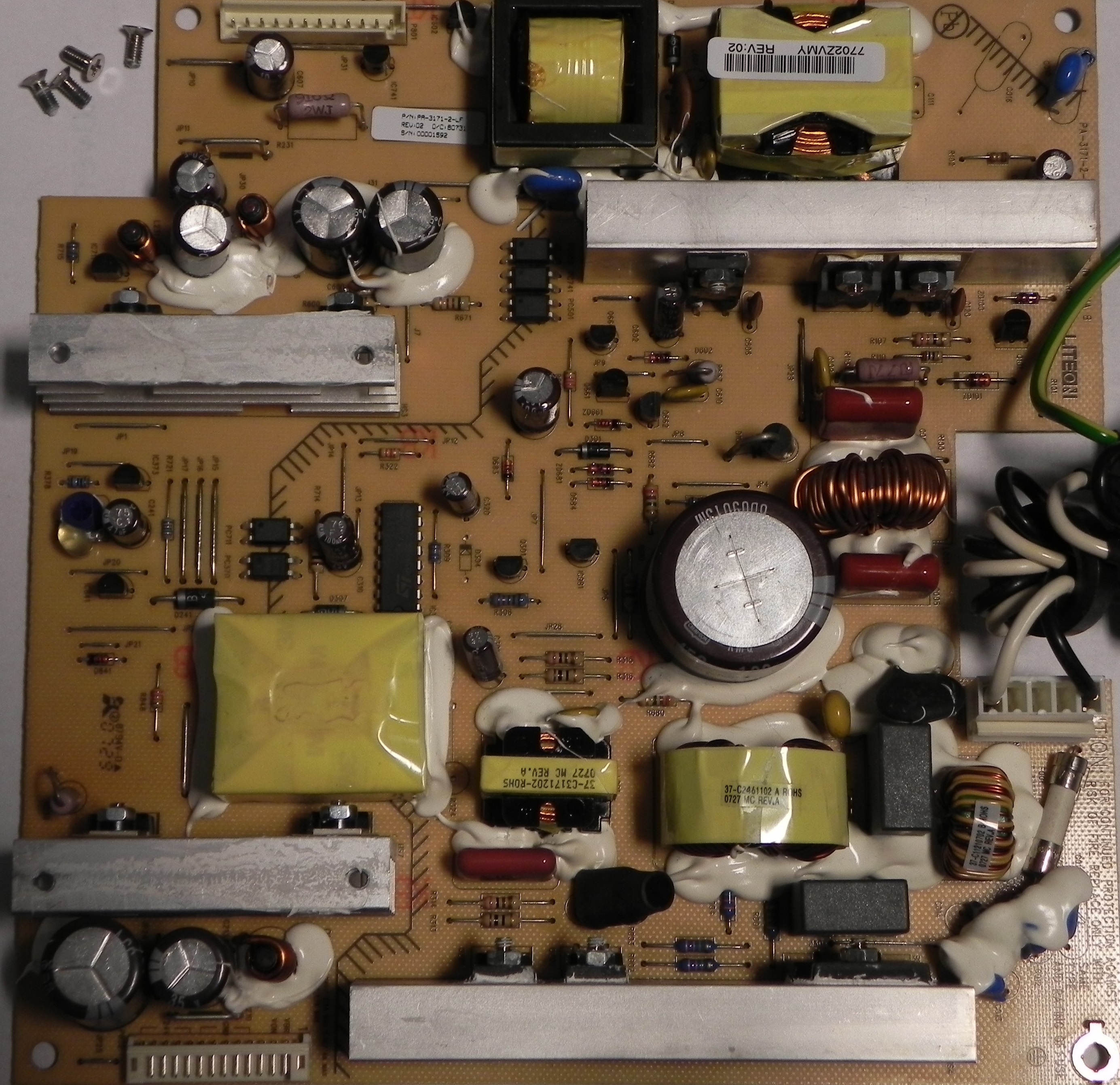

    salvaged one of these monitors from being trashed as I thought it would be a real shame since it is quite an expensive screen.
    After some googleing I found this thread by freddyfena, and it turned out it was almost the same problem: Computer detects the screen and the USB hub is working, but the screen itself doesn't work (and the front LED is orange).
    I followed the instructions in that thread as far as it went, and unfortunately got stuck as my problem deviated more and more from his.
    I have som basic knowlegde with troubleshooting (though I'm completely blanc on ICs) and soldering, but I don't actually know that much about semi advanced electronics, so please bear with me if I'm asking what a seemingly obvious abbreviation stands for.
    All of the images posted here are from the thread link to above for clarification (and I don't have a decent camera with me ...).
    _________________________________________________________________
    All testing was done with everything assembled outside the box (except the screen itself) with the screen turned on (ie. not standby).
    PSU type/no.: Liteon PA-3171-2-LF Rev:B
    Country/Mains: Norway/230 V
    Outputs:
    VBR: 3.31 V
    VON: 0 V
    24 V: 0 V <-> 5.1 V (2 s. interval)
    18 V: 2.31 V <-> 17.85 V (2 s. interval)
    5 V: 5.27 V

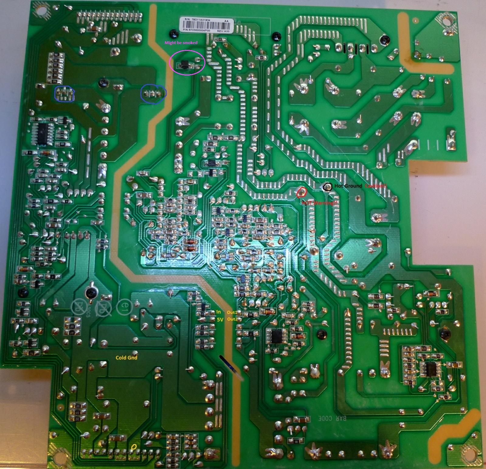

    Test of points marked by PlainBill (see image):
    PC 501:
    In: 0.1 V <-> 5.2 V (2 s. interval)
    5 V: 1.2 V <-> 5.2 V (2 s. interval)
    Out1: 0 V
    Out2: 0.1 V <-> 21.3 V (2 s. interval)
    Large Cap: 373 V <-> 399 V
    Test of L6598 (possibly defective, how do I check this?):
    Pin #:
    01: 0 V <-> 5 V (2 s. interval)
    02: 0 V <-> 1.9 V (2 s. interval)
    03: 0 V <-> 0.3 V <-> 2.5 V (1 s. interval between each step up/down)
    04: 0 V <-> 1.7 V (1 s. interval)
    05: 0 V <-> 0.9 V (1 s. interval)
    06: 0 V <-> 3.9 V (2 s. interval)
    07: 0 V
    08: 0 V <-> 0.27 V (2 s. interval)
    09: 0 V
    10: 0 V
    11: 0 V <-> 4.46 V (2 s. interval)
    12: 0.5 V <-> 12.3 V (2 s. interval)
    13: -- (NC)
    14: 0.3 V <-> 112.6 V (2 s. interval)
    15: 0.3 V <-> 113.2 V (2 s. interval)
    16: 0.8 V <-> 113.3 V (2 s. interval)
    Test of the two dual diodes:
    #1: 406 Ohm #2: 400 Ohm
    Diode test:
    ZD100: 0.729 V / 2.057 V
    ZD101: --- (Short Circuted)
    ZD661: 0.722 V / --
    ZD681: 0.717 V / --
    D101: 0.395 V
    D241: 0.471 V
    D301: 0.203 V
    D307: 0.474 V
    D602: 0.601 V
    D683: 0.601 V
    D684: 0.600 V
    D841: 0.600 V
    D?00: 0.472 V
    D??0: 0.471 V
    I have not tested the transistors as of yet.

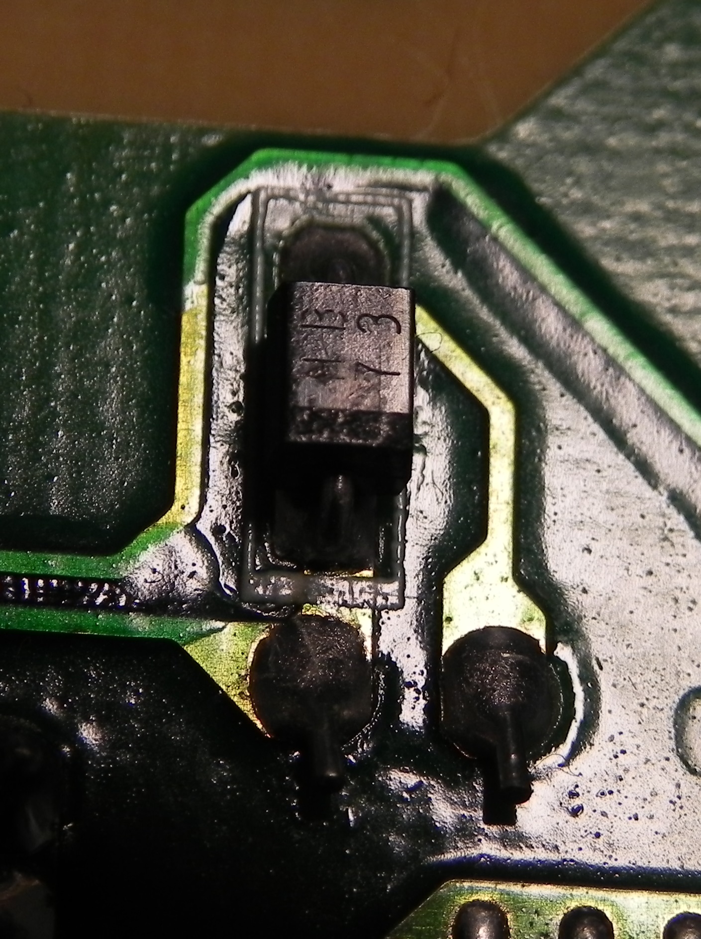

    The black cube (text too small to see) marked at the top might be smoked. Does anyone know what this component does?
    Any thoughts about this matter will be very much appreciated!

    Fluctuating voltages on the power supply like your 24V and 18V suggest the SMPS is trying to start, but cannot because something is shorted and dragging it down.
    One thing that can cause the fluctuations is a shorted diode. If you measured ZD101 and found it shorted, remove it and test it out of circuit to verify it is shorted.
    PS. Diode measurements usually have 2 readings. Report both and don't assume we know the other reading is "out of range".

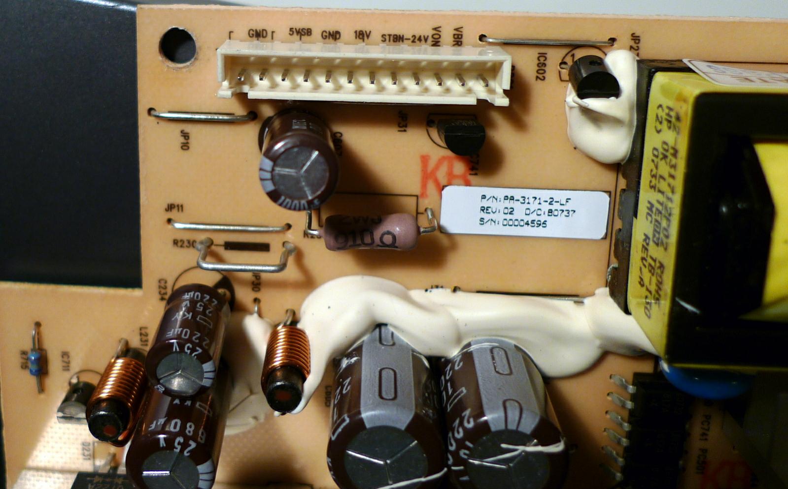

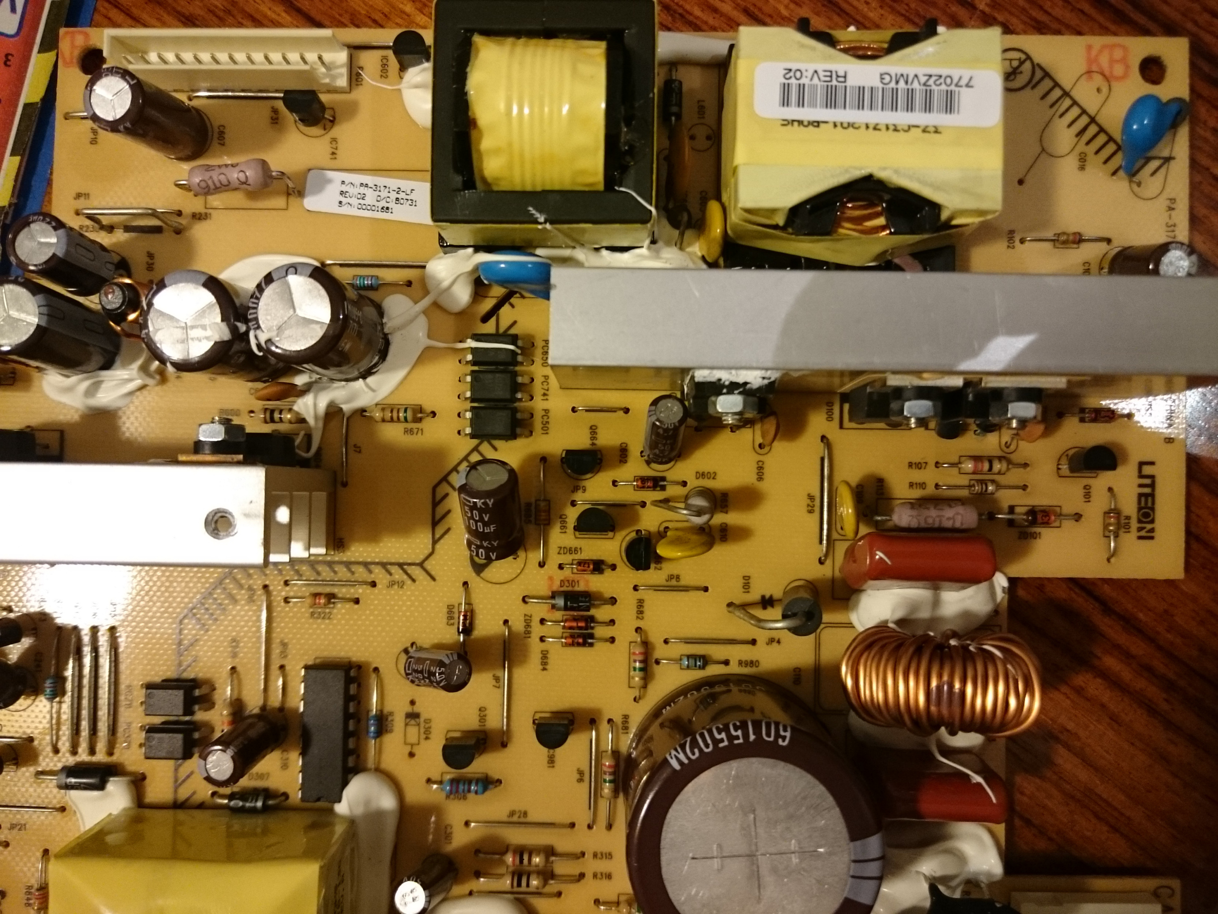

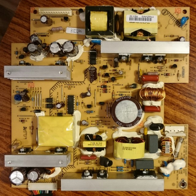

      Under are finally some pictures of my board. (Not that it is much different from freddyfenas ...)

        Don't know until you report both measurements. Diodes usually fail shorted. If it reads 0.2V both ways, desolder and verify out of circuit.

          I finally got around to make some new measurements:
          In circuit:
          Zener diodes:
          ZD100: 0.717/2.496 V
          ZD101: 0/0 V
          ZD661: 0.709/2.608 V
          ZD681: 0.706/--- V
          Normal diodes:
          D101: 0.380/--- V
          D241: 0.461/1.546 V
          D301: 0.194/--- V
          D307: 0.463/--- V
          D602: 0.586/--- V
          D683: 0.588/--- V
          D684: 0.587/--- V
          D841: 0.589/--- V
          D?00: 0.459/2.602 V
          D??0: 0.456/--- V
          Double (and possibly other) diodes:
          D100: 0.379/--- V
          D211: 0.340/0.202 V
          D212: 0.340/0.202 V
          D231: 0.086/0.292 V
          D604: 0.092/0.766 V
          Out of circuit:
          ZD101: 0.689 / --- V
          D301: 0.189 / --- V
          Transistors:
          (Measured 1-2,1-3,2-3,3-2,3-1,2-1 (Note that some may have been the othe way around))
          Q100: 0.508 / 0.617 / --- / 1.341 / 0.935 / --- V
          Q101: 1.293 / 0.560 / 0.628 / 2.825 / 2.888 / 0.626 V
          Q201: 0.483 / 0.729 / --- / 1.848 / 1.592 / --- V
          Q202: 0.472 / 0.750 / --- / 1.727 / 1.988 / --- V
          Q301: 0.630 / 0.800 / 2.007 / 0.631 / --- / --- V
          Q601: 0.509 / 0.607 / --- / 2.353 / 2.020 / --- V
          Q661: 0.630 / 0.794 / 2.015 / 0.632 / 2.930 / --- V
          Q662: 1.270 / 0.563 / 0.627 / --- / --- / 0.625 V
          Q664: --- / --- / 0.638 / 2.356 / 0.595 / 0.639 V
          Didn't seem like it was the zener diode ... unfortunately.
          Does this make any sense to any of you?
          Do you think it may be the "central IC"?
          Thanks a lot for any help

              "but the screen itself doesn't work (and the front LED is orange)." That to me is that the main board is not detecting the video signal from the PC, you can have bad inverter section but the main board should still detect the video signal from the PC. There are ID pins on the VGA connector for the PC to detect if the monitor is connected to the PC or not, but for the monitor to detect the PC vidoe signals, the monitor uses one of the either RED/BLUE/GREEN signal of the VGA. What are you using VGA or DVI for the connection?
              You also have 18/24v power supply section that does not work which can be due to bad component. The Zener that read shorted can be the one that is connected in parallel to the MOSFET's Source resistor (<1 Ohm).

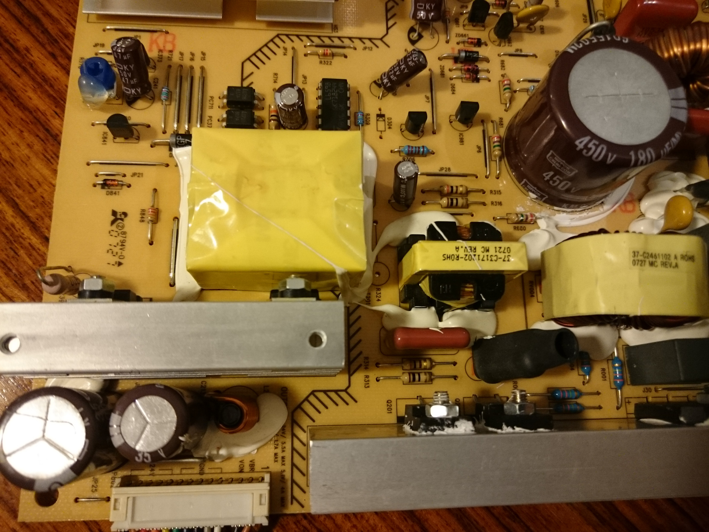

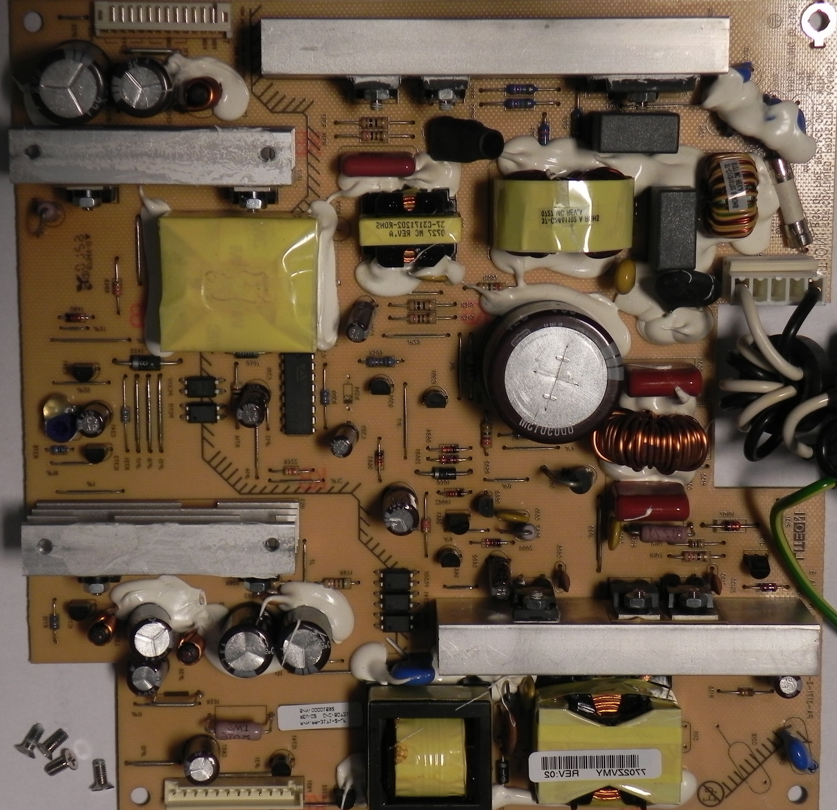

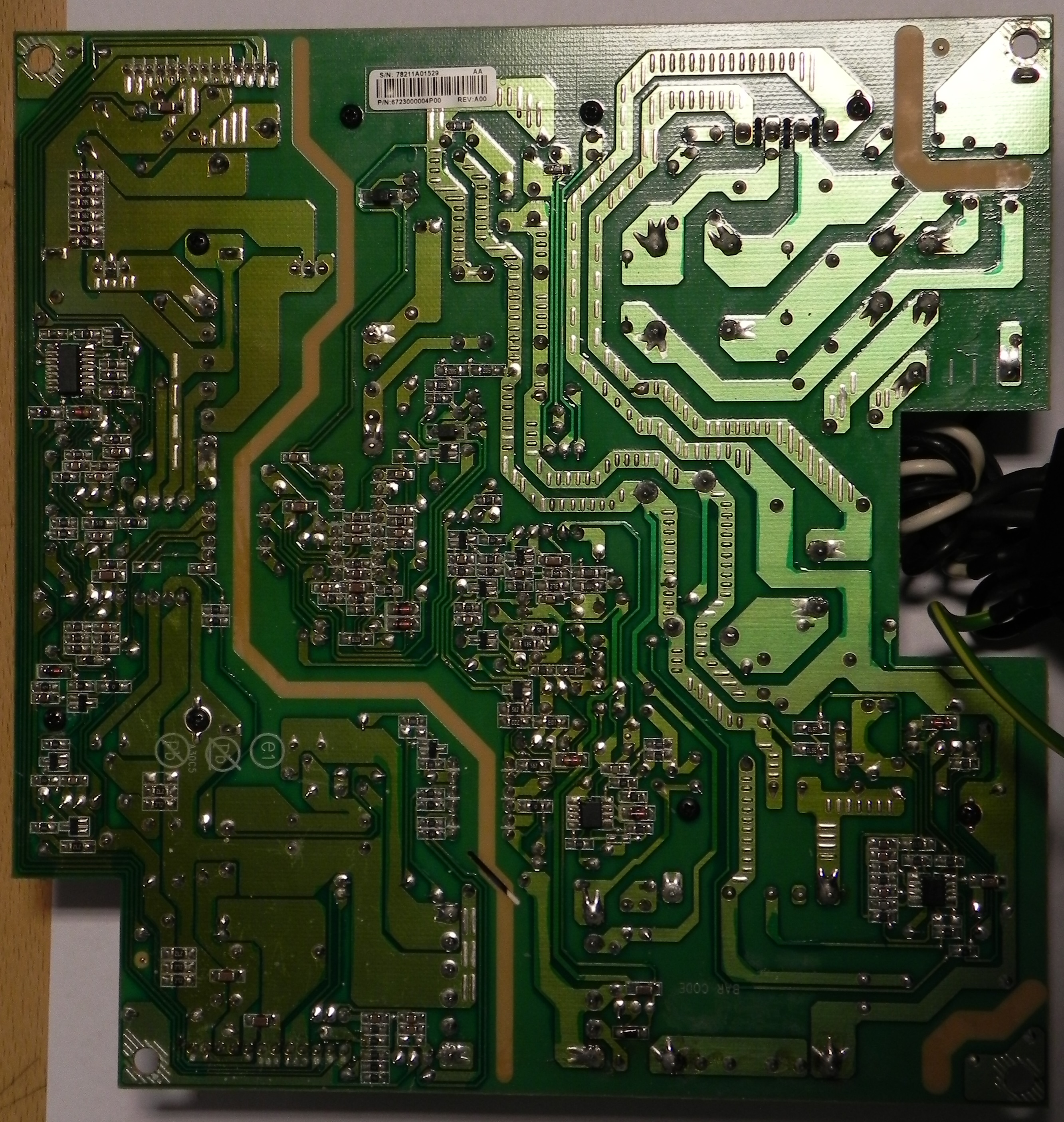

              Can I see good clear pictures of both sides of the board in 1/4 section so I can trace out the connections and be able to read the part designators?
                  Working on a big picture, will post it, but will probably choose another host since it will be huge, and I like the possibility of scrolling over having a lot of small chunks ...

                    ZD101 is good, as tested out of circuit. The reading you are getting in circuit however indicates a short. Check all parts connected to ZD101 and you'll likely find something burnt.

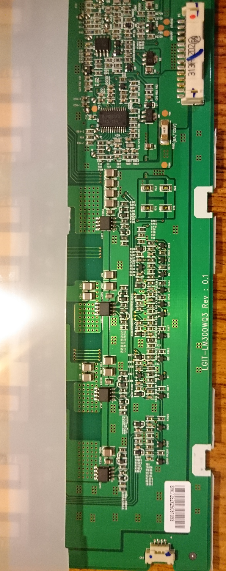

                            As it happens i ended up with just the same monitor as above which shows a somewhat similar behaviour. The control board tries switching on the main power supply again and again. However when I checked the output voltages, they all show up as far as i can tell. The 18V on the control board side and the 24V on the backlight-inverter side.

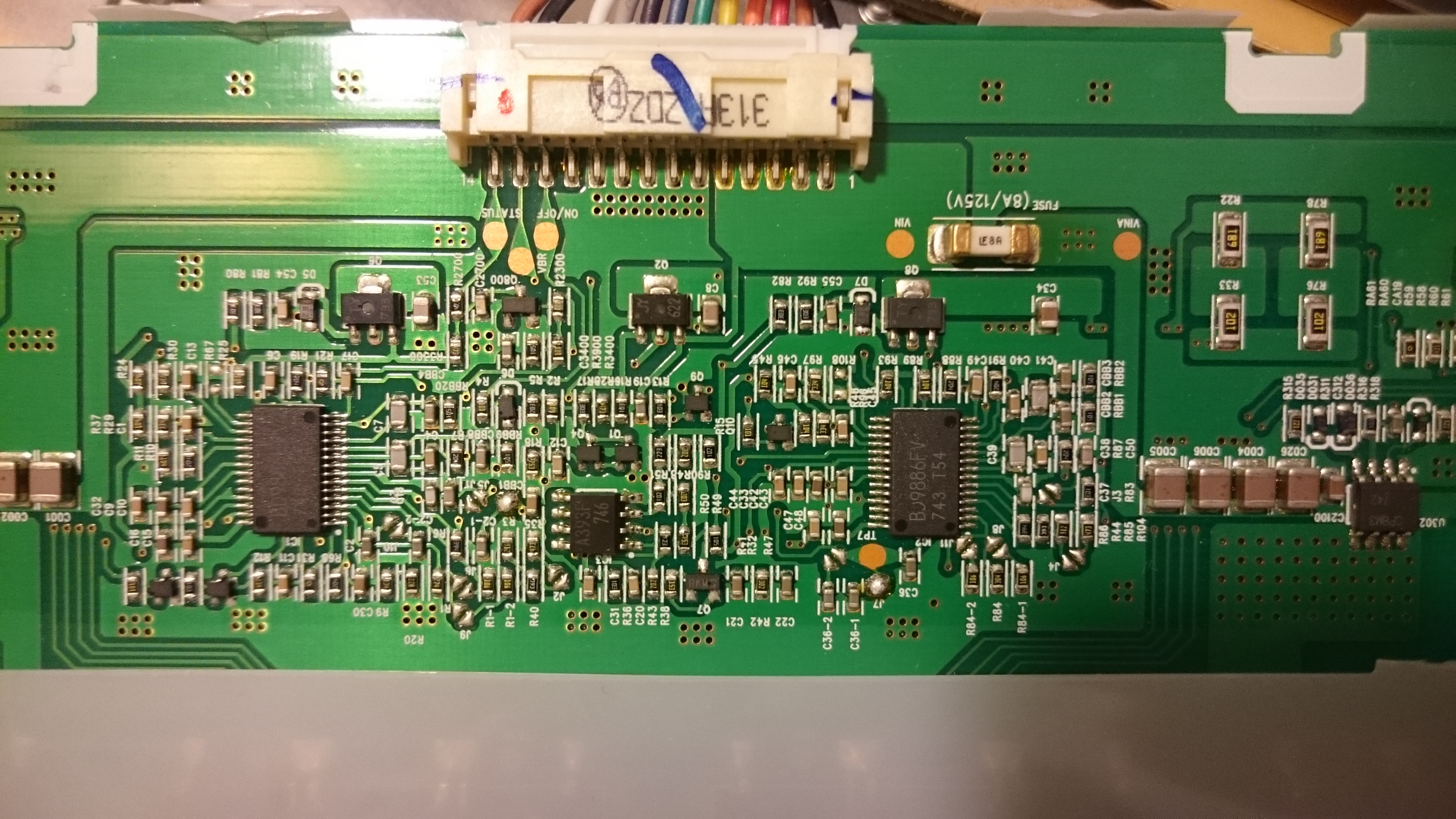

                            Since my display is making a regular ticking sound when the supply is being switched on i also looked into that. It turns out to be the board controlling the TFT area. So i guess the sound is just a symptom and not a cause.(?)
                            Since the voltages seem to be good on first sight, i was wondering: How is the control board deciding about "power good" / "power bad". The only way i see at the moment is that, the control board looks at the 18V from the power supply going up when it enables the supply. If that is the case, could it be that the power supply is taking too long to get to the full 18V?
                            I just have a digital multimeter but i might get a scope from a colleague and take a closer look at what is going on during those 2s enable-intervals.
                            Also: Would anyone advise against that i try to "manually" switch on the power supply by disconnecting it from the rest, hooking it up to 230VAC and putting 5V to the STBN-24V signal for further diagnosis?

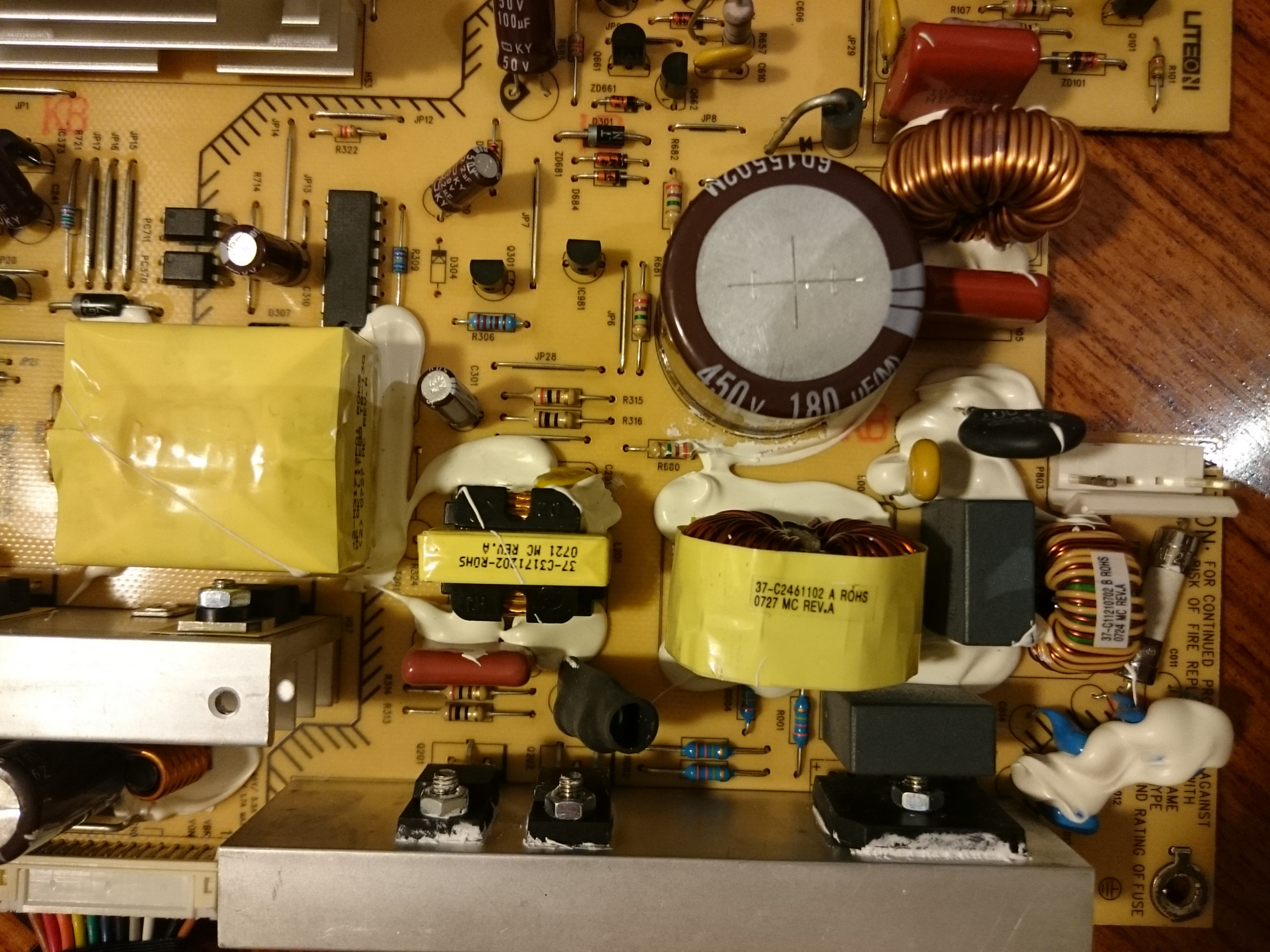

                              I looked around ZD101 a bit and the reason for MrYfe readings ("shorted") is a parallel resistor of 0.16 Ohms to ZD101. When taking the resistor out the gate of the mosfet (20N60C3) is open and the T-E legs show 0.46V in one direction and open in the other, which does not look bad to me.
                              Since this is a forum with caps in the title and the top of that large 180uF was not indented as the others i took it out and checked. It shows 158uF on my DMM which is a ~10% loss. Should i try to fix that?

                                Can you post good clear pictures of your boards using manage attachments
                                Does the back light flash on at all?

                                  Here are some pictures of the backlight inverter.
                                  From left to right:
                                  1) location of backlight inverter board and its high voltage cabling
                                  2) overview shot of the lower half of the board including the connector to the PSU at the top of the image (circuits are copy pasted so this kind of represents the whole inverter)
                                  3) shot of the center section of the board

                                    Now on to the main&standby power supply.
                                    From left to right:
                                    1) Overview of the whole board
                                    2) control board side
                                    3) inverter board side
                                    4) closeup of the lower hot section with power-line connector
                                    5) closeup of the upper hot section
                                    For completeness here are links to the images of the backside (thanks freddyfena)
                                    https://www.badcaps.net/forum/attach...1&d=1299451316
                                    https://www.badcaps.net/forum/attach...2&d=1299451316
                                        Sorry, i almost forgot. No it does not. I think the inverter is not being switched on before the control board decides that the main power looks good.
