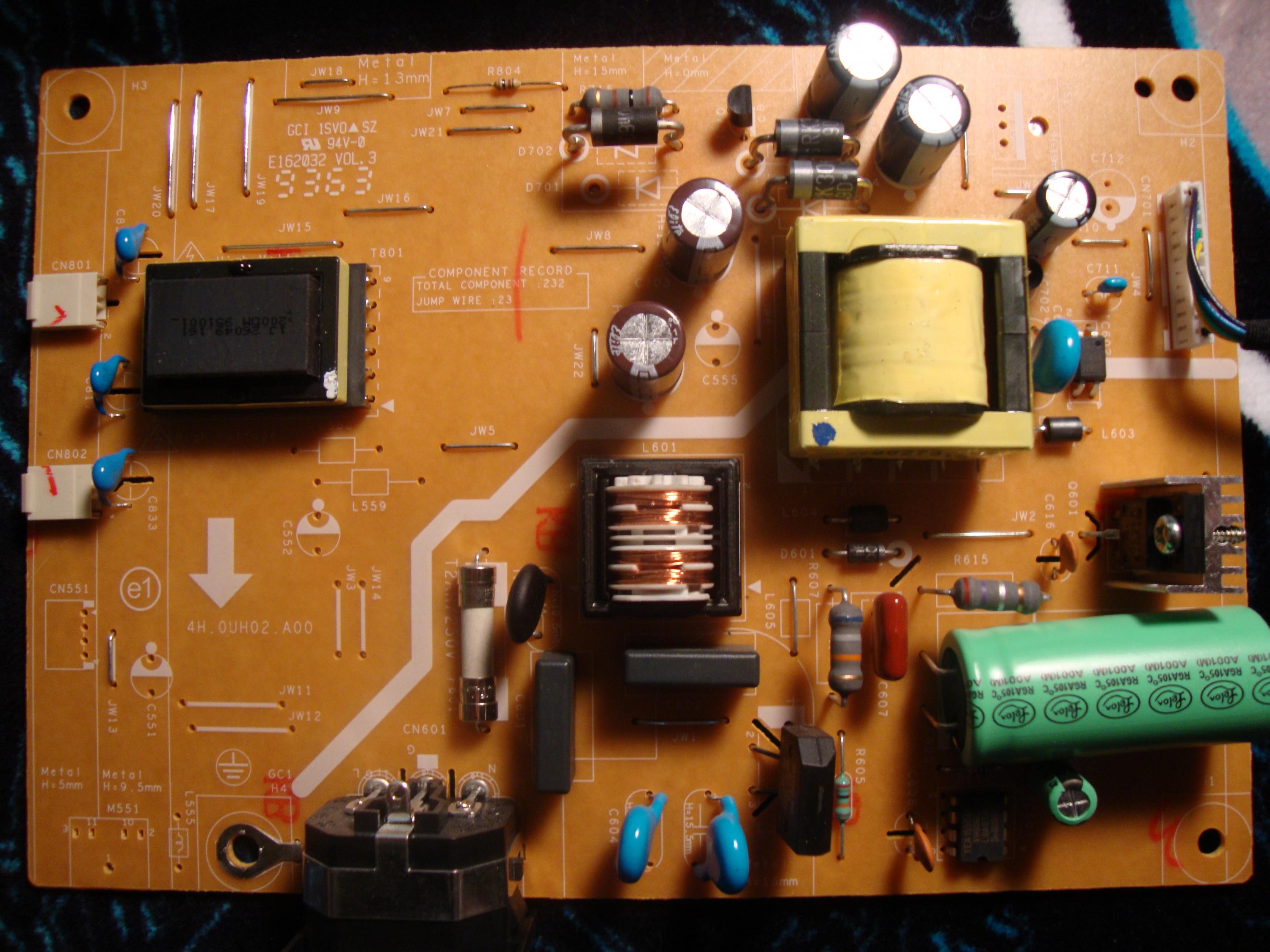

    So as the title describes I have an ASUS VH242H 24" monitor that has begun to flicker. The initial power up shows a crisp picture and looks fine. After a few minutes you begin to notice the screen flickering, almost looks like horizontal waves scrolling down the screen. It doesn't transform the entire image to white though, it seems like only the dark content of the screen flickers to white. (maybe it's just more noticeable in the dark places because of the color contrast). Its worst in the top left corner of the screen, and almost unnoticeable on the opposite end of the monitor. As the set continues to stay on it grows worse and worse. I pulled it apart looking for bad caps or corrosion on any of my ribbon cables and haven't seen anything visually to suggest a problem. I was wondering if anyone has any suggestions on where to start looking. Currently my multimeter is dead (needs new batteries). Once I pick those up I'll start testing but even then I feel like I'm shooting in the dark, without any real idea what could be causing the problem. Any help would be appreciated.

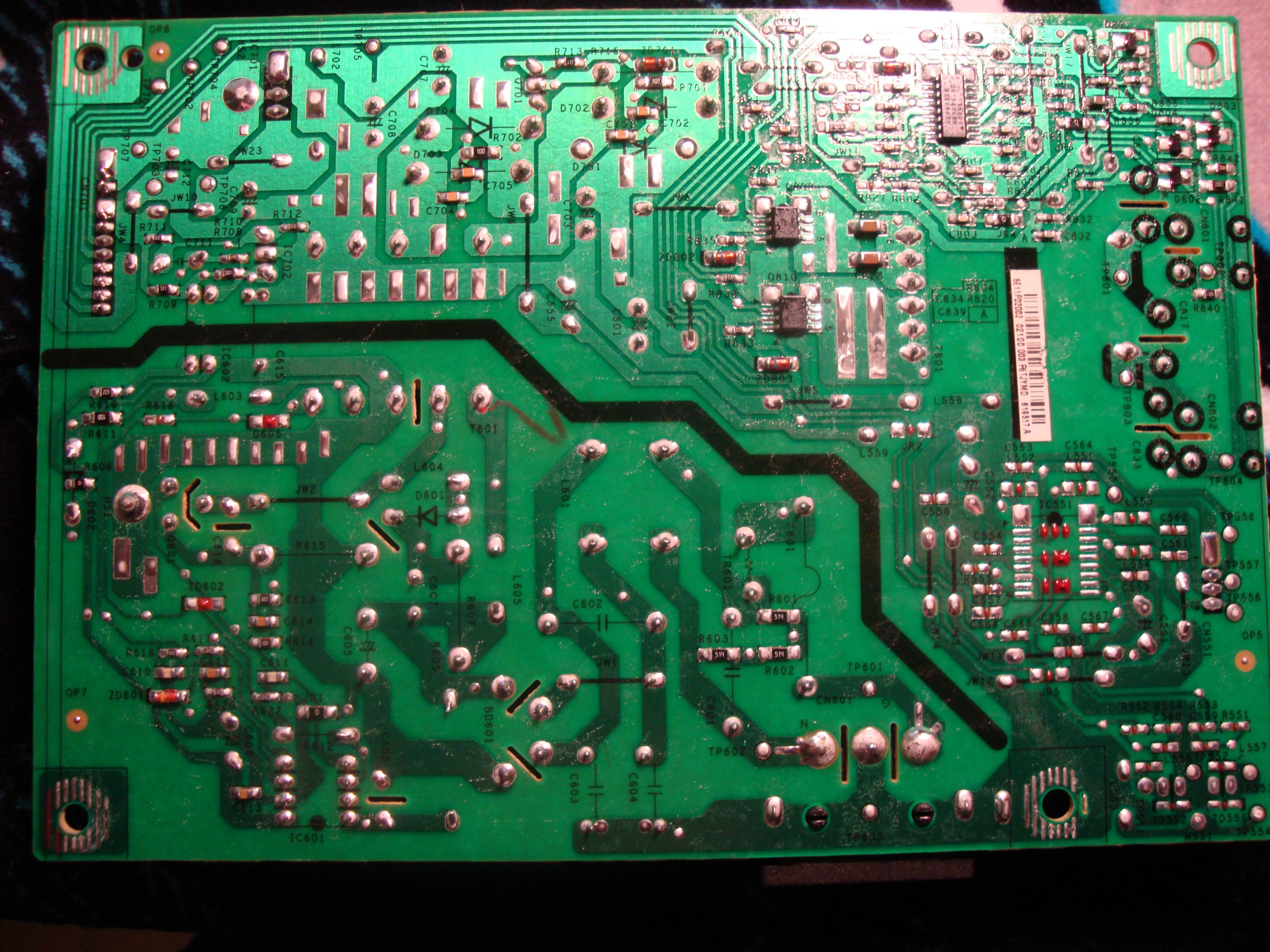

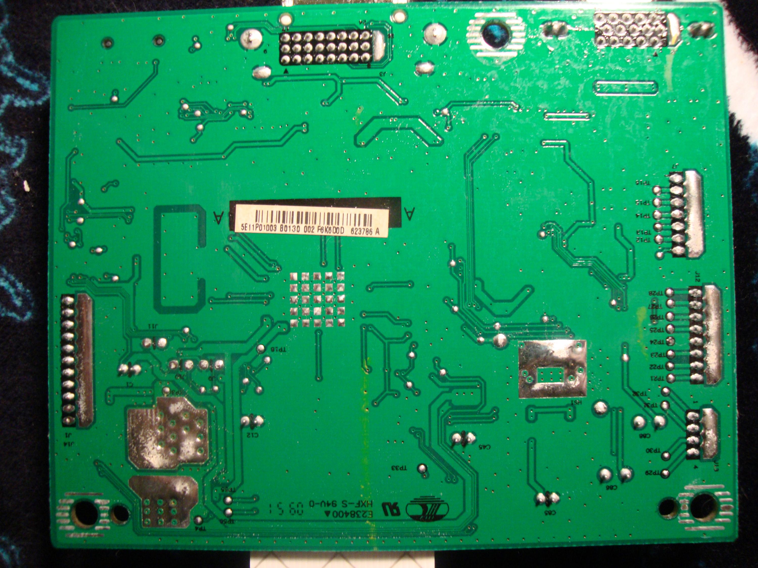

    We can help a lot more if you please post good clear pictures of the whole chassis, and then pictures of each board, front and back (in the same orientation) and close up of connectors, (max resolution 2000x2000 and 2MB) using the manage attachments button, which is found by clicking "go advanced" under quick reply.

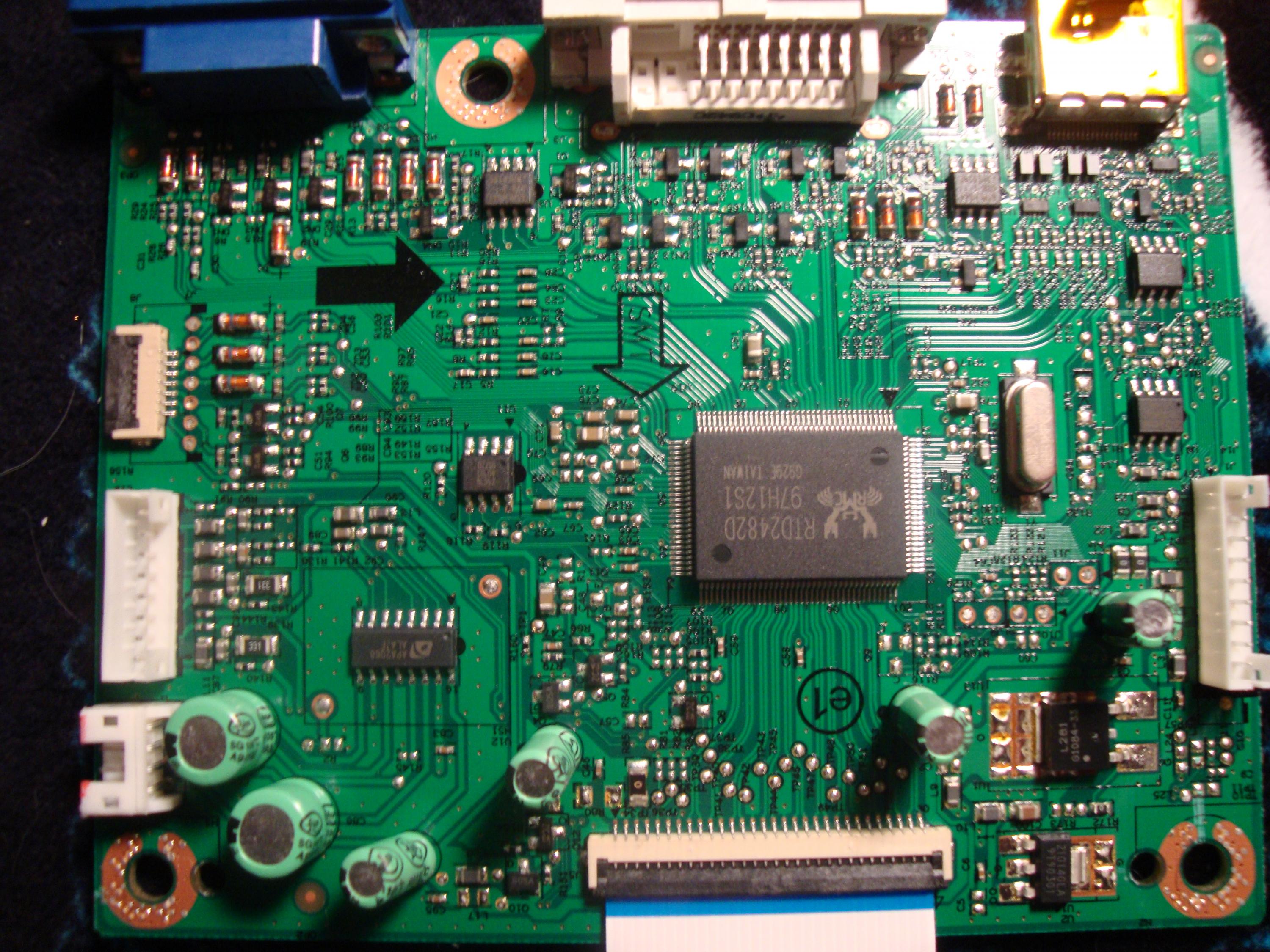

        I know some of these are sloppy.. but it's the best I can do with my bad camera and shaky hands. Let me know if you need a close up of anything in particular.

          So I put the boards back into the monitor and fired it back up to try to troubleshoot a little. The screen only flickers on the dark colors, I can see no problems when I change it to a pure white background. If I have a black background it will flicker a white color, and then if I right click to bring up a menu, everything directly above and below the menu will look fine, while the flicker/distortion happens all around the vertical stripe where ever the menu is.

            That definitely sounds like a mainboard issue. But. You can check the voltages at the connector from the power board to the mainboard. I'm betting they are just fine.
            I think the issue is with the mainboard. You want to check the voltage regulators and the caps first.
            Retiredcaps has an excellent guide on how to check voltage regulators on the mainboard. https://www.badcaps.net/forum/showthread.php?t=22231

              So I'm not sure the format of how this is supposed to be listed, but testing the voltage regulators on the mainboard I came out with this:
              regulator markings:
              L281 ------- Line 1
              G1084-33 - Line 2
              Pin 1: 0
              Pin 2: 3.29
              Pin 3: 4.94
              Regulator markings:
              210140LA -- Line 1
              9T9030K --- Line 2
              Pin 1: 3.29
              Pin 2: 0
              Pin 3: 1.19
              From what I understand the first one is a fixed regulator and seems to be operating correctly. The second one however is interesting... I can't figure out what the part number would be, or what the correct readings should be for this part.
              If you look at the photo I posted above, the first regulator is the one on top with the middle tab not connected into the circuit.
