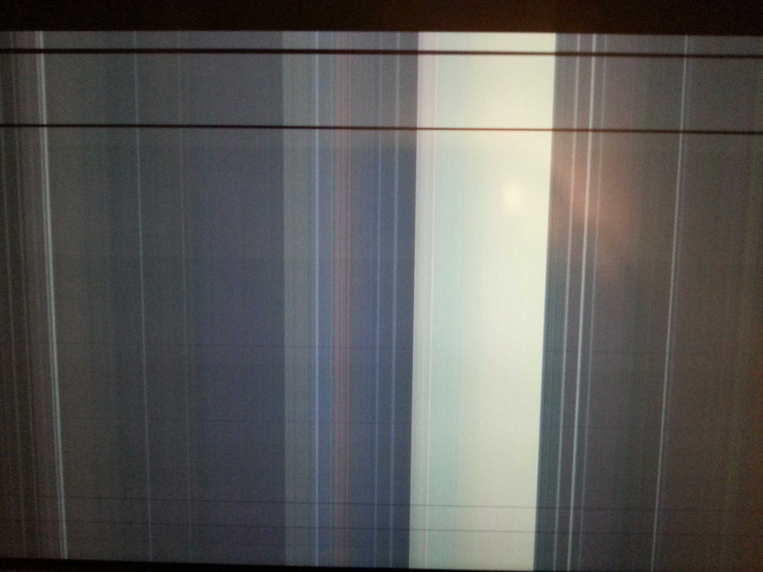

    I have a HP LP3065 30" monitor that is broken.
    I have tried looking around for other threads with a soltion for this for a while now but have not been able to find one.
    Whenever I turn it on it just starts flickering like crazy and I sometimes hear a high pitch noise. When it first started to happen it would only flicker whenever it had been turned of for a long period of time, but now it is constantly flickering (or making random patterns that changes depending on what the computer is trying to display).
    I have opened it up and looked at all of the PCB's inside the moitor for obvious signs of damage, but with no luck. All the capacitors on the PSU appears to be in good condition.
    I have some experience with electronics so I am not afraid to do some troubleshooting, but I just have no idea where to start. Any help would be greatly appreciated.

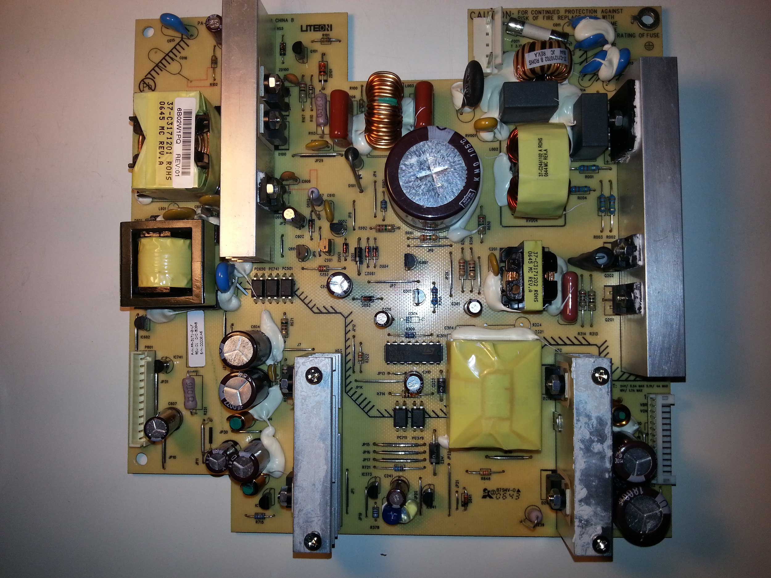

    PSU: Liteon PA-3171-2-LF Rev: 01

            I think K may mean the wire connected to the ccfl where it joint the ccfl sometimes burns away the insulation then it arcs accross to the frame.

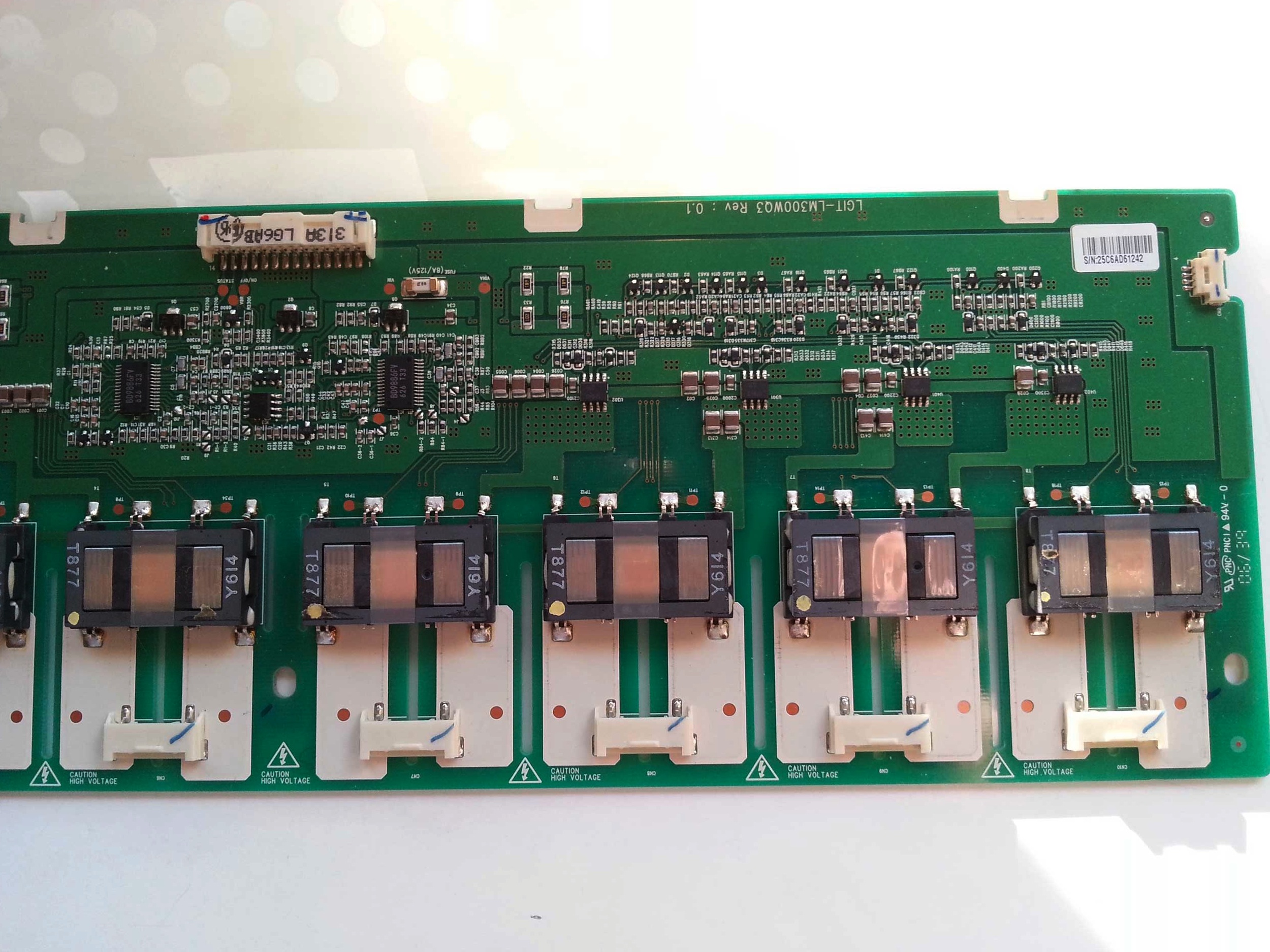

            Reall we will need pictures of the inverter board and the T con. Start with the inverter board it may be eadier to get at.
            If it is currently all connected up first check the cable bewteen the main board and the
            Tcon - take it off CAREFULLY and reseat. Then try it again

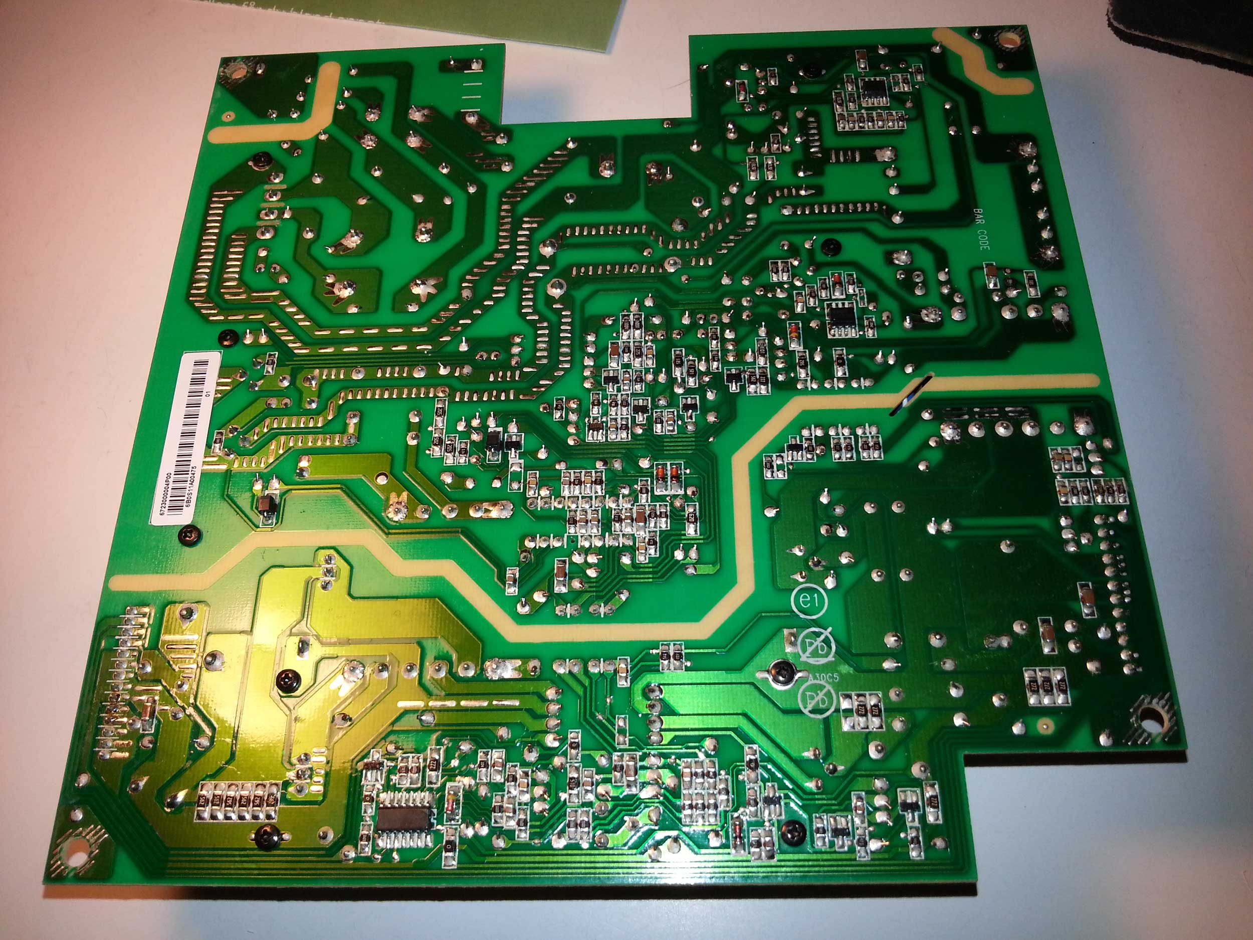

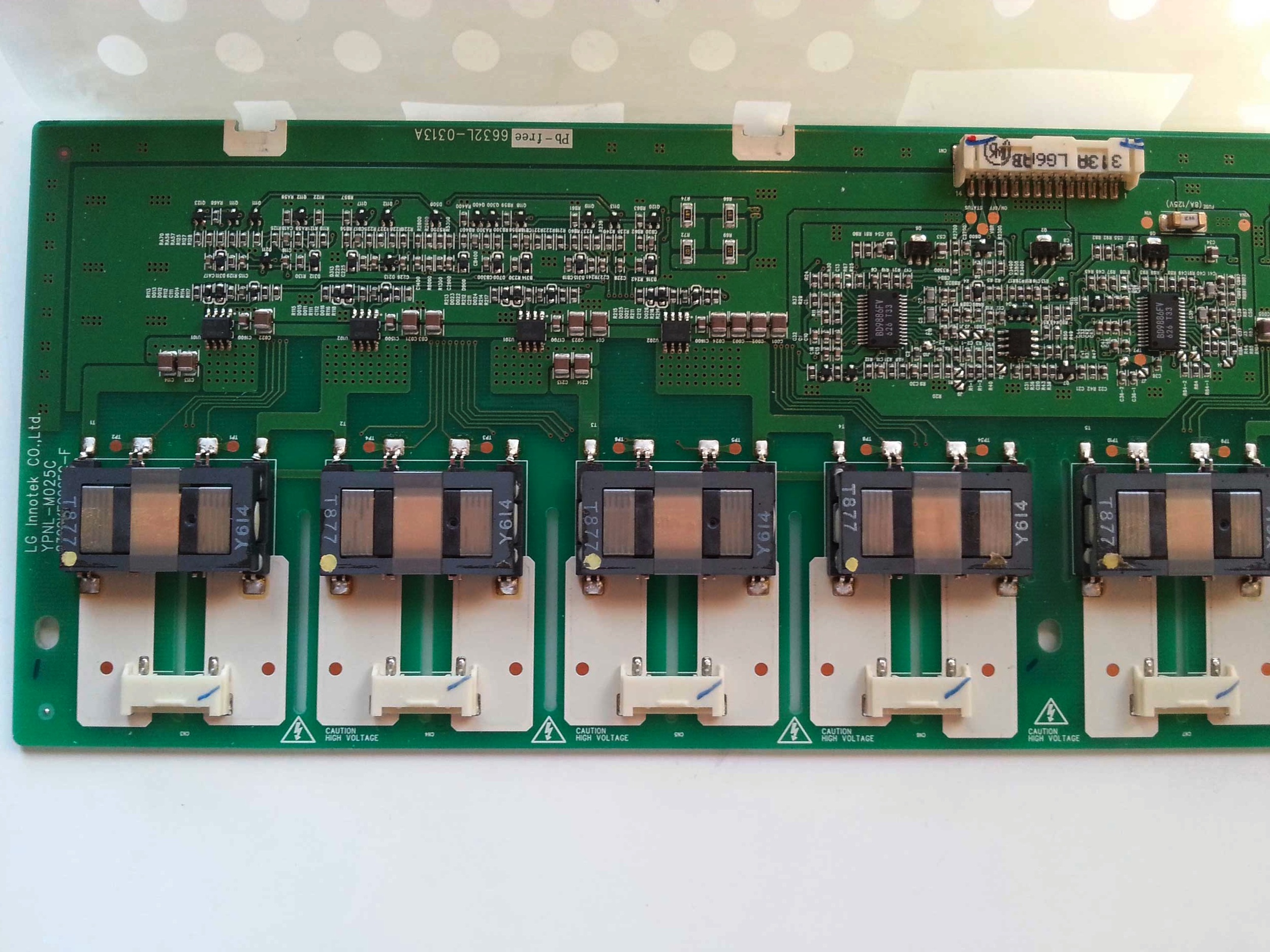

              Ok, So if I were to check for a burt isolation at the ccfl would I have to take apart the whole panel?
              I have tried to disconnect the cable bewteen the main board and the
              T-con board before with no result. I have taken some photos of the inverter board that I will attach below. If you need photos of the T-con then I can upload some also, but that board is a pain to get out.

                Hi - ok so no capacitors on the inverter so Tcon would be next.
                Ccfls It depends on the type of panel - this size- probably yes you will have to take apart BUT sometimes you can see the ends of the tubes and the wiring.
                IF you can wire it all up when the panel is out of the frame you can sometimes tell if a bulb is gone.
                What you could do while its in it present state is to test each bulb one at a time to see if one flickers - its hard to tell as I dont think they will stay on long enough. Another idea would be to make up a couple of spare test lamps and see if when using them the flickering stops.

                  Re: HP LP3065 Not working (Flicker, noise, patterns)
                  The screen shot on the first post shows bad looking screen which can be due to poor power supply, bad T-CON, etc.
                  The flickering on the screen, is the lamp flickering or the T-CON is flickering (T-CON is going on and off)?
                  You may have multiple problems.
                  To find out if the backlights are flickering or not, disconnect the LVDS cable to the sceen, then look at the screen in dark room to see if the backlights are flickering or not.
                          Bad lamps will not cause all those lines on the screen, but did you disconnect the LVDS cable and see if the backlights are on steady as I suggested.
                          There are lots of caps on the T-CON board, not the canned type that you see on the power supply board.
