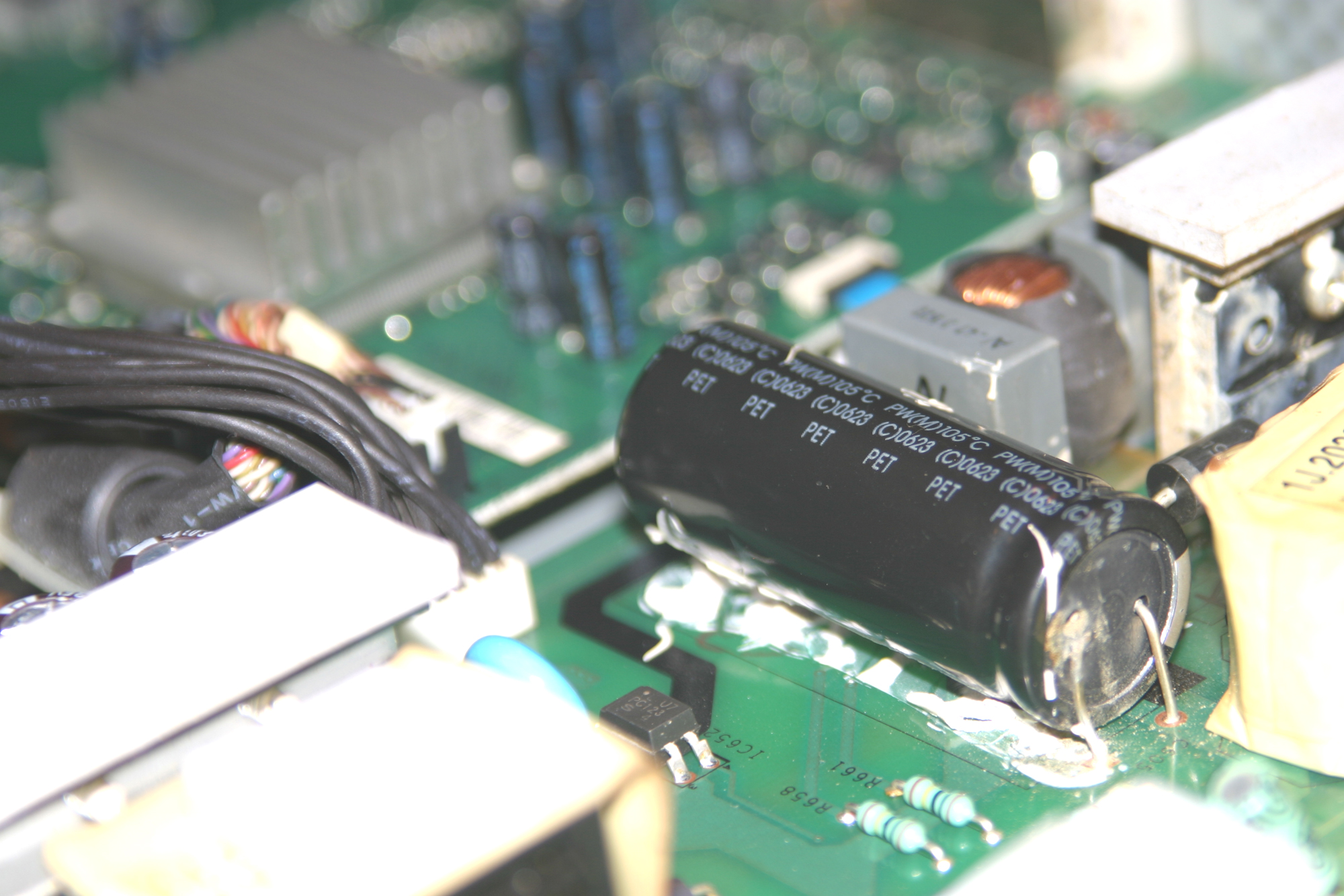

    Been reading a LOT on this forum, and its amazing. I have learned so much.. (and I'm a tech!)
    Anyway, I have this 5 year old BenQ 24 inch.. was using the PC and I hear a sizzling sound, then POP! Won't power up at all.
    Open the back, looked at all the caps--no bulges (but that doesn't mean much).. BUT, I find on the power supply board that the one big cap (the Elite 450 / 120μF)
    I can visually see the acid (brown rust looking stuff) trying to ooze out. The board didn't have any on it thank god.. every thing looked fine..
    Looks a LOT like this image:
    http://i1188.photobucket.com/albums/...10603-1828.jpg
    It's about 2 inches long.. 1/2 inch thick.. big one.
    Other text on it is:
    Elite 450 / 120μF
    PW (M) 105c
    (C)0623
    and PET is repeated along the side of the cap...
    The "POP" was probably the fuse, right?
    It's a 'white' ceramic fuse--hate that-- info is T4AH (and or TR601) / 250V
    I have a volt meter, but what settings should I use to check the fuse? 250 volts..? I am totally new to caps and this stuff.. I can build a PC blind folded, and have fixed a PS3 with the no clean flux re-flow, but this is beyond me, and I need help. You guys are amazing, and I thank you for this forum, and its members.
    I'm just in love with this BenQ.. its the old 16:10.. (I bought a new BenQ, but Its a 16:9) and I really do miss that inch. lol... so If I can get this up and running, I'll be running 3D MAX with 2 monitors..
    or playing Battlefield 3..
    Thank you!! If you need a picture of the cap, I can go open it back up and take some shots.. I have a good DSLR.
    Thanks again!!!

    It might have been a fuse; but it also could be the cap. A capacitor will sometimes sizzle and pop. To check the fuse you want to set your DMM to 200 ohms. Touch the leads together and see what it measures. It should read less than .9 ohm. With power off, touch both ends of the fuse and you should get a very low reading if its good (continuity). No reading, or any reading above say .1 to.9 (depending on how it read when you touched the leads together) would indicate its no good.
    It might just be that big cap, or maybe it took something with it. Some pictures would be nice if you can. Use the "manage attachments" feature and we'll try to get you fixed up good

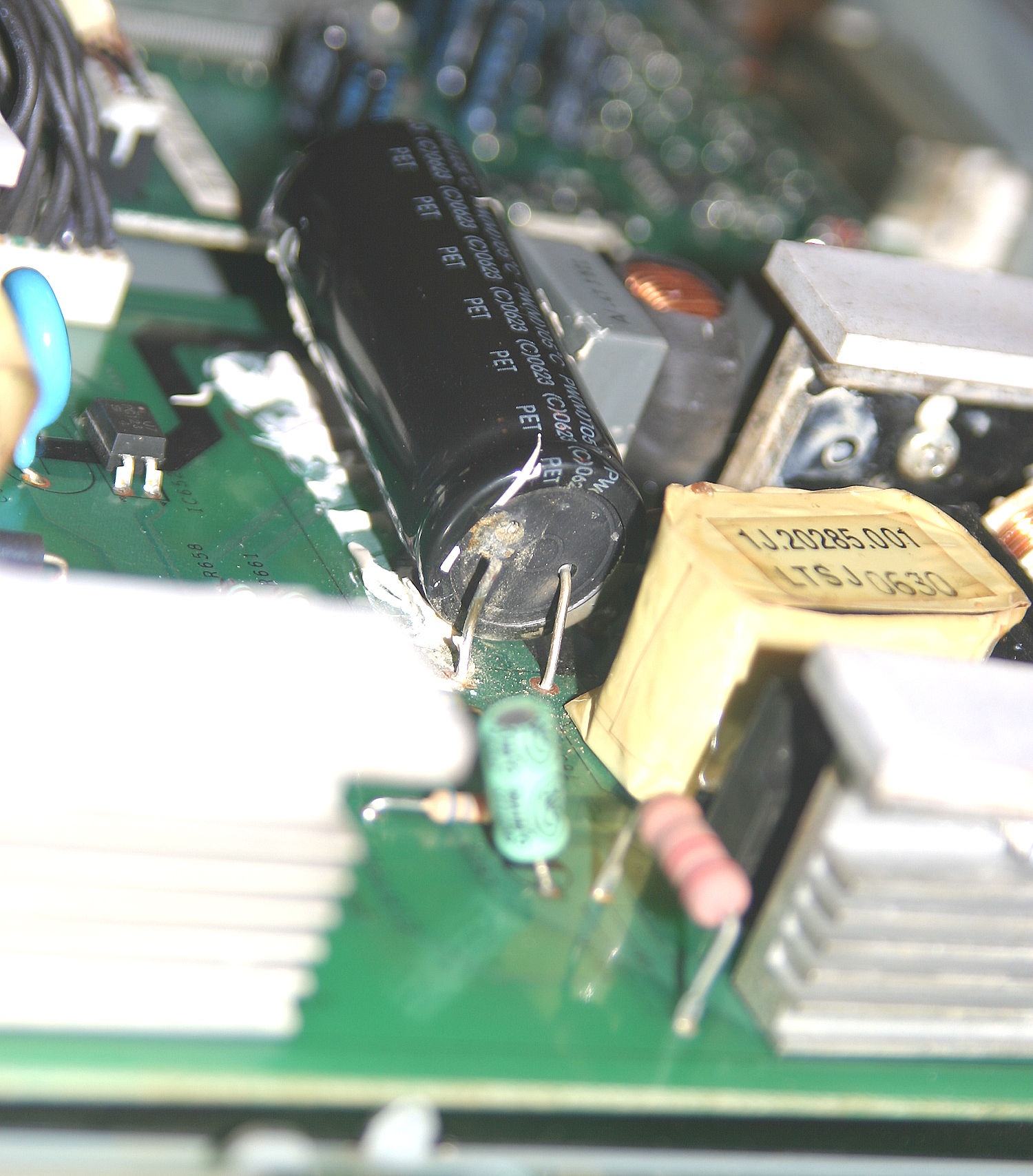

      We can help a lot more if you please post good clear pictures of the whole chassis, and then pictures of each board, front and back (in the same orientation) and close up of connectors, (max resolution 2000x2000 and 2MB) using the manage attachments button, which is found by clicking "go advanced" under quick reply.

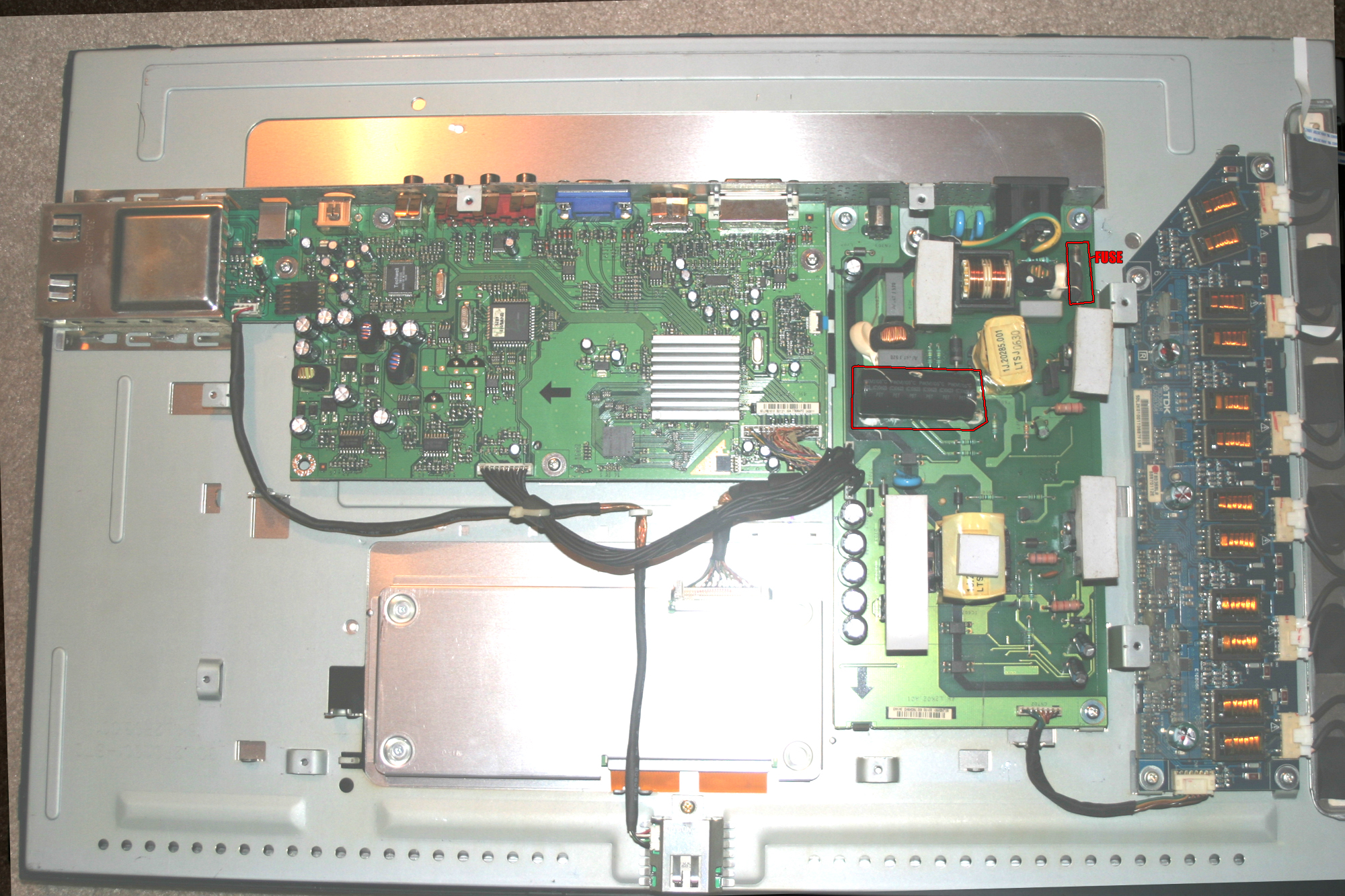

        I took the best shots I could.. I can take more as soon as I get my other camera back from a friend. But the main cap, the 450v was the issue (see the brown stuff--and i moved the prong a bit, and it came off easy. broke off or was already separated from the inside..
        (I scraped some of the white silicone off.. will clean it fully when I replace the cap)
        Looks JUST like the image I saw in the Dell thread, heck the same side of the prong!
        If you know what I need, post the best replacement from Digikey's with what I need to replace that Elite 450 120μF
        PW (M) 105c cap, and that fuse..
        I checked the MM on the fuse, and its dead.. so the cap overloaded? and killed the fuse? or the fuse saw the overload, and was like "whoa.. better stop this NOW, and pop!
        Thank you all, Wish I had a macro lens on the DSLR Canon.

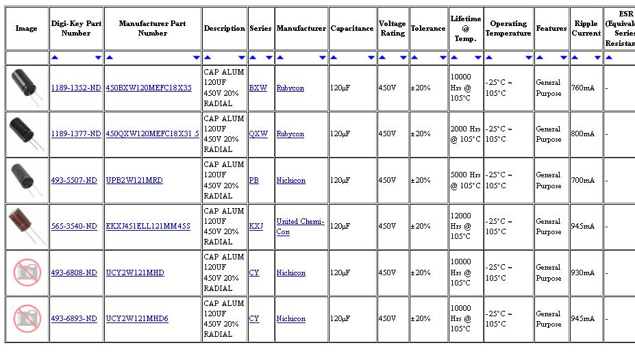

          Ok Cant actually see the fuse properly in the picture Digikey have two
          one is glass the other ceramic you will need to check the physical size and
          get glass or ceramic to match the old one
          Part Nos 507-1252-ND and 507-1213-ND
          The Big Cap there are 6 possibles all are ok you will need to pick one nearest the size you have and correct distance between pins. I think I would go for a higher ripple rating they are a little more expensive, but have longer life.
          Again I cannot tell if any other components are damaged or if caps are swollen.
          Better get 3 or 4 fuses though if it blows again straight away just let us know and you can rig something to save fuses.

            Ok, I ordered the cap, (third one down on the list), and ordered 10 ceramic fuses (as you said, just in case).

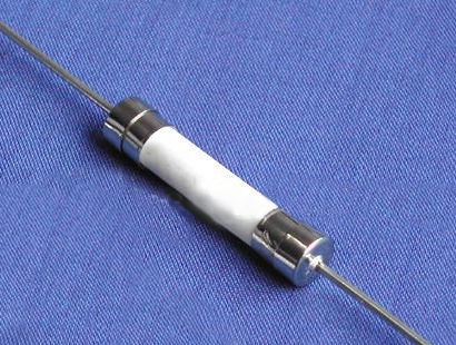

                      BUT... issue with the fuse.. I ordered the digi-key fuse:
                      INFO:
                      P/N 507-1213-ND
                      5HT 4-R
                      FUSE SLOW 250V 4R 5x20
                      Ordered 10 of the ceramic's, it was cheap, so no biggie, but I THOUGHT the two 'end caps' on the fuse were able to bend back. nope, they were apart of the fuse housing I guess.. it LOOKED like the fuse was inside the end caps, and the wires went through the holes to the board.. (I'm a noob at this kinda )
                      So what should I order? Any links? I searched digi-key, but I was lost of all the settings and stuff.
                      At the end of each 'end-cap' were the words 'cono fuse'... if that helps .
                      If you need a pic of the fuse area and fuse, let me know. It broke, but I have the end caps, (I clipped the wires up to the fuse end caps, and tried to solder the leads to the fuse, but it didn't take.. I don't think you can, can you? anyway, one of the leads melted a bit, and need a whole new fuse 'unit' I guess.. lead wires, end-caps and fuse all in one. *sigh*.. I'm learning though, and it's so interesting to learn this stuff.
                      Thanks!!
                      (Found an image of exactly what it looks like below)

                          From the photographs I'd swear that we're looking at the insides of a Dell 2407 - the power supply and inverter boards look identical visually.
                          There's a long thread on the Dell 2407 in these forums, might be worth a look ?
