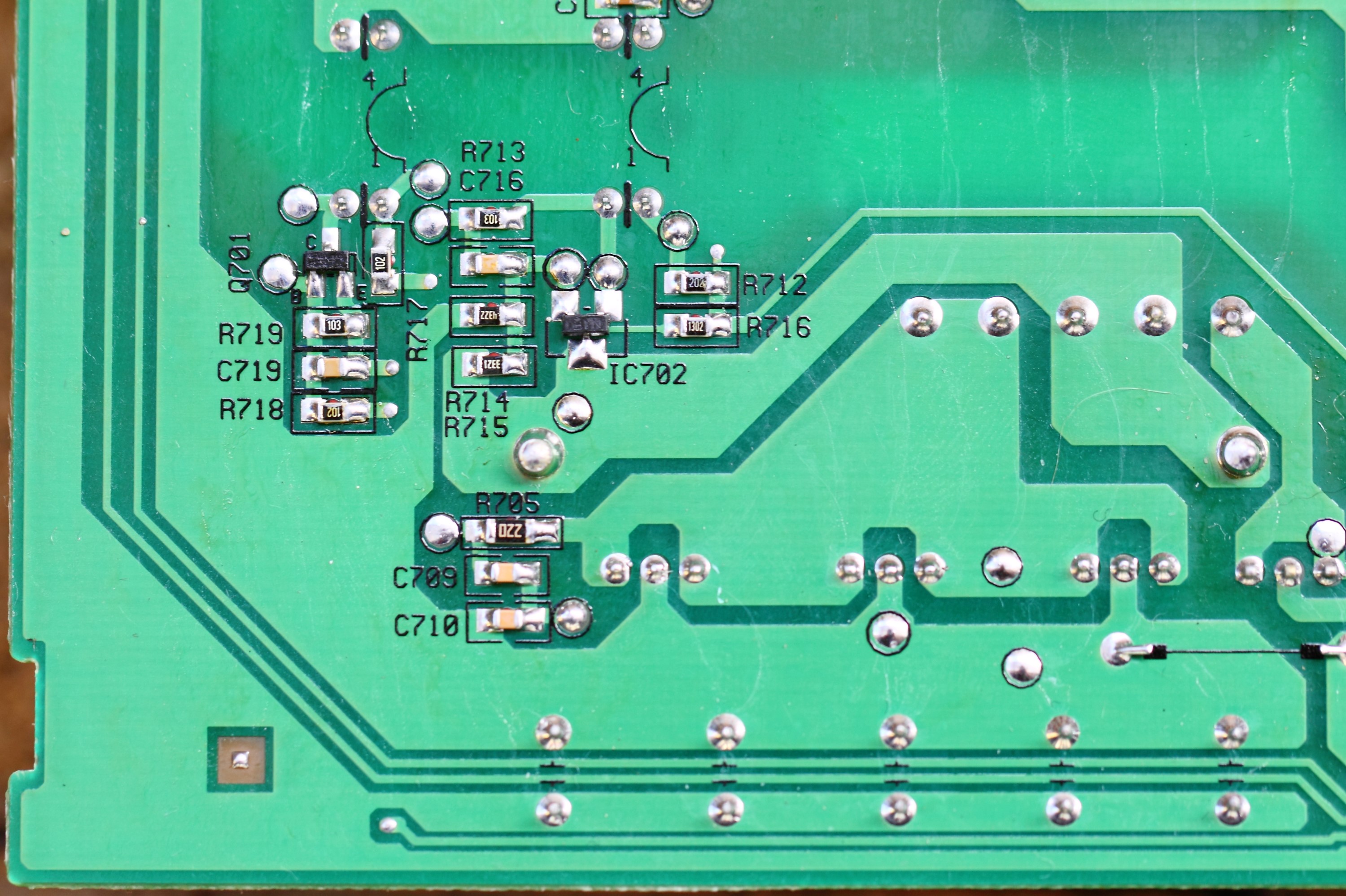

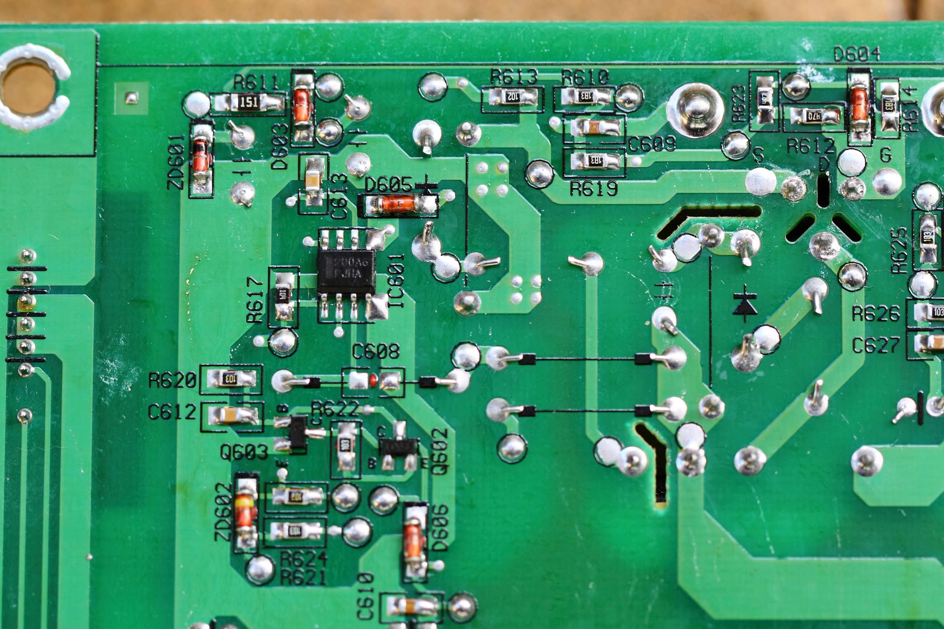

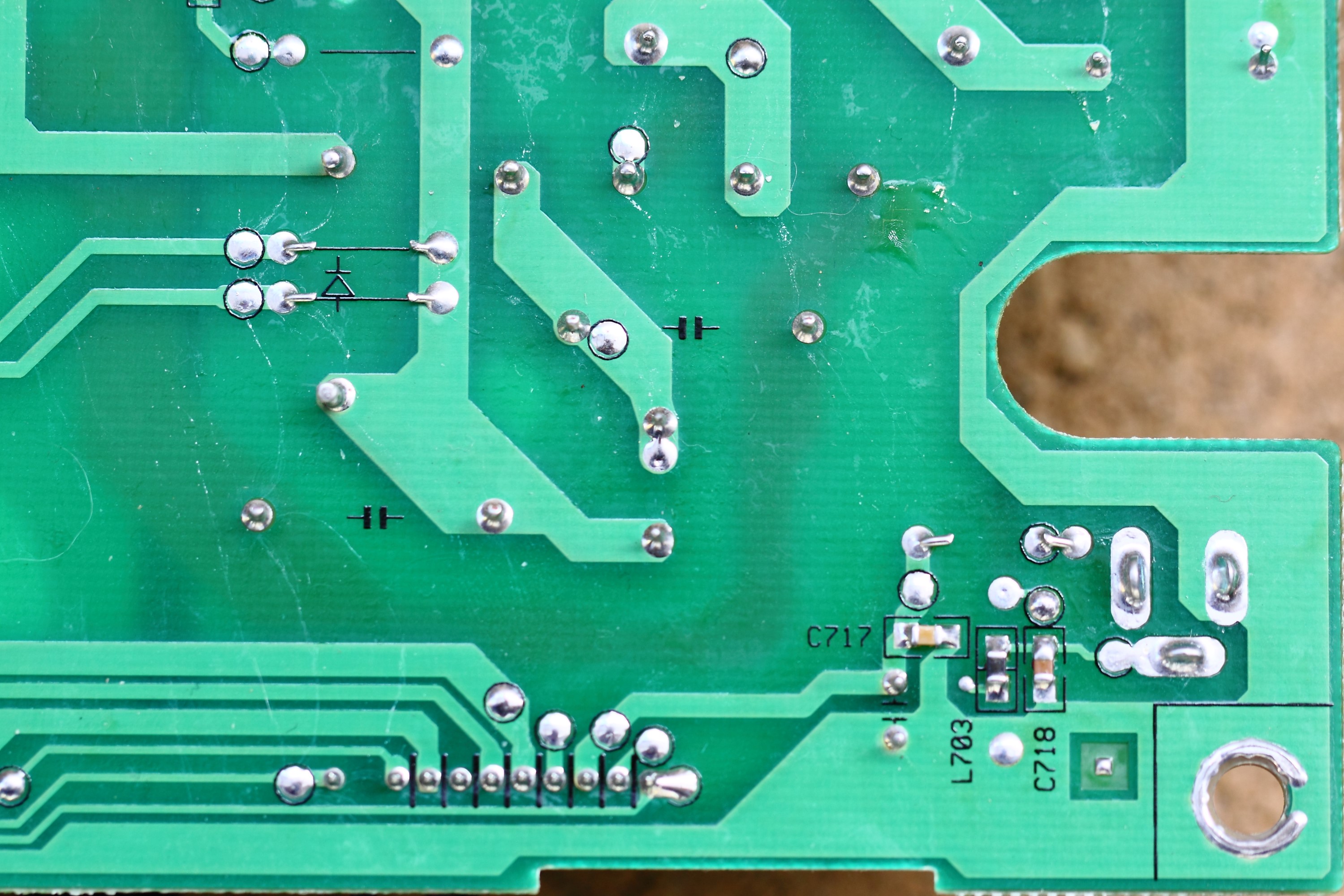

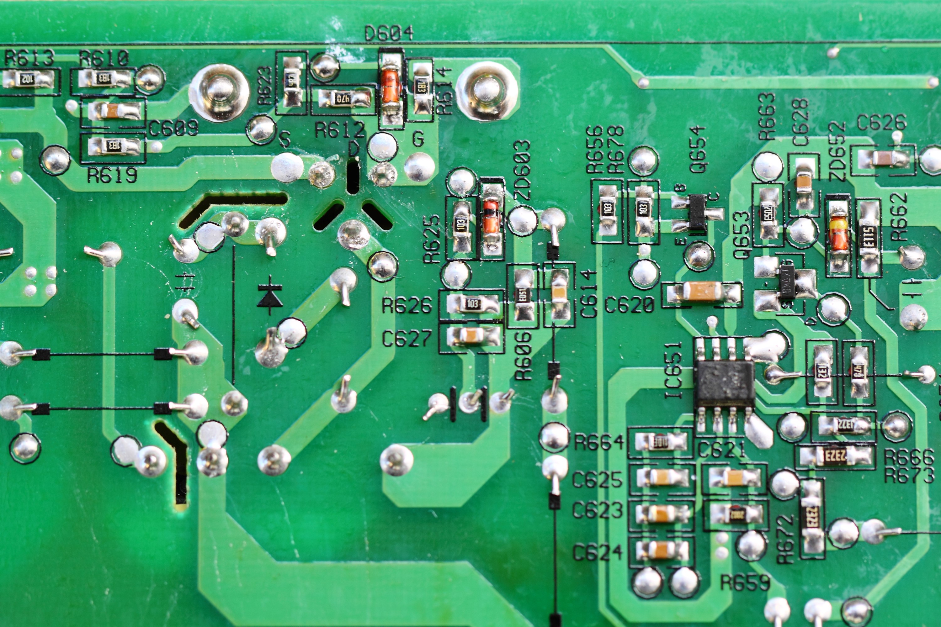

This came to me in a "partially repaired" state.
Stop reading here
Skip to the end... The stuff in the middle is what I've found out. But I think I want to bypass the original power supply, so my REAL question relates to the voltage and currents for the rails generated by the power supply.
It seems to have had the classic 2405FPW fault of the 400V capacitor giving out.
I've read this, and I can spot a number of similarities.
Anyway, I've attached some images. It seems to me that Q651 has been replaced at some point. And clearly C605 is not the original.
In any case, comparing to the checklist:
Yep, it's blown.
Replaced (but reads correct capacitance)
Yes, I'm seeing a short across drain and source (0.1ohms). Also seeing 117 ohms to the gate which seems rather low...
Best image is 3685, and yes it looks burnt.
No visible issues, but resistance 1.226k
On resistance rage I see open one way and just over 1k the other way. On diode test I see 0.616V and 1.016V. SO still acting a little like a diode, but I'd have to remove it to be sure.
Can't measure across C611, but IC601 looks discoloured on one side. I think it's fried.

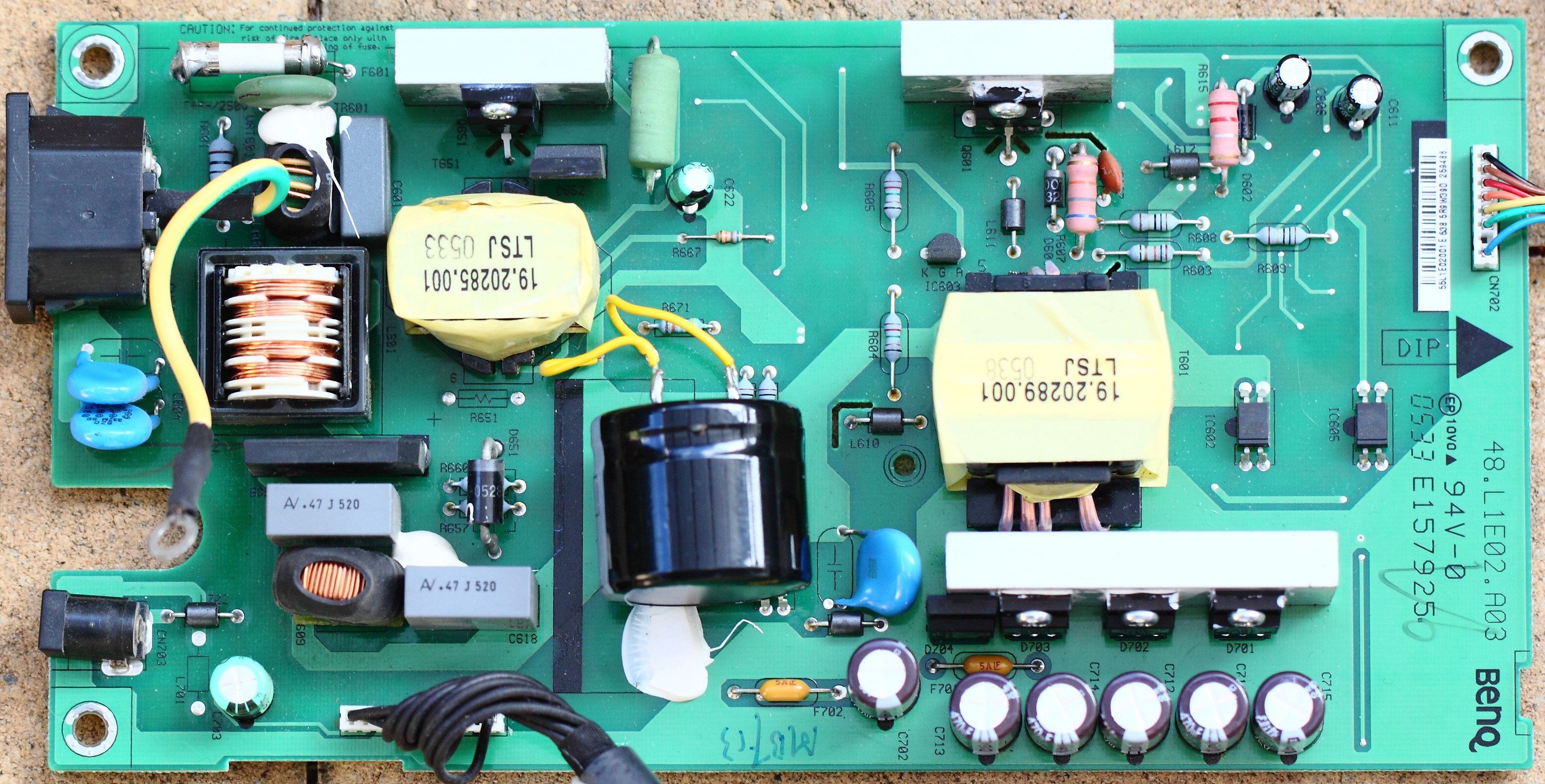

Frankly, the effort in repairing this looks more than the monitor is worth to me. But the idea of applying power externally seems attractive.

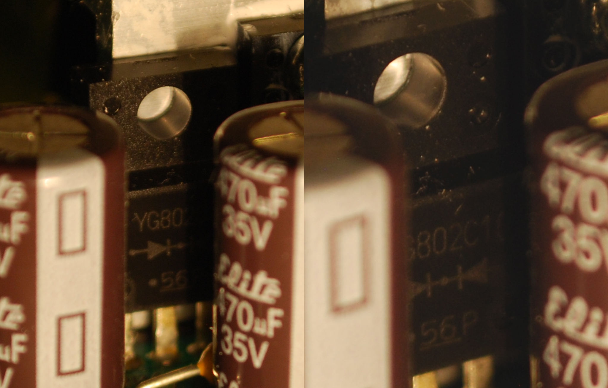

The instructions for the 2407WFPb are here.
What I'm concerned about is the other voltage supplied by the 2405 power supply board that is not supplied by the 2407 board. Does anyone know what it is?
What are the rails?
What currents are they capable of supplying?
