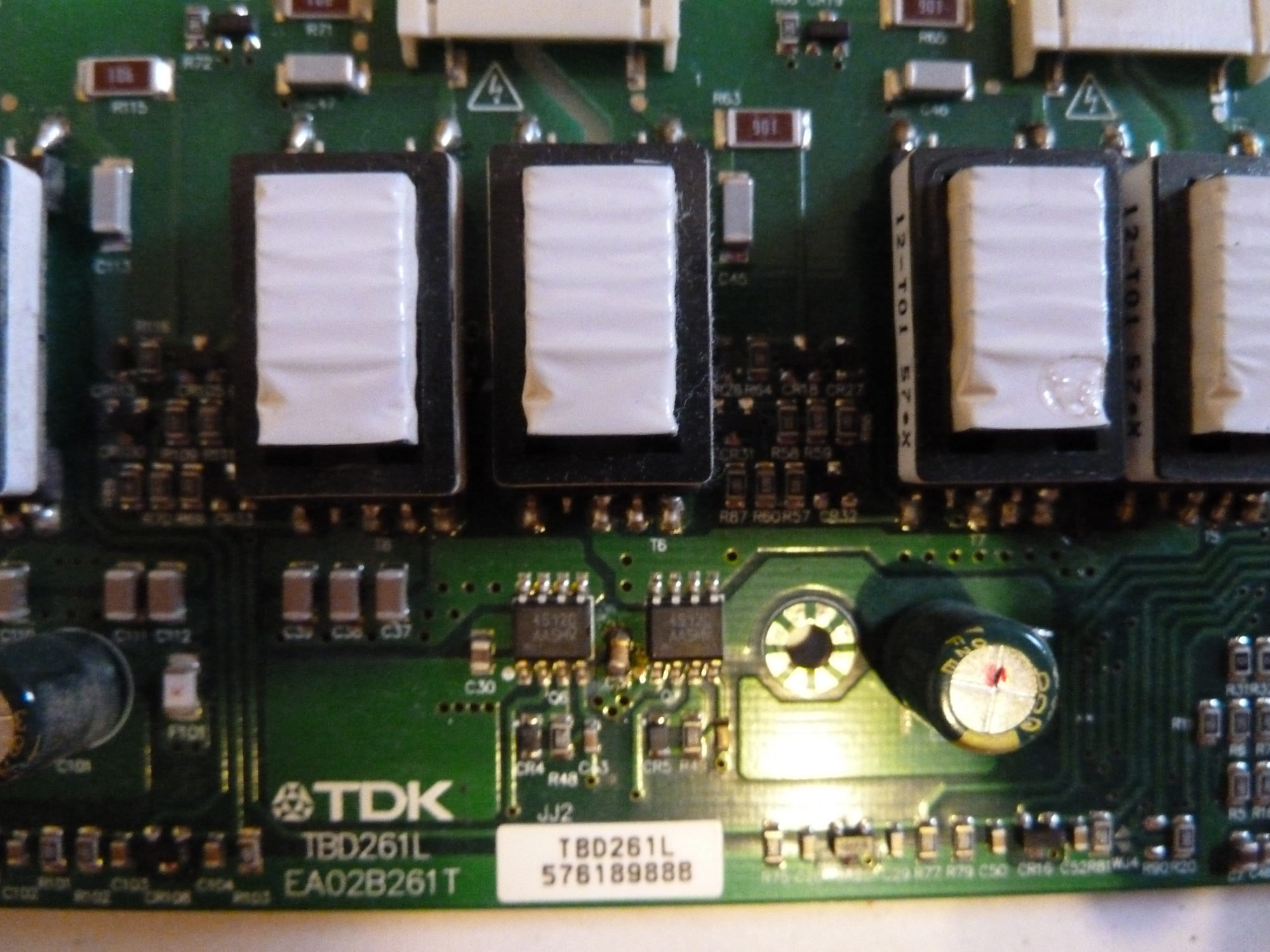

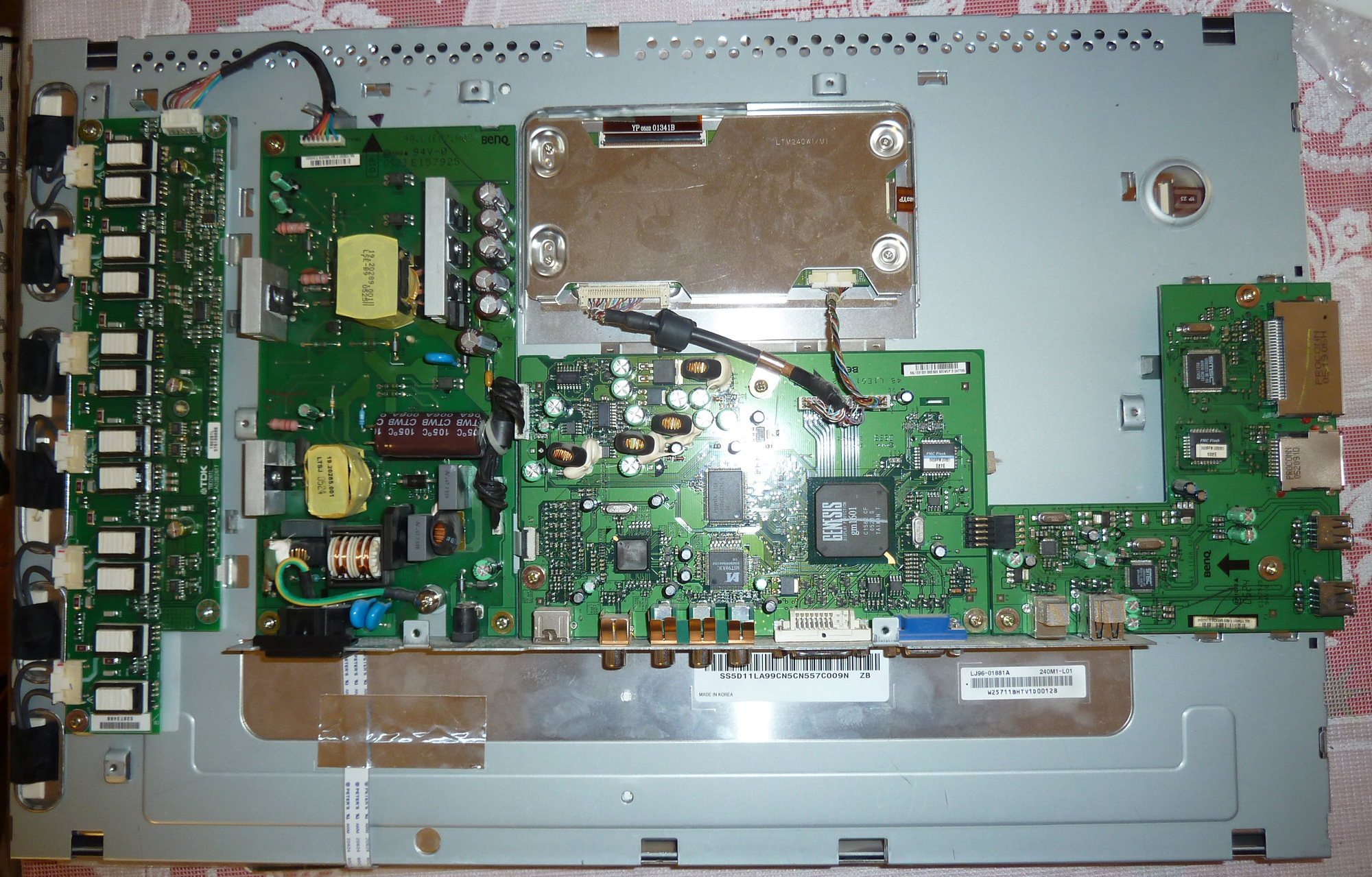

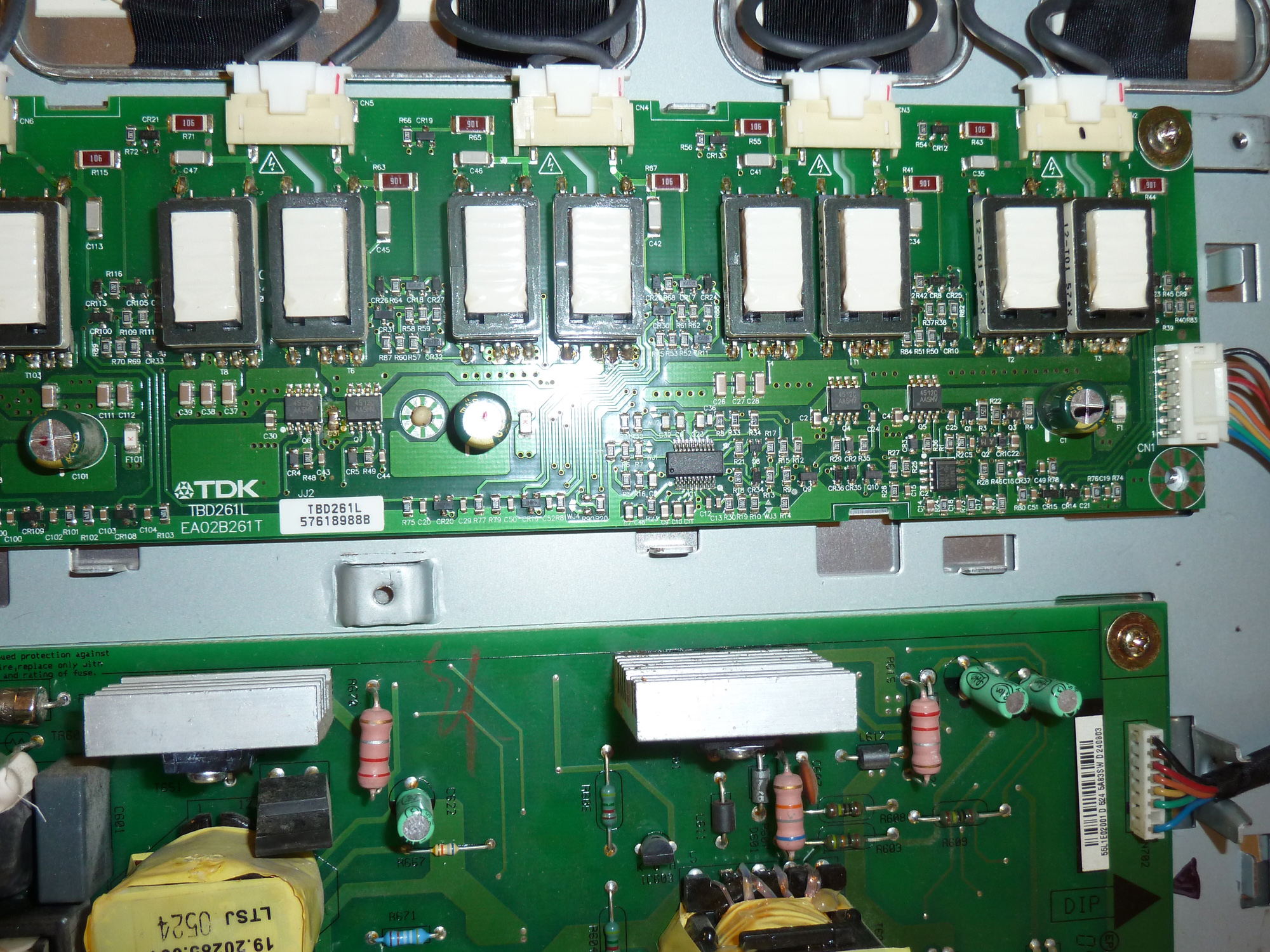

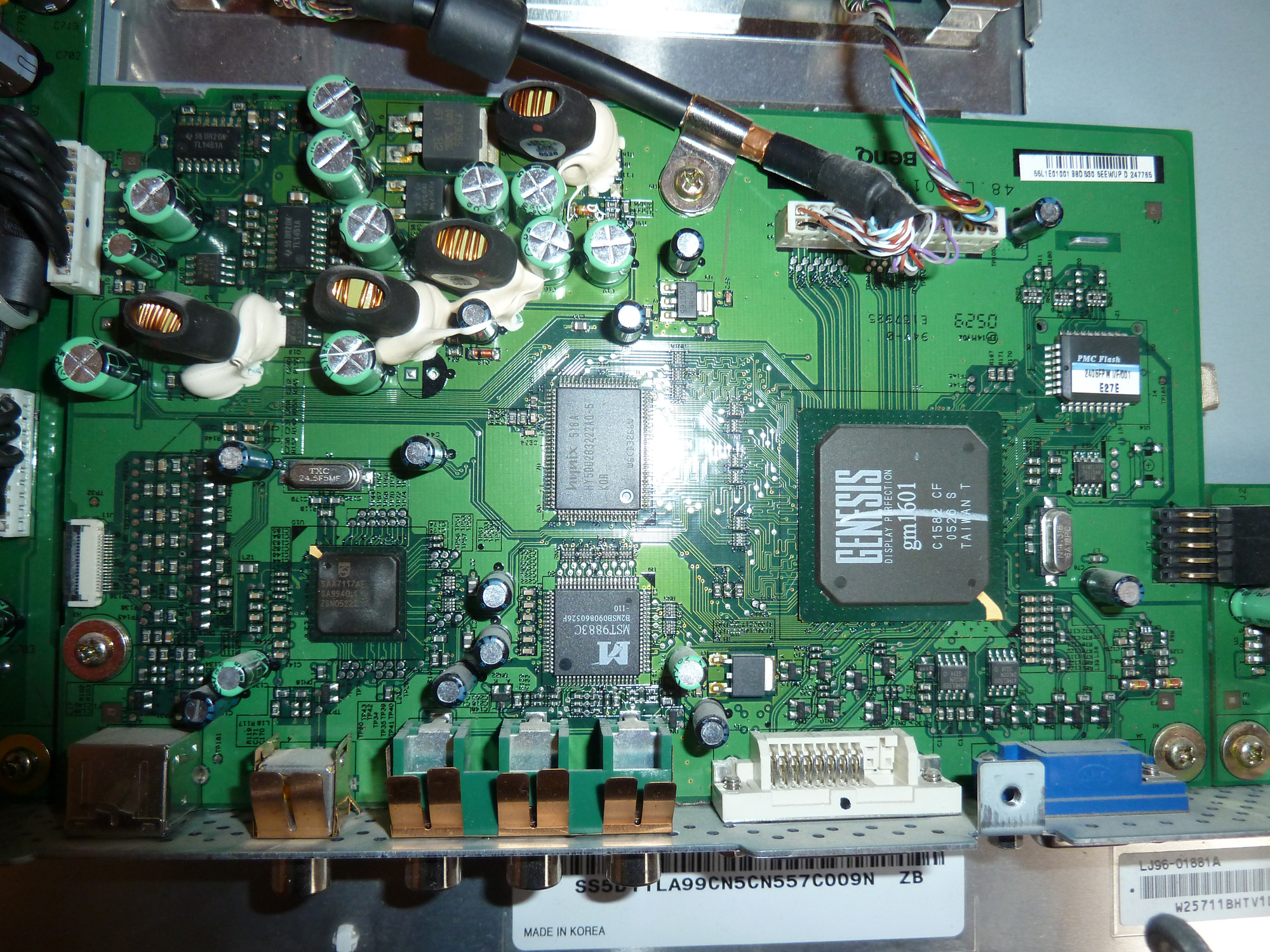

    I have casually been reading posts on this site for about a year hoping that “one day” I'll have enough knowledge to fix my Dell 2405fpw. The monitor turns on (power button lights) but nothing shows up until I use a flash-light and see that the “please connect input“ default error screen is bouncing around. So the back-light needs more power.
    I was hoping it was the usual capacitor problem but after changing all of them the monitor would only have a brief flash. I would also hear a click/buzz sound which sounded like someone was flicking a switch on and then off from the TDK inverter circuit board. The sound may have also originated from the CCFLs.

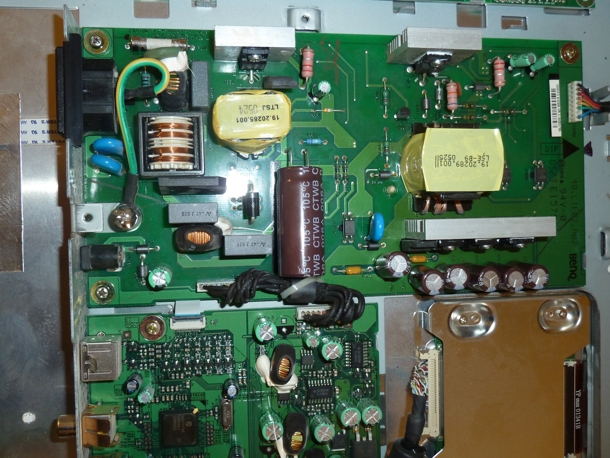

    On the power board, I replaced the big capacitor because it was leaking and the smaller ones were bulging. I also replaced mosfet and resistor near the fuse as it was causing other posters problems due to their capacitors leaking.
    The power-board is outputting 21.3 V when it is switched on and 21.7 V on standby.

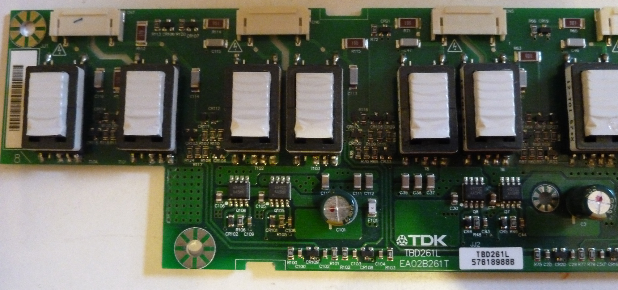

    TDK board
    While tracing the current, I found that it stops just before the transformers at the surface resistor/fuse (F1, F2 & F101). I'm not too sure what those little white components are but one has a much different reading than the other two;
    F1: 0.3 Ohms
    F2: 78.8 Ohms
    F101: 0.4 Ohms
    I also tested the output while the monitor was switched on and got 21.3V for all three of the components.
    For some reason I'm unable to get a reading from more than 1 leg of the transformer.
    The output voltage to the TDK inverter board (while monitor is switched on) is:
    Black: 0
    Brown: 0
    Red: 21.7V
    Orange: 21.7V
    Yellow: 21.7V
    Green: 1.4V
    Blue: 3.2V

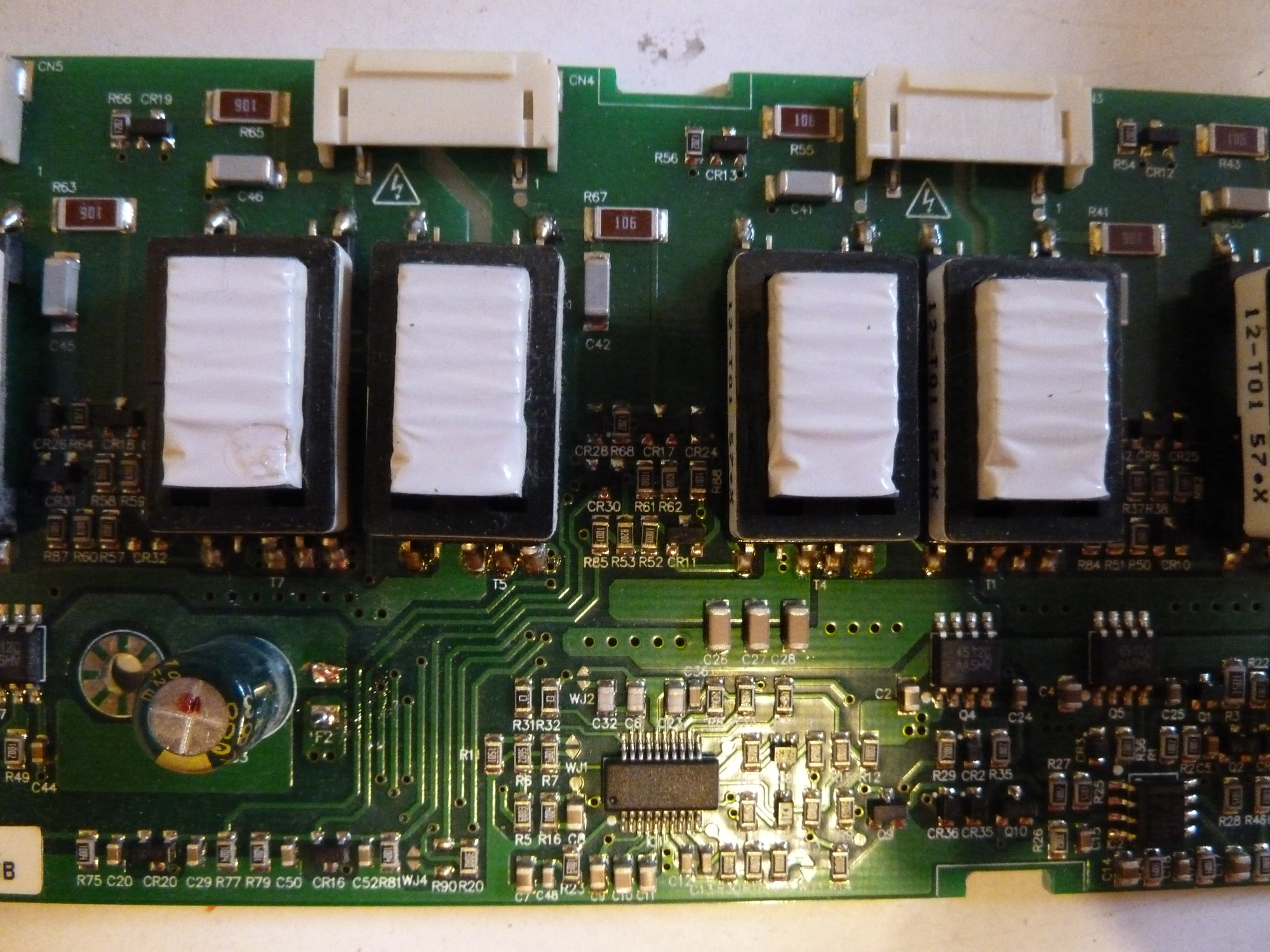

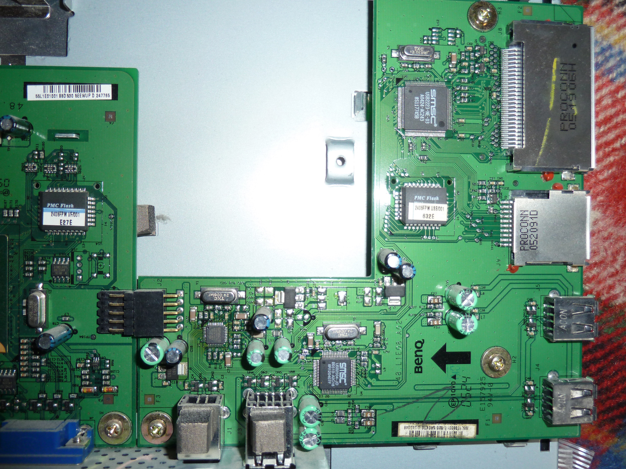

    Am I right in thinking the power board is good and I should be diverting my attention to the other boards ?
    Does anyone have any suggestions/tips how I could test the inverter board more vigorously and what components are more likely to fail ?
    If the monitor flashes for a split second, would this mean the CCFLs could be still alive and intact ?

    Re: Dell 2405fpw - Backlight problem
    F2 is a fuse and it has blown
    If it has a K on it - flash has blanked it it may be 1.5a
    There is no standard marking but I have seen a few from different sources with k=1.5. They tend to be a bit expensive and having to buy 10 makes it moreso.
    Some mebers use small pico fuses and solder them in first as from some sources
    they can be a bit cheaper.
    Cpc seem to have a FREE postage promotion on at the moment
    http://cpc.farnell.com/cooper-bussma...-bb45-00001003
    might do - they have others as well you will need to get the right physical size
    - it is often easier to solder the new one piggyback on top of the old one - less chance of damage to the fuse and the board.

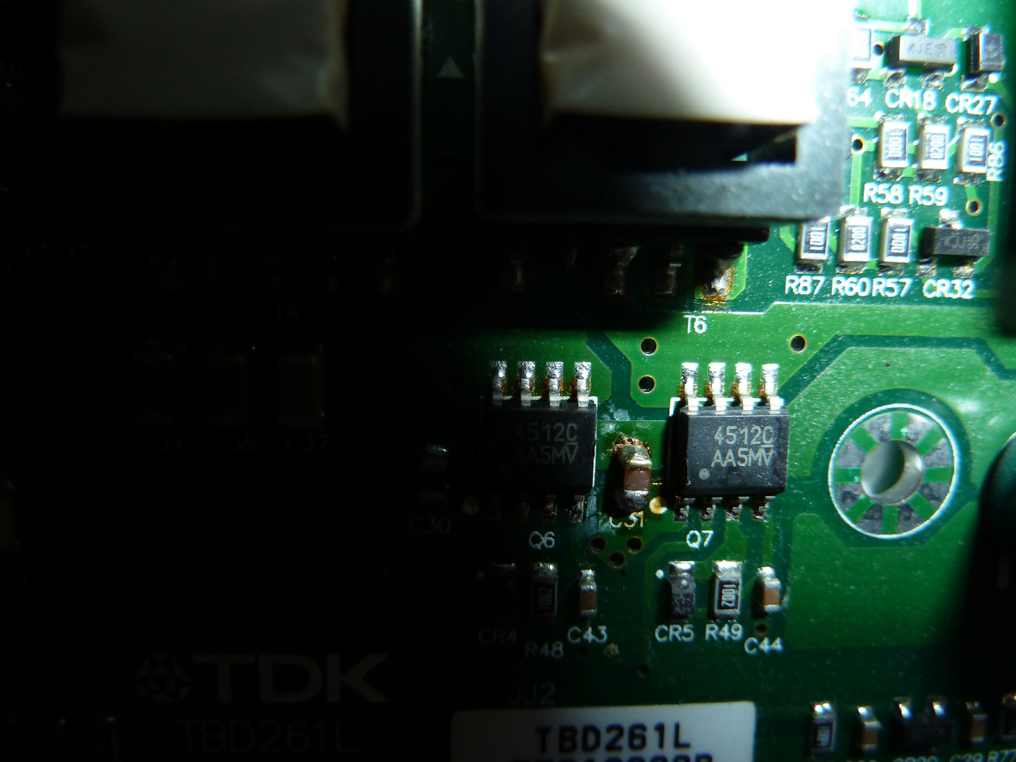

              I've just replaced the fuse and after I switched the screen on it blew again.
              I clean the board by spraying some isopropyl alcohol and found a dirty looking component C31 which I assume is some kind of surface capacitor ? It looked like it had been soldiered by myself (messy) and had some yellow residue beside it. I'm not fully sure if it has exploded or it's just dirt.
              I've only got a cheap £30 multimeter so it's unable to test capacitors. Is it possible to test capacitors with a basic multimeter ? I'm going to have to remove another capacitor from the board to compare the results. I usually just replace the standard capacitors with spare capacitors lying around but in this case I'm not going to have a surface mount one.
              Does anyone else have any other ideas of what could be disturbing the F2 fuse ?
              Sorry about the photos, it's really hard for my camera to focus on the miniature components.
              Thanks for your help

                Please do the resistance testing of the MOSFET, start with Q106. We are looking for low resistance reading between pin 1 and 5 (or 6, 7, 8 since they are tied together), do the same for the MOSFETs and report the readings.

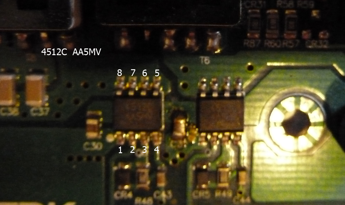

                  Hi, I'm unsure if I've numbered the pins correctly. I assumed the pin number starts with the dot/indent. The 5,6,7,8 pins are all linked according to my continuity test. I've attached my version of the pin numbering system just in case it is wrong.
                  From pin 1 to pin 5 (diode/continuity test mode)
                  Mosfet model - 4512C AA5MV
                  Q106 - 531 ohms
                  Q105 - 532 ohms
                  Q6 - 532 ohms
                  Q7 - 533 ohms
                  Q4 - 532 ohms
                  Q5 - 530 ohms

                        OK, I just look at the spec sheet of the AF4512, it is dual MOSFET's (P and N channels), so you need to take the reading between pin 3 and 5 also.
                          From pin 3 to pin 5 (200 M Ohms setting)
                          Q106 – 1.1 M ohms
                          Q105 – 1.1 M ohms
                          Q6 – 1.0 M ohms (tested many times)
                          Q7 – 1.1 M ohms
                          Q4 – 1.1 M ohms
                          Q5 – 1.1 M ohms
