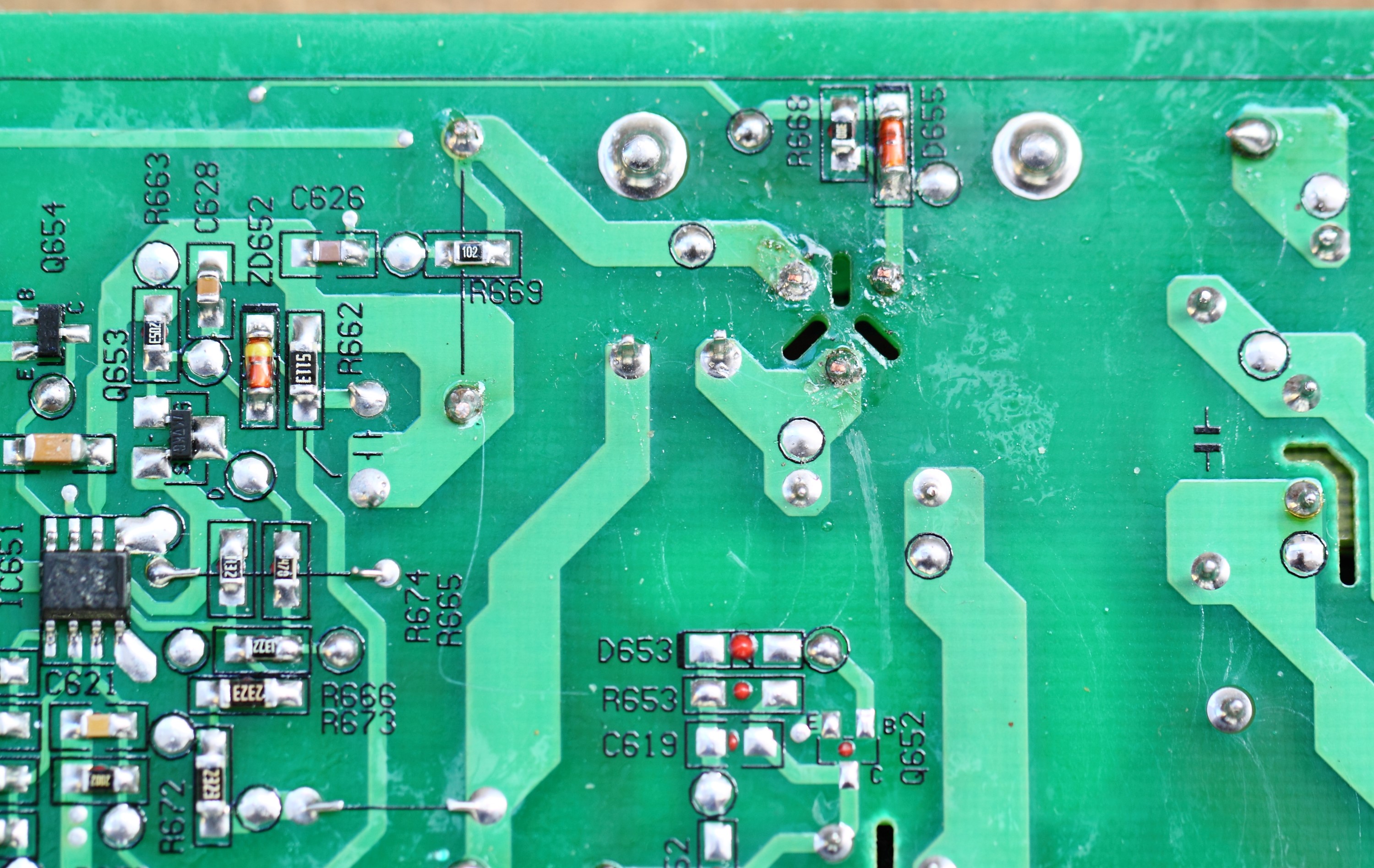

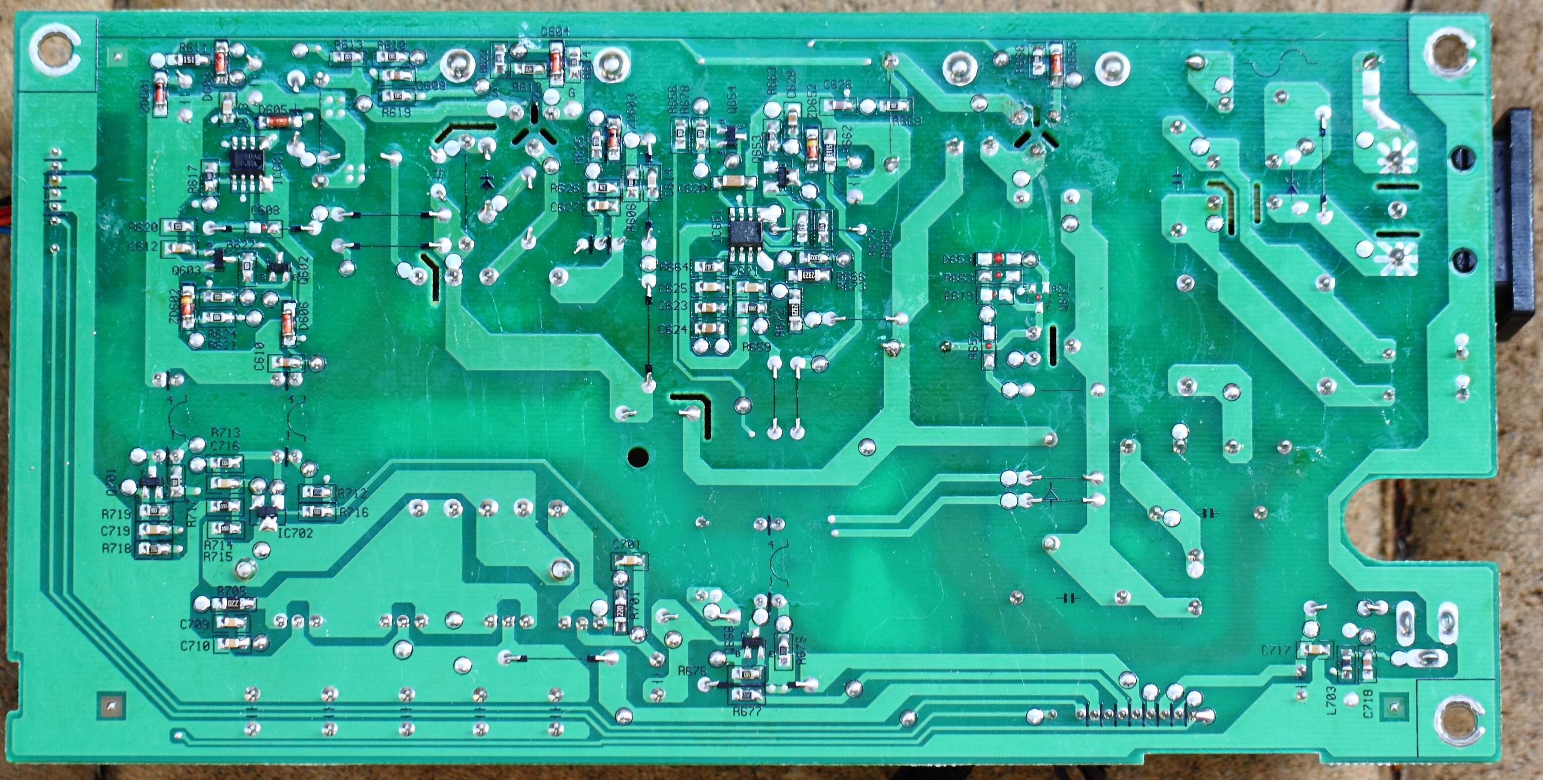

    Anyway, I've attached some images. It seems to me that Q651 has been replaced at some point. And clearly C605 is not the original.
    In any case, comparing to the checklist:
    a) F601: Resistance of fuse high!
    Yep, it's blown.
    b) C605: Capacitance reading not correct
    Replaced (but reads correct capacitance)
    c) Q651: Resistance only a few ohms between one pair of pins
    Yes, I'm seeing a short across drain and source (0.1ohms). Also seeing 117 ohms to the gate which seems rather low...
    d) IC651: visibly burnt
    Best image is 3685, and yes it looks burnt.
    e) R669: visibly burnt/ resistance no longer 1k
    No visible issues, but resistance 1.226k
    f) ZD601: resistance of about 22R across it, both ways round?
    On resistance rage I see open one way and just over 1k the other way. On diode test I see 0.616V and 1.016V. SO still acting a little like a diode, but I'd have to remove it to be sure.
    g) IC601: Capacitance measured across C611 appears more than 47uF even though C611 is OK.
    Can't measure across C611, but IC601 looks discoloured on one side. I think it's fried.

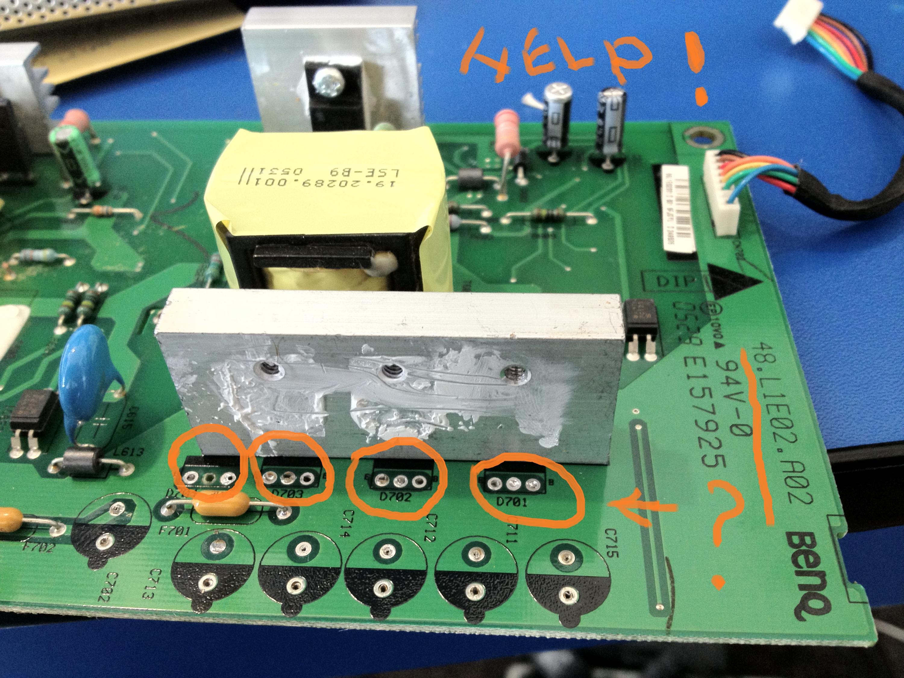

            Hi guys, help determine which there were? received in this form! thanks for the help! may have a schematic for this power supply??
              Re: Dell 2405FPW power supply fault.

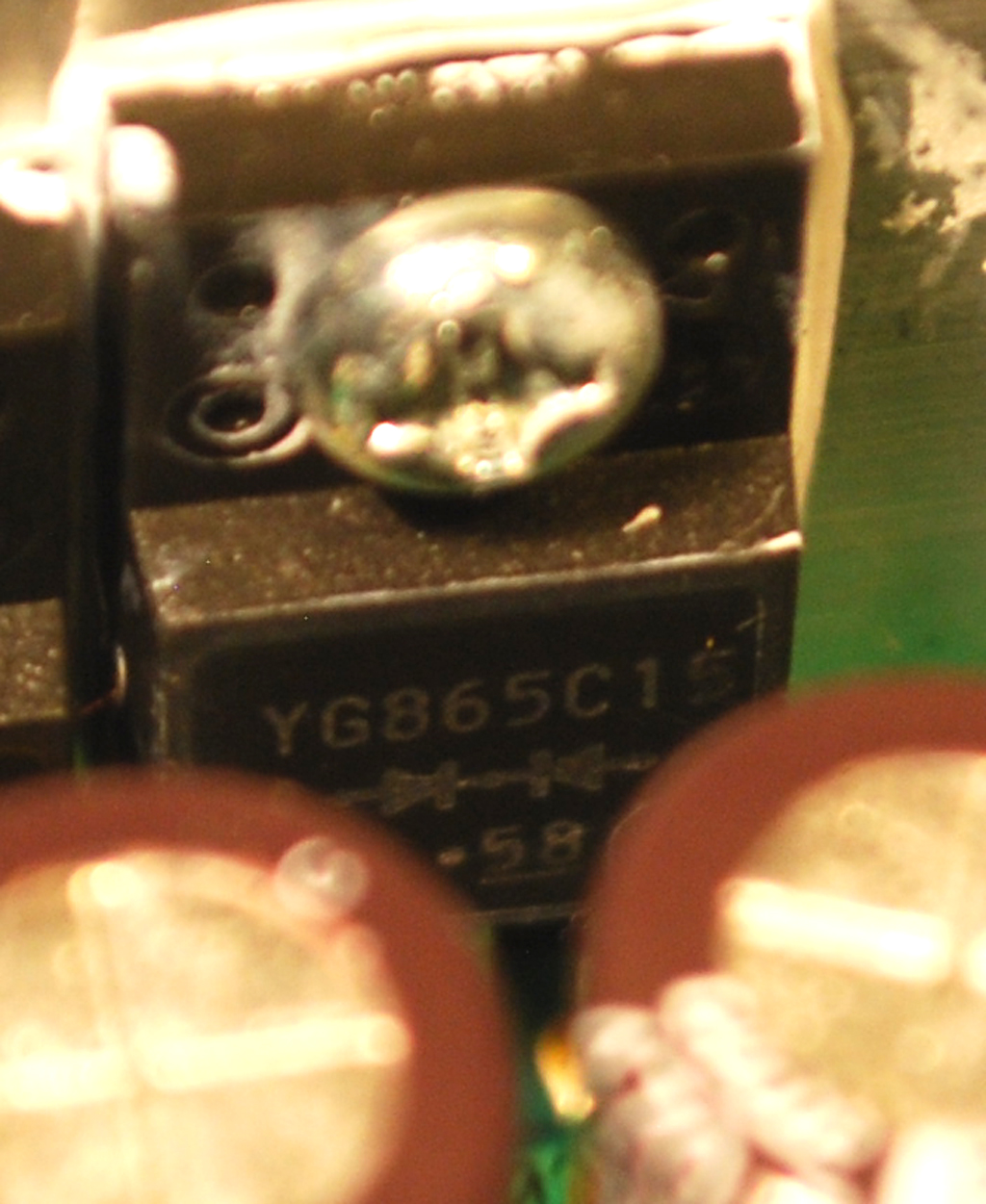

              C702, C711, C712, C713, C714, C715: All 6 of these capacitors are 470uf, 35V, 105°C.
              D701, D702, D703: YG865C15
              D704: YG802C10
              These capacitors fail frequently, and also C605 (120uf, 450v, 105°C)
              I have never seen any of those Schottky Barrier Diodes fail.
