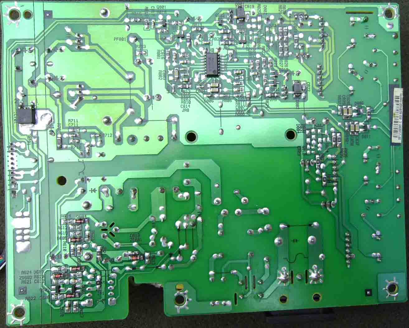

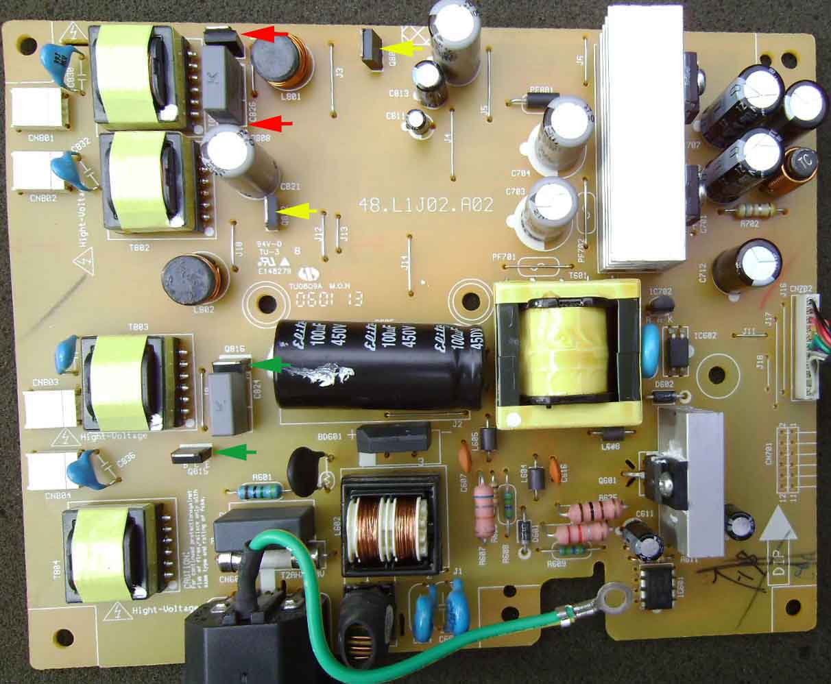

    When I got this Benq FP91G+ its power light wouldn't even come on when the power button was pressed
    One of the C5707 pair indicated by red arrows tested faulty, so I replaced the pair
    A solder joint on the component between those C5707 was cracked, so both its legs have been resoldered
    Because a joint was cracked, I've also resoldered legs of the components indicated by yellow arrows - are they usually FU9024 ?
    Not in this instance - one is marked F1 F37 FQU 11P06, the other F1 F38 FQU 11P06
    I've also resoldered legs of the transformers
    The C5707 pair indicated by green arrows is original
    All capacitors have been replaced, not necessarily by high quality ones, but sourced from a local specialist supplier (not a chain store)
    Now after pressing the button, the power light stays green
    There'll be a brief flash from the backlights, usually with the Benq logo visible on screen for a fraction of a second
    Help please - how do I progress from here ?

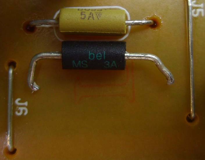

                Replaced PF801 as shown in first attachment, with fuse salvaged from a computer motherboard - probably a keyboard fuse in its original incarnation
                Leads were barely long enough to be soldered, shown by second attachment, apologies for the blurred pic - measure ~ 0.02 ohm solder joint to solder joint, so should suffice
                I hope people who know what they're doing aren't horrified by a 5A fuse replacing the original 3A - only alternative on hand was unmarked, so I thought better the devil you know ...

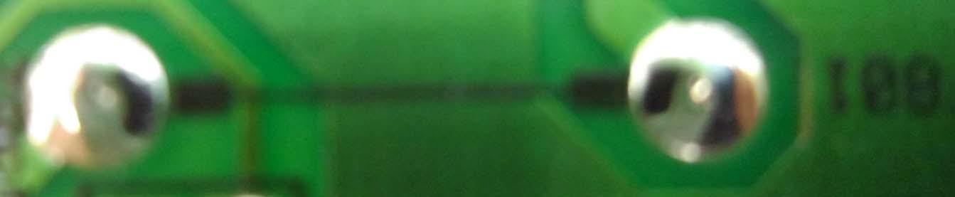

                            UPDATE
                            Pleasure of this repair lasted only a few months before being replaced by pain from the monitor refusing to switch on one morning
                            So it got put aside until I needed a working monitor
                            Expecting my recycled picofuse to be the culprit, I was surprised to find that it tested OK
                            Not necessarily the case for F601, the fuse beside the AC input socket
                            F601 has no audible beep when tested with the Diode test / Continuity setting of my Fluke 77
                            Although it does measure ~6.45 M if I use the meter's Ohm setting - presumably this number is MilliOhms, indicating a good fuse ?
                            Am I barking up the wrong tree, or have I found the likely culprit ?
                            I'd already tested the four C5707 as good, before checking the fuses
                            HELP PLEASE

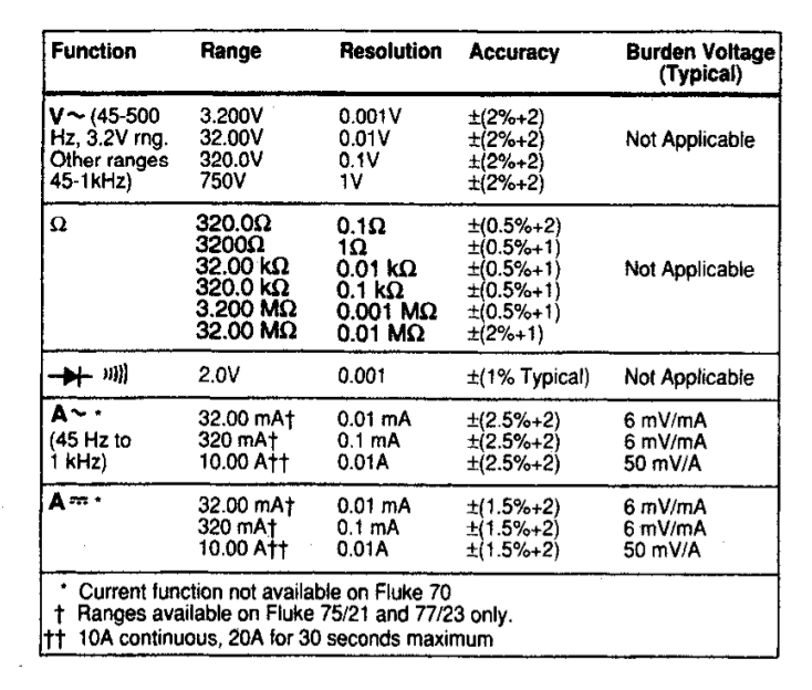

                                No, that is MEGA ohms on the Fluke 77.
                                The Fluke 77 can only show 0.1 ohm resolution. Straight from the manual.
