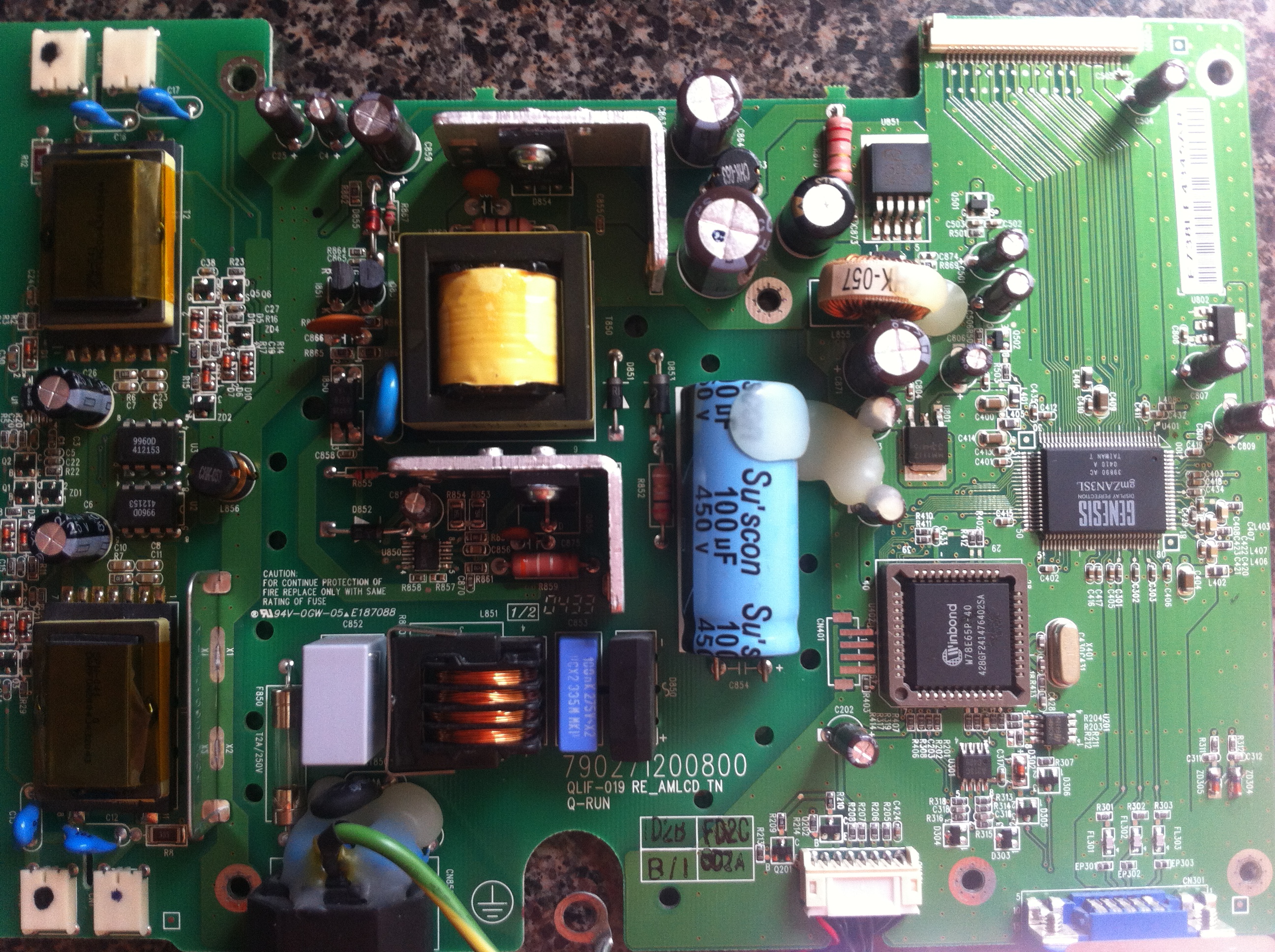

      Any pictures of the main/logic board?
      Board Part # 790271200800

        Can anybody tell me what values I should have on L856 (labeled on top of the component CHK-053) and L855(labeled on top of the component CHK-057). I was looking at the back of the board and it seems that L856 was replaced. And L855 looks worn out (darker at the top), I don't know if it is because it is very close to cap C871, and the heat generated by the cap make it look like it is now. Please advice!!

          Both should read less tha 1Ω.and both look ok on close up.Your fault is located on the part of the board to the right of the Big blue cap,as I have said you can spend lots of time and you will probably still end up with a un-repairable board.

                  This will be my very last try, I just measured L855 and L856, and based on your response they should be reading NMT 1Ω. Well, here are the readings:
                  Without Power:
                  L855 = 1.8Ω
                  L856 = 2.0Ω
                  With Power:
                  L855 = 19.0Ω
                  L856 = 4.9Ω
                  I'm asking because, L855 looks worn out, and L856 seems that was previously replaced. Again, if obtained values are considered acceptable/normal, I'll drop the ball once and for all, otherwise, I might have a chance...

                      Never measure resistance with power on.
                      Inductors rarely fail. If your reading is not below 1 ohm, it might be because your test leads have high internal resistance. Most of my test leads are 0.2 ohms or less when they are shorted. Cheaper or bad leads can be 1.0 ohms when shorted.
