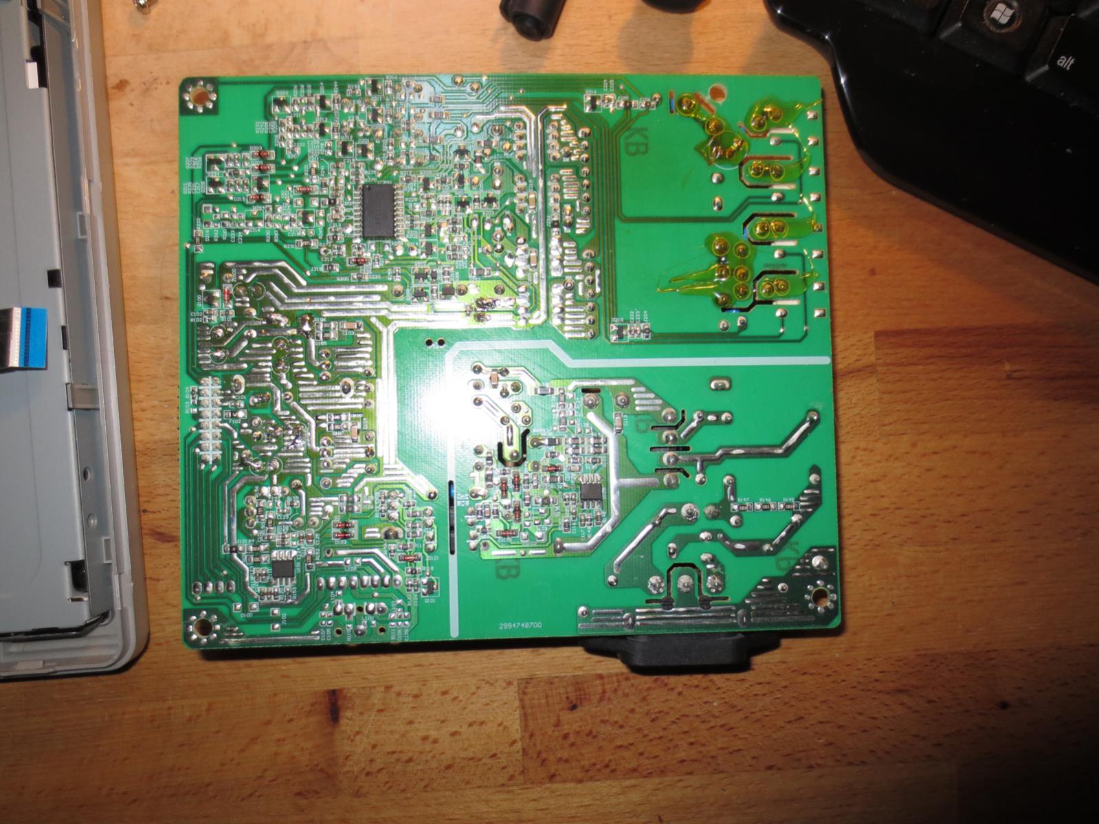

    I've got a serious problem with my Acer AL2216W. It started with the orange stand-by LED getting darker a few weeks ago. Until yesterday there was no problem except the LED, the monitor was working fine. So yesterday i turned it off and when i came back, the orange LED was off and the monitor didn't start at all.

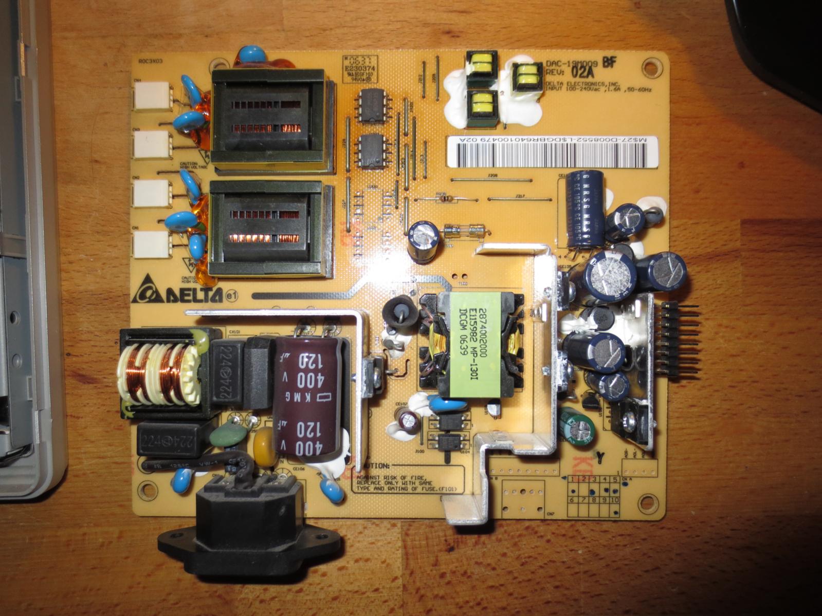

    I opened it and checked the caps (had to change them a few years ago) two 1000μF were bulged. Today I replaced them with some of the same local shop, re-assembled the monitor, but no orange LED, no starting
    So I plugged it in and checked the outgoing voltages:
    13.8V pin was about 14.3V (a little high?)
    5V pin was exactly 5V
    Back to checking parts: The power switch and LEDs were fine, so I followed up the conducting path from the LEDs on the switch circuit board to the MOSFETs (K84 T9) and measured the voltage of the pins to case-ground:
    green LED (power on):
    Gate: 3.26V
    Source: 0.16V
    Drain: 0V
    orange LED (stand-by):
    Gate: 3.26V
    Source: 0.16V
    Drain: 0V
    I checked the MOSFETs with the diode-check of my multimeter when the PSU was off, both gave me same values for the different measuring options (G-S, G-D, whatever).
    So I followed the MOSFET's source circuit track to the PSU-connector. Its taken from a circuit between the top two pins (8 & 16) - voltage between them: 0.16V
    The voltage seems a bit low to me, but following the pin conducting paths didn't lead me to any new idea. At this point I'm out of knowledge, so please help me!

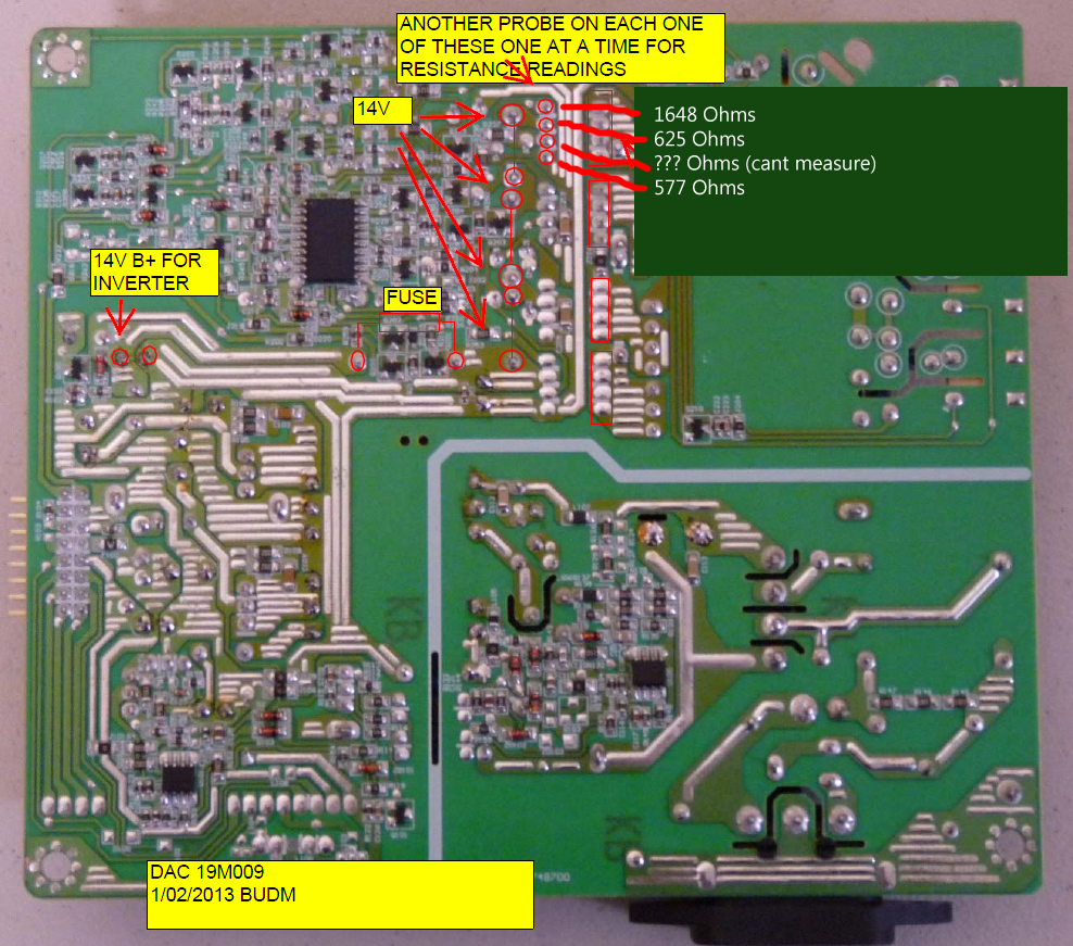

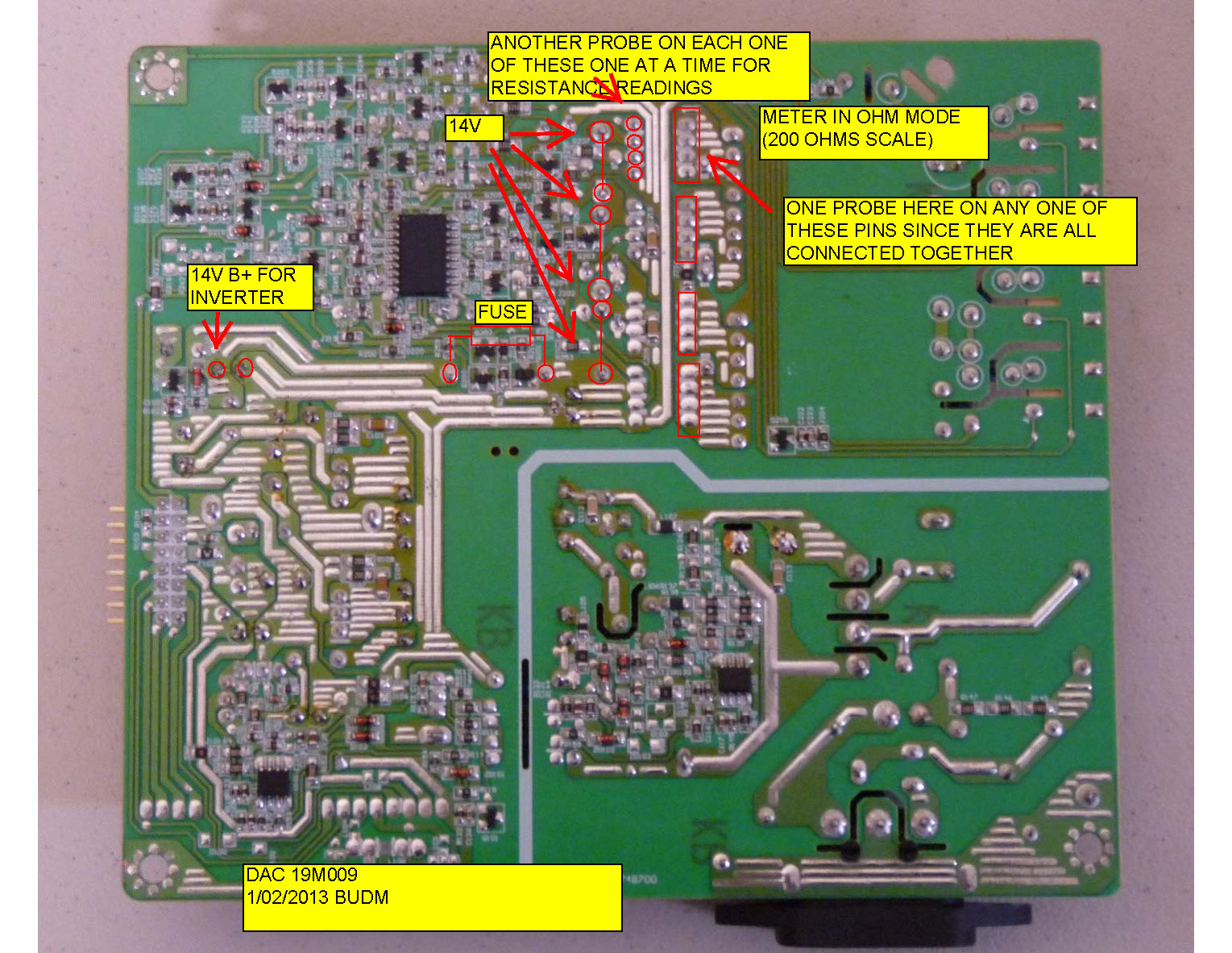

            Please see pictures, you need to check the DC for the inverter again.
            OK, your earlier post are not the same MOSFET I had in mind, the MOSFET'S are the 8-pin dip on the power supply-inverter board

                    "P605 Ohm-values are for both MOSFETS " What is the P605 Ohms?
                    There are 4 MOSFET's 8-PIN DIP that I redlined and I need the resistance reading of ALL FOUR MOSFET's.
                    • hitz
                      • Jan 2013
                      • 36
                      • germany
                      Re: Acer AL2216W / DAC-19M009 dead?
                      I've only 2 on my board, both got the values you can see on the picture i attached to my previous posting.
                        OK, I see and understand your answer now. Sorry about the confusion.

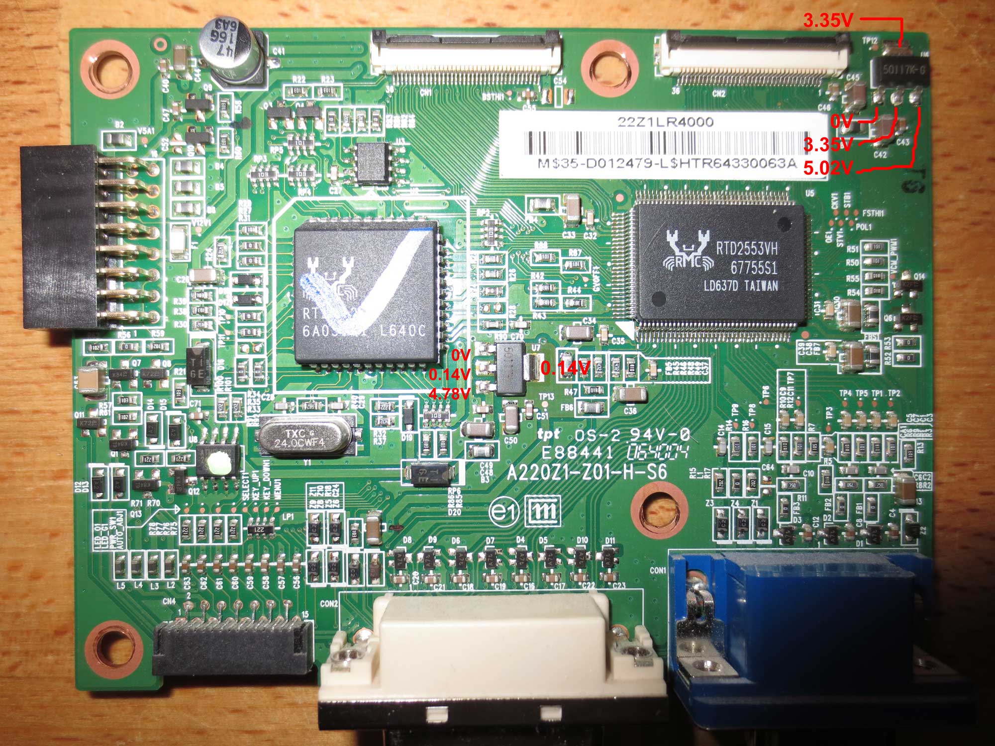

                                    Its U7 in the middle and U6 in upper right corner. Both are labeled 50117K-G.
                                    The middle pin of U7 is directly connected to the source pins of both LED-MOSFETs I mentioned earlier.
                                    For measured voltages open the attached picture.

                                      It looks like U7 may be bad. We also want to make sure the output of the middle pin of U7 is not shorted to ground. To verify, unplug your monitor from power. With your meter set to 200 ohms, place one probe on the middle pin and the other probe to a ground point. Hopefully, you won't read zero ohms.
                                      I'm thinking the regulators are part of the 1117 family of regulators.
