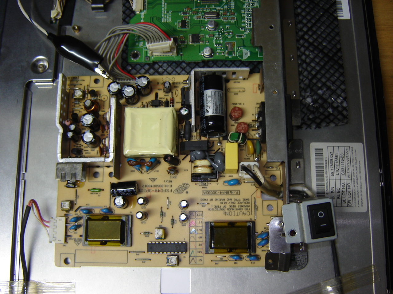

    I've got a Samsung 172n monitor at a thrift store and I'm trying to fix it. The symptom is this - I turn it on the power LED turns on, keeps on a little bit, and turns off. There is no signal of any activity whatsoever. The power board looks ok, there is no signs of overheating or burned parts. The electrolytic capacitors were not bulging, but I changed them all anyway. That made no difference. I checked the voltages at the cable that goes to the main board and the 13v and 5v are there and are steady. So, I got to the conclusion that the power source part of the board is ok and the problem is in the inverter part. Then I checked the voltages on the inverter main IC and everything is almost at zero v. I've changed the IC and 2 transistors in the line that provides the DC to the IC, as well as a diode. That made no difference either.
    The part number of the power board is BN44-00092A. Does any of you have the schematics? l've searched a lot for it, but I could not find it on the internet so far. What I found is the schematics of the model BN44-00082A, which is somewhat similar, but not totally. So, without the right schematics I am trying some things, but I'm not totally sure about what I'm doing.
    Another doubt I have is this - what is the voltage I would have to expect on the on/off pin? That comes from the main board and seems to be almost zero as well. Does that indicate the problem may be in the main PCB?

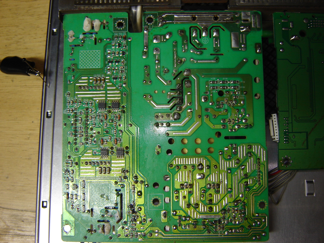

    Whilst you have given a good resume of the problem in order to help we could do with picture of the boards so we know what we are dealing with.
    A couple of checks - check that you have replaced the caps the correct way round.
    I think on the power board there is a green torpedo fuse- meter on ohms 200 touch the probes together - should be 0.0 or near to. Then with NO power to the board put one probe on each end of the fuse - should be the same as touching the probes together.
    Post result.

    We can help a lot more if you please post good clear pictures of the whole chassis, and then pictures of each board, front and back and close up of connectors, (max resolution 2000x2000 and 2MB) using the manage attachments button, which is found by clicking "go advanced" under quick reply.

      Now, returning to the board - I forgot to mention - I had already checked that green fuse and it tests ok, as well as the 2 transformers that do not seem to be shorted, but I don't have a ring test to be 100% certain. If I understand correctly, that type of power source needs a kind o feedback signal to keep working and I thought that maybe it is not receiving it, but how do I test that?

        It kind of looks like that cap between the transformer and the primary switcher is bulging a little bit, sort of hard to tell from that angle though.
          Re: Monitor Samsung 172N problem
          Thanks for the reply, but not really, I've changed all the caps.

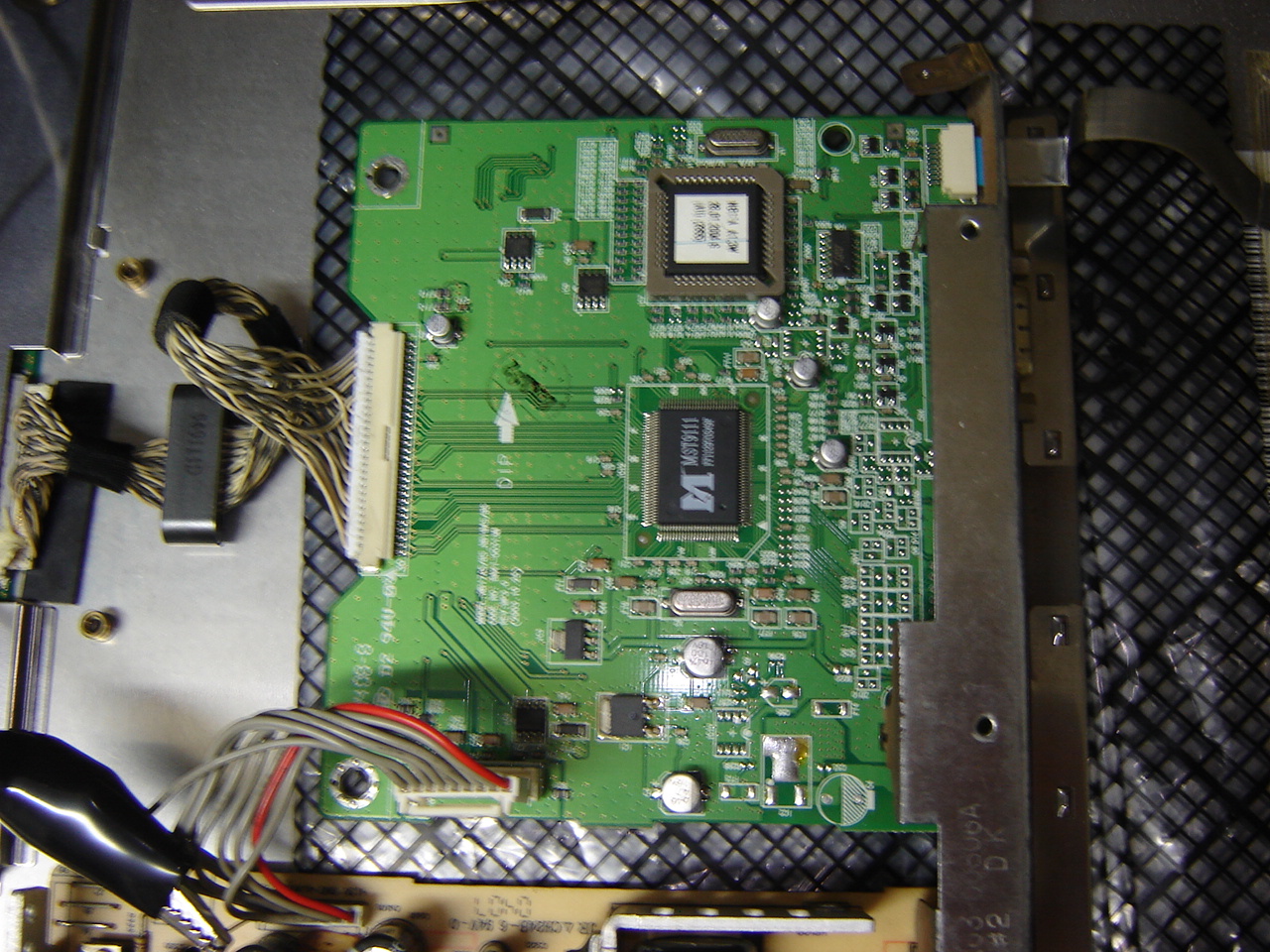

              Ok- the picture of the main board is not clear enough for troubleshooting and
              (This is not aimed just at you - I think I will add it to my standard request for pictures) I cant understand why anyone would post a picture of a board
              one side then turn it upside down and TURN it to post the other side.
              When you dont have the board it makes it difficult flicking between pictures to see where something on the bottom is on the top. Rant over.
              The reason I was looking is that there are four or five big solder joints which I think must be the transformer - can you reflow them

                Measure also the voltages in the regulator chips in the main board ( marked 1117-something ) . Although the picture is out of focus, the solder in them seem a little brown from the heat.

                  So, things are pointing to a problem on the main board. I have been trying to measure the voltages there and things are odd. It seems that the IC that provides 5v to the 3,3 volt regulator sends 5V for a moment and then shuts down. So there is no 3,3 volts for the main chip. There is no 5 volts either where the main board should feed the panel board (not even when I turn the set on).

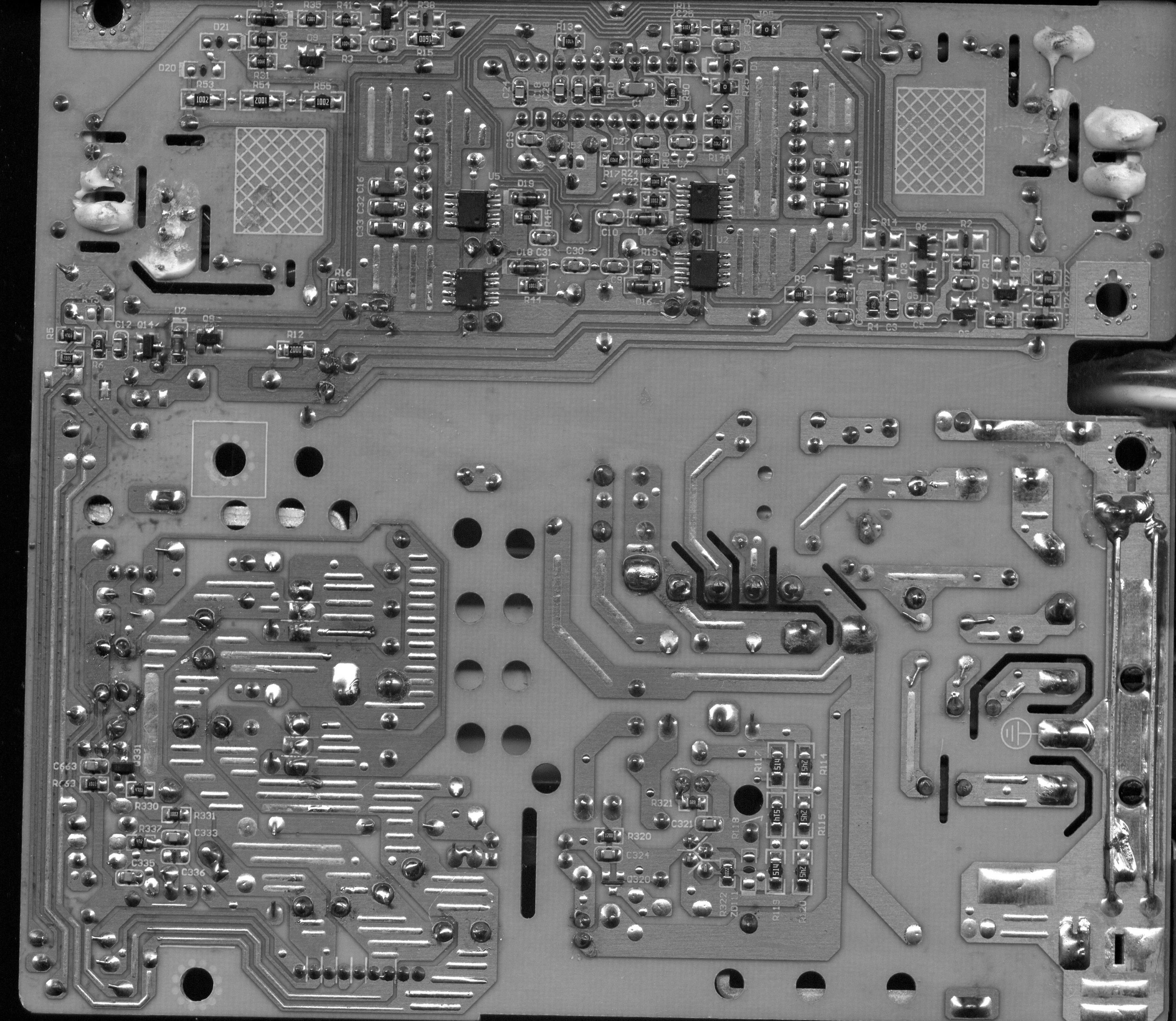

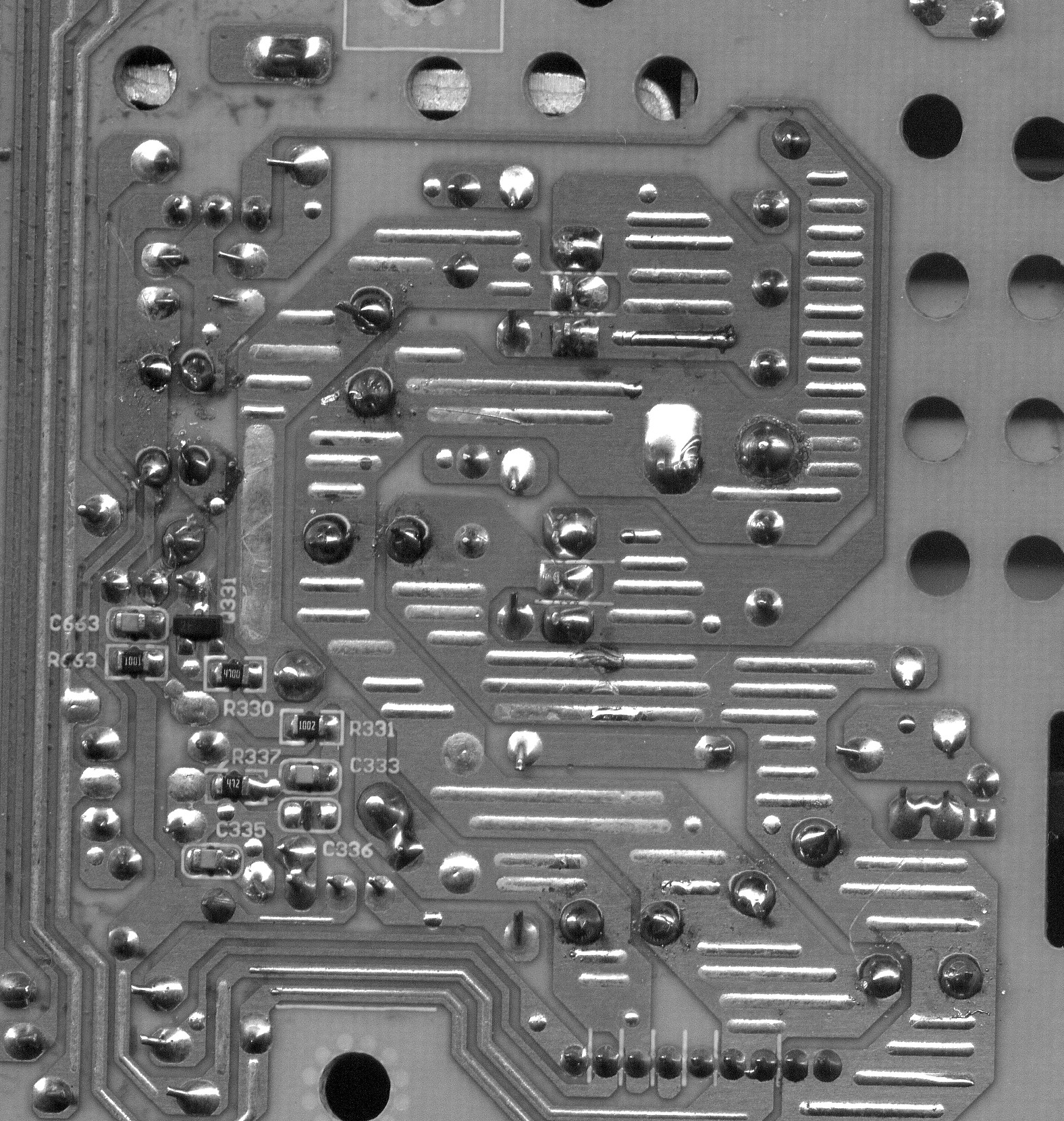

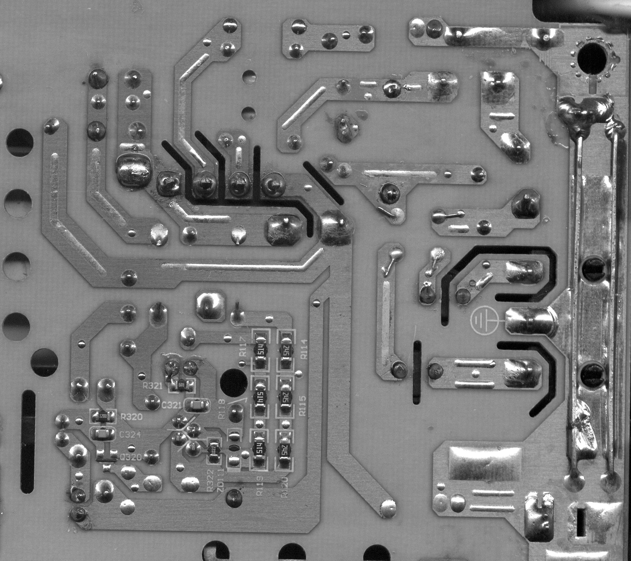

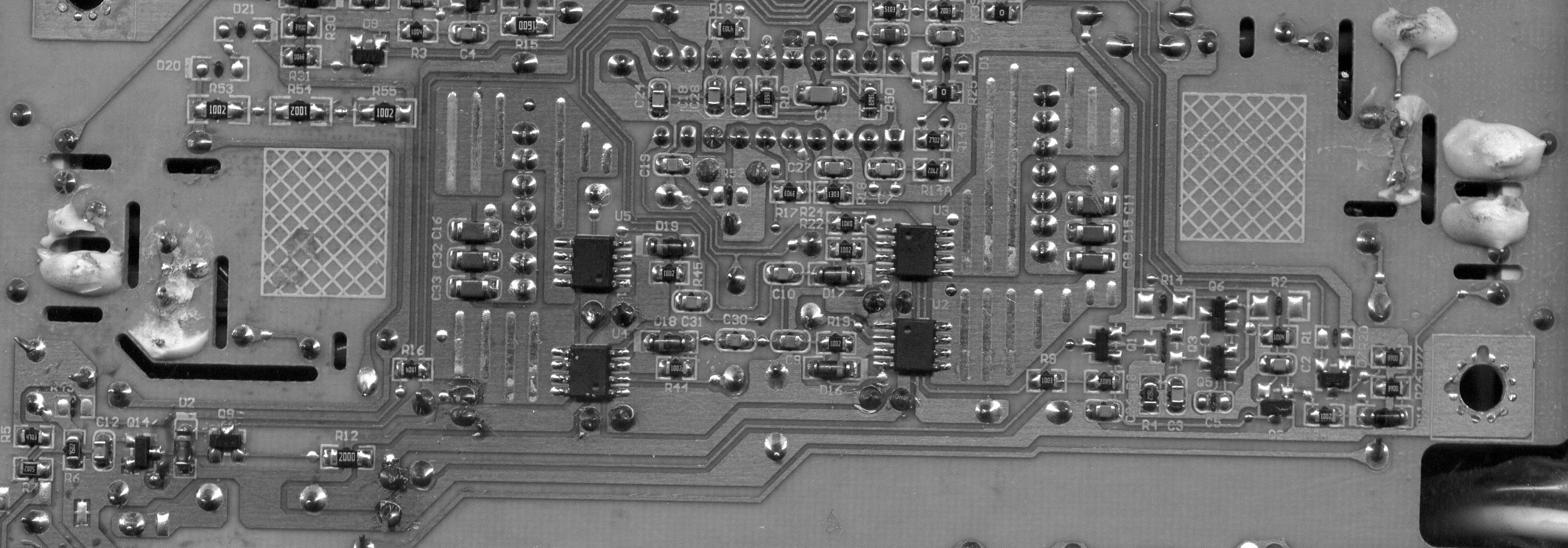

                  I attached some scans of the board, divided as I understand them and a PDF file showing the pins that connect the power board to the main PCB. I'll try to post other pics the way you asked.

                    The ADJ pin is for the backlights Dimming control, it will varies from 0~5V, the 'ON/OFF' is for the backligts ON/OFF control, >3VDC = backlights ON, <1VDC = OFF. Both signals are generated by the Main board from the Micro controller.
                    It sounds like the Power-invertr board is OK. You can easily verify that by disconnect the connection between the power board and the Main board, the power supply board is always on, it does not go off, it will be running the minute you AC applied to the board. Use a 1K resistor between 'ON/OFF' pin and the 5V pin, that should turn on the backlights.
                    Notes on functioning monitor: The backlights and the power LED will turn off if you do not have the monitor hooked up to a running PC.
                    I think you may have problem on the main board.
