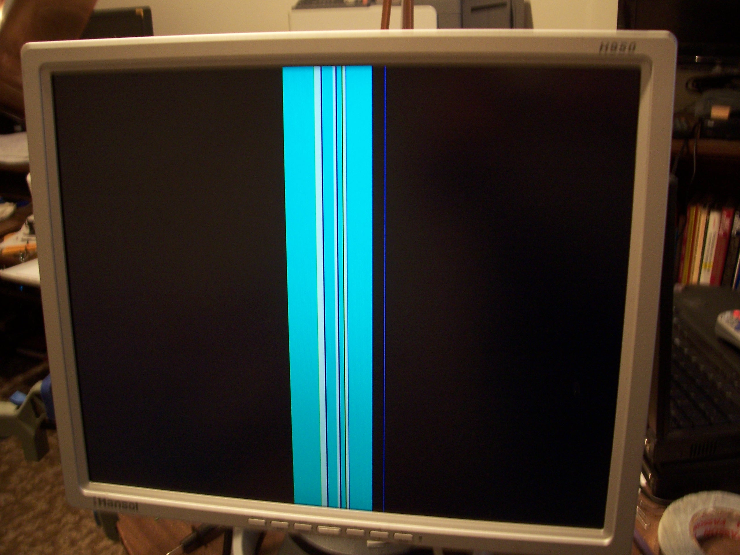

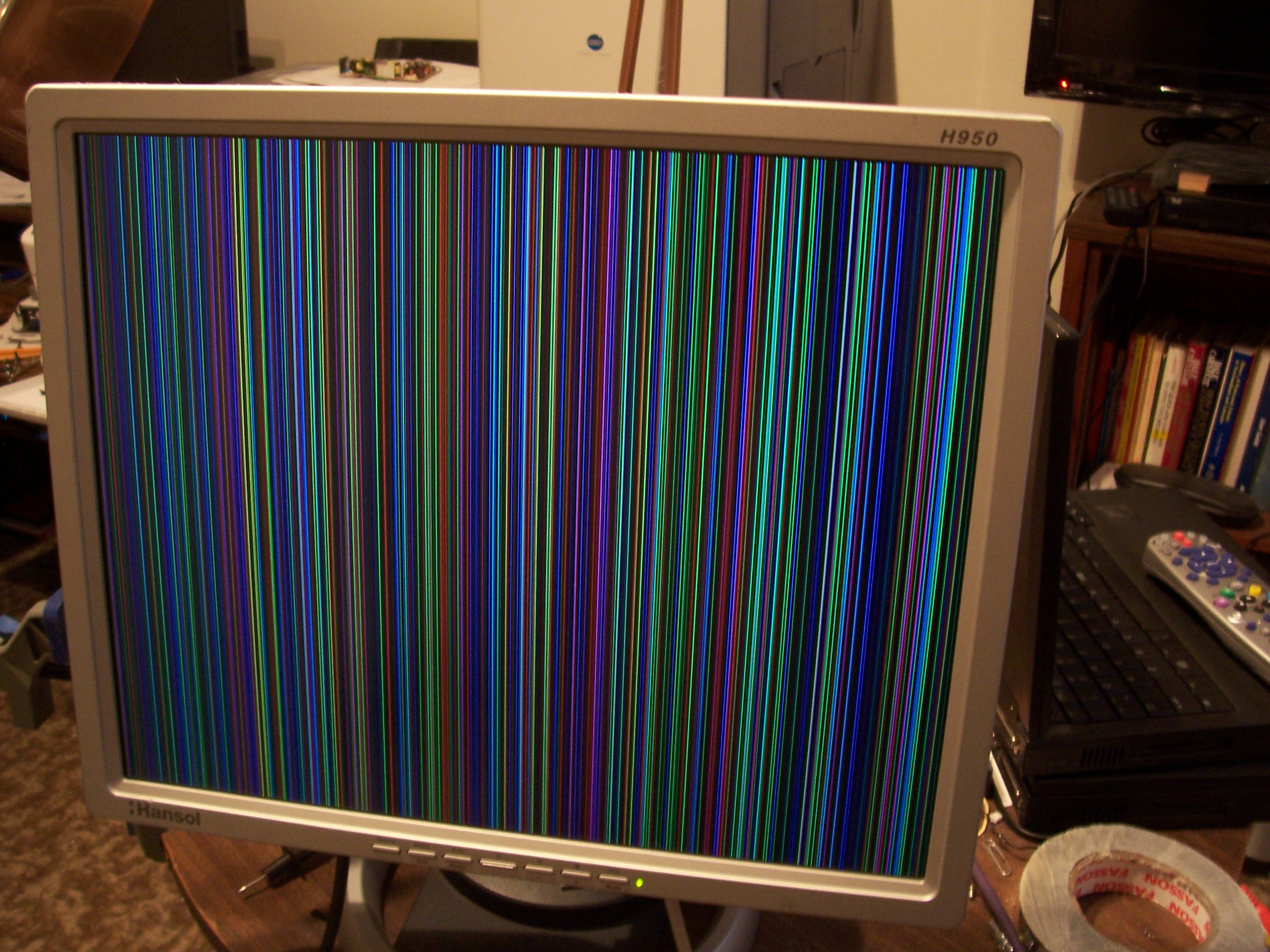

    This monitor is giving me some grief. When I turn it on it gives a bunch of pretty lines. (Photo #1) When I turn it of and back on I get lines as in photo 2 and after it warms up and I turn it off and on it works perfectly. (Photo 3). If it goes into sleep mode for any length of time the symptoms start all over again? Leave it on, attached to a continuous signal, it will work without fault. I have run it for days. I have had it apart. Replace the caps checked all connections several times. It did have bad ccfl lamps which I replaced. Anyone have a similar experience? I posted on this way back and have not seen anything to narrow this down to solve the problem?? I find it very difficult to get reading with it working/not working

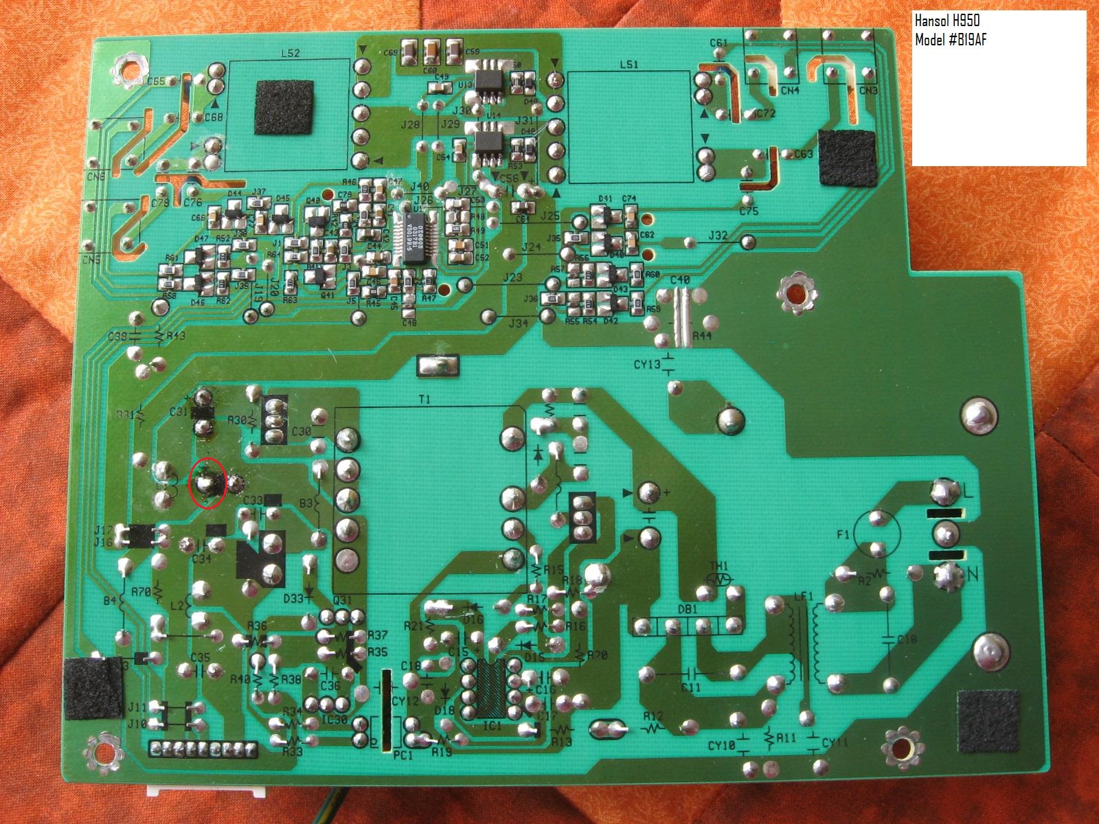

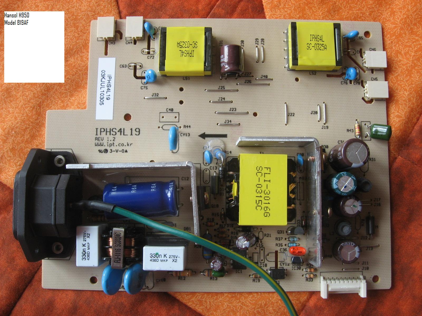

      Thanks selldoor on second look I replaced the large caps only 1000uf @16v Its been awhile since I did work on this one can't remember why I didn't replace them all. The remaining caps are sam young. I will replace the other caps and report. Sorry I have 4 or 5 in slings here right now I have to stick to just one. Here is a picture of the power board the logic board on this one is soldered to the chassis and I haven't removed it to get a picture or done any work on it.

            Thanks budm I have replaced the other caps on the power board and two of which I did not have equal value. I replaced the 0.68 uf@50 with a 1uf@50v and the 47uf@50 with a 47uf@25 and all seem to be working for now?? Any comments on the substitutes?

              0.68uf to 1.0 uf is probably ok at the same voltage (just check it was 0.68
              68uf 50v is often a startup cap size)
              It could be that the 47uf50v was the startup cap in which case you should really get one the same value as you will be putting a lot of pressure on a 25v

                I think the 25V should be okay. Most of the SMPS IC VCC are in the range of 12-16V. I think manufacturers chose 50V either for more ripple or lower ESR?
                Obviously, it would be easy for davg to verify by measuring the DC voltage across that cap.

                        Thanks guys appreciate it. I may pull it apart again just to check the voltage across that cap as suggested by retiredcaps. But it do seem to be working fine right now. oops when I take the power off and plug it back in the screen shows very bright. When I check the menu the brightness is at 70 and the contrast is will above 100? Holding the - minus button for several seconds will reduce the contrast down to 99 - 100 and it is ok but once I take the power off again I have to make the adjustment again. I guess I will have to pull it apart again.

                          I did a factory reset and the unit seems to be working just fine even after unplugging and plugging back in. Will leave it for a couple of days to see what happens.

                            Thanks to all for the support. This unit have been running for nearly a month now and I am considering it another success.
