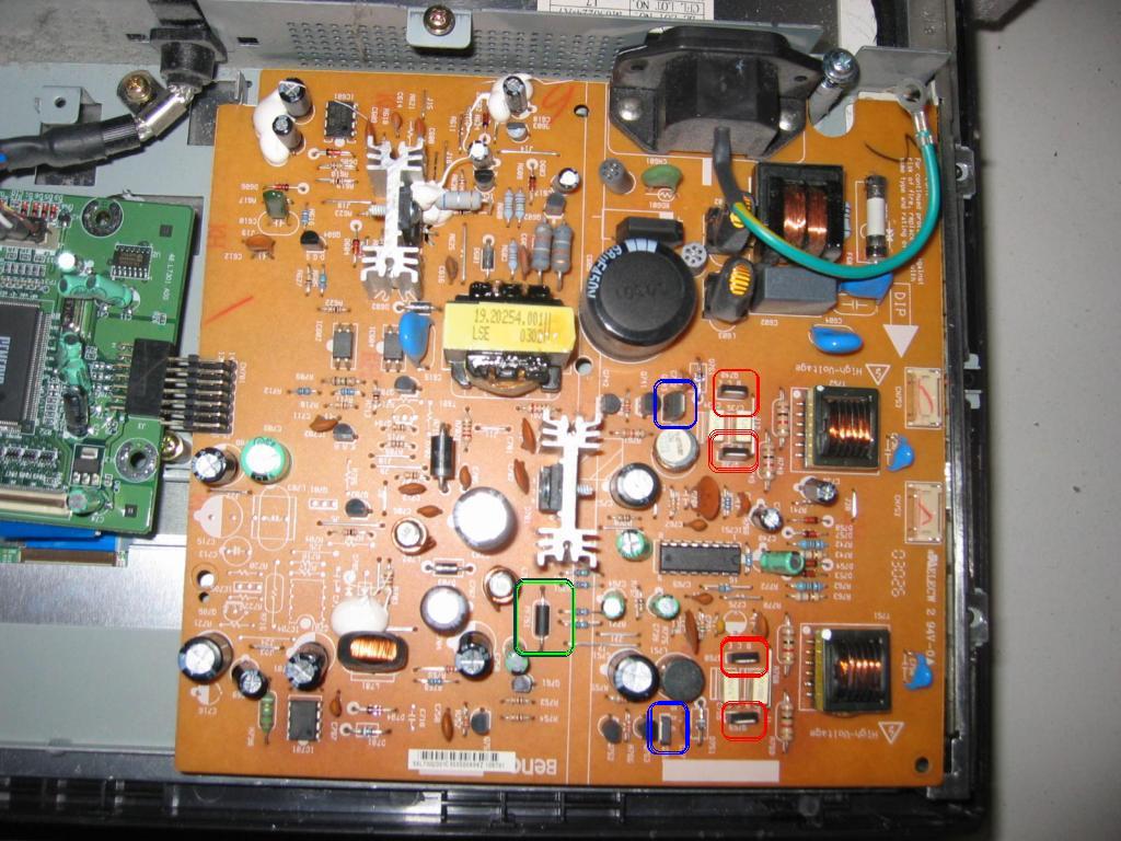

      I'm not sure how to find the board version but here is what it looks like.

        You can see 2 pairs of small white capacitors on the right hand side of your photo, in fron of the inverter transformers.ech of these pairs have 2 transistors around them.You will probably find that one pair of those have gone short circuit,and will need changing, and the transformers etc need resoldering.

          The 2 small white capacitors, transistors, and transformers and their solders all look okay; but I'll go ahead and try re-soldering them.

              This is a fairly common board. It's a Ben-Q variation. The C5707's are often shorted. at least one (circled in red)
              They have repair kits on eBay for this board. http://www.ebay.com/sch/i.html?_odkw...c5707&_sacat=0
              You want to replace the C5707's circled in red. Check the picofuse and replace if needed (circled green). And once I had the other transistor shorted. (2 - circled in blue)
              Just make sure to resolder the inverter transformer legs or it'll take out a transistor again.

                  As with capacitors and as selldoor says, you can't go by looks. You have to test components properly or you'll spend a lot of time looking in the wrong places. A very nice procedure has been written by retiredcaps in this forum (find it using t=18301) in the discussion for an E152FPb monitor with the same issue, and similar build, as yours. Apparently since the power led is on, there may be no issues with the power supply and the problem is in the inverter section or the main board. So the first thing to do in this case is to make sure the inverter IC is getting power. Simply put: no power to the IC, no picture. Looking at the photo in your post, I believe this is the 16 point IC directly and 0.7 of the way down from the power receptacle on the board. The IC used on the E152FPb is part no. TL1451ACN but you can check your board to see what part is used and from the datasheet find the VCC and GRD pins to measure voltage between these two points. Typically, it's 12 to 14 vDC. What are you getting?
