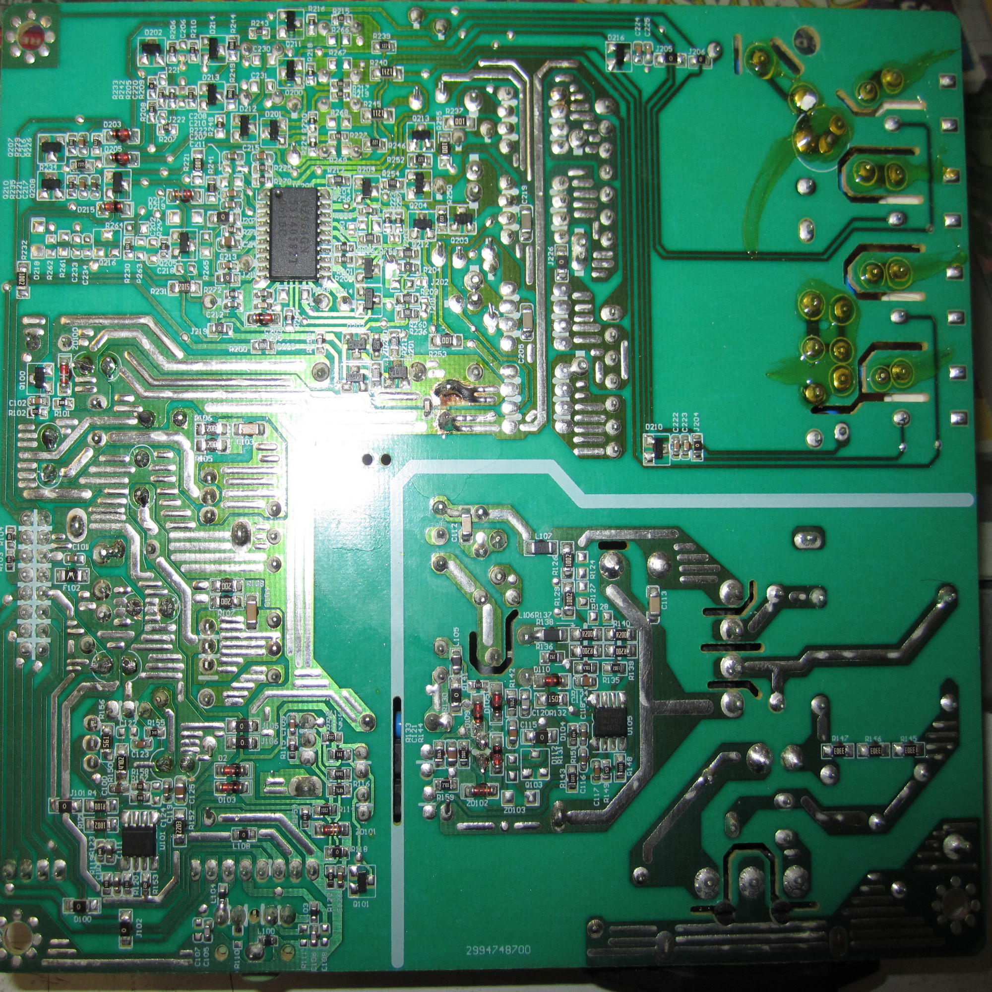

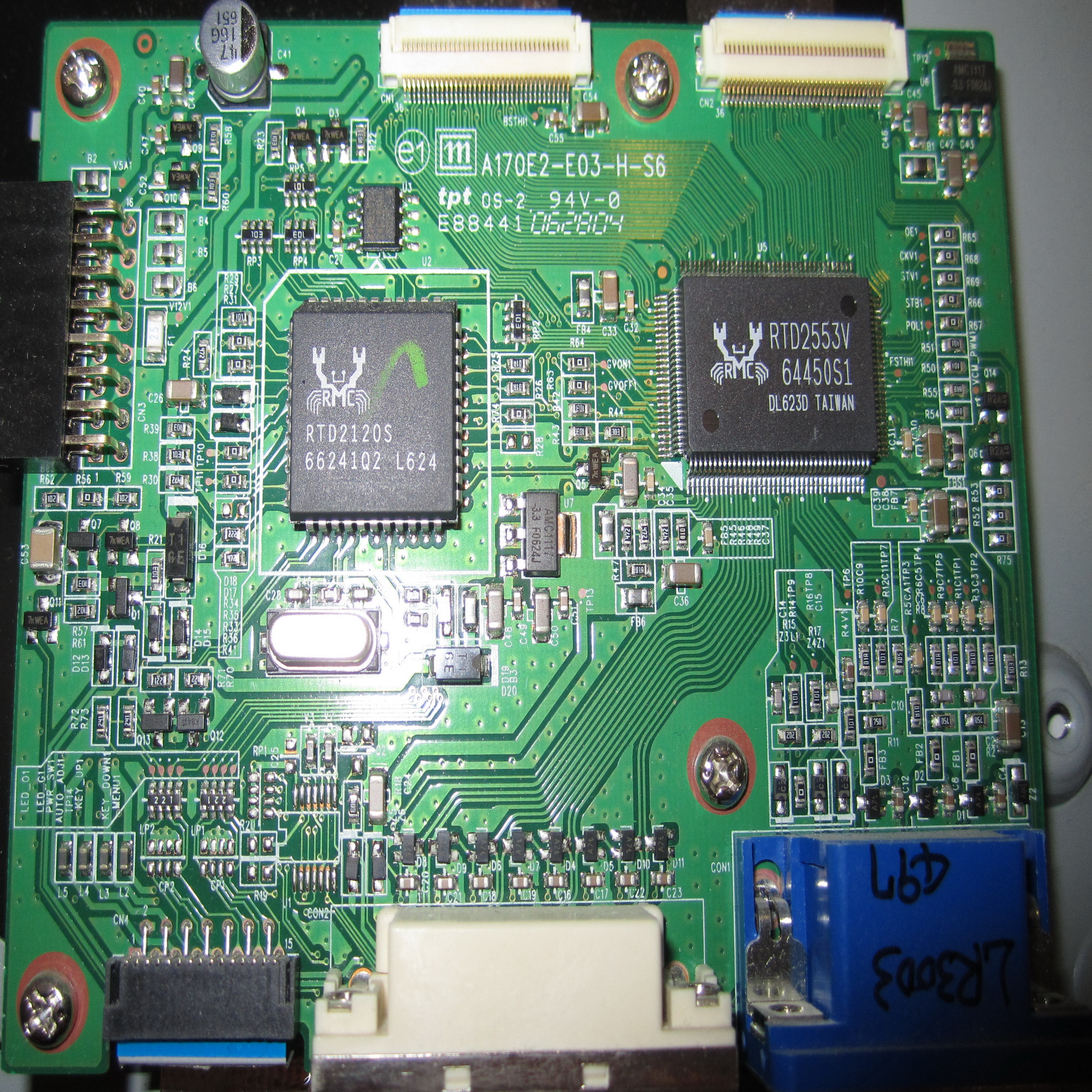

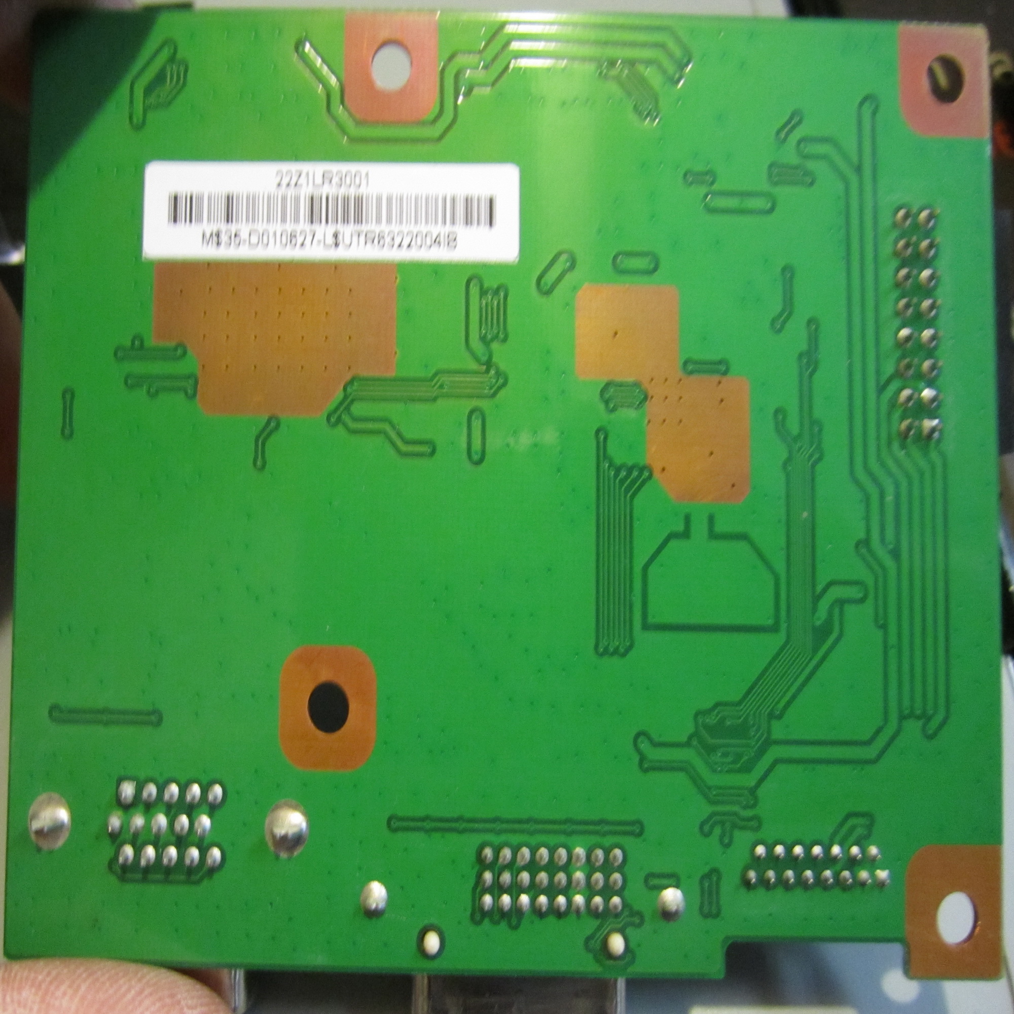

    I managed to take the pictures of both boards that were right next to each other. If you need any other pictures i will gladly take pictures.

      Re: Repairing a vx2235wm
      i have the same board in my viewsonic i shorted the pins on u6 when measing voltage.
      now i need to find what i shorted out on the main board is there any plans showing this board.
          I mean my monitor would not start and i was testing volts ont the main board. but shorted out the pins on a voltage regulator at location U6 with the prob of my meter. now there is more damage to that board and have to find what i fried.
          Now im looking for some help and or the schematics.
            Abester- I am not certain about the secondaries on this board, I have marked where I think they are. With the power off set your meter on 2000 ohms and test S1 to S2 and S3 to S4. (2000 may not be high enough one member reckoned he got 128Kohms but we never got much further)
              These are the two pins for the secondary winding.
                  Okay bare with me as I have not used a multi-meter before. Could you possibly tell me how to do it? I have been meaning to check out some Multi-meter tutorials and how to use them, Maybe i will do that tonight.
                          With buds pictures showing the secondary windings. The top two measured 371.25 and bottom two measured 368.20.
                            Abester =Ok They look to be correct- Do you have any spare lamps you can use to test
                            old monitor/laptop - There is a section at the end of the 2 sec to black guide where Budm show a modified cfl bulb for testing

                                #35
                                Yes - that is ok - I have said they appear to be correct- so we now have to move on to the lamps and lamp wiring

                                          #40
                                          Its the video board I have one out of an acer. it look almost the same. And screen stared right up. But wrong epromp or what ever you call it. So it was like split screen on one monitor with a black bar runing up and down screen. Guss I will have it fix the orgnal or find a new one
