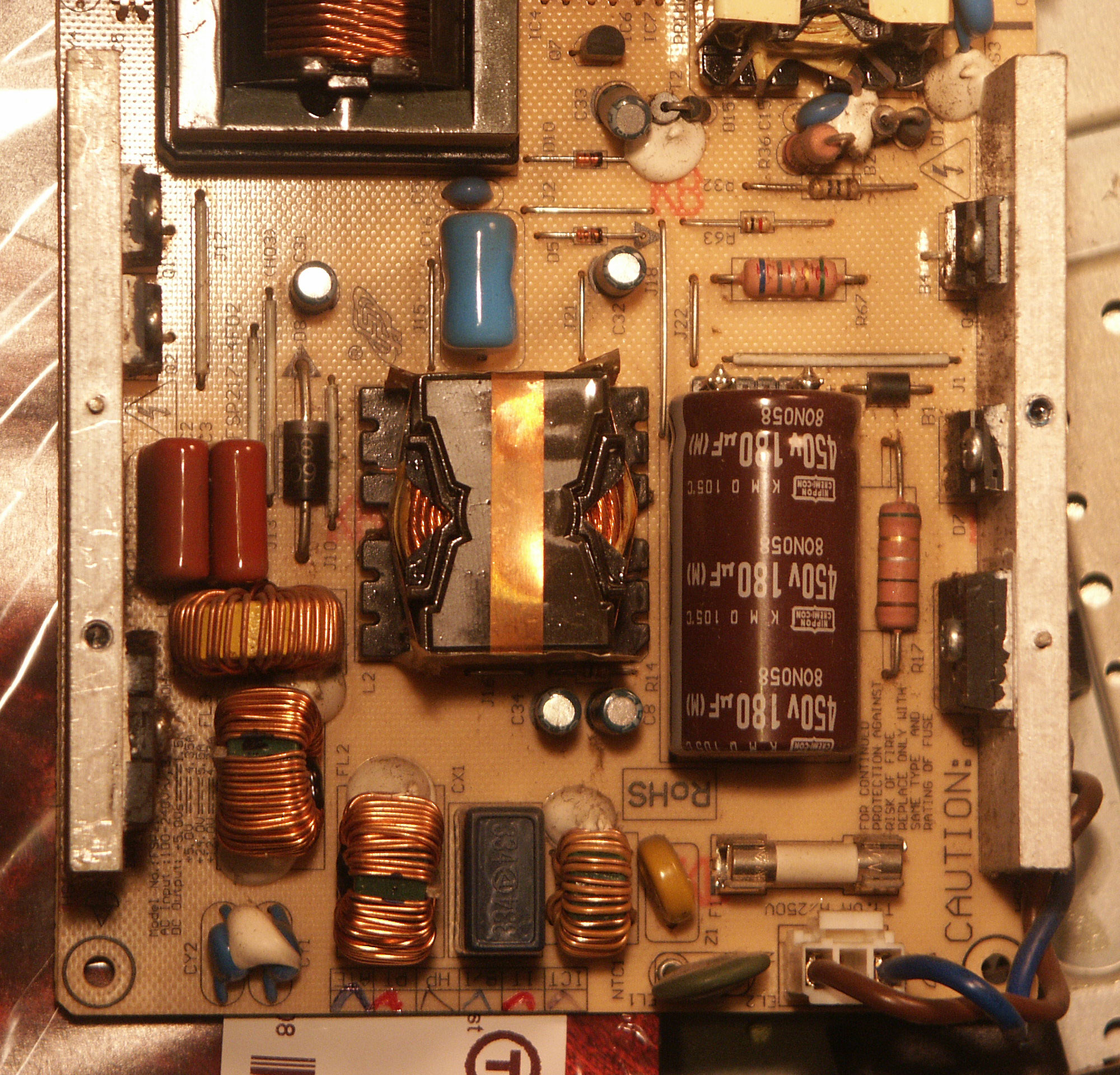

                  You could try posting decent pictures to see if we can see anything wrong.
                  The caps from the SB may not be good - what make /series - for a power supply they need to be good quality low esr.
                  We can help a lot more if you please post good clear pictures of the whole chassis, and then pictures of each board, front and back and close up of connectors, (max resolution 2000x2000 and 2MB) using the manage attachments button, which is found by clicking "go advanced" under quick reply.
                  Examples of what is needed

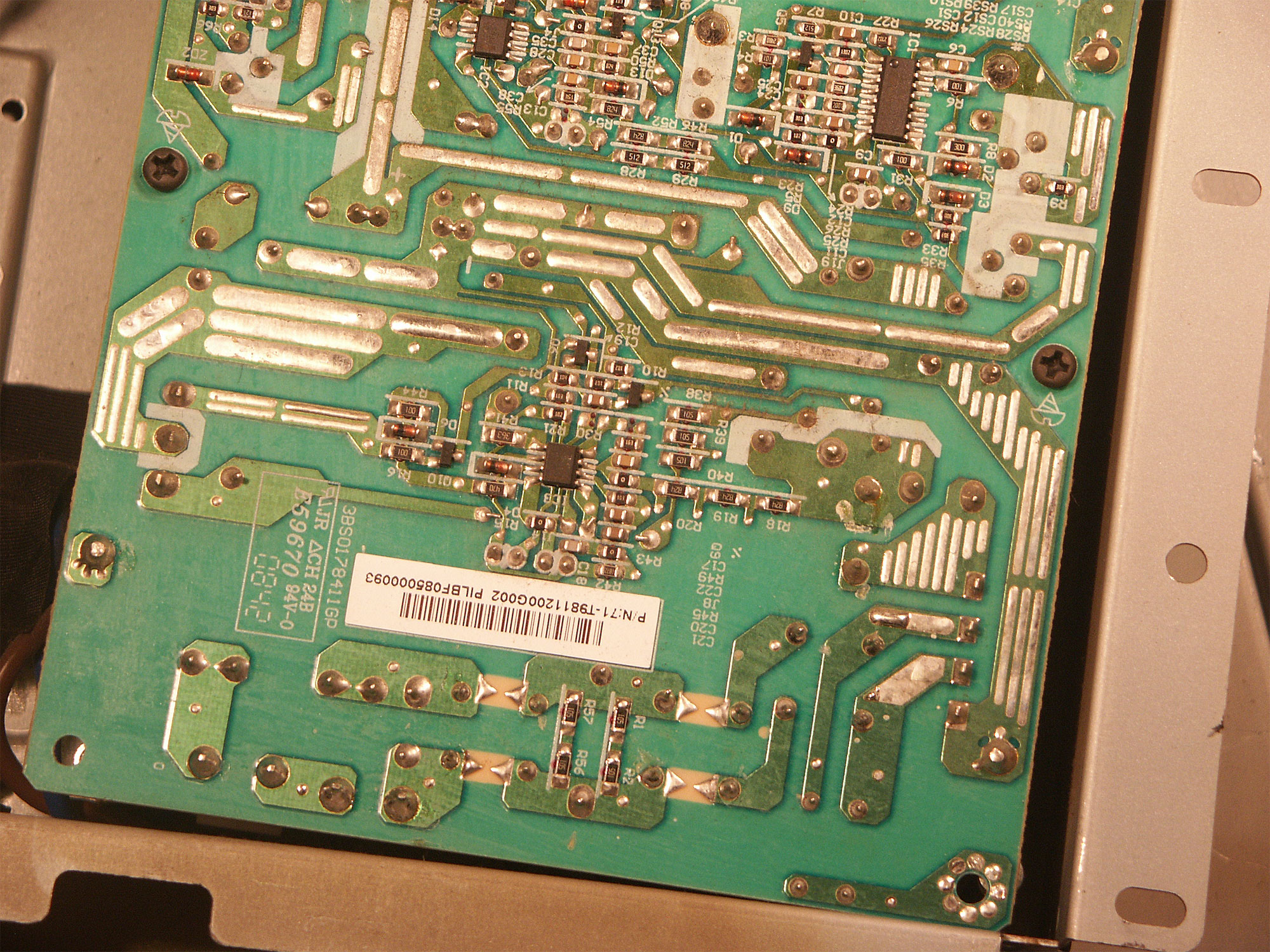

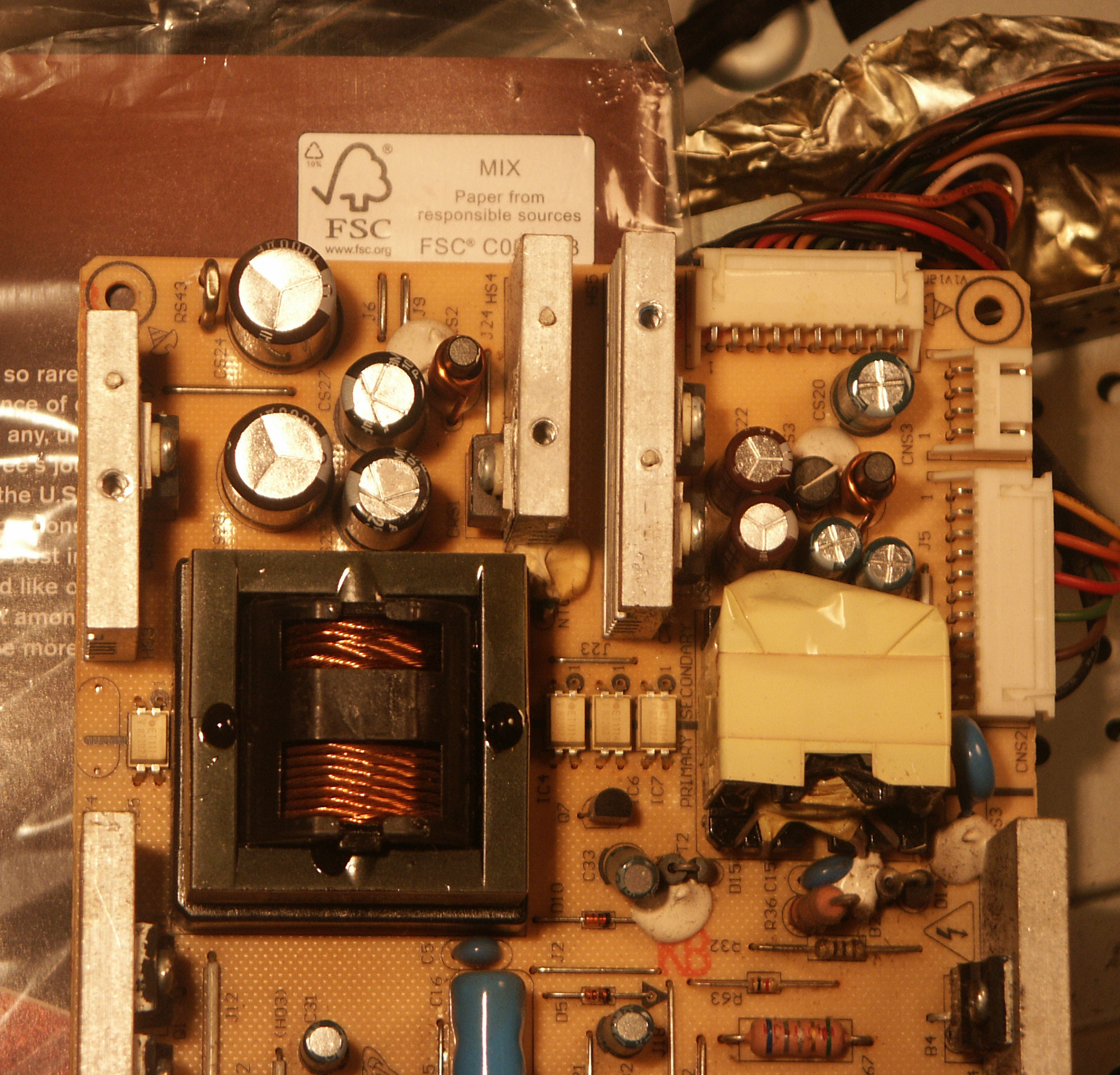

                      Re: Hanns-g HG281DJ stuck on self test after changing caps
                      Here are the pics, I should be able to get them slightly sharper when the sun comes up tomorrow.

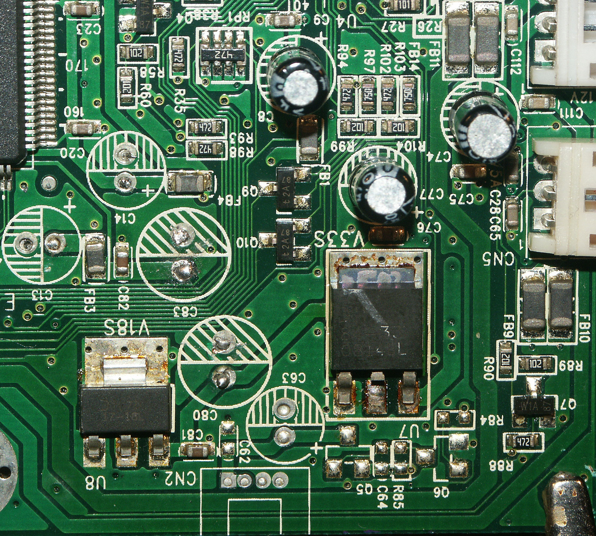

                                    I just got a good close up pic (the second one) of the area that I have attacked.
                                    The U7 voltage regulator solder is brown and crusty looking, it was like that before I touched the board (honest guv, I have a pic to prove it).
                                    I later got some solder on the rear side of U7 which I had to heat to remove, so I could well have fried it.
                                    Here are the measurements from left to right as you look at the images.
                                      U8 ia a 1.8V (You can see the V18S printed next to it) fixed 1117 series LDO regulator, it is bad!
                                      U7 is 3.3V (You can see the V33S printed next to it) fixed regulator. It is OK.
