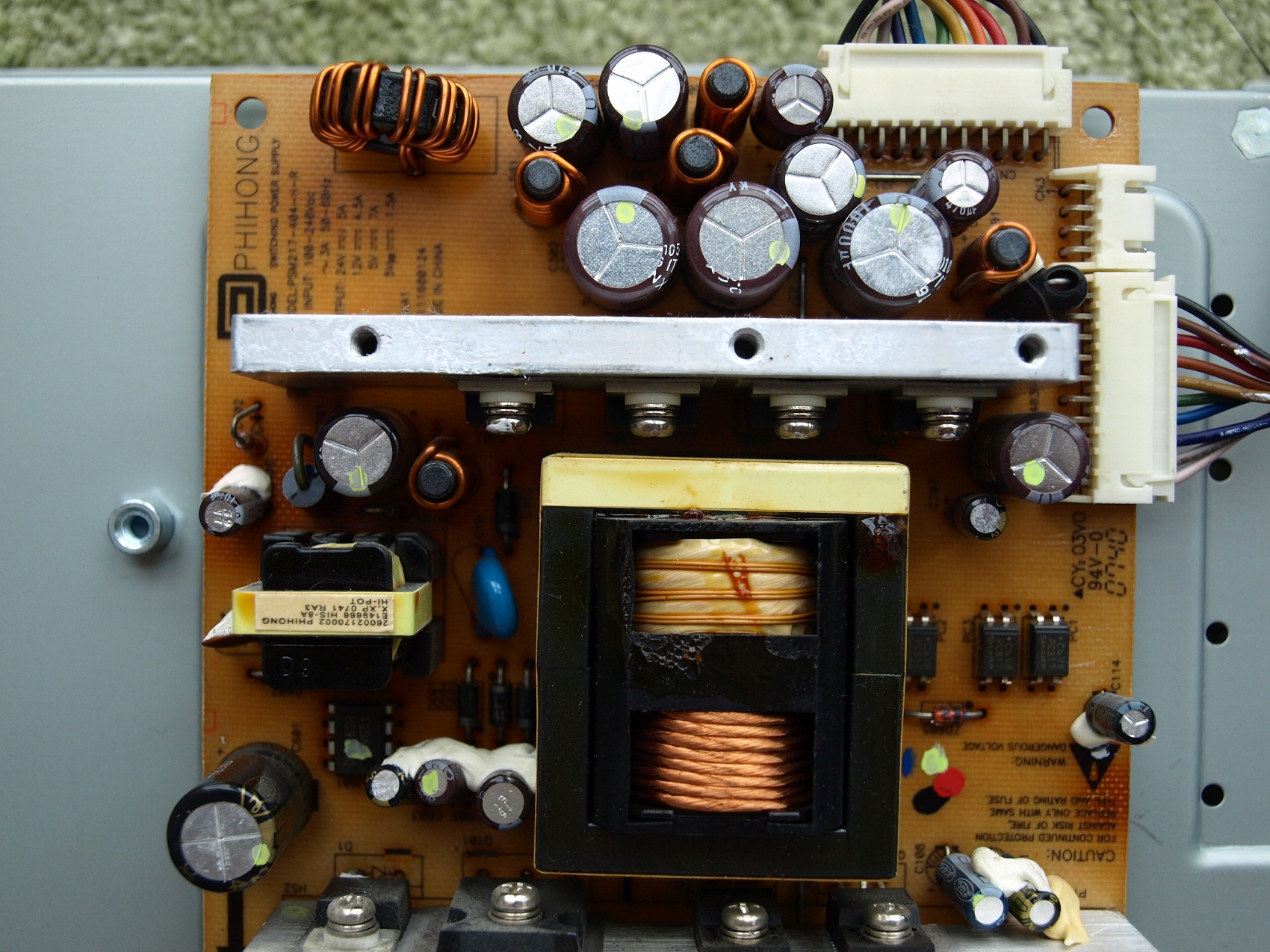

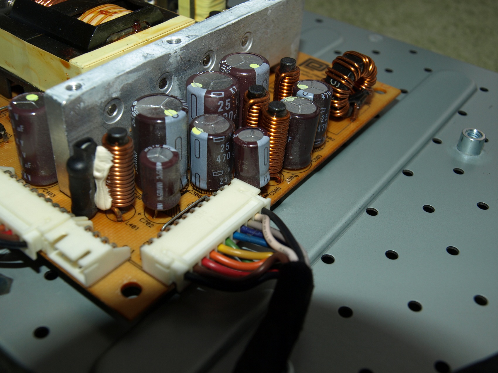

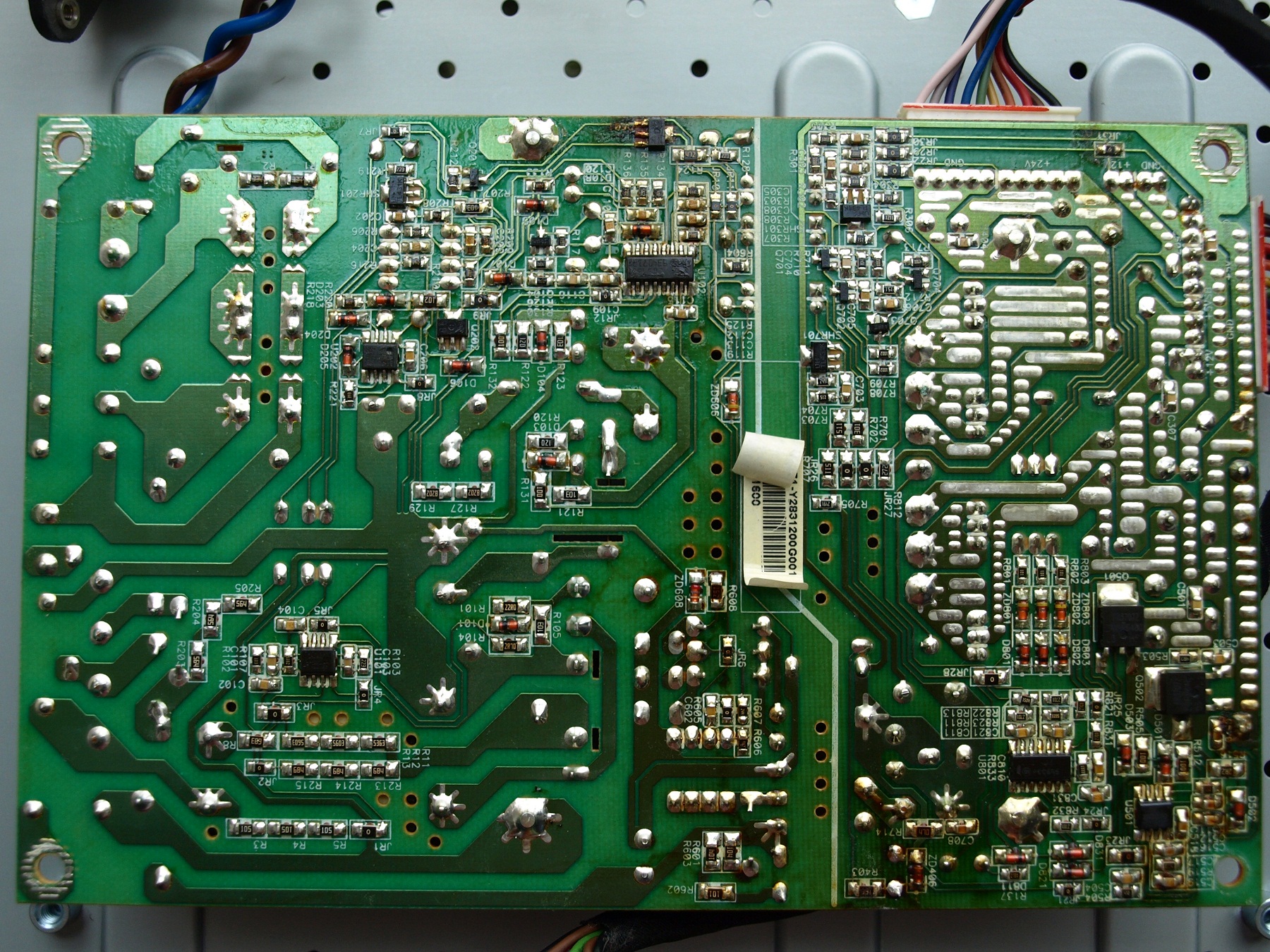

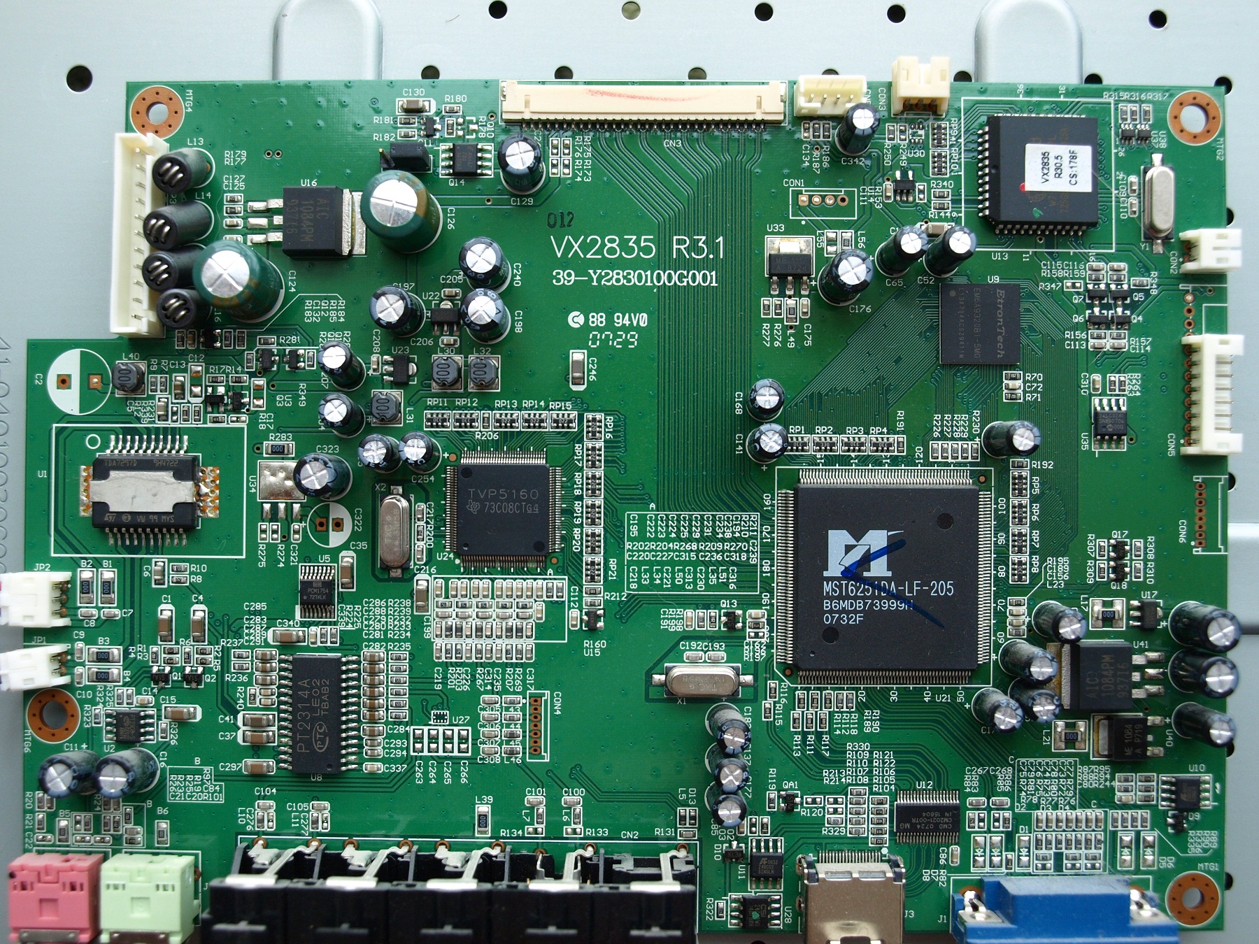

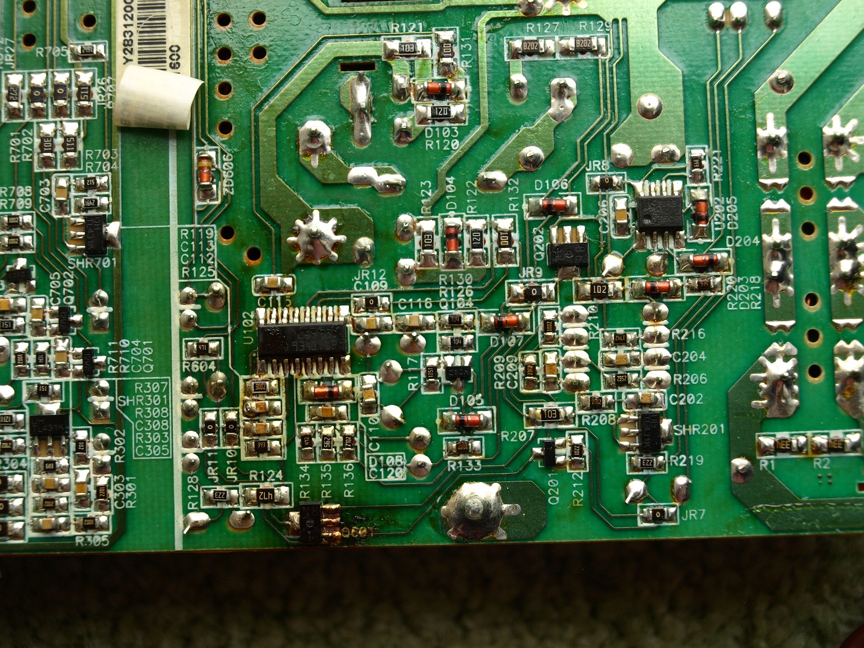

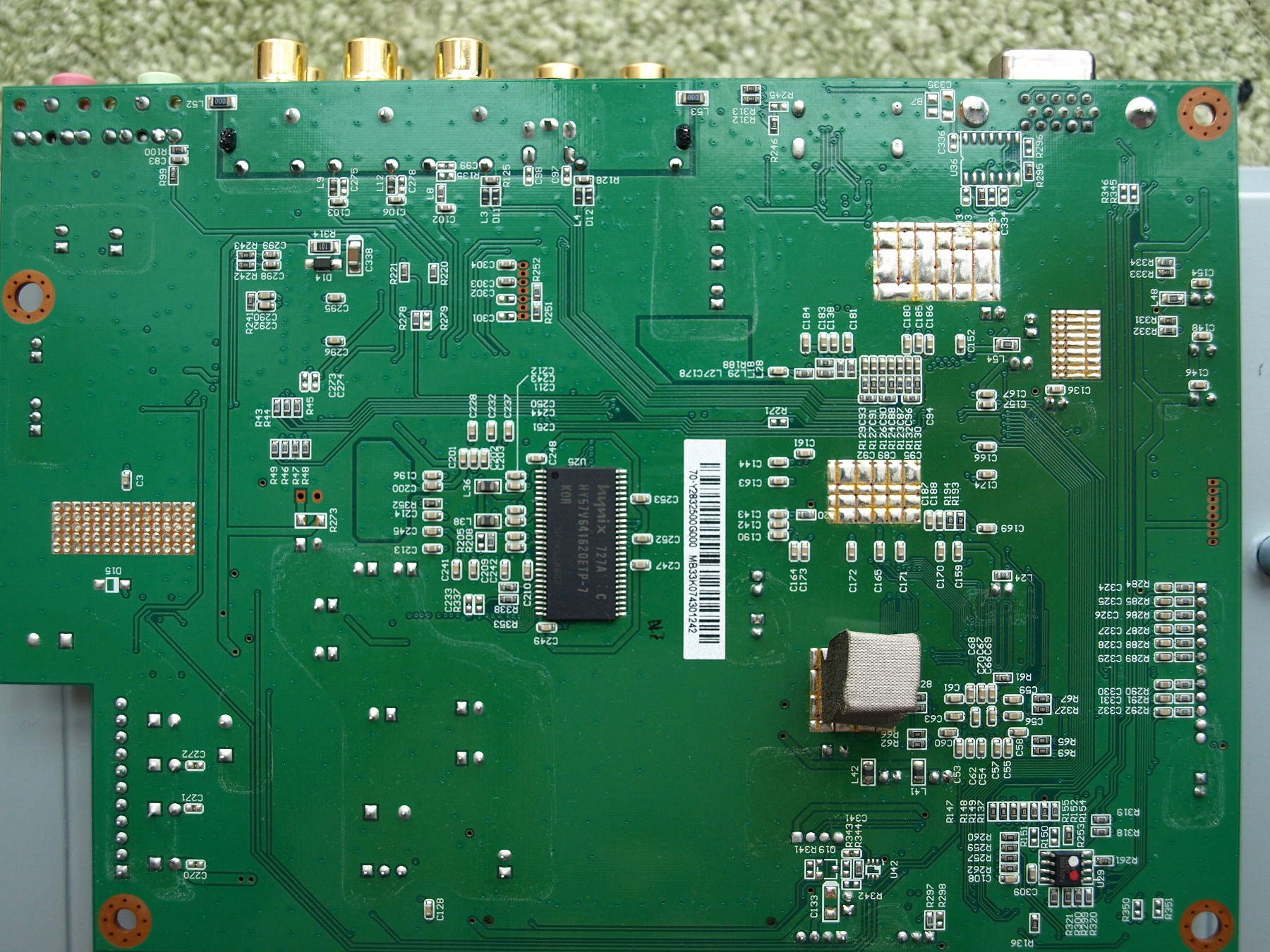

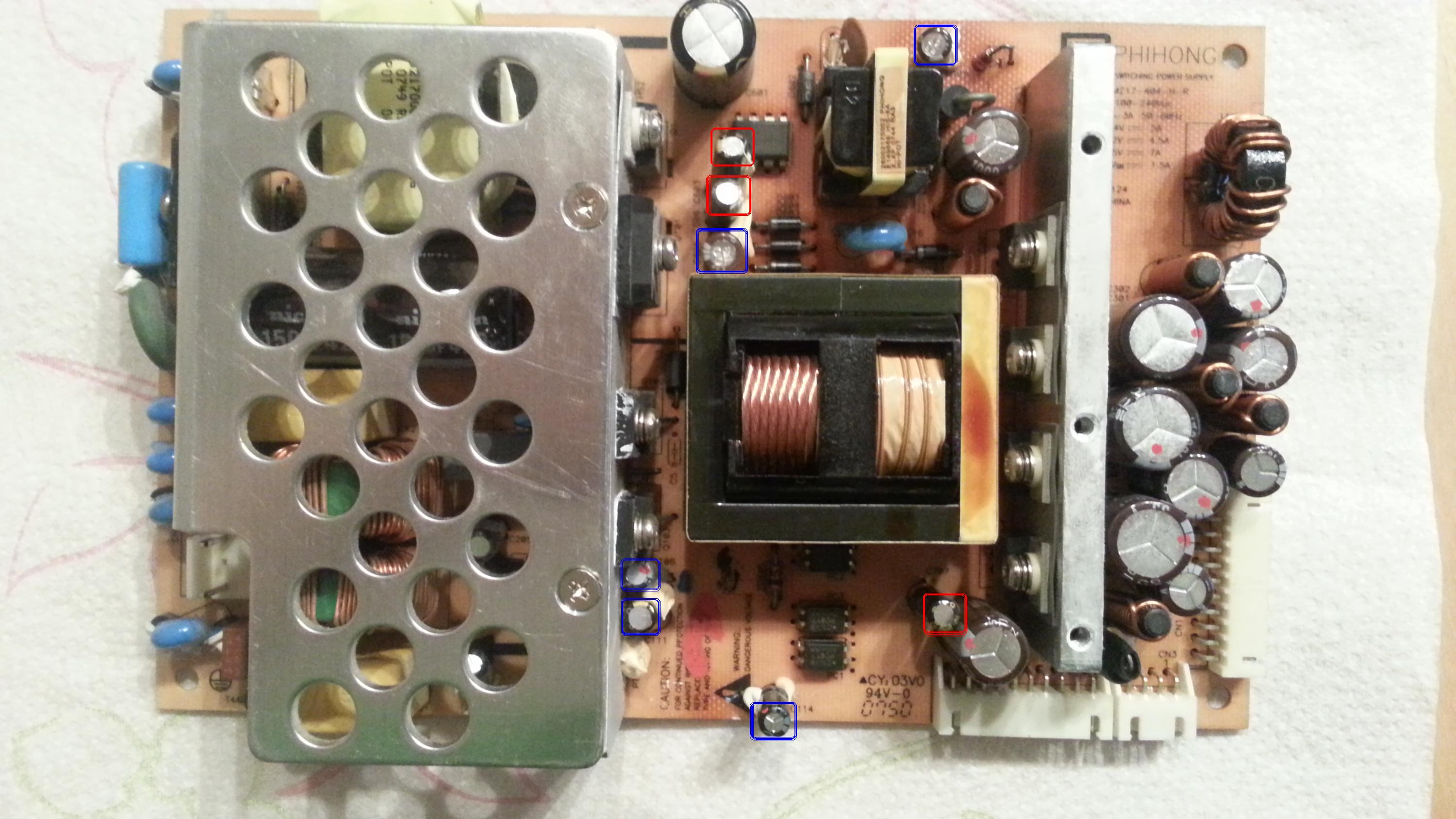

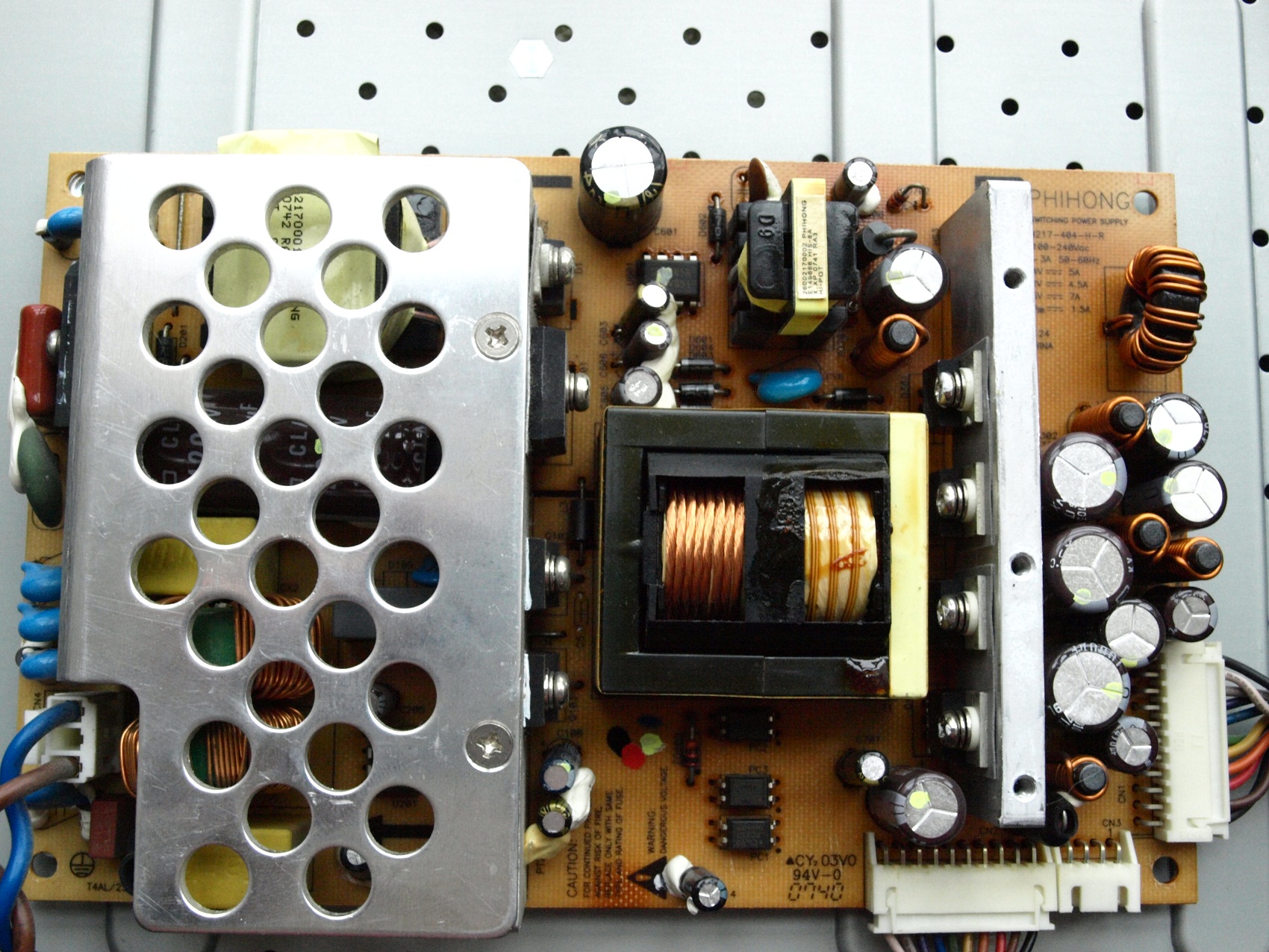

      Hi Guys,
      Well i managed to take apart the monitor without any breakages and went about photographing the appropriate parts today when i had some good light.
      I uploaded 8 photos, which i hope isn't over kill, i just want you guys to get a good look at what i am seeing.
      The first thing i noticed (and i am a novice at this) was the distinct discolouration on the power board and the definite areas that looked burnt - black/brown with some sort of residue there. When you held it up it also smelt pretty burnt as well.
      It looks, from what i have read on the other posts, that this power board has been running very hot (same as the Hanns G) during its life and has essentially burnt out - capacitors/circuits?
      So what i am trying to establish with the help of the forum is whether it looks, from my pictures, that it could be saved or whether it really is set for disposal.
      If you need more specific area photos please let me know.
      Thanks in advance to the folks who can chime in with some help here.

        Never overkill when it comes to photos, since it's the only thing that forum members have that they can use to help diagnose the problem. Looks like they used some quality caps like Chemicon KY series, which is probably why you got 5 years out of it. They also used some low quality Lelon caps.
        Looking at your photos, there seem to be some bulged caps on the logic board: C198,C124 and C126. If you do a search on this site for VX2835Wm, you'll find these caps have caused problems for others.

          The power board looks OK, yes, it's a bit dark but that's in places expected to be hotter, like the transformers.
          The capacitors are a good brand and a good series, so I don't think they're a problem.. though it wouldn't hurt to check them if you have some way to do it.
          The video board on the other hand... it looks to me that at least the two capacitors by the linear voltage regulator are looking swollen.
          I'm thinking of C124 and C126 ... that chip between them is a linear voltage regulator.
          Its purpose is probably to convert whatever comes from the power board from to 5v , or it converts 5v from the power supply down to 3.3v
          If you have a multimeter, put it on Voltage DC.
          With all the boards connected and monitor turned on, put the black probe on the ground (one of the rings on the corners) and then put the red probe on the pins and the tab.
          Measure the voltages on all those pins and see if the output is 5v, 3.3v or 1.8v
          There's another capacitor that looks bad, c198.
          You might also want to check C176 , near another linear regulator U33 - check the voltage on the pins of that regulator, it's probably for 1.8v
          There's another linear regulator U41 ... check the capacitors around it and the voltages on the regulator.
