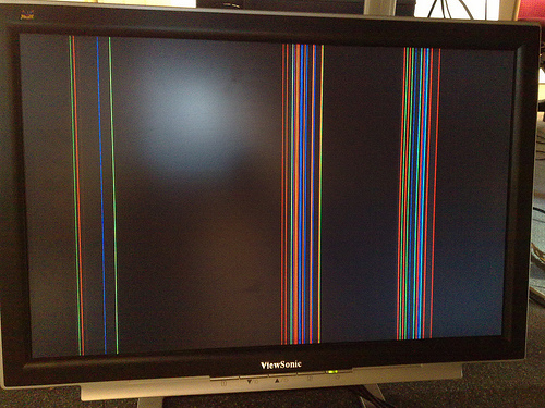

    Hello to everyone.
    I got a broken Viewsonic LCD here.
    As i wrote in the topic, when i turn on the LCD only
    bright vertical lines (in blue green red) are viewable.
    (they are getting brighter at the beginning... like a cap is getting loaded)
    Here a picture of the Lines and some caps from the board which is connected to the display (seems to be for the lcd lamps... but the bright lines look more than a data connection failure ?)
    Hope someone got an idea =)

    Re: Vertical Multicolored Lines Viewsonic LCD
    You will probably find that you need a new Screen.
      I have fixed a 42" Vizio Tv with a similar looking problem and it was the famous U33 vdo on the mainboard.
        What does it look like when you have a video source hooked up? Do you get any video? Do the lines always stay in the same spot or do they move around?
          Hello.
          The picture was while the video cable was connected.
          I also activated the 2nd display in windows and moved a window on the broken screen... but the lines didnt move.
          The only thing i saw is, that the lines where "moving" when i turn the sceen off and on again.. -> so the lines donΒ΄t move in that way, but are always on another position when i turn it off and on (also the color varies)
            You can try cleaning and reseating the flat ribbon cable that connects the logic board to the LCD panel.

              In my experience (which is entirely with one particular brand of LCD TV) that would more likely be the LCD timing control board, or even the main board, than the LCD panel. A bad cable connection is also possible.
                Try applying some squeeze pressure by the offending lines from the outside of the case, or better still directly to the panel. Like, pinching it. Does anything change ? If so, it may be the panel de-laminating, in which case it has to be replaced. If no changes are affected by doing this then pursue the cabling connections and control board.
                  I'm betting on low 5V or 12V to the t-con; I've seen it before on a TV.
                    The U33 component is a voltage regulator that delivers 3.3V to other components on the mainboard. This is on some Vizio TVs. Check all the voltages, see if none of them is a bit lower than it should be.
                      i already disassembled the hole screen....
                      have to try what happen when i disconnect the small ribbon cable... if there are those lines too...
                      @ tibimakai - ok, i will do that next weekend
                      So nobody thinks the green caps maybe can be the issue?
                        So i disassembled and assambled the whole monitor, same thig happen.
                        Vertical bright colored lines.
                        The voltage on the power board are correct.
                        I made some pictures again, maybe someone can tell me which component could be broken ?
                          What I was refering to is a VIZIO TV. You have on the mainboard a U3 and U5, check those to see what kind of voltages do you get at each pin.
                          There is a T-con board somewhere? Pictures?
                            Hello.
                            In the wohle monitor were only those 3 Boards... (the yellow and green one are connected by the power connection)
                            The number after the U stands for something or is only numbered?
                            Or is there another board where i put the other side of the data cable?
                            (never looked up there...)
                            add:
                            Okay i googled it.. damn... never tried to open the rest of the case
                            Is it possible to repair a t-con board ?
