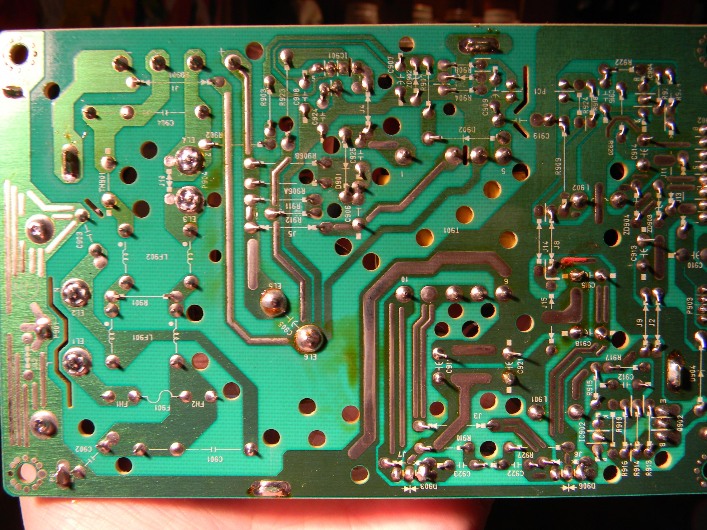

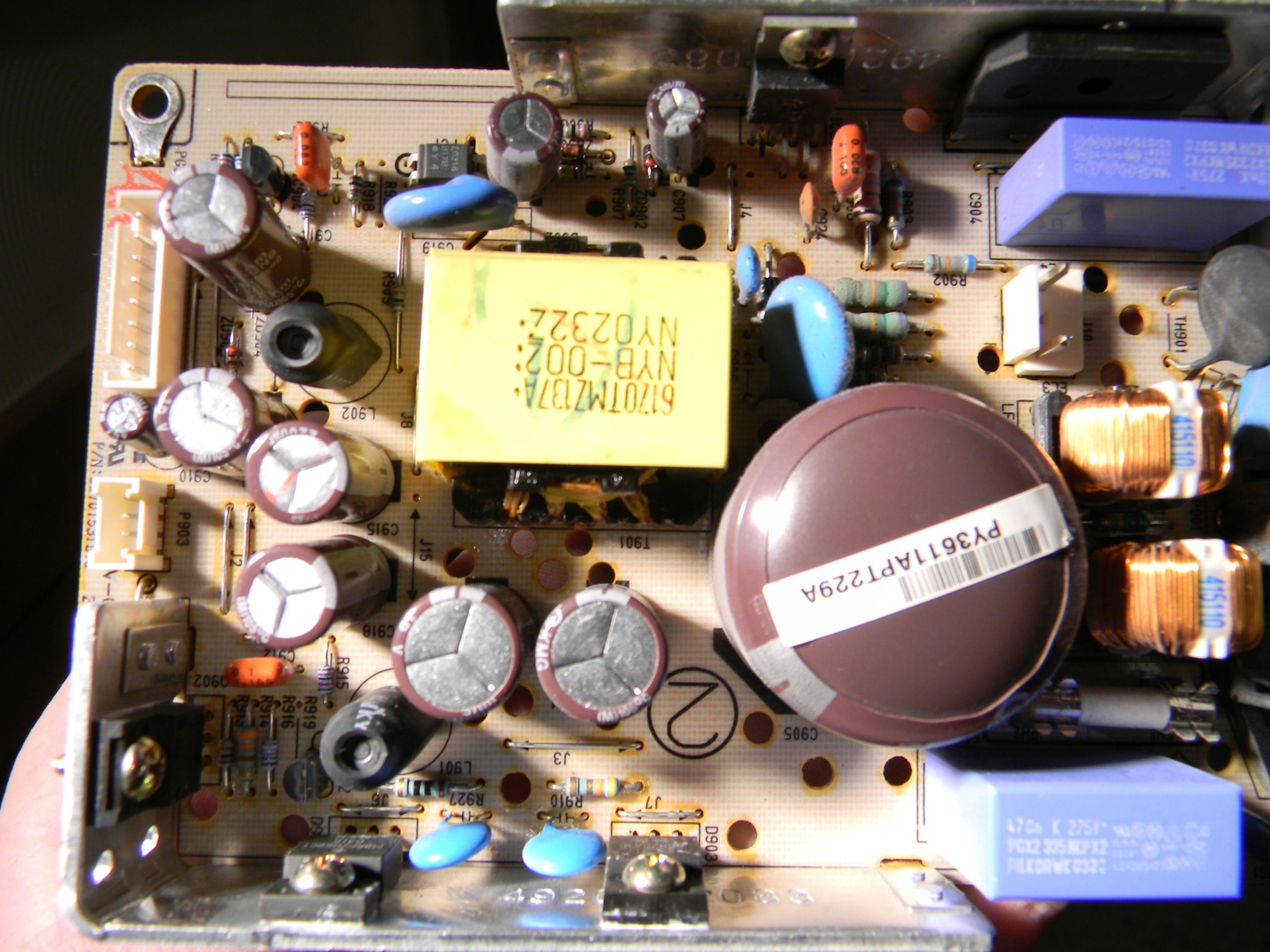

    Hi everyone, I'm new here and am hoping you can help me with my problem. I recently acquired an LG Flatron L2010P LCD for free and am looking to repair it. The problem with it is there is no picture and no OSD, however the backlight works and the power indicator light works. I have pulled the monitor apart and looking at the power supply, there is no visual bulging from the capacitors except for the large 400v 150uf which I'm guessing could be the problem.
    Attached is a top and bottom view of the board.

    What is the DC Voltage across the big cap...I'm presuming you have a Meter, and please note you are probably looking at approx 165volts DC, as the Mains in Canada is 110volts AC ??? dont be confused,the Dc should be about 1.414 of the AC.

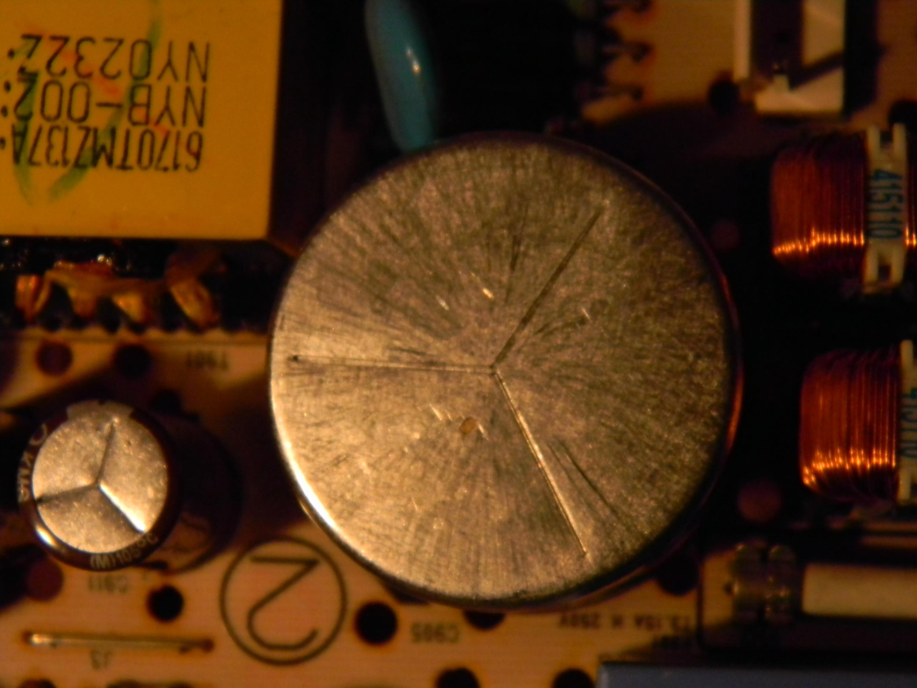

      Please press the top of the large capacitor to see if the plastic disc seems "tense" or if it easily goes flat.

        EDIT: The large capacitor is hard as a rock.

          If the plastic disc can´t be suppressed the top of the capacitor is likely bulged. To be 100% sure you can easily cut the plastic film in the capacitor to remove the disc. I you do so, make sure the capacitor is discharged first (even though it may be broken). And post a new picture of it as well

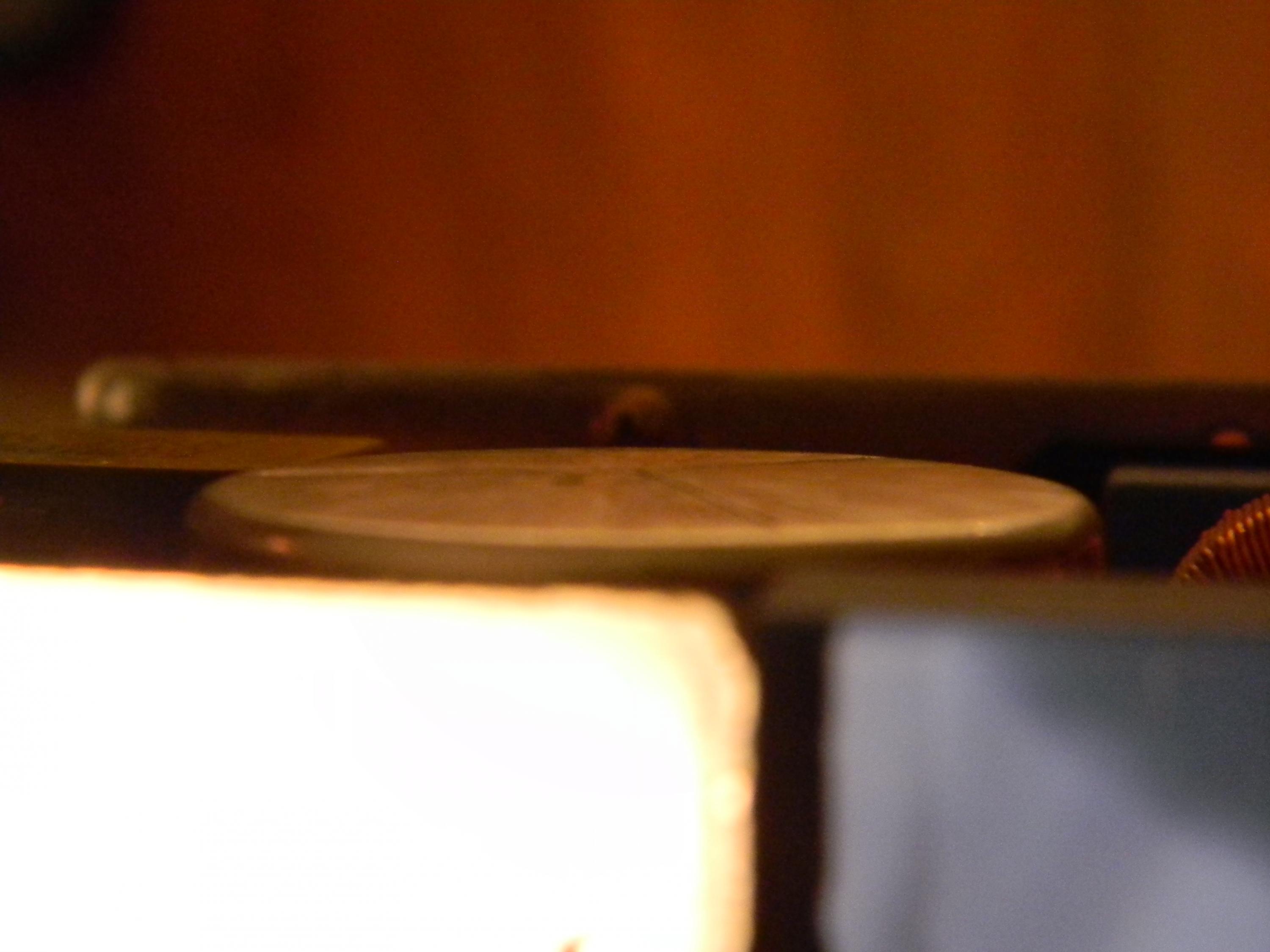

                    Ok, I tried two old PCB's I made years ago. One is a roulette machine and the other is a circuit tester (red and green led to test + and -) both require a 9v battery. I connected them to the leads of the capacitor and neither had any charge. Tried the screwdriver to confirm the capacitor is fully discharged.
                    EDIT: Took the plastic off and I can't really tell if the capacitor is bulged.

                      Well, when I meant almost any resistance will do, perhaps I should have mentioned that if the capacitor was charged and had a couple och hundred volts on it, you shouldn´t use any sensitive equipment to discharge it with. Something that runs on a 9V battery doesn´t like to be feed with 200V, not even for millsecs... A light bulb is much more rugged.
                      The only thing more you can do now without a multimeter is to confirm that the large capacitor is broken/bulged and either change that one and try if it works, or change all the capacitors on the board while you´re at it. It will only cost you a few $ more and you don´t have to think about it again.
                        Hmm, no it doesn´t. Too bad, otherwise this might have been an easy fix.

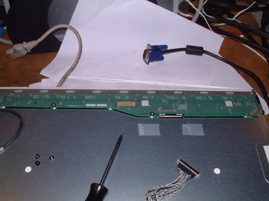

                          Is it possible this could be an even easier fix than I thought and just be a video cable that needs to be replaced from the main board? Obviously if the backlight lights up the inverter should be good, it's just not sending a video signal to the LCD?
                          EDIT: Found another thread with a similar problem.
                          I also think I found the service manual for the mainboard.
                            1) Your big cap is likely working 100% because you get a power LED and the backlights work. If your big cap was bad, you would not get either of the above.
                            2) If you get no picture, it could be a simple as a blown SMD fuse on the panel board. The panel board runs the length of the monitor and is located at the top of the lcd. You will need a multimeter to measure the fuse as you can't tell if it is good or bad by looking at it.

                              EDIT: Could you clarify what you mean by 'panel board'? I know there is the main board with the vga and dvi interface and there's another long stripe board to control the osd. If its underneath all that it will be a pain to take apart.
                                Re: LG Flatron L2010P no picture
                                See picture.
