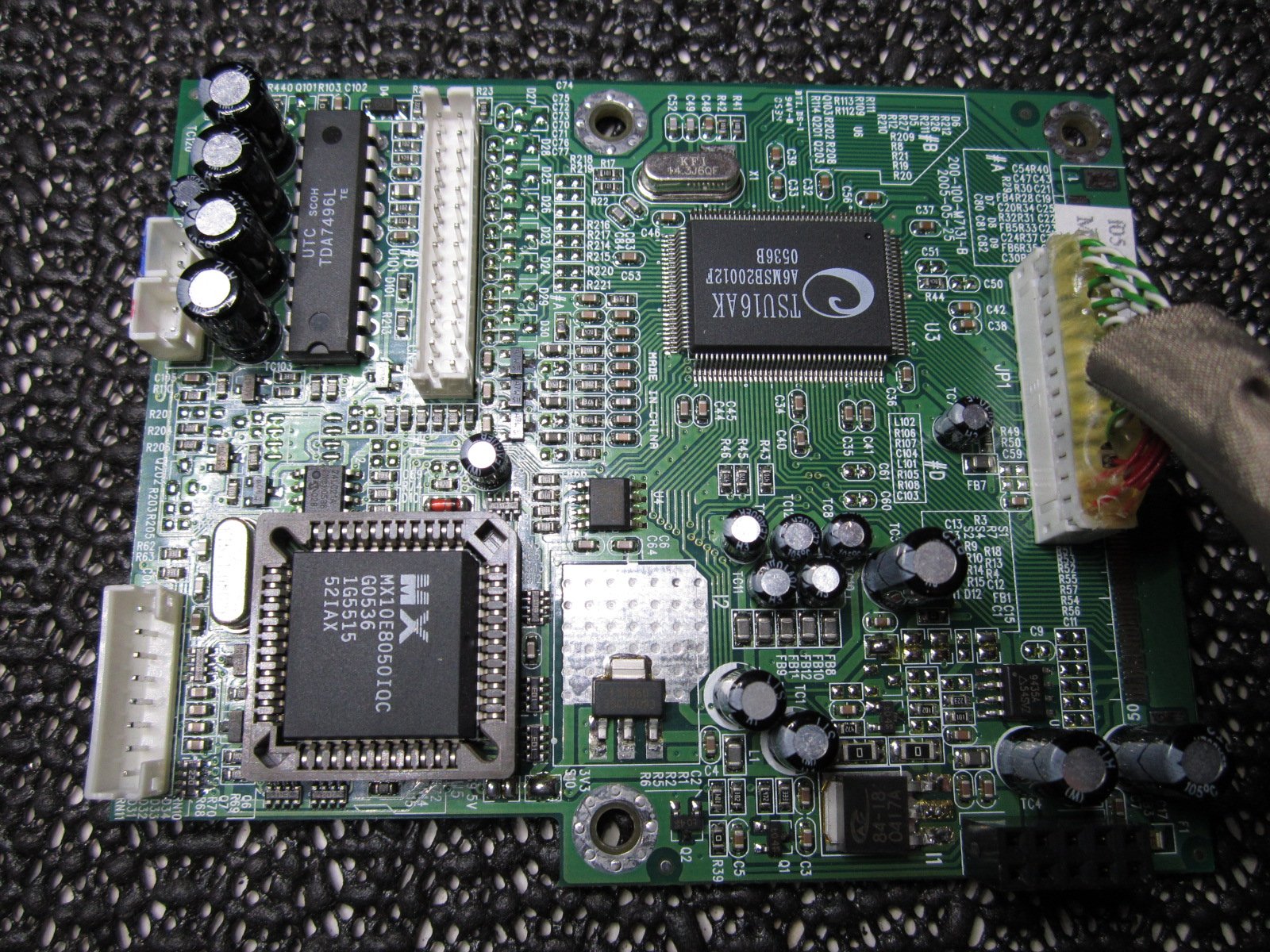

    I just replaced all the caps in a Seanix 700P monitor but still have graphics corruption that is for lack of a better word "dancing".
    Any chance someone has seen this before so I would know what to try next?
    Pic is attached but I can also show a short video capture if someone needs to see one and there is a way to show it without breaking forum rules.

      Taken when monitor in standby (power light is amber):
      FS8860 -> Line one
      33CJ0093 -> Line two
      pin 1 = 0.000
      pin 2 = 3.289
      pin 3 = 5.11
      84-18 -> Line one
      0417A -> Line two
      pin 1 = 0.000
      pin 2 = 1.792
      pin 3 = 5.11
      Taken when monitor in normal use (power light is green):
      FS8860 -> Line one
      pin 1 = 0.000
      pin 2 = 3.199
      pin 3 = 5.04
      84-18 -> Line one
      0417A -> Line two
      pin 1 = 0.000
      pin 2 = 1.740
      pin 3 = 5.04
      The readings are taken with the monitor powered on and connected to the pc, but with the lcd panel not connected as the boards can't be reached with the panel plugged into everything. Power light is green.

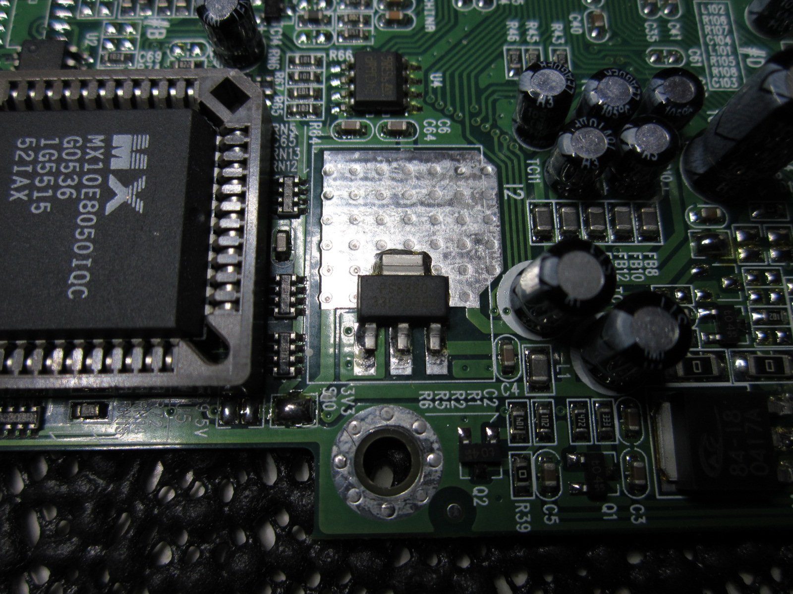

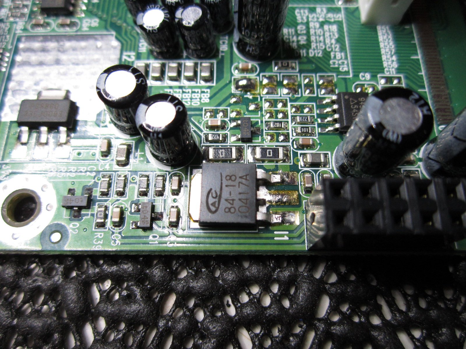

                          • Undead
                            • Mar 2012
                            • 64
                            Re: Seanix monitor
                            Post a picture of each so we know what size package they are.
                            Not the best lighting today but hopefully they will be clear enough.
                              The pics are better than 90% of the usual out of focus stuff that we get.
                              http://www.ebay.ca/itm/221105133435
                              I having a hard time find the 84-18 TO-252 replacement on ebay. Digikey has it
                              http://www.digikey.com/product-detai...ICT-ND/1301472
                              The difficult part is the 5A output. Most of the 1117-18s on ebay are all SO-223 and 1A output.

                                      It's unlikely any of these regulators are 5A - with the input of 5v, to get 1.8v at 5A it would dissipate 3.2 watts * 5A = 15 watts.
                                      That's impossible. At best on that PCB I see about 4 watts of dissipated power, so any 1.5-2A regulator would probably work.
                                      For the 3.3v, it has quite a bit of solder there as heatsink so that's probably 1A+ and actually uses it. A random datasheet for FS8860 says 1A.
                                      Pay attention to this particular one because the pin order is different than the one on most common regulators.
                                      Yours appears to be 1. GND 2. OUT 3. IN with the TAB output
                                      Most regulators are 1. IN 2. GND 3. OUT with the TAB ground.
                                      I didn't compare the pinout of the 1.8v one with other regulators of the same format so this one could also be just as quirky.
