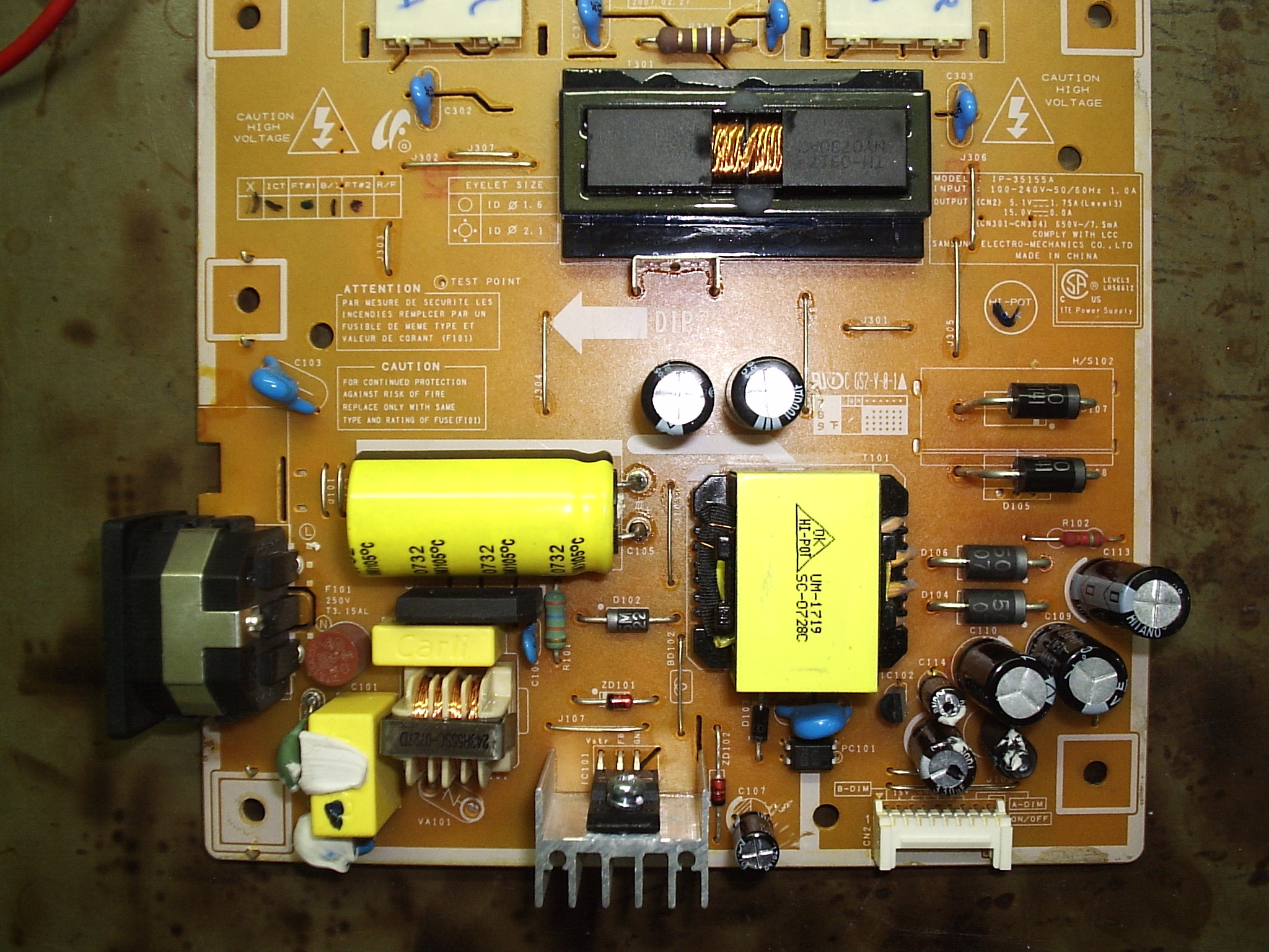

    Got two of these that won´t power up.
    PSU is IP-35155A, inverter transformer is TM-0917.
    First one got bad caps in the 5V line C109 and C110 ( two 1000 uF x 10V, Samwha XC ) . Swapped them and the one 820 uF x 25V near them. ( C113 , also Samwha XC ).
    Well, now the psu gives correct voltages in the CN2 connector, with and without the logic board connected.
    Then the other : none of the caps were bulged. Just to be sure, I swapped most of the caps ( C190 and C110 , 1000uF x 10V, C113, C112 and C316, 820uF x 25V ). All were Samwha XC.
    Connecting just the psu gets the voltages in the CN2 connector ok. Starting it up with the logic board connected gives just about 1V in the 5V line, and 3.something in the 15V line.
    Have swapped C107 ( 47uF x 50V SamYoung LXV) and the controller ( FSDM0465R ) to no avail. Have also tried with both logic boards, it made no difference.
    Now for the interesting part :
    If I connect just the IP board, turn it on, measure the voltages to see it is working, turn it off. Wait for the big cap to discharge, then connect the logic board and turn the thing on, it will not start ( Voltages between pin 2 - 3 of the D0465 stay around 9.7 - 10.3V ) . Output voltages in 1V for 5V and 3.2 for 15V.
    But if I connect the logic board before the big cap has time to discharge fully, and turn power again fast, the smps will start, voltage between pin 2-3 will be around 12.4V, and output voltages are ok ( 5.1V and 14.7 - 14.9V ) .
    As I have the two boards , and one seem to work, I´ve tried :
    Swapping the NTC TH101 ( 5 ohms, SCK-053 ). No difference.
    Swapping the big cap ( Samwha WL 100uF x 400V ) . No difference. By the way, in the other board it is a SamYoung KMF 100uF x 400V.
    Any suggestion of other things to troubleshoot ?

      Hi, IP is the code of the psu+inverter board ( IP-35155A ) .
      I mean it works with respect to the voltages ( the boards are with me at work, and the lcd panel is at home, so will only know if it shows image tonight ) . Before recapping, it would not give correct voltages when connected to the logic board.
      The situation now : I have one PSU board that powers up ok, with or without the logic board connected. This is the one I consider the best then. Will test it with the lcd panel later.
      And the other board will only start up ok if connected to power by itself, then disconnect power and reconnect logic board + power fast enough for the primary cap not to discharge. Then it can start and gives ok voltages.

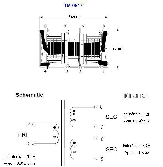

        Just to get it out of the way,whilst you indicate the inverter transformers are TM-0917 you do not say if you have tested them. Can you test the secondary windings- meter on ohms 2000 test pins 5>6 7>8 and post results as follows
        pins 5>6 Ohms xxxx
        Pins 7>8 Ohms xxxx
        • rogfanther
          • Jul 2006
          • 458
          • Brazil
          Re: Samsung 740B plus won´t start
          Yeah, 1030 ohms one, 1032 ohms the other.

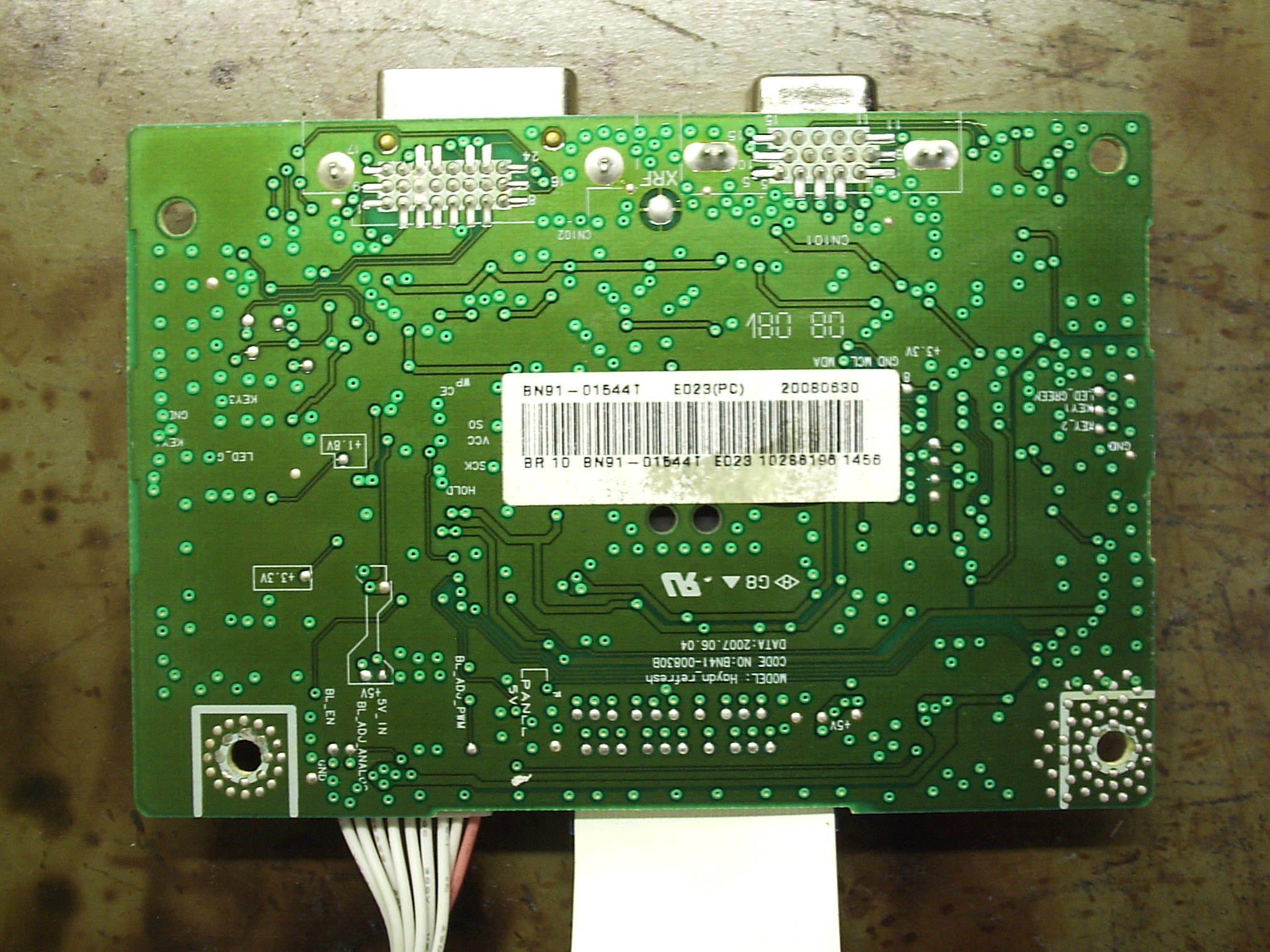

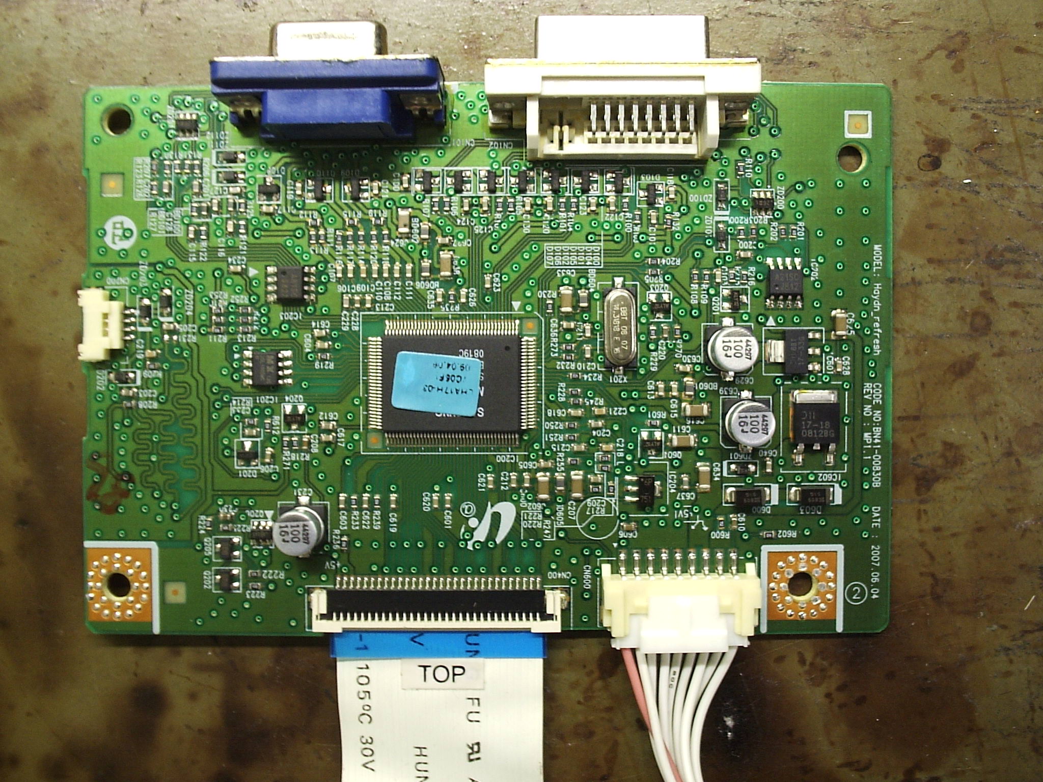

              Here are the photos of the main/logic board.
              Made a slight detour when going to lunch and went home. The good PSU board, along with what I will call the goog Main board, work with the panel. Power LED on, message of Analog / Digital on the screen. Disappear with vga cable connected. Power button works to turn the display on and off. This psu still has a little hiss, that I assume is caused by the caps I didn´t swap yet. When my order arrives ,will recap it all with Panasonic FM.
              The regulators in both main boards are within spec ( 1117-18 gives 1.82, 1117-33 gives 3.42 ).
              Don´t know if I explained ok : the "phenomenon" is that, if I plug the bad PSU board with the main board, and turn on power, it seems not able to start, and Vcc to the pwm chip stays lower than the minimum.
              But if I connect just the bad psu board, turn on the power, after about 2 seconds it will stabilize power . Then if, while the main cap is istill charged, I turn off the power, connect the main board, and turn power again, the psu will start and stabilize the outputs. Vcc in the pwm will be ok, as also the voltages in the main board regulators.

                  Just measured them again. 1.81V and 3.32V. I don´t believe the problem to be in the main board, because it happens with both of them connected to the "bad" psu. Both main boards in the "good" psu give correct readings.
                  I have changed a zener ( 47V ) and another diode ( 1N4007 ) , but no difference was made.

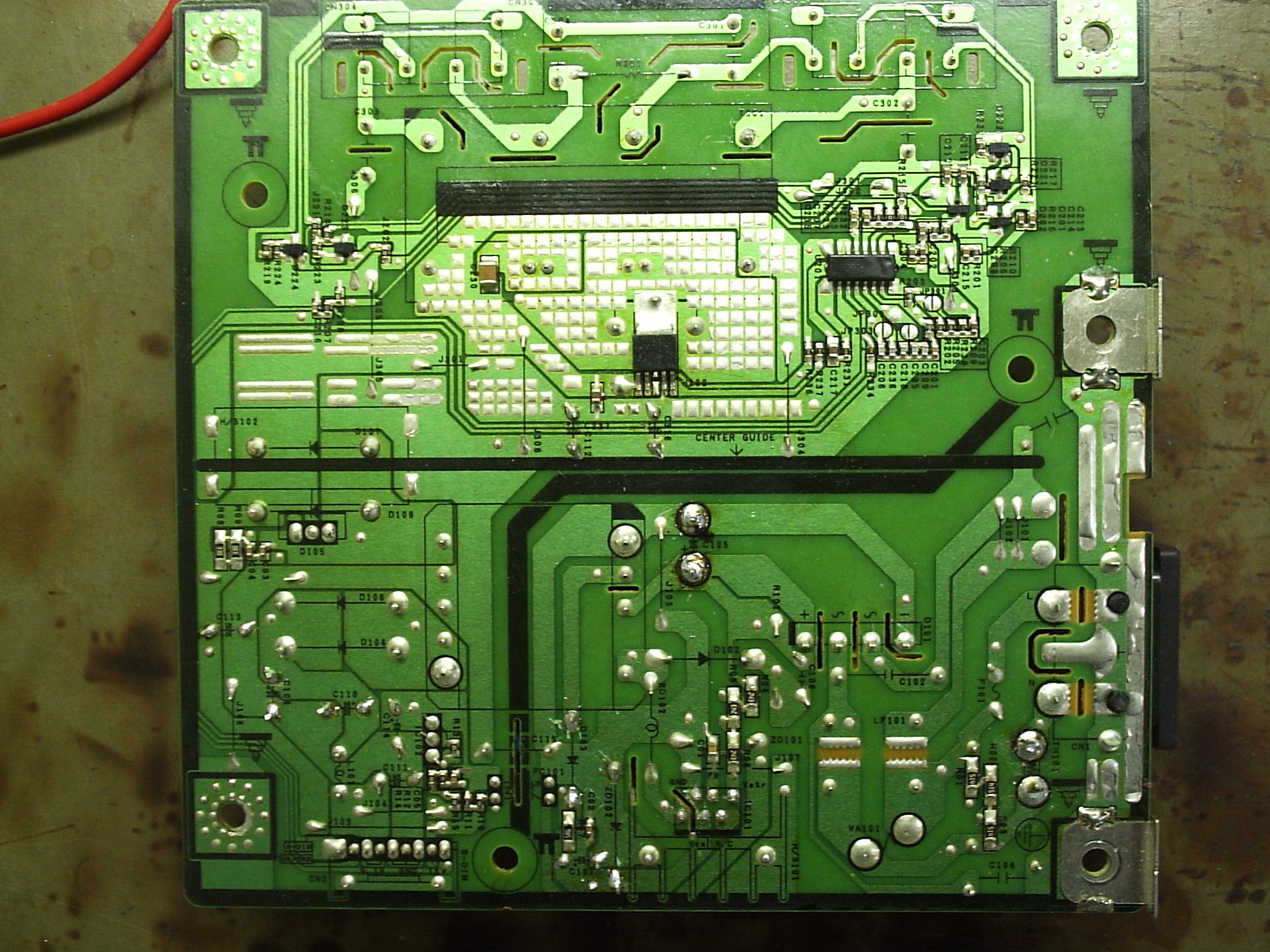

                    C107 is your startup cap. On the bad PSU, measure the DC voltage across it with the big cap charged and uncharged states.
                    Unplug lcd monitor. Wait until big cap is fully discharged. Now hookup multimeter aligator clips to the big cap to measure DC voltage. Now hit power switch. What is voltage across the big cap?
                    --- begin sig file ---
                    --- end sig file ---
                    • rogfanther
                      • Jul 2006
                      • 458
                      • Brazil
                      On both PSUs, with the main board disconnected, the voltage in the cap stabilizes at 10.9-11V.
                      With the main board connected, in the good PSU the voltage is 12.7V.
                      With the main board connected to the bad PSU ( big cap uncharged ) , the voltage fluctuates betwen 9.3 - 10.4V.
                      With the main board connected to the bad PSU after the big cap has had time to charge alone, the voltage stabilizes at 12.4V
                      With the main board connected, the big cap measures 175.2V
                      With the main board disconnected, the big cap measures 175.2 V
                      With the main board reconnected before the big cap has time to recharge, it measures 174.3 V
                      Voltage measured in the outlet is 127.3 VAC

                                        Decided to ressolder all the secondary and pwm joints in case of a hidden cold solder joint. After that ( with the board still a little warm ) when powering it up, voltages were almost ok ( 5V was 4V, 15V was 12V ) . Thinking it was a cold joint , I let it cool during lunch time, and tried again. Back to not functioning.
                                        Then tried heating the secondary caps with hot air. No difference.
                                        Tried to ressolder the pwm section joints, in case there was a really stubborn one. Power it up, almost right voltages ( 4V and 12V ) .
                                        Thinking about what I could be heating that was making a difference, I considered the optocoupler was something I had not replaced. So I made the test : power the boards up. Voltages too low ( 1V in the 5V line, 3.2V in the 15V line ) . Then I hold the solderin iron near the optocoupler while measuring voltages. After a little while, they climbed up to the correct values.
                                        Now, is it more probable to be just the optocoupler, or some other part would be too weak to make it work, and when I heat the opto it somehow conducts easier ?
