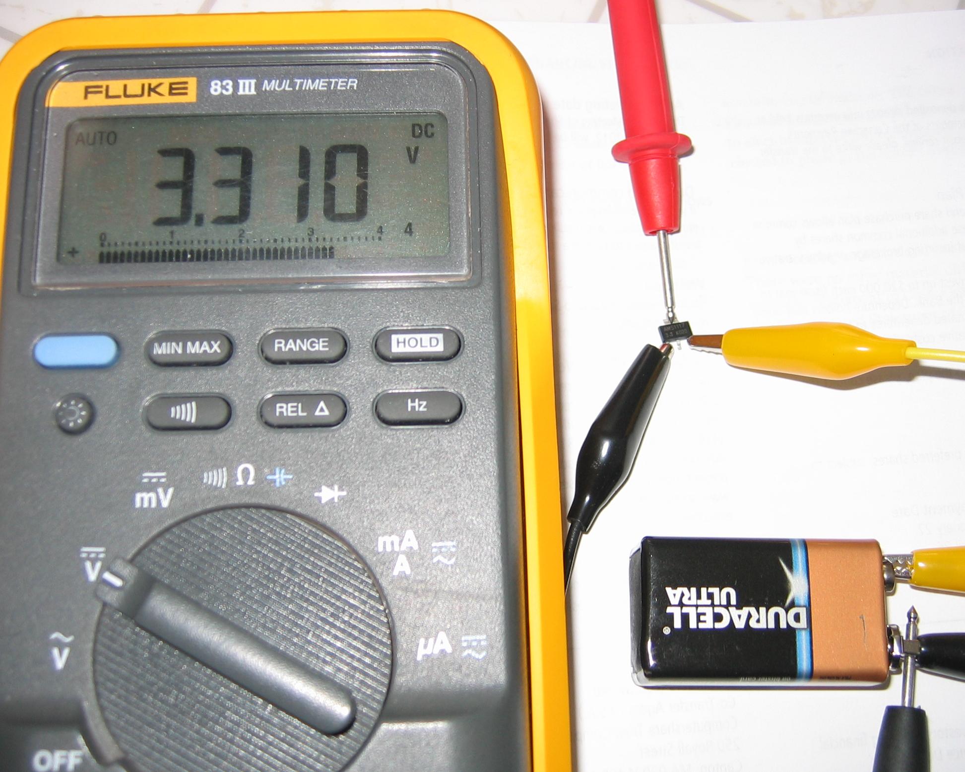

              Originally posted by tom66
              The datasheet doesn't mention a maximum input - I know some regulators are limited to just 6V in! - so try and stay within this limit.
              Yes, I caught my own error after posting in post #15
              Most of the time, I use *weak* 9V batteries. The one in the picture is 7.3V with no load. I find it easier to clip on leads versus doing multiple AA cells in series.
              The voltage regualtor in the picture, obviously, is a fixed 3.3V. I do have a 1.8V, but the 3.3V is the one I had handy. Cloudy day so I had to use indoor flash so not my best work.

                OK, i think i measured 102. It peaks to 1.60v for a brief moment and then drops to 0. Battery is stable 4v

                  I changed two caps we were talking about and no change noted... Sadly I can;t seem to find this particular IC, that has output voltage of 1.8v. Closest is 3.3v.
                  Aly alternatives?
                    #29
                    Re: LG flatron L1718S - shaky picture when not in native resolution
                    Aly alternatives?
                    Look for AS1117, or LM1117, or LD1117, or AM1117. -18 is the output. Can eBay sellers ship to you? If so, http://www.ebay.co.uk/itm/2-x-SMD-SM...item3f06fd6467 or http://www.ebay.co.uk/itm/20x-AMS111...d#ht_779wt_956 (pack of 20, you'll be able to fix 19 more monitors. )
                    If not, you could do what I did to fix this 32" TV; I built a little regulator board (with an LM317T, cheap and plentiful device) and fitted it in the chassis. However, that TV had a lot of spare space inside; I'm not sure a 17" LCD would have enough space.
                        They probably can ship but i have no ways of paying for it as serbia is not in Paypal, sadly.
                        Tell me, would the variable voltage ones do?? I can find some that have var output from 1.5v up until 30 or something
                              You can build a little circuit on a bit of prototyping board or stripboard to do it with the LM317T.
                              Use input capacitor 100uF or above (any cap with good voltage rating is okay here.)
                              Use output capacitor 100uF or above (again any cap is fine, as long as voltage is okay.)
                              From the output pin tie a 220 ohm resistor to the adjust pin.
                              Then the adjust pin gets a resistor of value 470 ohms, this will give 1.836V, with a 5% tolerance, which is fine.
                              Optionally add a red LED on the output, with a 10 ohm resistor, to indicate output is active. (Most red LED will be fine with 1.8V.)
                              Tie the input to a 5V source.
                              I would recommend adding a heatsink to the LM317T too, and applying epoxy or hot glue to hold big components down. Insulate the bottom of the board with electrical tape and find a good place to put it inside the monitor.
                                  Aly alternatives?
                                  Check your junk or dead boards. The 1.8V regulator is a fairly common part. For example, I found one on my old sound card.

                                      Remember to check your board before you wire it in with a voltmeter. Echoing Retiredcaps though, I have found old laptop and computer motherboards to be a goldmine for replacement regulators.
                                        #39
                                        Just a correction to my previous post - realised I was being an idiot - use a 330 ohm resistor instead of 470 ohm in the lower resistor. This will give 1.87V. Even better use a little potentiometer of 500 ohms in place of the 330 ohm resistor so you can adjust the output.
                                        My previous suggestion would have given 2.65V!! I was using the wrong formula. The correct formula is 1.25 * (1 + Rlower/Rupper)
