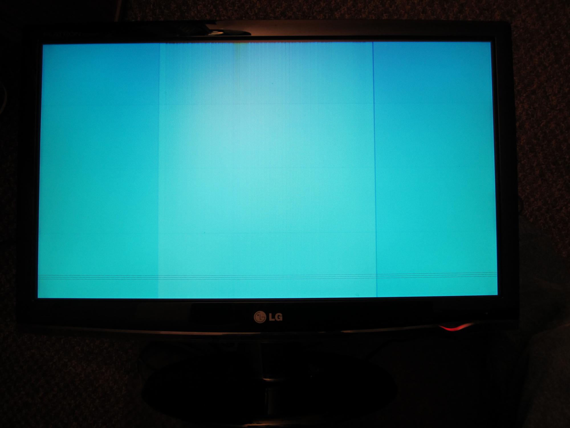

    Got another bad monitor in the office. Though this one is just over a year old. The positive side is that this is the only one of these out of the 6 from that purchase.
    I think that the pictures can explain the issue better than I can with the first being the lcd in question and the second being what it is suppose to show.

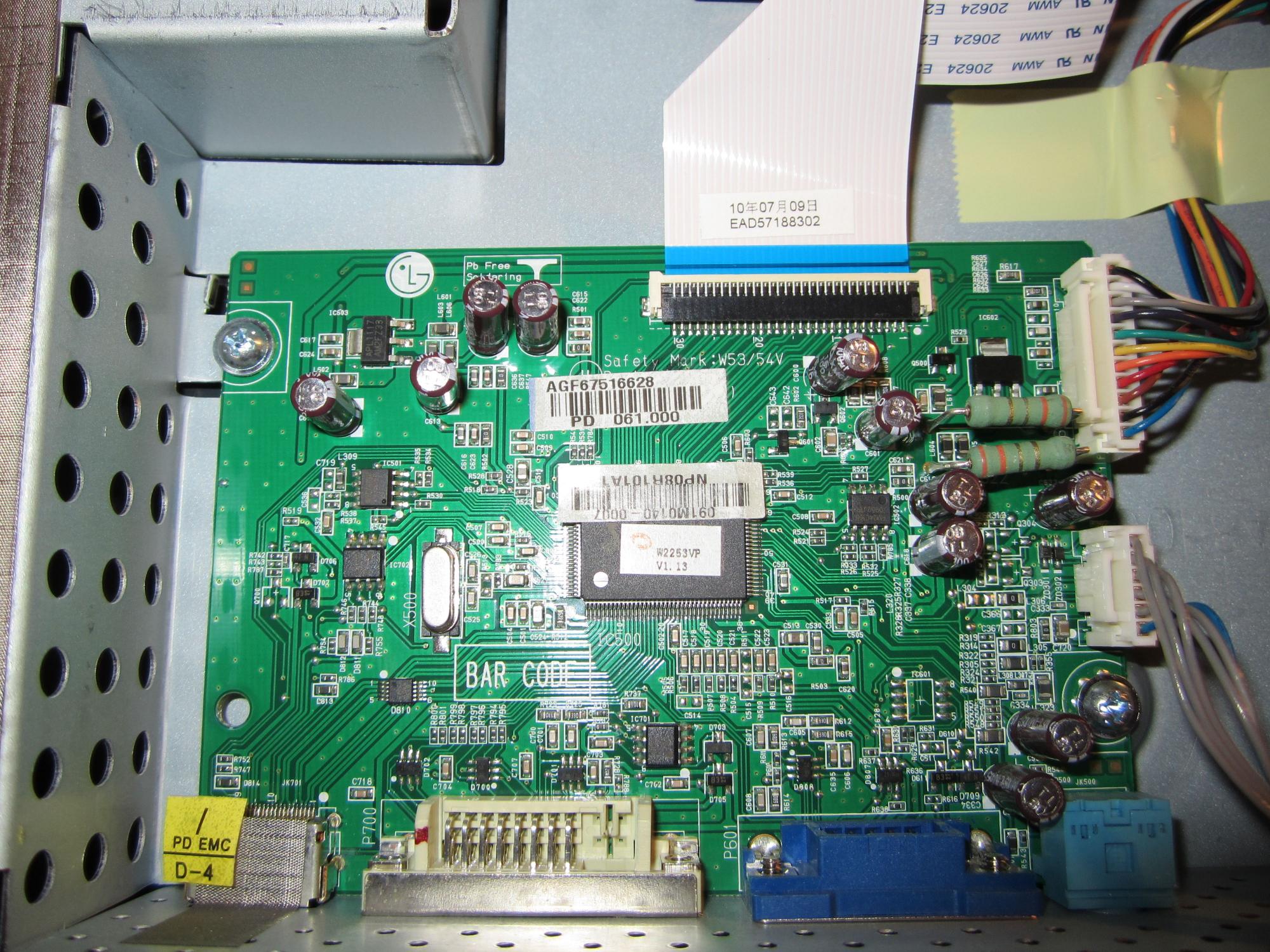

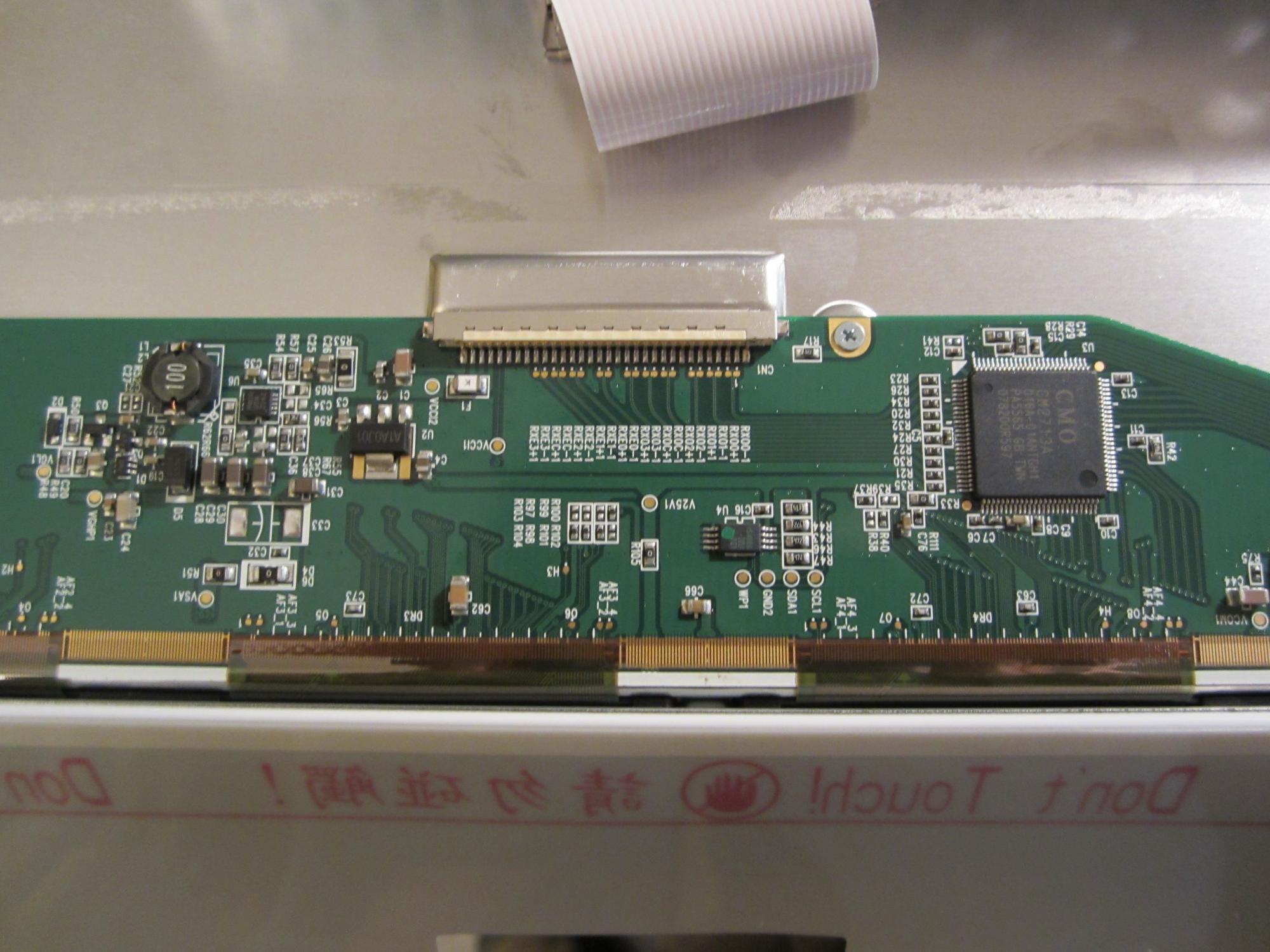

        If all monitors are the same type is there any chance of borrowing another one to swap boards - that is the quickest way- to confirm a faulty board.As it stays on it doesnt look like a power supply problem. Its not the backlights nor the inverter. Can you post a picture of the panelboard/tcon may be fixed to the panel and needs careful handling.

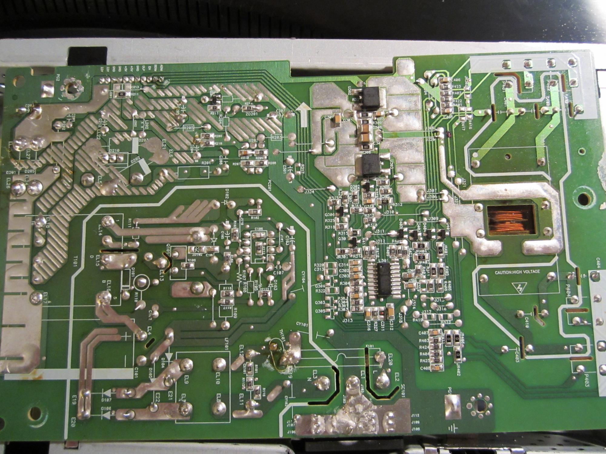

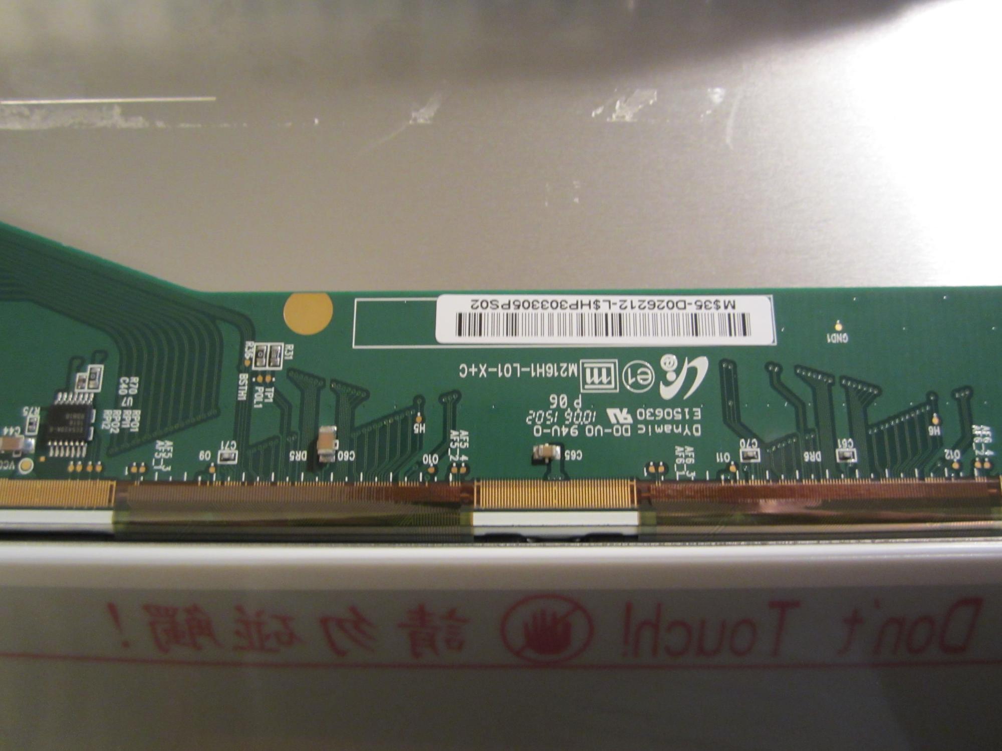

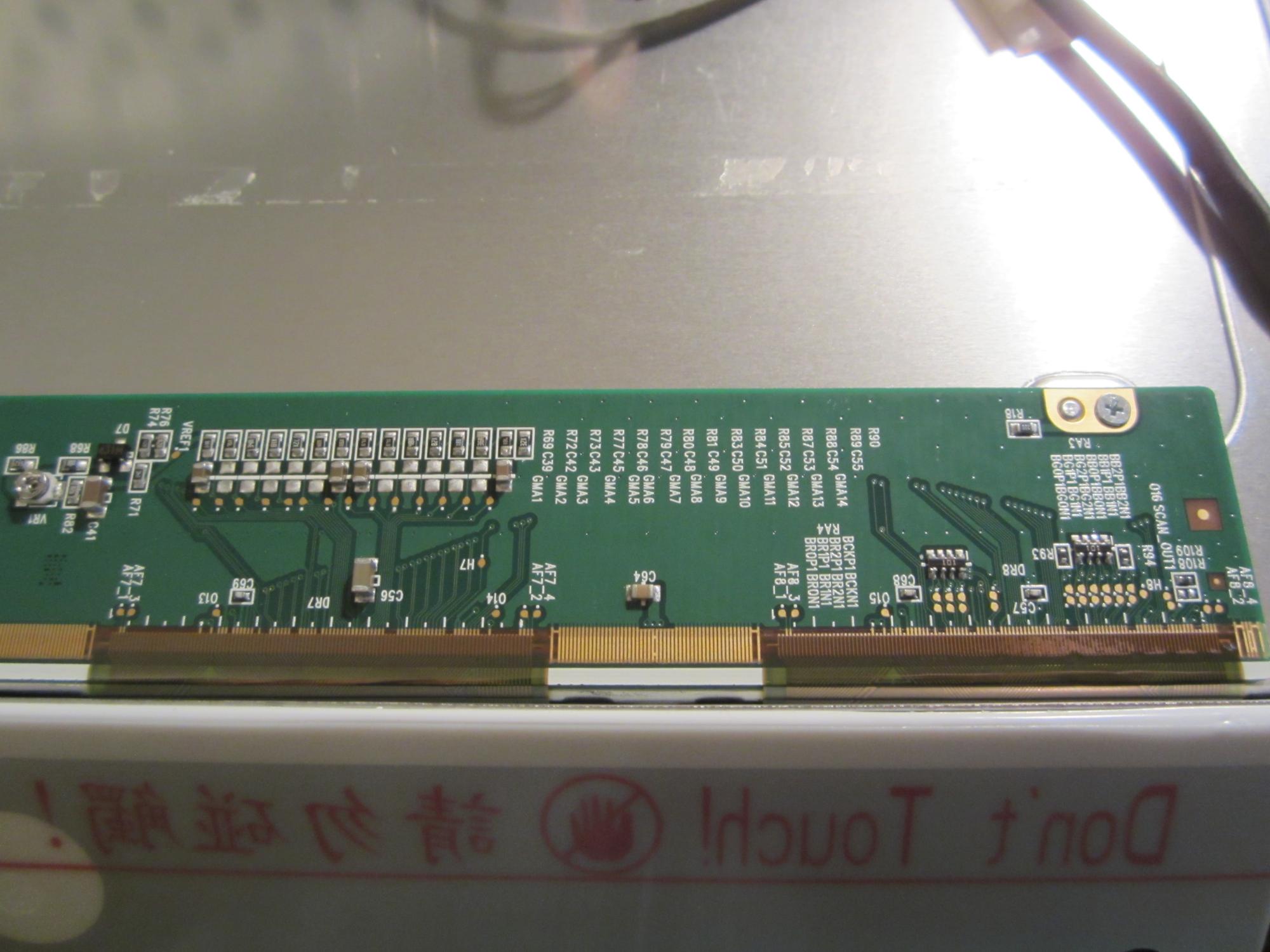

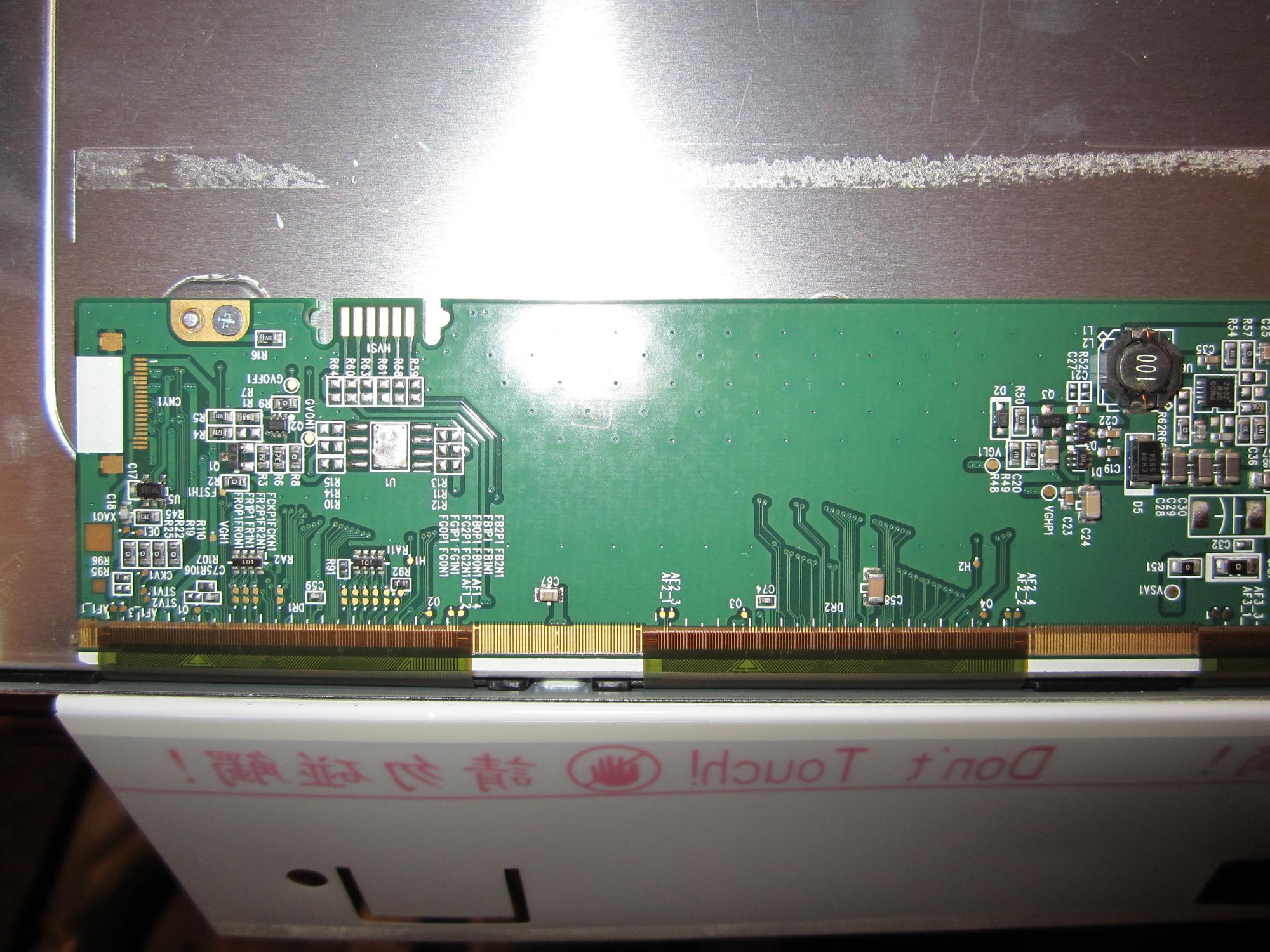

          Although I could swap board with another one, I would rather not if possible since people are using them during work. And I did clean/check the signal cable going to the panel.
          I believe that here's the pics (though I still don't know what a tcon is )

            Ok Great pictures! That is a panel board or Tcon ( I just found out today that
            if its on a monitor its called a panel board and if its on a tv its a Tcon)
            Anyway in pic 2 near the connector there is a little white rectangle smd with a "k" on it - That is a fuse - can you test it.

              Ah, thanks for the explanation, and the fuse seems to be good still at least according to my cheap multimeter.

                The fuse should read the same as touching the probes together.

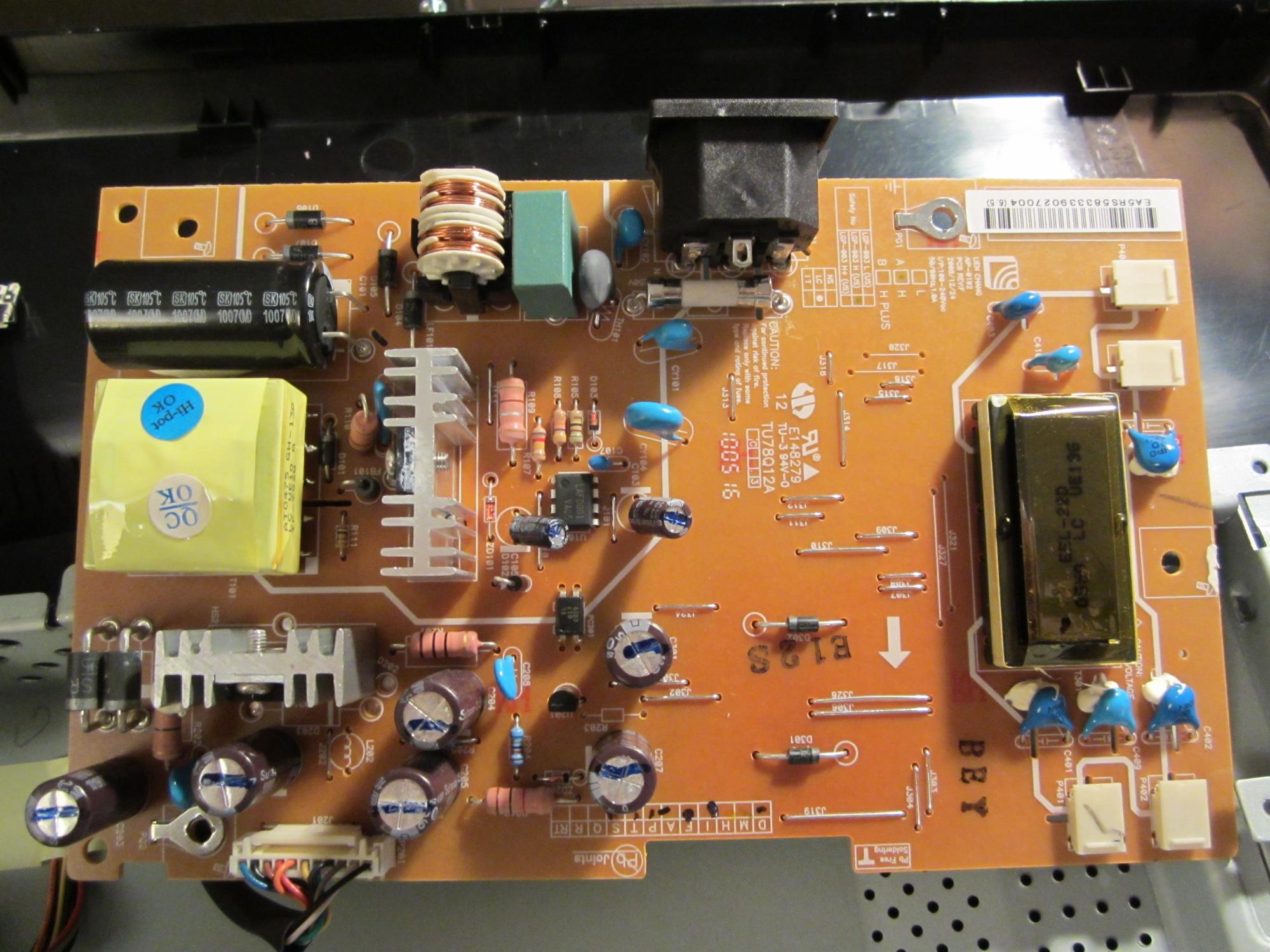

                  Have you verified you're getting 5V output from the power supply? If yes, then try measuring the output of the voltage regulators IC602 and IC603 on the logic board (last photo in post #1) .
