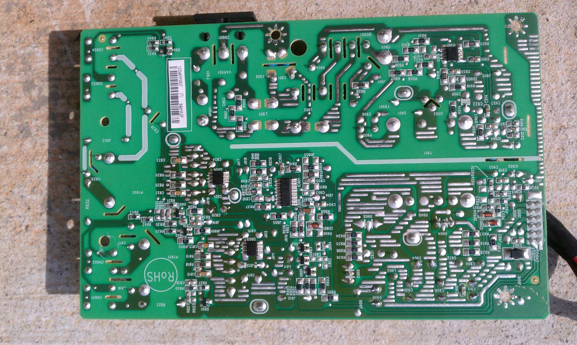

        Re: E19T6W powers off
        Here is the back side of the PS looks good no heat issues..

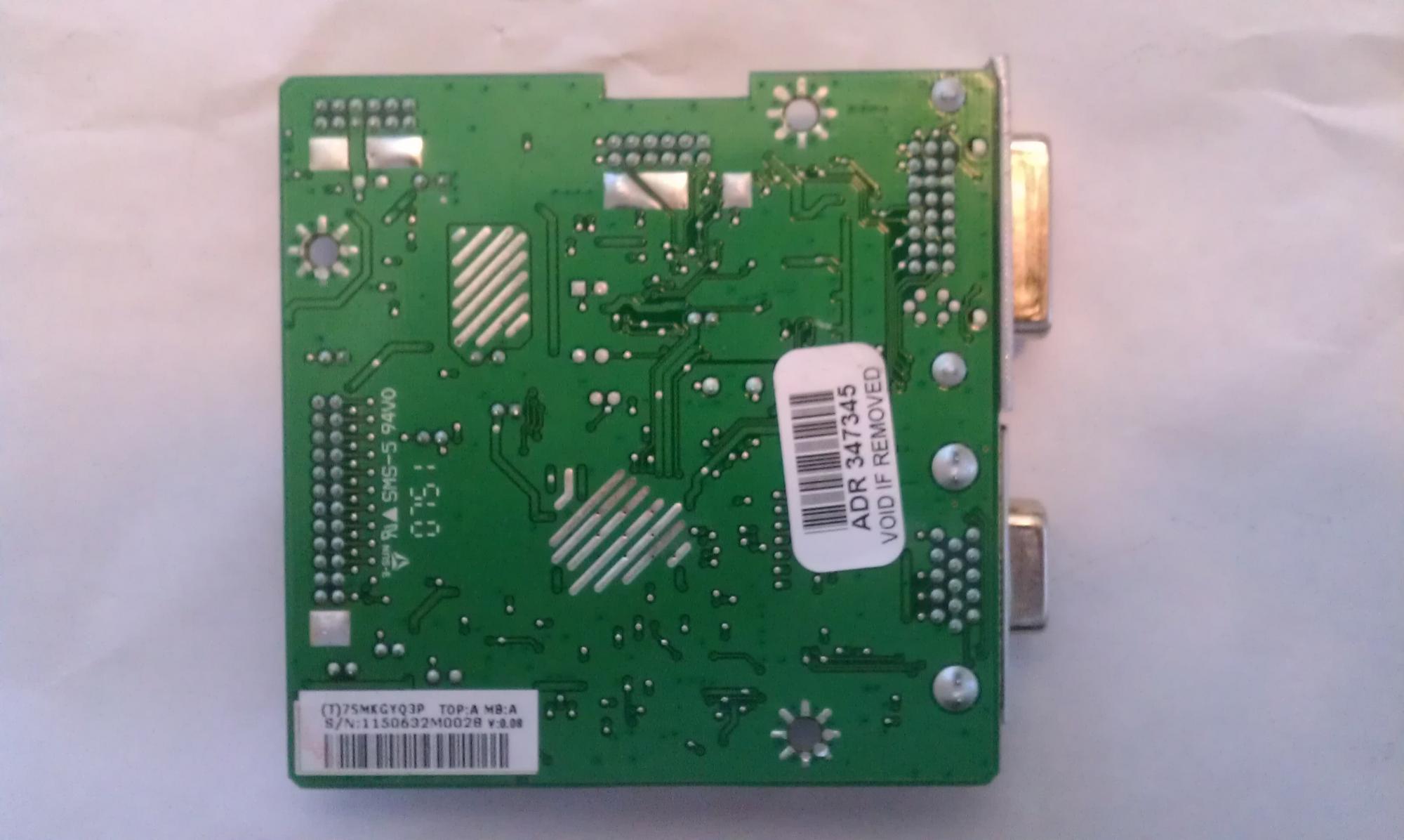

          And the back side of the interface board.
            When it stays on for more than 2 secs how long does it stay on and does it have a picture -
            Can you re take photo of the video board and the back

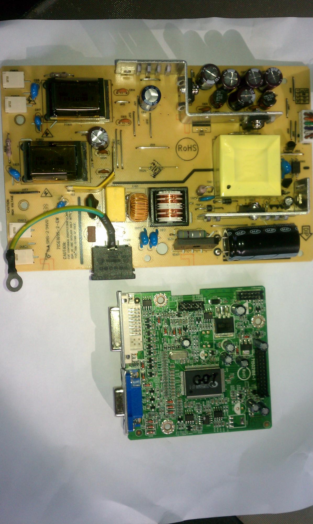

                Well this is an interesting one - did you have the monitor when it worked properly - did the fault develop over time or suddenly (thinking powersurge)
                Have any capacitors been changed?
                Can you look at capacitor C906 solder looks odd - look at the underside and try and
                wobble the top.
                Also near the bottom inverter transformer there is what looks like a link - insulated?
                Is the insulation burnt or is it just the pic.

                      I checked the C906 and all the soldering is fine and making continuity on boards foil. There is no sign of burn its the picture.
                      I bought this monitor brand new and had it for 1 year and a half. So it's out of warranty. The way it happened was, I run 3 monitors and when I am not using my PC the pc goes to sleep putting all 3 monitors in standby mode.
                      Well it was just one day I hit the spacebar so the system wakes up and this monitor was completely powered down, I press the power button it came up and only lasted say around 10 seconds then after only 2 seconds.
                      I tried and checked all the cables etc and still acts the same so-
                      I opened it and replace all the caps in the power supply and I might add the power supply looks new with no trace of burn marks or cold solder.
