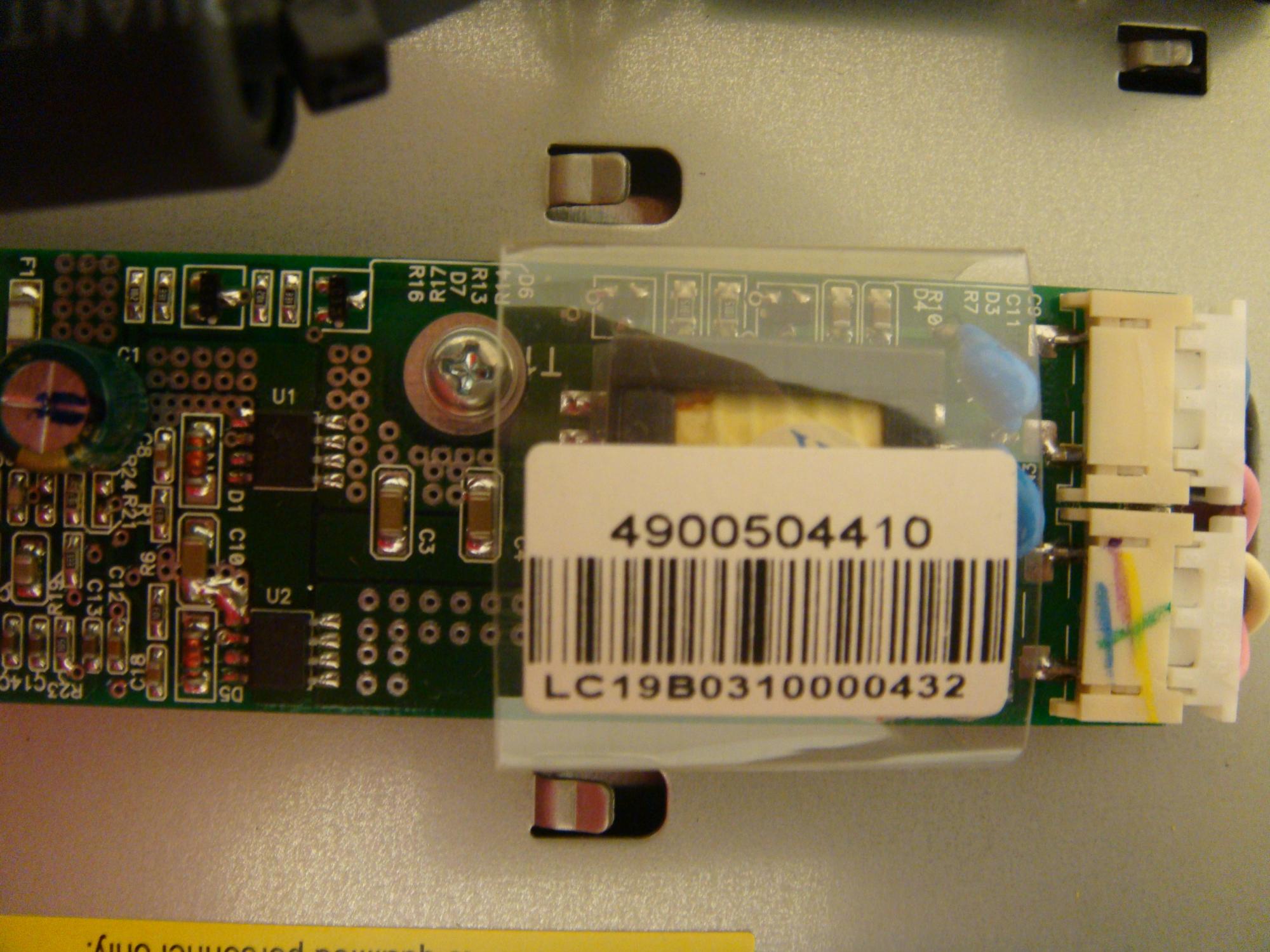

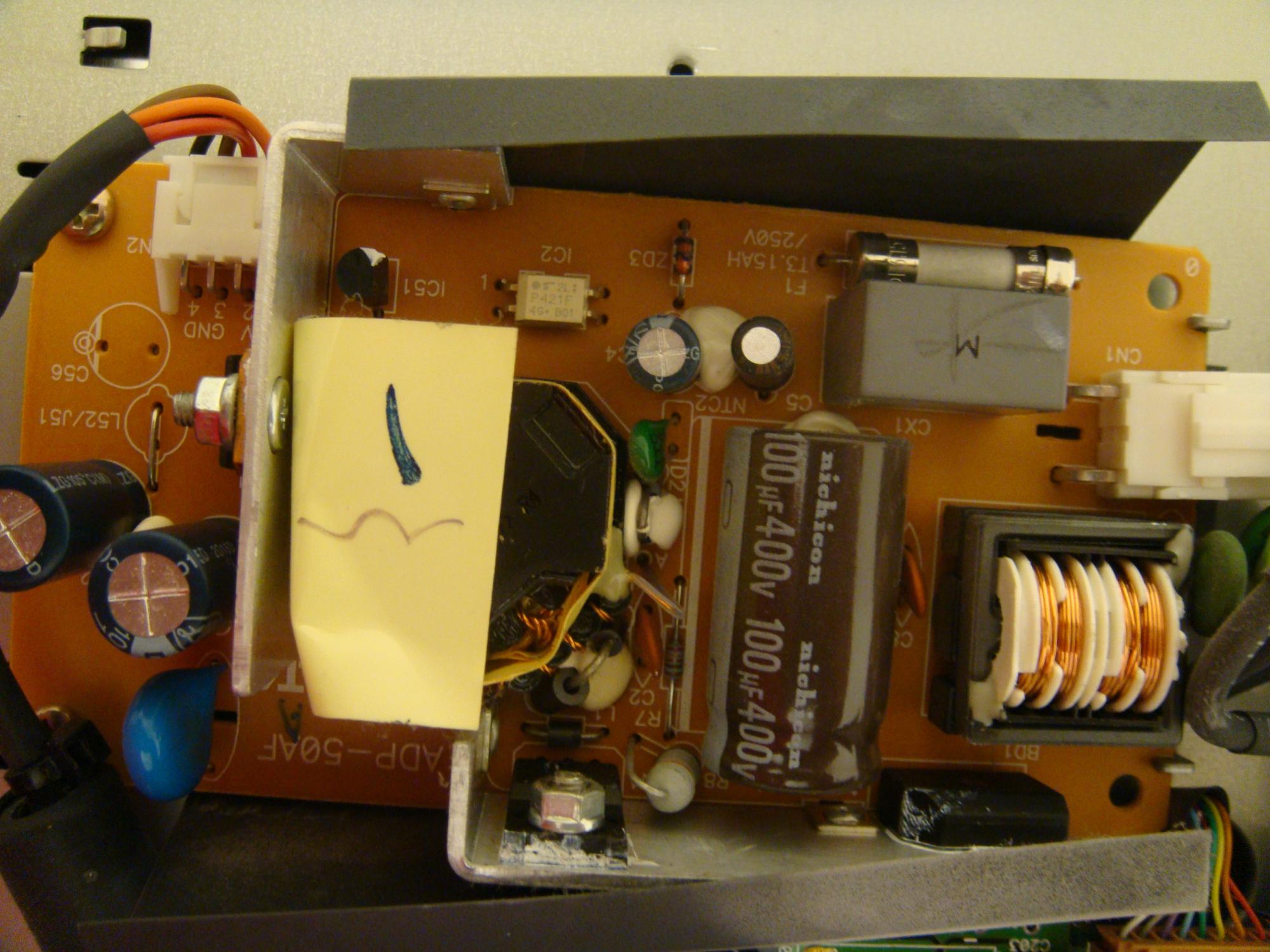

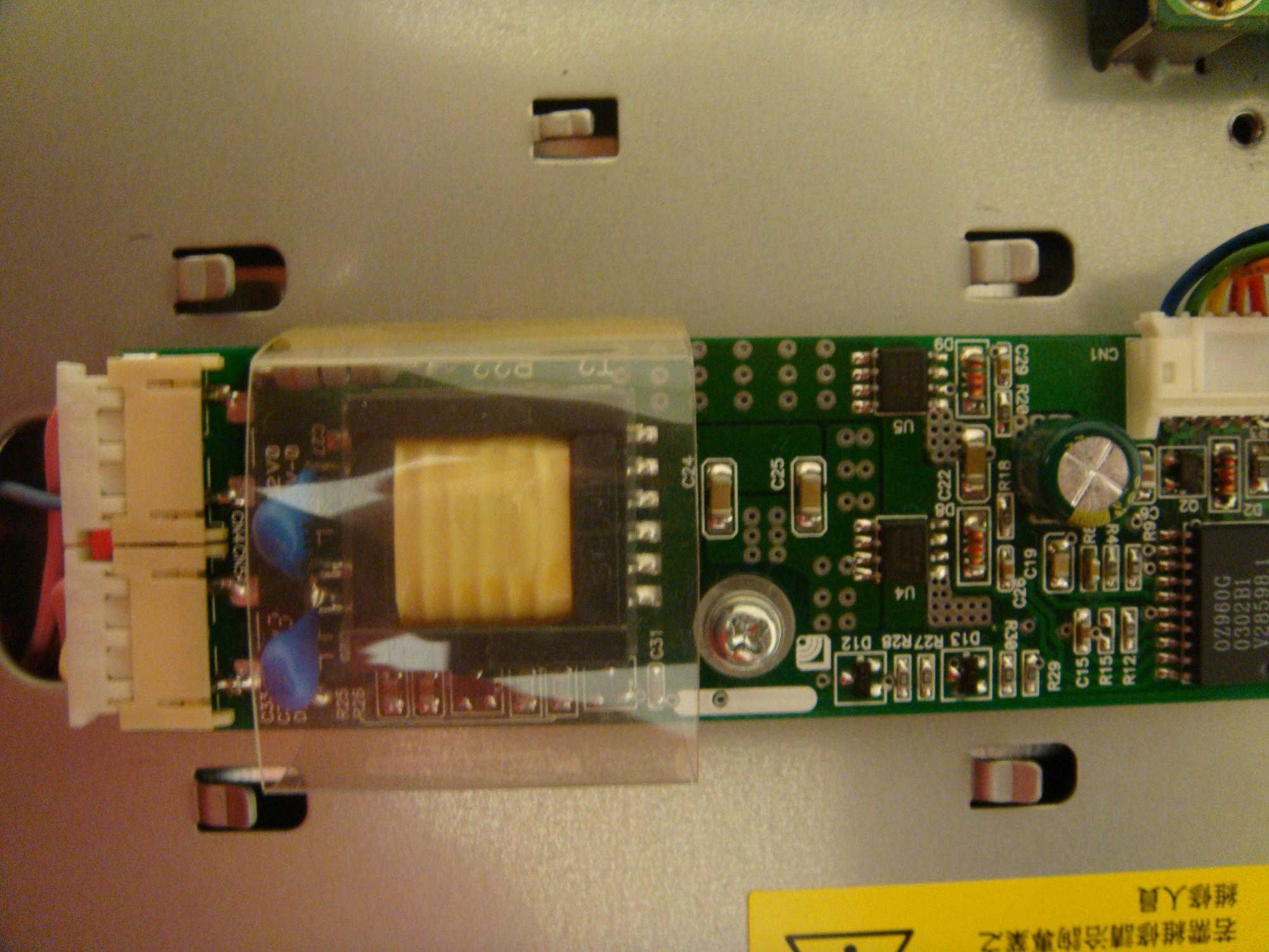

My VL193 flickers intermittently. The flicker usually goes away when I power it off and power it back on but sometimes it remains. I have posted pictures of an overhead view of the power supply and two closeups of the inverter.

1) It could be those two caps on the inverter board that are causing the flickering.
2) Check the DC voltages on the connector to the inverter board and see if they are stable or fluctuating.--- begin sig file ---

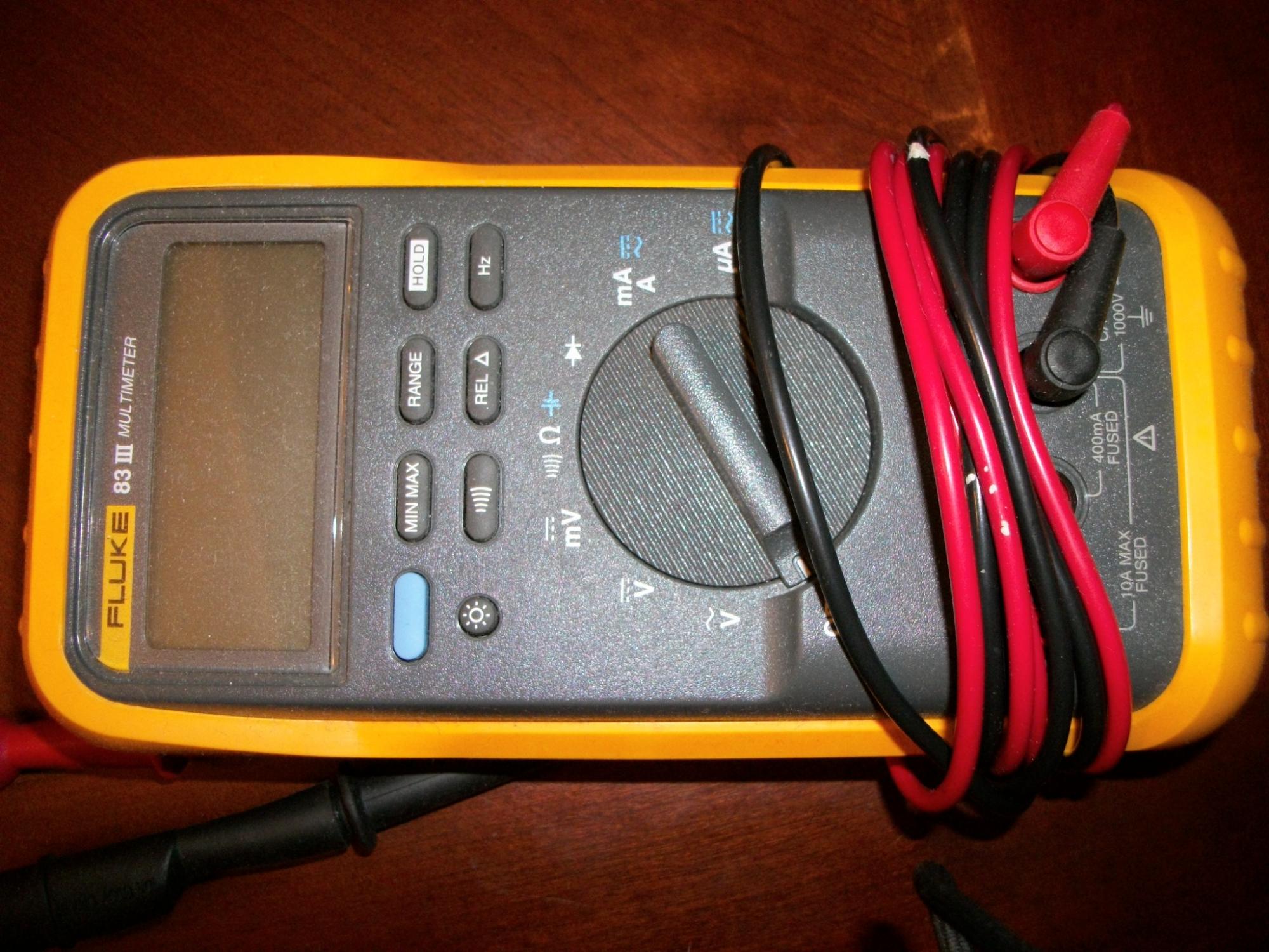

Okay, one retiredcaps' bonus point for having a Fluke 83 III.
1) Set your Fluke 83 III to DC volts (2nd switch position - V with the solid line and dash line).
2) Plug in and power on your lcd. Hookup a working computer displaying your favourite wallpaper.
3) Put your black probe on a ground screw on the inverter board.
4) Put your red probe on each colored wire on connector CN1 on the inverter board.
5) Number each pin and report each DC voltage reading. See if the readings are stable or fluctuating during the flicker.
See my fellow Canadian Afrotechmods' excellent multimeter tutorial (5 minutes long)
http://www.youtube.com/watch?v=bF3OyQ3HwfU--- begin sig file ---

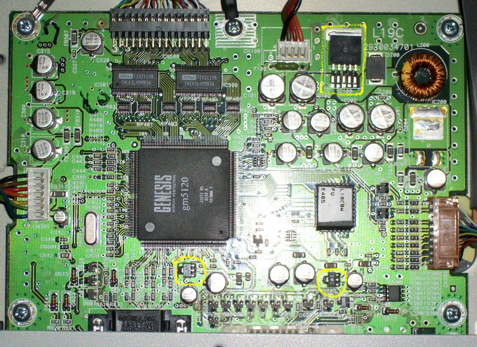

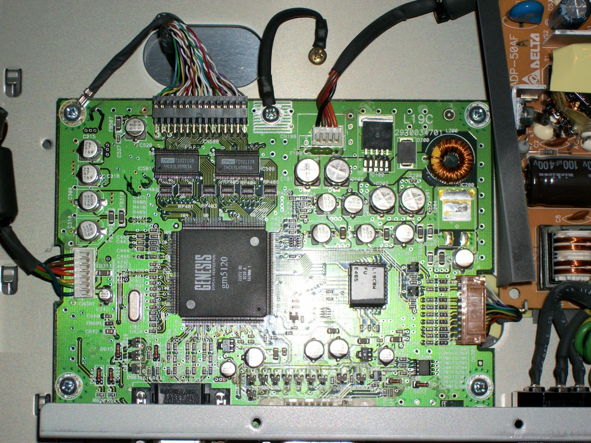

Post a picture of the logic/main board as well. Flickering could also be due to a bad voltage regulator on the logic/main board. Bad caps on the logic/main board is another possible cause.--- begin sig file ---

I circled what I think are 3 voltage regulators.
1) Plug in lcd and power on. Hookup a working computer again. Put your Fluke 83 III into DC voltage.
2) Put your black probe on a ground screw on the main board.
3) Put your red probe on each pin of each component except for the top tab.
4) List the part number of each component and its DC voltage reading for each pin.
5) Report findings like so
IC100
part number = 7805
pin 1 = 0.0V
pin 2 = 5.0V
etc
6) Try to take this readings while the monitor is flickering.Attached Filesif you find these attachements useful please consider making a small donation to the site
