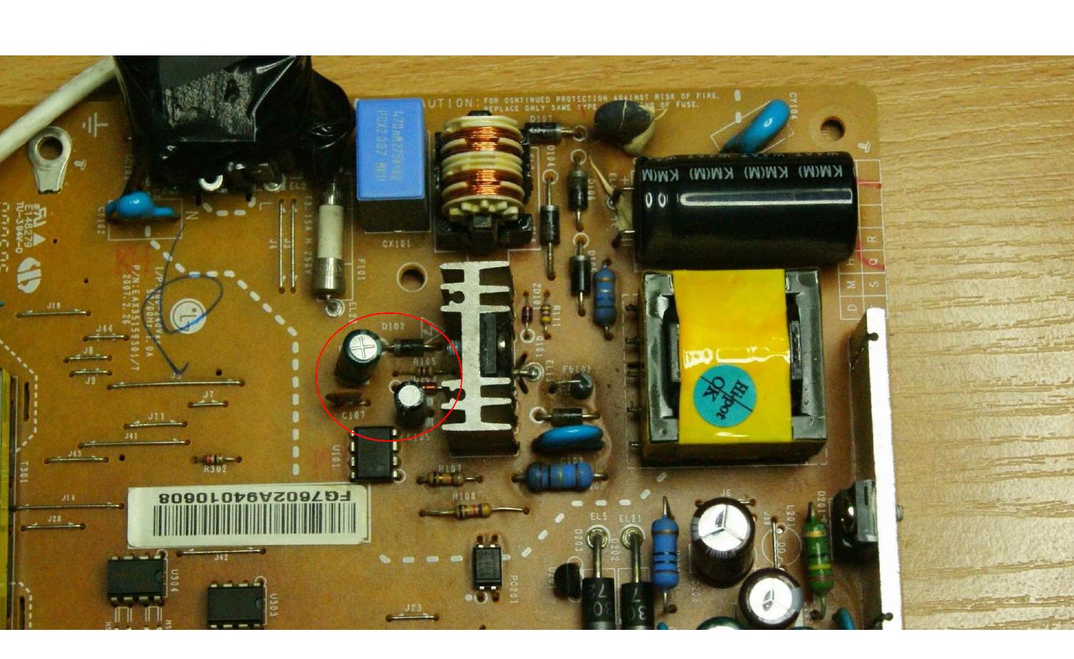

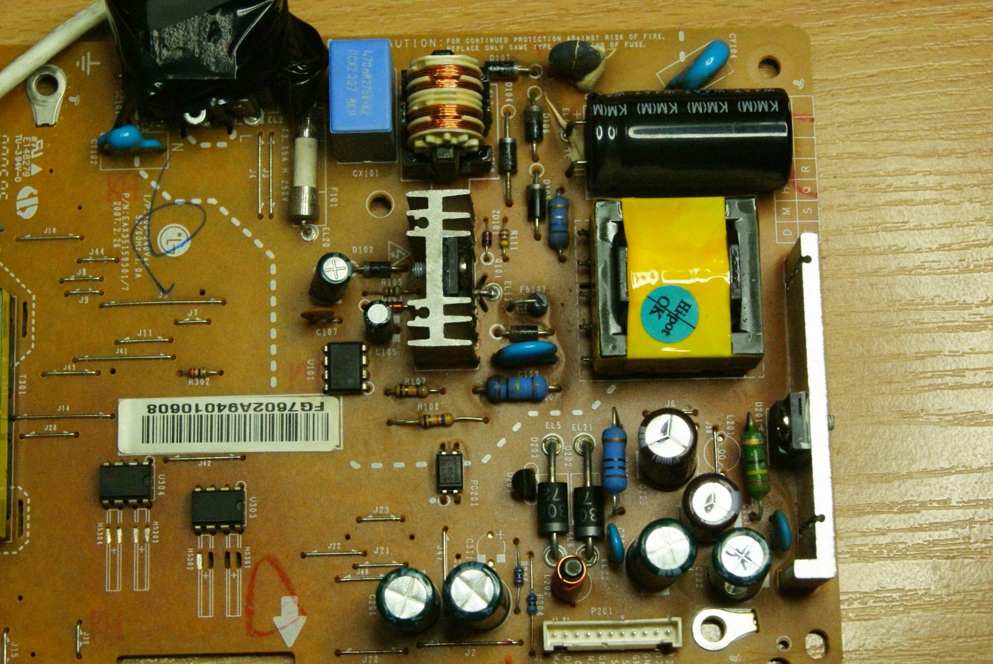

    Hello
    I have this LG monitor that doesn't power on.
    Optically everything seems fine and I have check all mosfets,diodes, capacitors but couldn't find anything wrong..
    Voltages on connector are absent with one strange expection:The moment I plug the board in I have 12volts but they are descending at a slow rate..
    I mean at the begging I have 12volts,ten seconds after I have 11.5, another ten after I have 11, and so on..
    I have found service manual but I had no luck with it..I'm starting to think it has a faulty PWM controller but not really sure..

    The power supply is always on even you do not turn on the monitor, so please check the the DC voltages without turning on the monitor, see if the voltages stay on, if you turn on uinsing the switch and then you see the voltages go down, then the power supply may have gone into shutdown mode due to over current draw due to short circuits.

      Check zener diode (located on bottom of board) zd301 for shorts. It looks a little discolored.

        Thank you for your answer..
        The voltages I'm talking about are without connecting anything on power supply(just like you see it on pictures )I have soldered a plug and taking measurements but the voltages on connector are missing..
        ZD301 is OK, it just has some kind of varnish on it

              Since 5v and 12v are generated by the same SMPS, it sounds like it turns on then it goes off. Do you hear any fainted ticking sound from the yellow transformer? And What DC voltage do you have on that large Main DC cap?

                The ceramic cap next to D107 seems burned to me.
                Check also the transformer below the main cap, next to C102.

                  I don't hear any sound from the transformer.Main cap has its voltage OK about 330V DC(230 VAC in Greece )I have measure its ESR and capacitance, both are OK.
                  Well the thing is a have voltages everywhere on primary but nowhere on secondary if thats any help..That's why I'm thinking maybe the PWM controller is faulty( but my knowledge on SMPS is very limited so I'm possibly wrong).

                    Pics could have been a bit sharper - try and get them as near 2mb as possible ,should look llike this one:https://www.badcaps.net/forum/attach...1&d=1290283049
                    Did you replace the caps- what make/series are they - have any not been replaced,what make series are they?
                    Can you check on the bottom of the board the bottom pin on d201 looks cold? (gap in solder)
                    Near what looks like C02 there is a solder splash can you check it hasnt burnt through to the trace - clean it off.
                    C203 the leg looks like it is just sticking through the solder (cold?)
                    What is the triangular bit of soldering near D105?
                    I am only asking as I cant see enough in the pics
                    Can you test the optocoupler http://www.datasheetarchive.com/PC82...tml#datasheets
                      Re: LG L1953S doesn't power on
                      Please try this first: heat up these two caps with hair dryer to see if the PS will stay on (you can monitor the 12v line), remove and check the values of these two caps or replace them, these two caps are part of the kick start and self powered circuits for the SMPS IC.
                        Well the bigger cap is OK( I don't remember its value and I'm away from it now)
                        The smaller has nominal value 0.47 uF /50V.I check it with my ESR meter and it says 0 uF( which I quess is normal, since it can check caps above 1 uF) but it has ESR 20 Ohm!
                        I looked at an ESR table and a 1uF/50V cap must have an ESR of 4.5Ohm..
                        So my cap has gone bad? Or it has too low value and meter can't check it properly?
                        P.S My other cap meter this one says 390nF so it has normal capacitance but what about high ESR?

                          Well, I would replace those caps as I redlined. If you heat up the bad caps, the ESR will go down. Did you heat up the two caps to see if the voltages come back?
