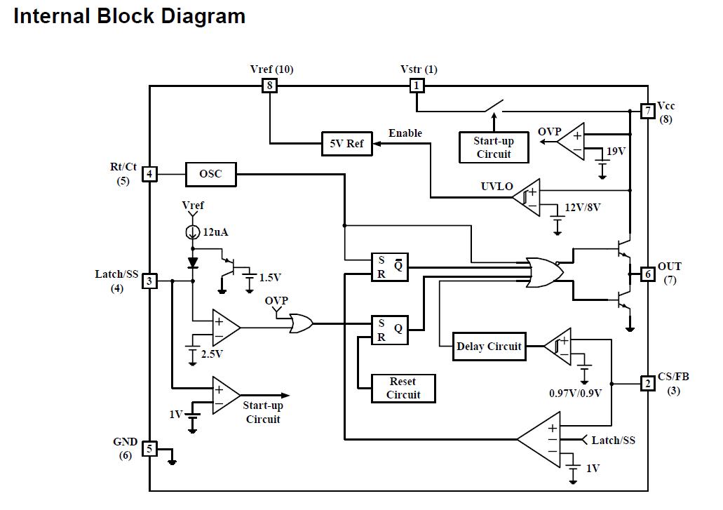

              LED will do, another place to monitor to see if the running power supply section that keeps the SMPS IC running by supplying the voltage to VCC pin 7 of the IC, I want you to put LED with 1k resistor in series and attach this to pin 7 of the SMPS IC or across C103, This LED should blink on also, if it does not, then that may explain why the SMPS does not stay running.

                            Do you have Oscilloscope? The whole thing still does not make sense to me yet since the VCC power supply is working unless there is internal leakage between pin 1 and pin 7 inside the IC so the current is flowing through R108 and comes out on pin7. You can try lifiting one leg of R111 and see if the LED will still stay lit.

                                I edit my post as well after reading your edited post, now time for me to think what is happening, so do you have voltage at the VCC pin of the IC, if you do, then there is internal leakage inside the IC (failed electronic MOSFET switch between pin 1 and pin 7) and now it is trying to run off pin 1 supply by R108 (47K) but not enough current to run it properly.

                                    Yes the voltage on Vcc is still 9.8 volts..
                                    So? Is it a faulty ic after all?
                                      #58
                                      Re: LG L1953S doesn't power on
                                      Yes.
