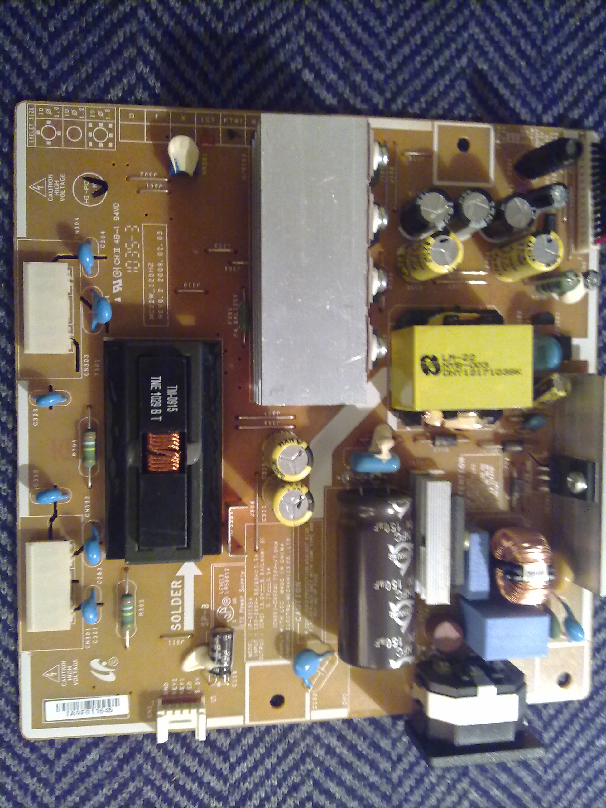

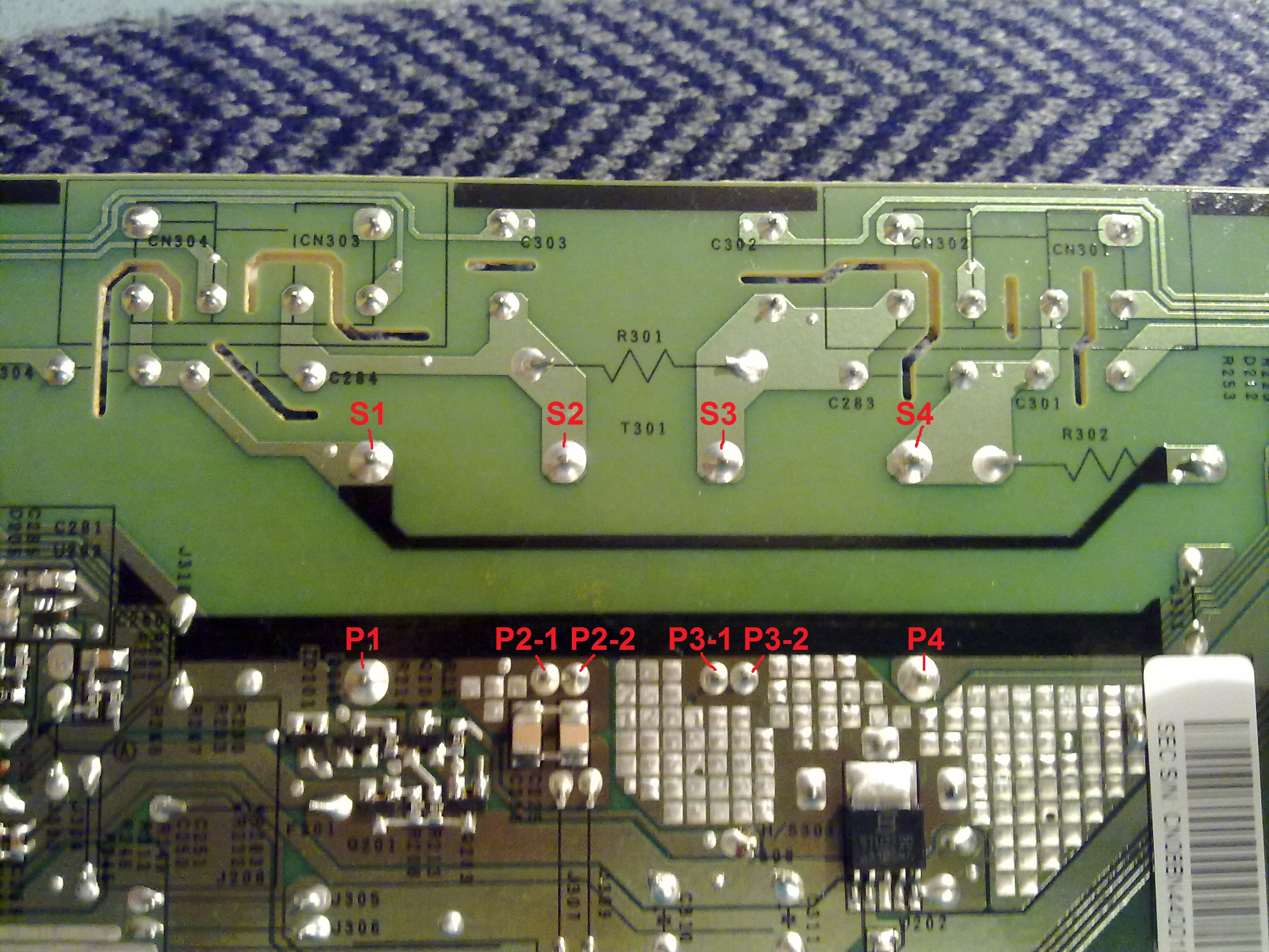

    ok but which pins - I am concerned that my original pic showing the secondaries was only an example and is not the same as yours.
    The later picture only showed the primaries which Are in the same position
    BUT the secondaries on YOURS are probably as attached.
    Were those the pins you measured?
    • jays_swe
      • Dec 2012
      • 8
      • Sweden
      #42
      Re: Samsung 2233RZ "2s to blanck"
      p1-p2 0.02
      s1-s2 920
      s3-s4 883

        It still looks as though it is bad - the S1>S2 and S3>S4 should be within 3%

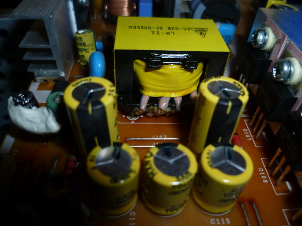

                          Is this the problem LM22
                          Just realized that post might be quite long with the photos if there's a better way to display let me know.
                          Many thanks
                          Gareth

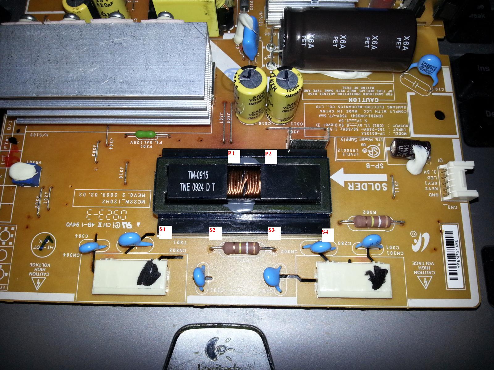

                                    Hello guys,
                                    today a broken 2233RZ arrived. He has "2s to blanck" behaviour.
                                    I just disassemble it and now I want to measure it. My first impression is, that the monitor smells a little bit like cigarette smoke. But it is not too bad, you notice it.
                                    My next impression was that I can see no bad capacitor on the board.
                                    So I want to take some measurements of the inverter transformer in circuit.
                                    I added picture of the back of my circuit and my markings.
                                    manual range multimeter, set it to 2000 ohms
                                    P2-1 <-> P2-2 = 001 ohms
                                    P3-1 <-> P3-2 = 001 ohms
                                    P2 <-> P3 = 001 ohms
                                    P1 <-> P2 = 1 (no contact)
                                    P3 <-> P4 = 1 (no contact)
                                    S1 <-> S2 = 898 ohms
                                    S2 <-> S3 = 1 (no contact)
                                    S3 <-> S4 = 963 ohms
                                    S1 <-> S4 = 1 (no contact)
                                    Does these measurement indicate any circuit failure?
                                    Greets from Germany
                                    TCC

                                      Replace the transformer, looks like the secodary comparison is outside the 3-5% ,and therefore should be changed.

                                          If you look at the pins you will note that P2-1 and Pin2-2 are common,,,similarly P3-1 and P3-2 are common, so that accounts for the two extra pins !!!!!!!
