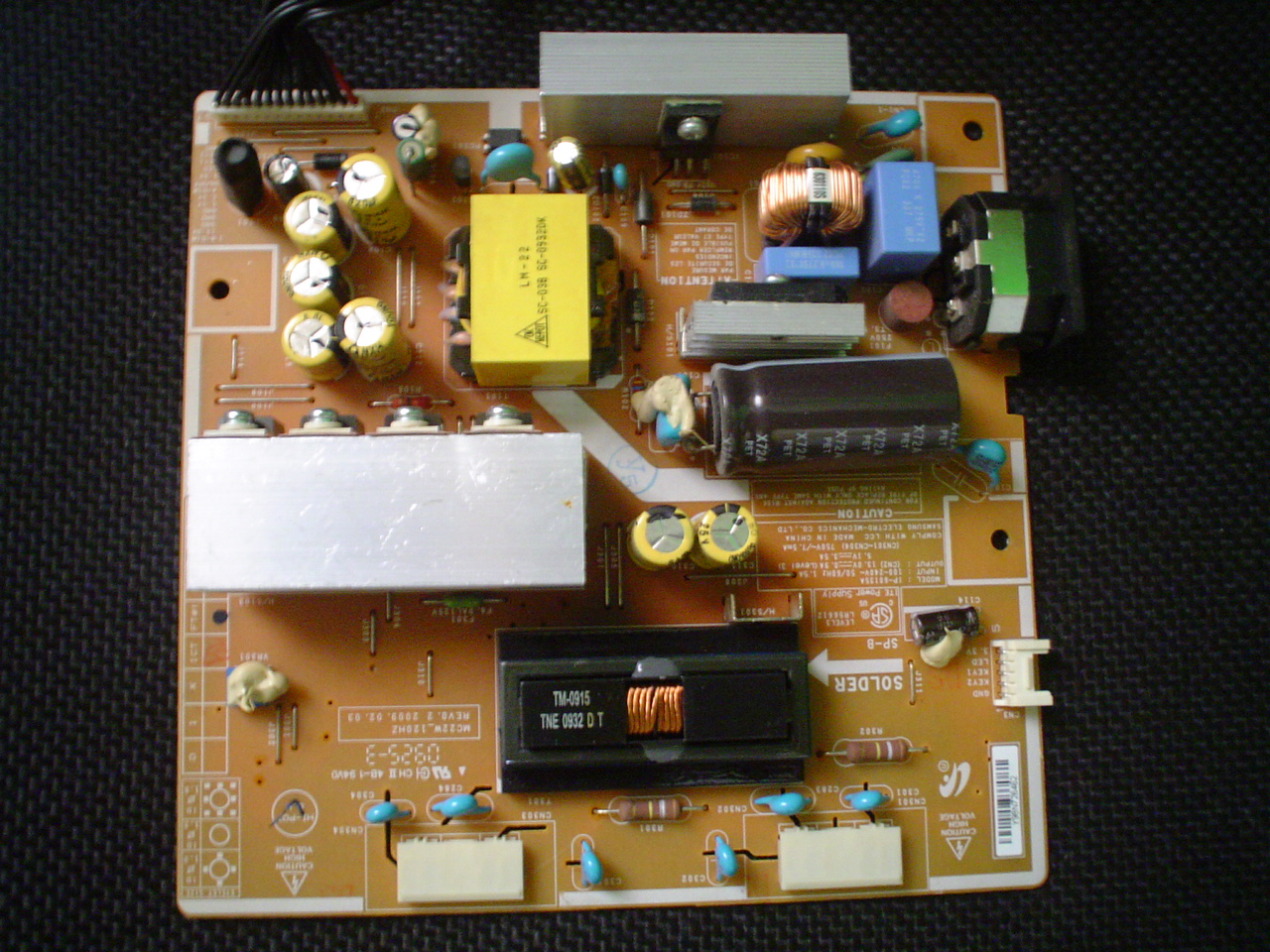

    Hi ppl!!
    Searching the forum i findout that isent any monitor of that model here yet, but i'm about to change it,

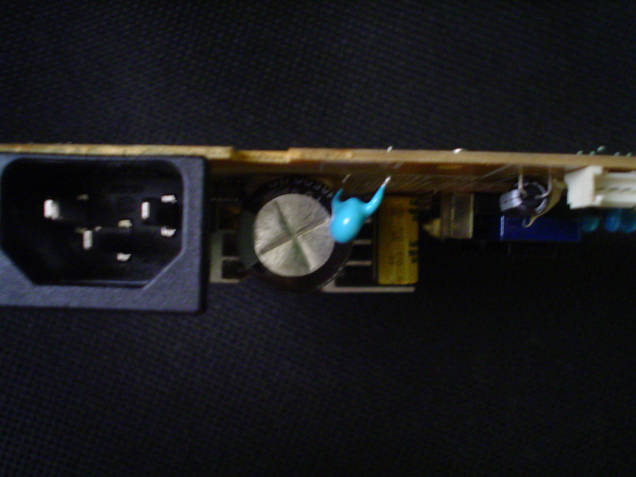

    2 days ago when i was turning my pc on i got this "2 sec to blanck" on my 2233RZ
    i opened it and made a visual inspect on the power supply, no capacitors were visible demaged, so i went to test the Inverter transformer and those are the readings:
    P1 = OL
    P2 to P3 = 0.2ohms
    P4 = OL
    S1 to S2 = starts with 1090 and then settles on 960ohms
    S3 to S4 = OL
    so, since one of the secondaries is not giving me any readings i assume that is a tranformer problem.
    i bought an TM-0915 inverter but it will take 20 days to arive here
    i will provide pictures as soon i arive home.

    That is PROBABLY an open secondary, but it is reassuring to know what range you set the on DMM.
    PlainBill
    • retiredcaps
      • Apr 2010
      • 9271
      Re: Samsung 2233RZ "2s to blanck"
      S3 to S4 = OL
      Yes, that is correct.
      I will guess that your multimeter is an autorange multimeter since it displays 0L. Manual range meters tend to display "1" on the left hand side to denote out of range.

          Yes. Desolder the bad transformer and verify out of circuit that it is open.

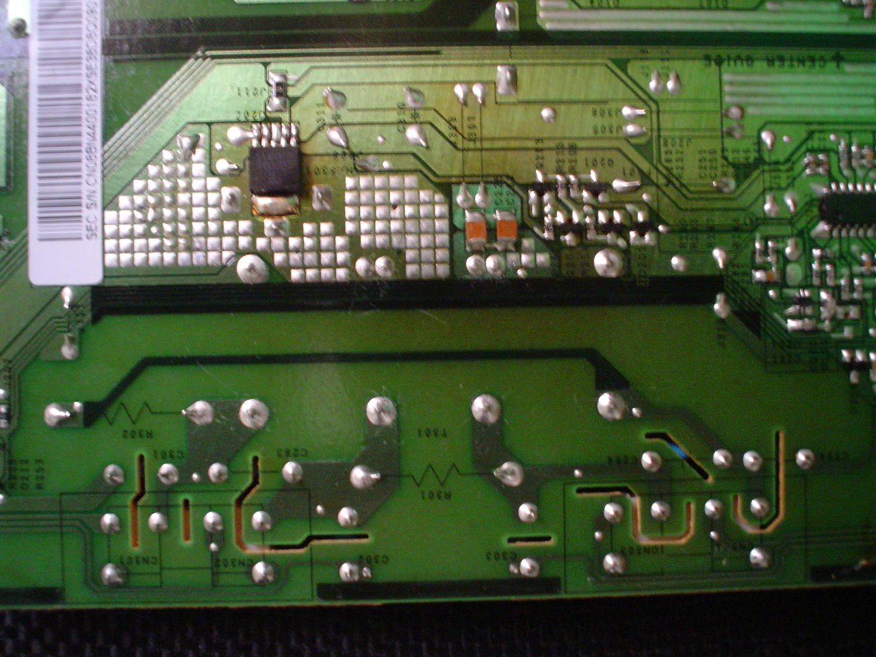

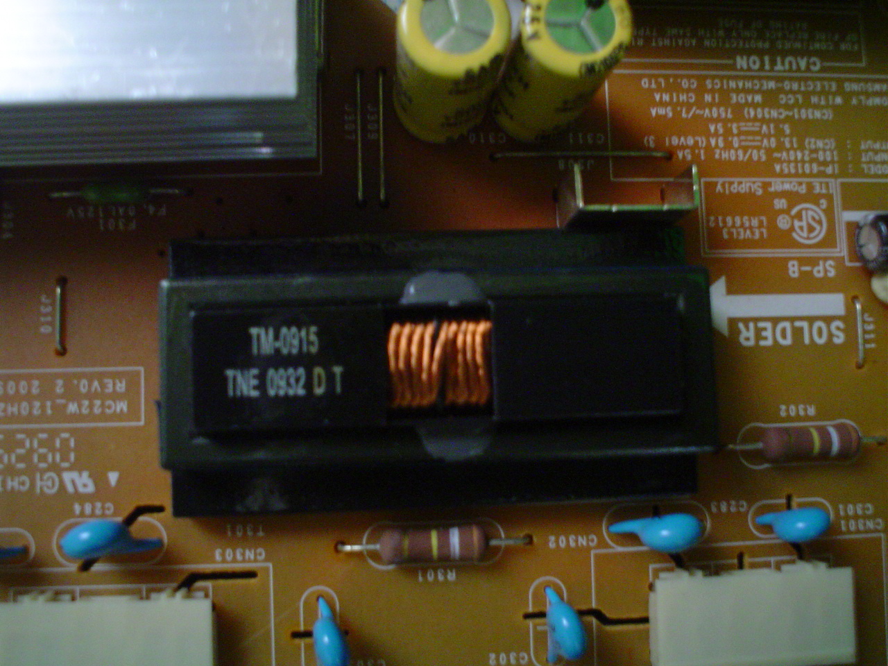

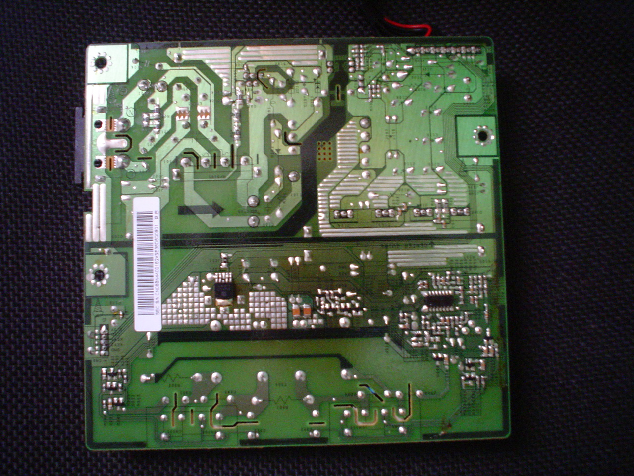

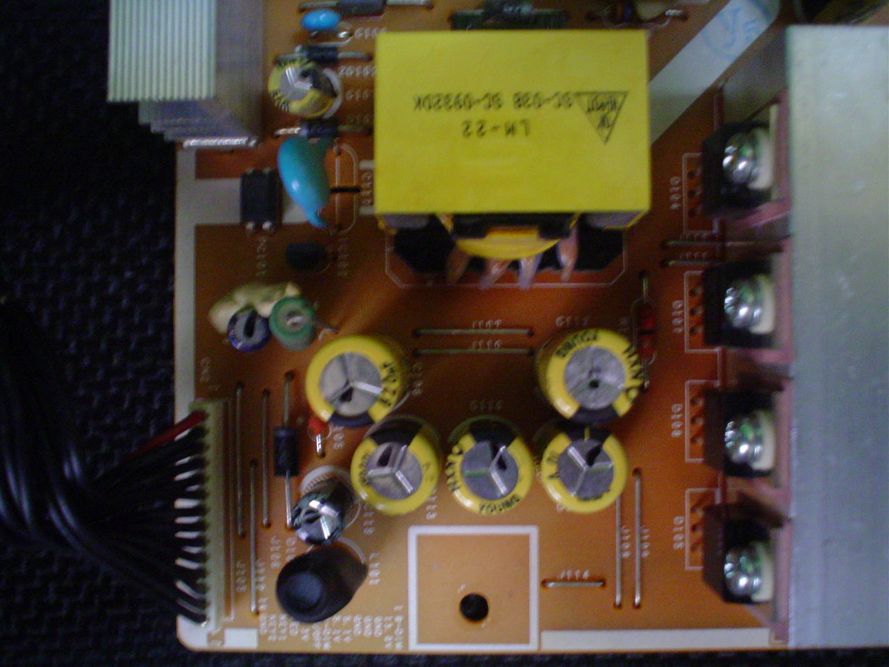

              as promised here are the pictures...
              Measured again just to be sure, the S3 to S4 is totaly dead, not a single resistence signal on the multimeter, well i've purchased a new one from ebay, from a chinese seller, it will take 30 days to get in here, so i will be for more 28 days without my gamming monitor.

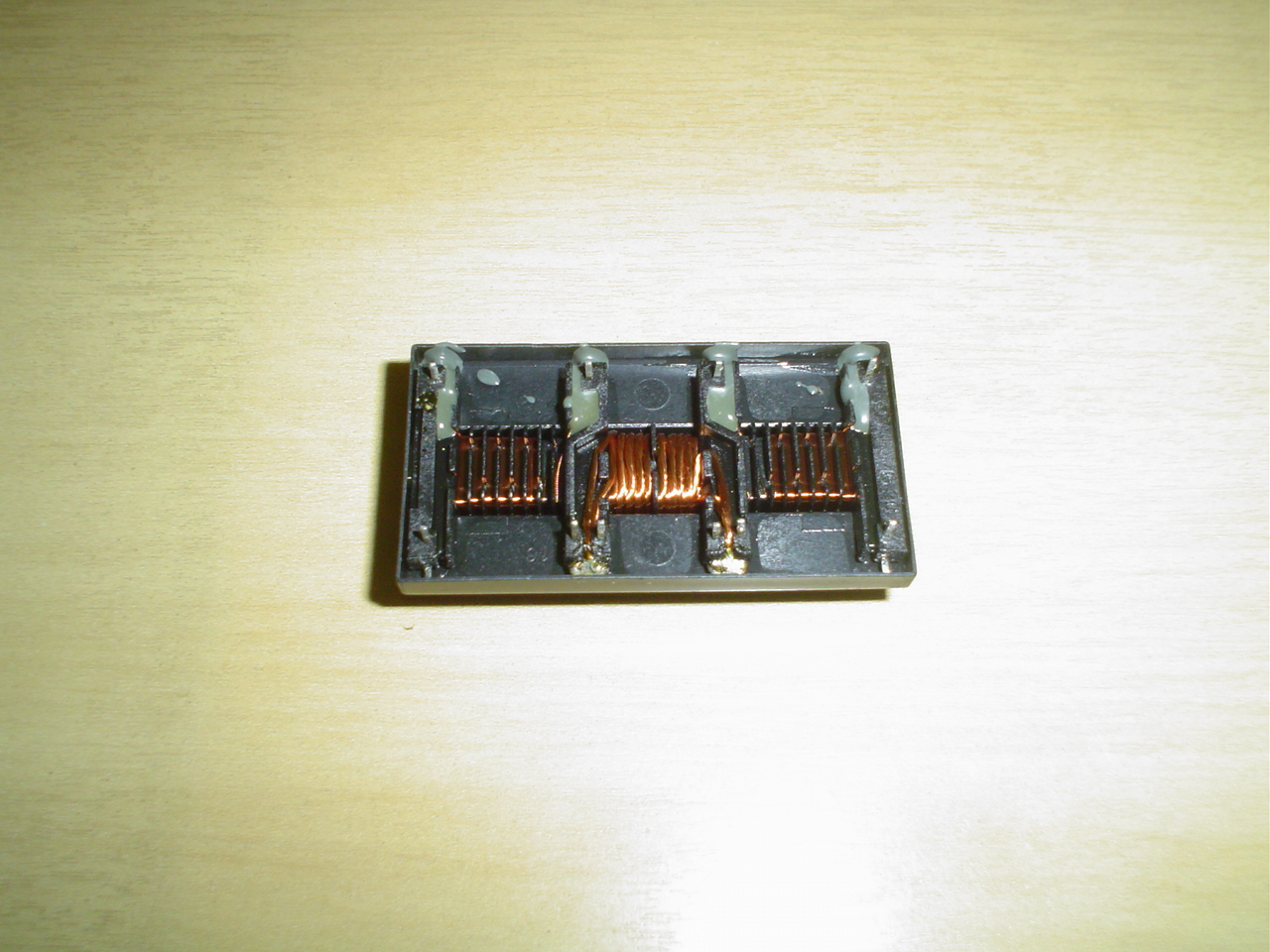

                        As requested by the member retiredcaps, i de-soldered the transformer of the circuit board and measured it
                        here are what I've found:
                        P1 OL (as it should be)
                        P2 to P3 = 1.2 Ohms
                        P4 OL (as it should be)
                        S1 to S2 = 910 Ohms
                        S3 to S4 = 2750 Ohms
                        (the multimeter was adjusted to the more accurate range)
                        due the difference greater then 3% i can guess this transformer went to the electronics heaven.
                        and also a picture attached of the bad transformer.
                        thank you guys for your patience.

                        • retiredcaps
                          • Apr 2010
                          • 9271
                          S1 to S2 = 910 Ohms
                          due the 3% difference i can guess this transformer went to the electronics heaven.
                          Definitely bad. A replacement can be found on ebay. $12 + $5 shipping from Hong Kong.

                                  well, I received the new inverter transformer today, just made the change a few minutes ago and the monitor is back to life!
                                  thank you guys for all the support.
