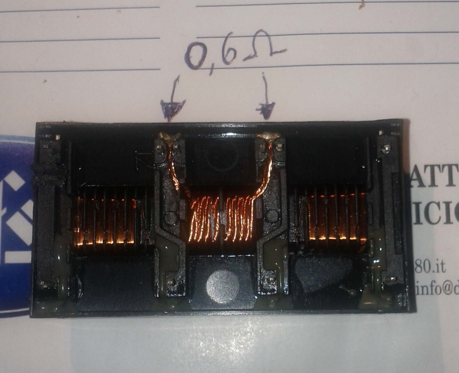

    Re: Samsung 2233RZ "2s to blanck"

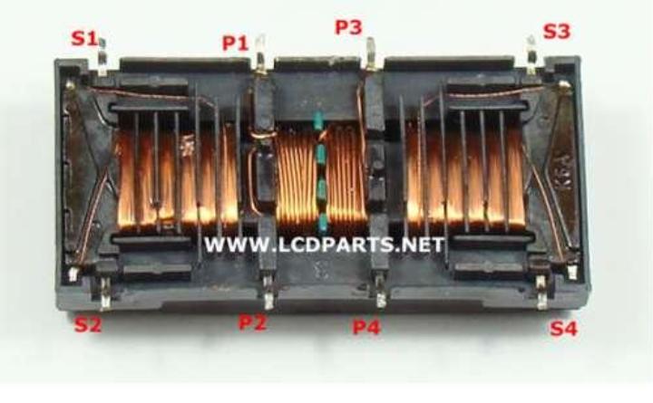

    Picture is too small can you take one of YOUR transformer top and bottom.
    They usually have 8 pins and test as attached.
    Meter on 2000 ohms. Can test on or off the board - post results.
      Ok, thank you for reply and attached image, I needed it. This evening I'll test it and report back.

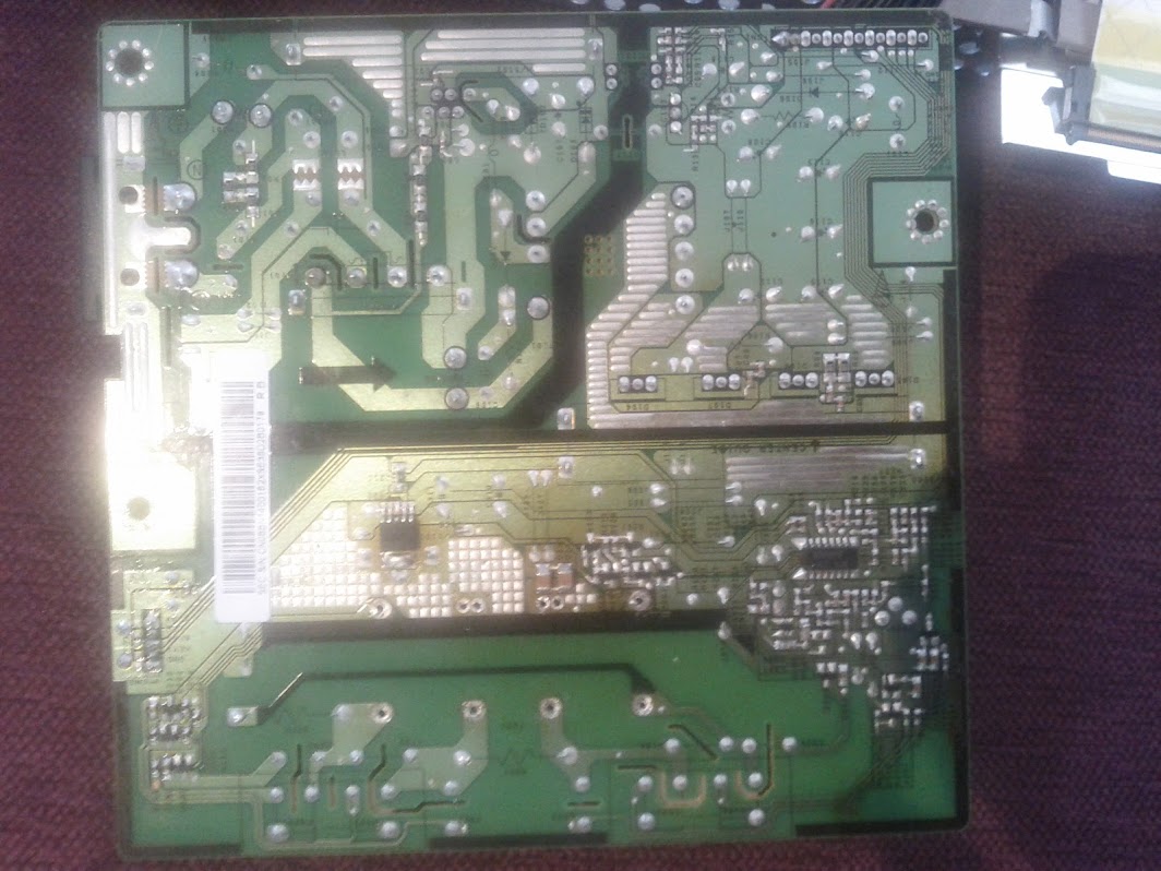

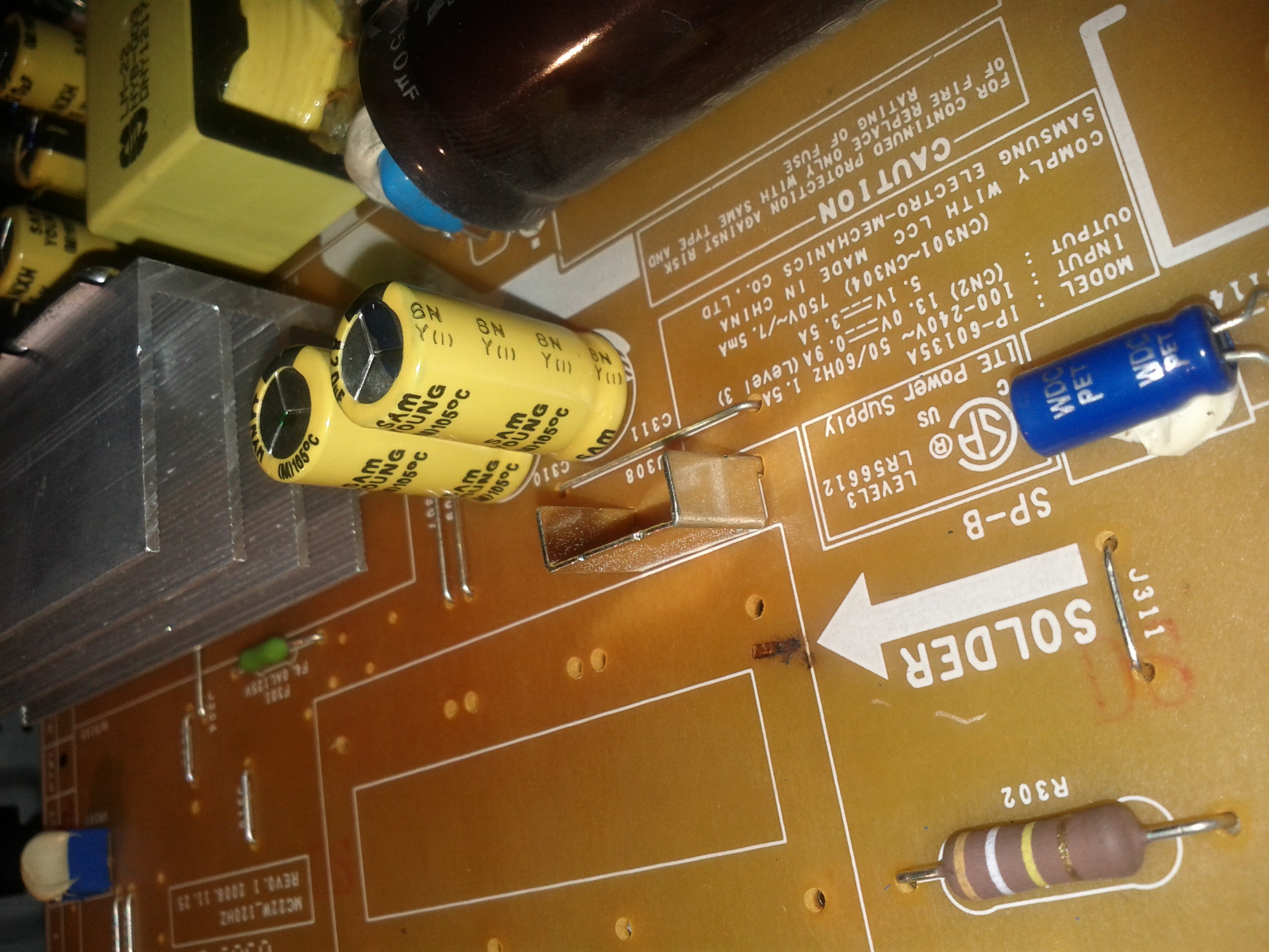

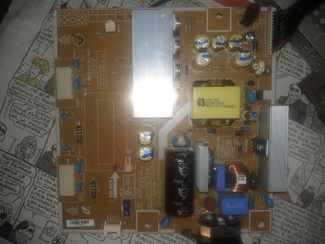

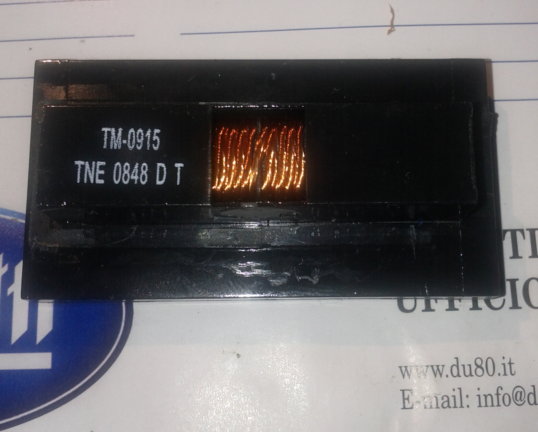

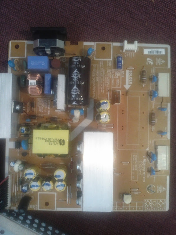

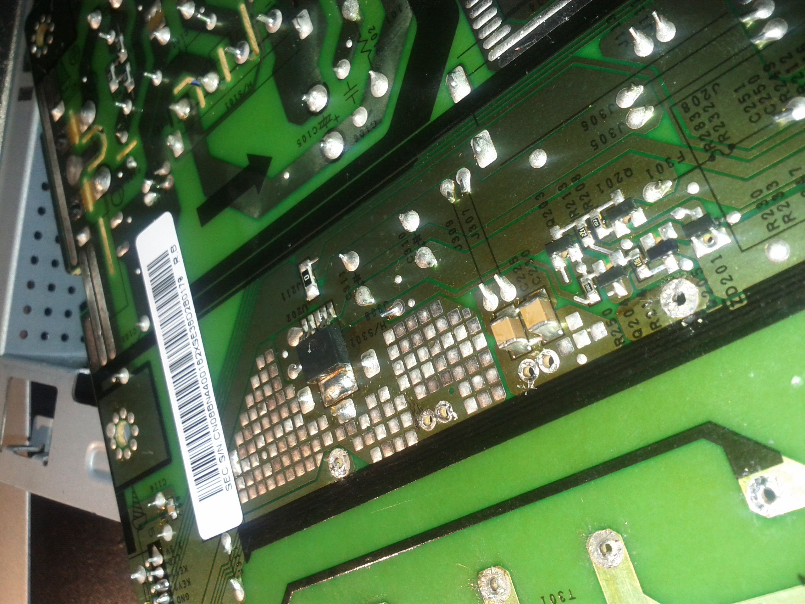

        Ok, I uploaded the power board images. On the back of it there is a "bronzed" area...I wonder if that could be a problem.
        I already bought a new TM-0915 transformer, because desoldering it I broke the magnet
        I could post the resistance recordings, but I guess that without the magnet they're altered..All "S" contacts seem to be open, as the multimeter reads "1". The only two contacts that give a reading are P1 to P3 = 0.6ohms
        Please let me know if photo quality is poor, so that I can take them again with a reflex camera.
        Thank you for support.
          That is a bit odd was meter on 2000 ohms? - try 20000ohms.
          Can you still test and post the results for the other 2 transistors?

            Pictures will do for now - you have turned the board between each shot making it difficult to work out back to front where things are - tell me what is on the other side
            of the bronzed part - doesnt look too bad. Did you put the yellow caps in? what brand and series are they?
              It was on 200 ohms, because at 2000 the reading was 0. I confirm it, at 20K the reading is 0. All other contacts coupled give "1". I repeat, I totally broke the transformer magnet when I removed it. Lol, I read "SOLDER" and thought I had to solder there. I'm a moron.
                sorry for that. I'm uploading detail of the bronzed part. Doesn't look too bad to me, too. The bronzed part is only a bit darker on the back of the board, near primary pins of the transformer and near right one (upper left transformer pins of first photo). On the board front no burns are visible (a part from my soldering mistake near the "SOLDER" label :/ ). The screen was used for about 6 hours per day for a year and half, then started going black after 2 sec.
                  Ok firstly sorry - forget transistors for now - mixed up a reply on another post.
                  I was thinking transistors were overheating part of the board making it bronze but dont know why I mixed the two up.
                  Anyway do you just mean the small brown mark the white arrow points to (very convenient that being there)
                  I think it is just where the secondary wiring has burnt out and marked the board.
                  Dont really think there is much we can test until you get a new transformer, unless you have another monitor in which you can test the panel (CCfls)

                    #29
                    No I made it, because I'm a moron, I read "SOLDER" and I tried de-soldering there on front of the board at first. Don't laught at me
                    My stupid action maybe burnt the secondary wiring, I agree on this.
                      The transformer arrived. I soldered it and...IT WORKS!!
                      I'm so happy I saved it
                      thank you for support

                                        Can you just confirm which pins you measured - can you post a pic of your transformer
                                        • jays_swe
                                          • Dec 2012
                                          • 8
                                          • Sweden
                                          #40
                                          s1-s2
                                          s3-s4
                                          p1-p2
                                          p3-p4
