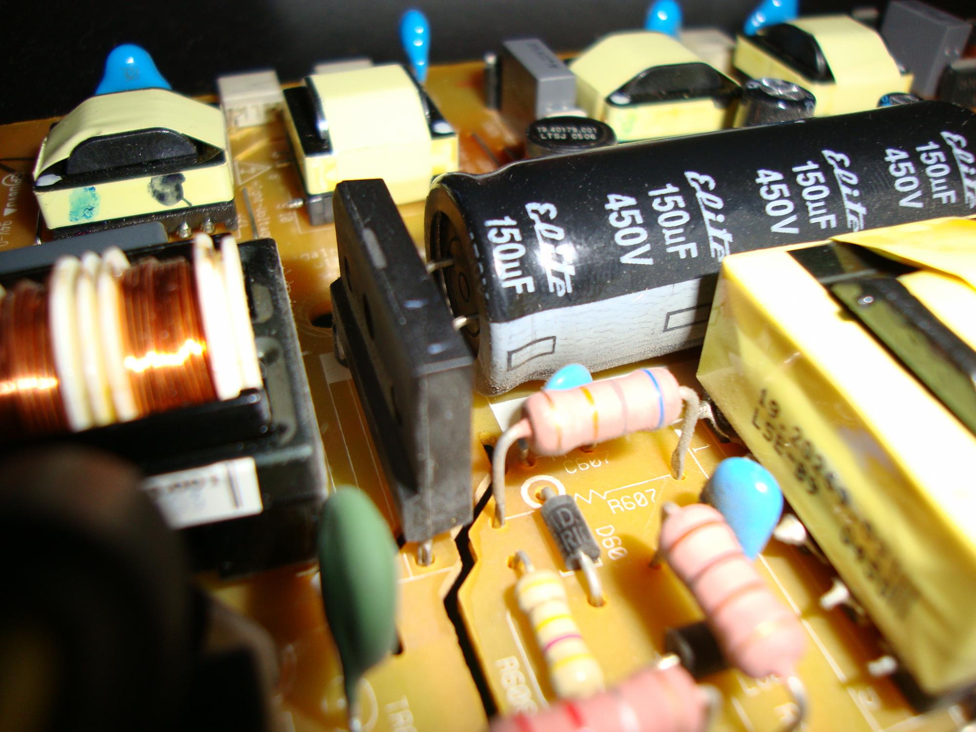

    Hp 1955
    The hp 1955 (Benq 48.L1A02.A00) the monitor was just totaly dead.
    So I opened it and removed the power board. So I found out that one of the three pins on the power cable connector was blown. If you look at the "green" side its the left pin. the center pin was loose and the right pin had cracked solder. So I resoledered it. I think I did I decent job on that but it didn't help at all. The power led didn't go on. also here is no bulging on capacitators or something similar. What do you think, could it be both the C5707 transistors and the picofuse maybe?

    Let's do this logically. What is the voltage across the large cap? On the top view there is an 8 pin IC partially obscured the green wire. What is the part number of that IC?

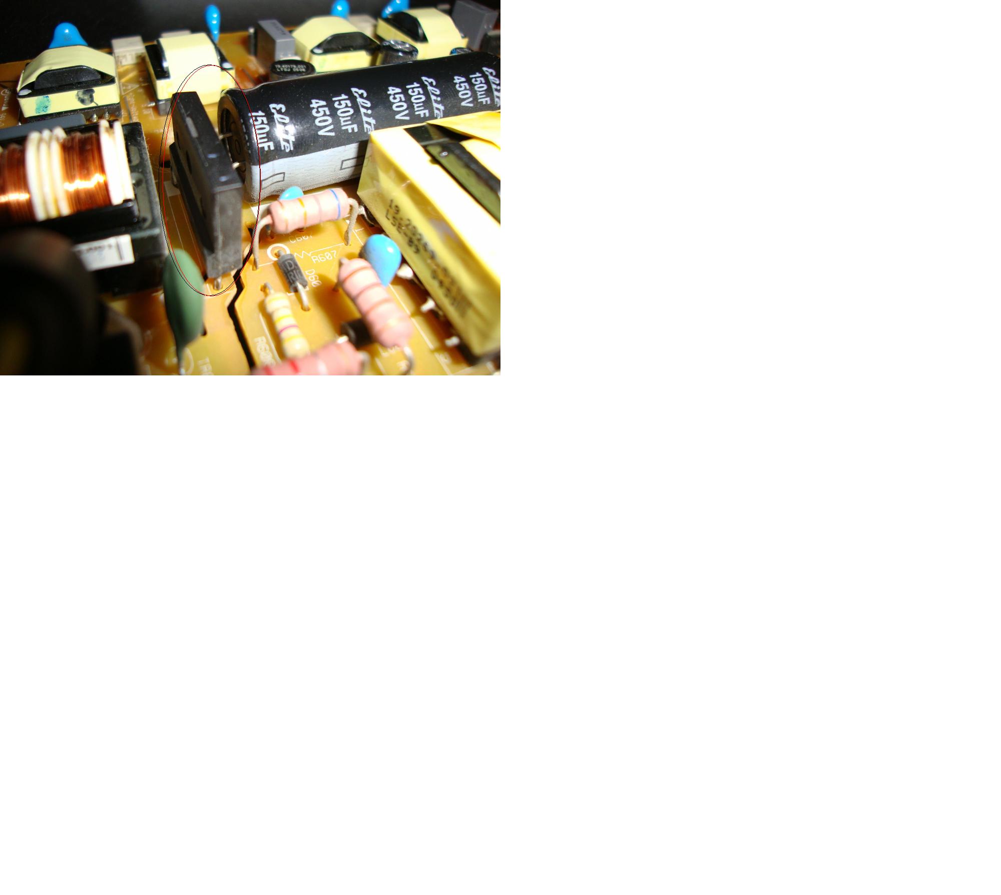

                              No Not the power connector pins - the pins of all the components ringed in red on the earlier picture.

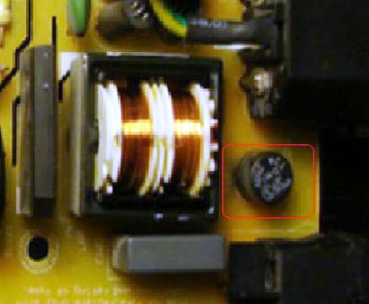

                                  No ,I mean the mains fuse - I have marked what I think is a fuse It will probably say on the board and on the fuse but cant see. (This is why good clear photos are important)

                                        Hmm! test fuse?? Whilst looking for an easy way to show this I noticed that this board has a switch. When you were testing the BIG Cap
                                        was it definitely switched on?
                                        If it was can you test the switch. - same as the fuse but obviously resistance when on and none when off.
