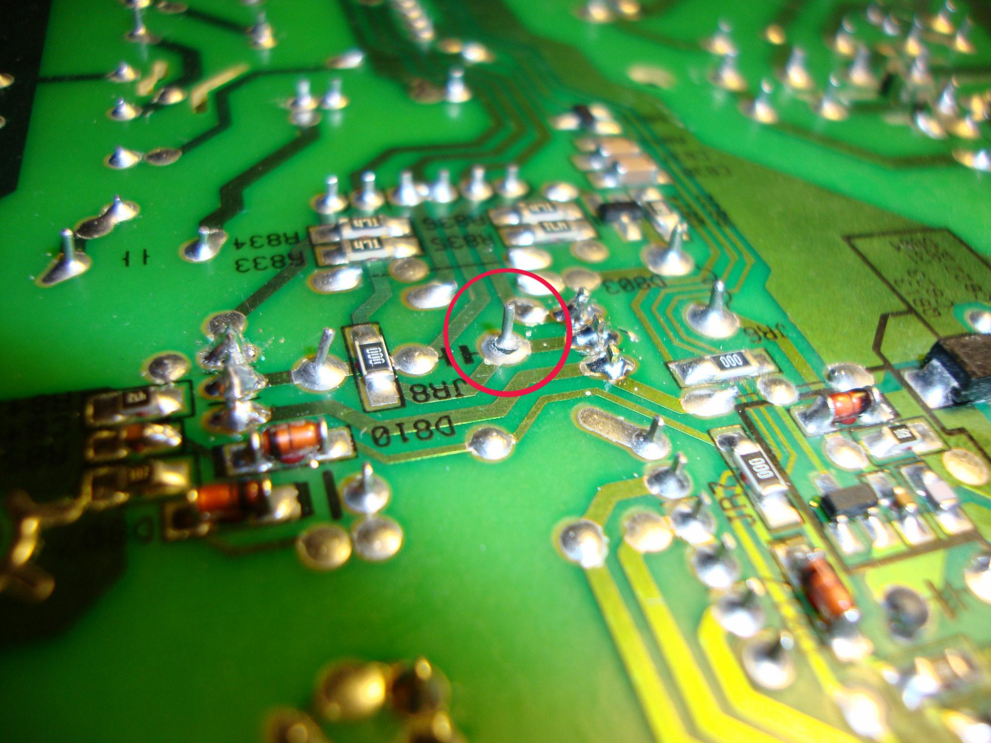

                So I think we have solved it all.
                First I desoldered the c5707 transistors and tested them. Nothing wrong here...
                So I did a more close up inspection on the area and who could have thought there was a real crack in the solder, so much that when pushing from the other side it went through. Resoldered only the crack. Well I first melted the original solder and also added some new solder. Now it's working like a charm at least the time tested.
                Made a picture on that so you can se for your selves, also some of the resoldered transistors are in view.
                I will leave this screen on for a while and see if it can hadle being on.
                If it passes then I guess I'll have to say thank you all for the help!
                  #48
                  Re: Hp 1955
                  Great Result
                  How many times did we suggest cold joints - resoldering?
