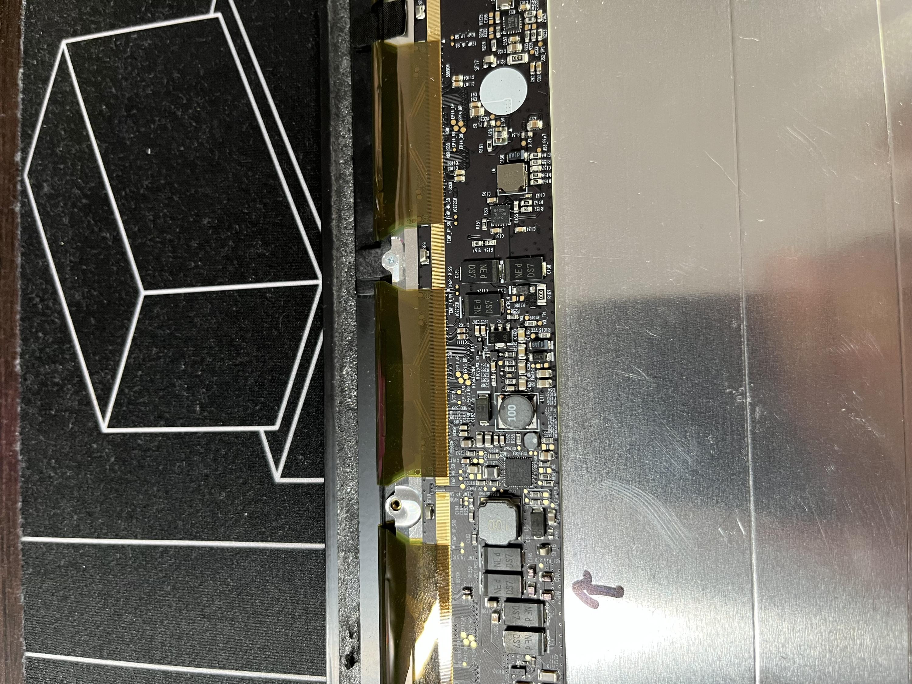

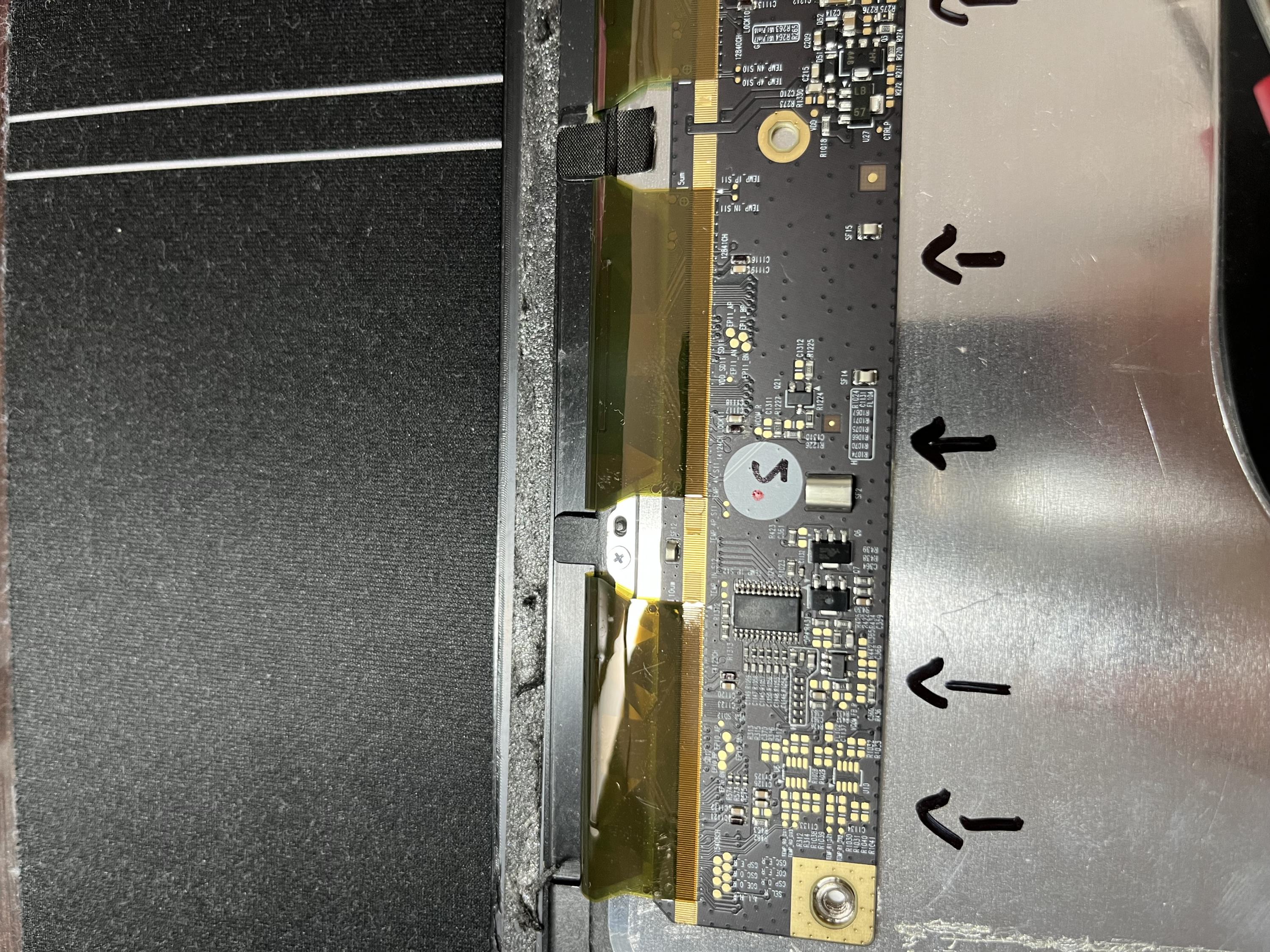

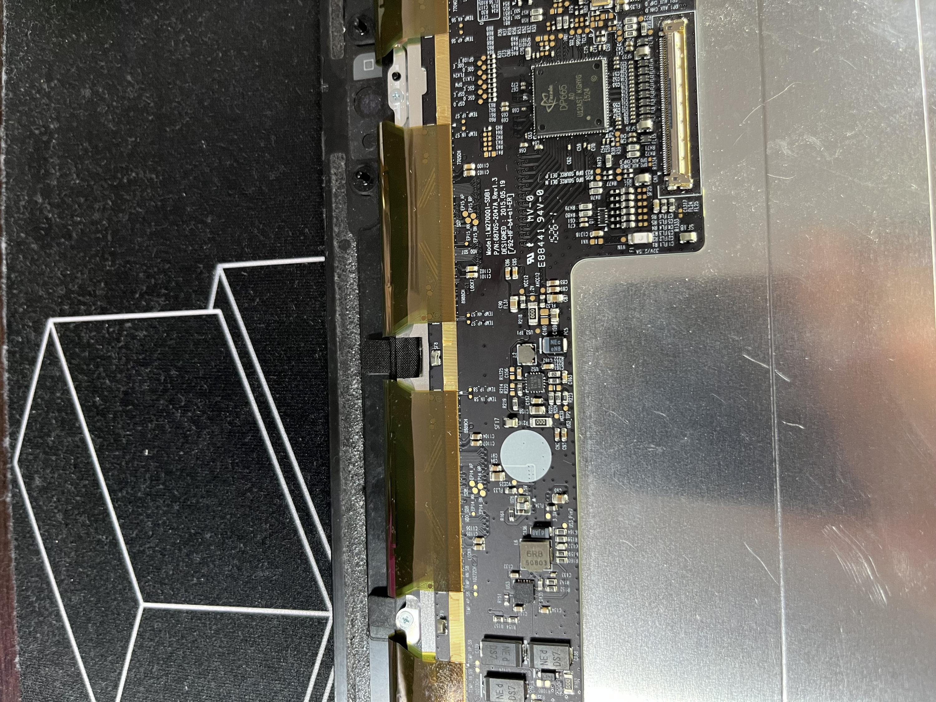

    Want to repair t-con board
    display has no screen, but backlight is on, it communicates with mainboard, all diag leds on.
    all ribon connections are without damage
    mainboard functions without problem. connected an other display and there is a picture...
    so i investigate t-con board and all capacitators for shorts and blown fuses
    can´t find any fuses...???

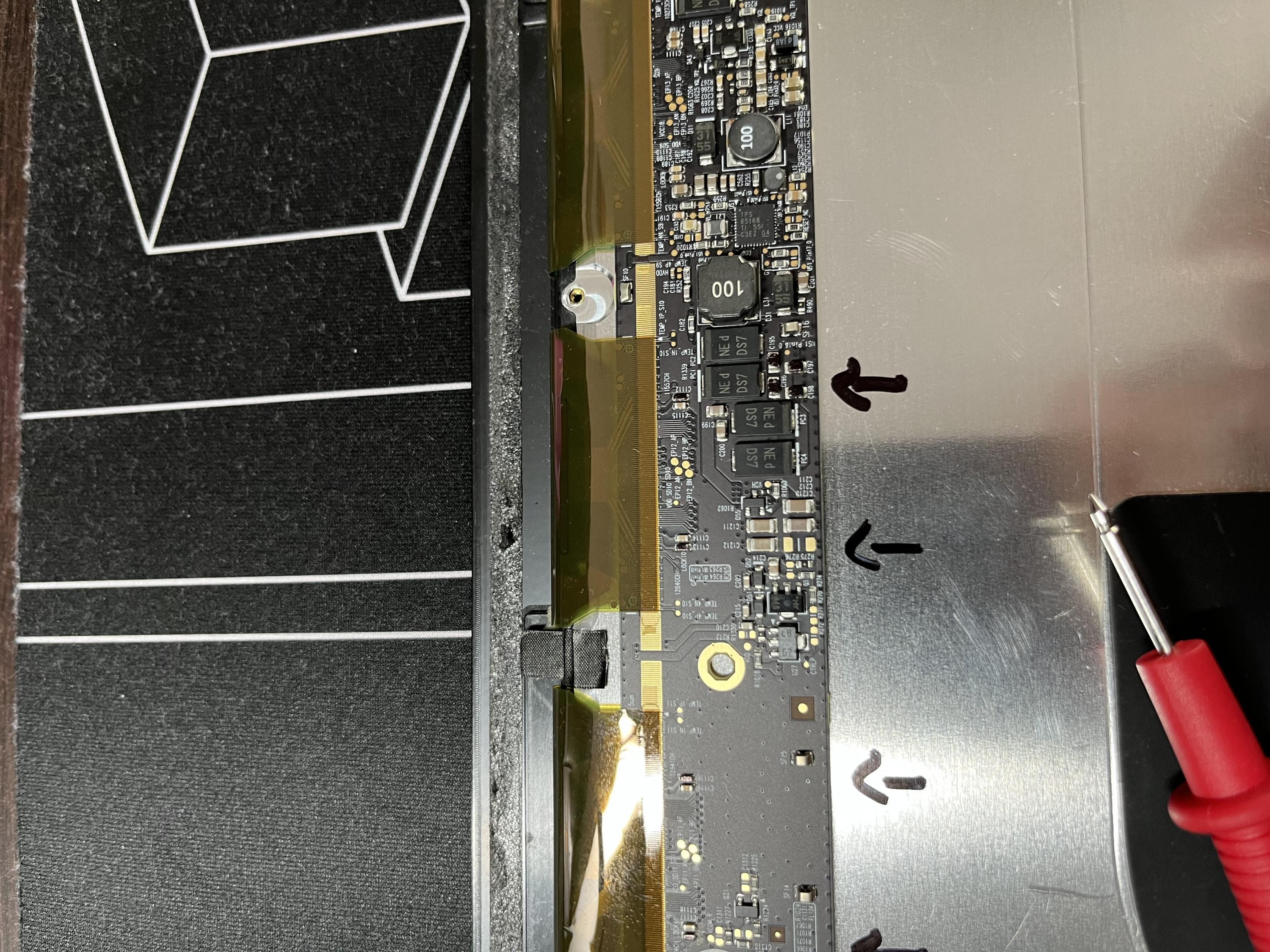

    so there are many capacitators that seems shorted... i don´t know if this is normal..
    black marked caps are shorted.

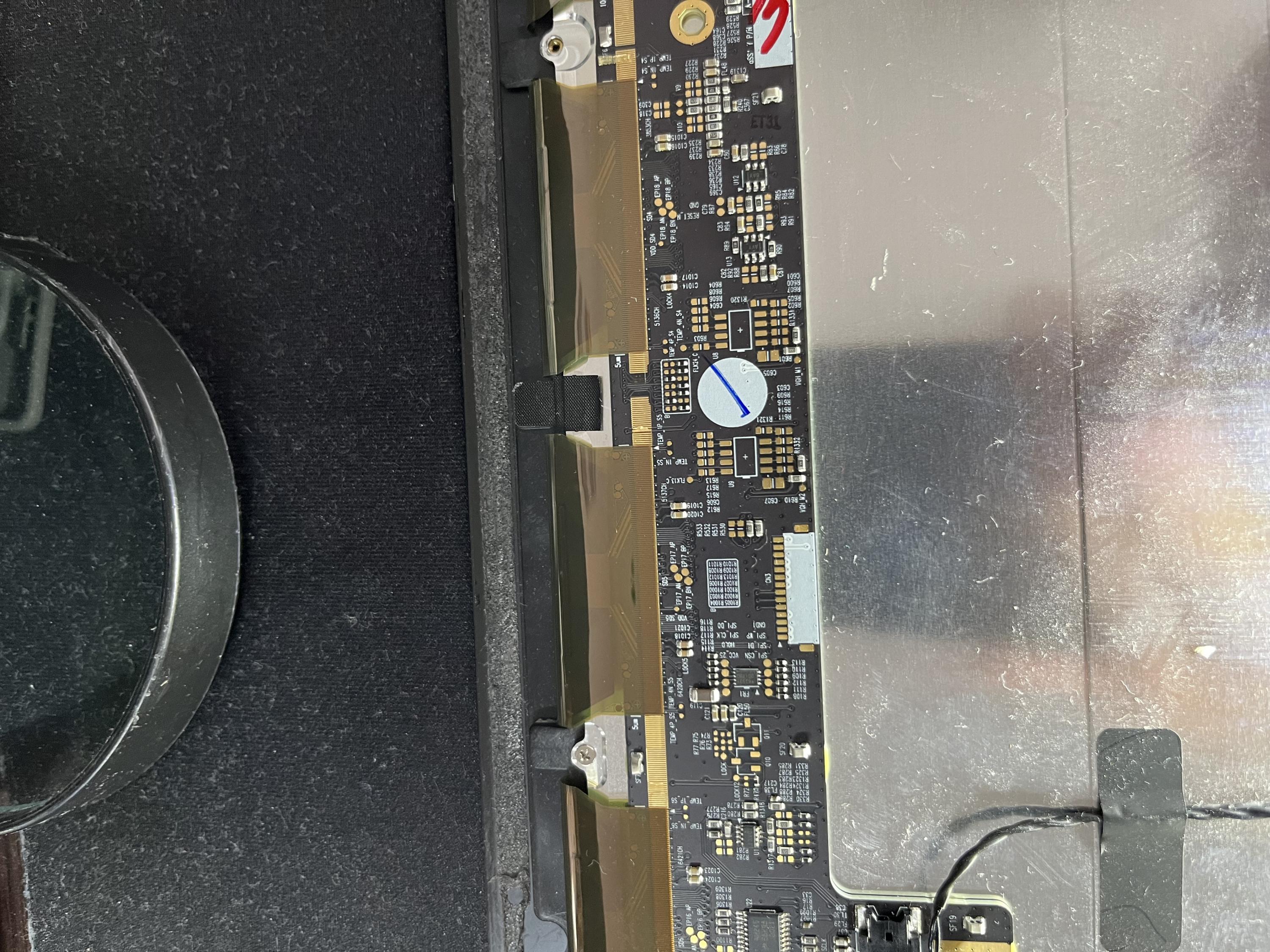

    if you have doubts, remove them from the motherboard and measure them...the fuse is in the last picture below the LVDS plug...(F1)...
