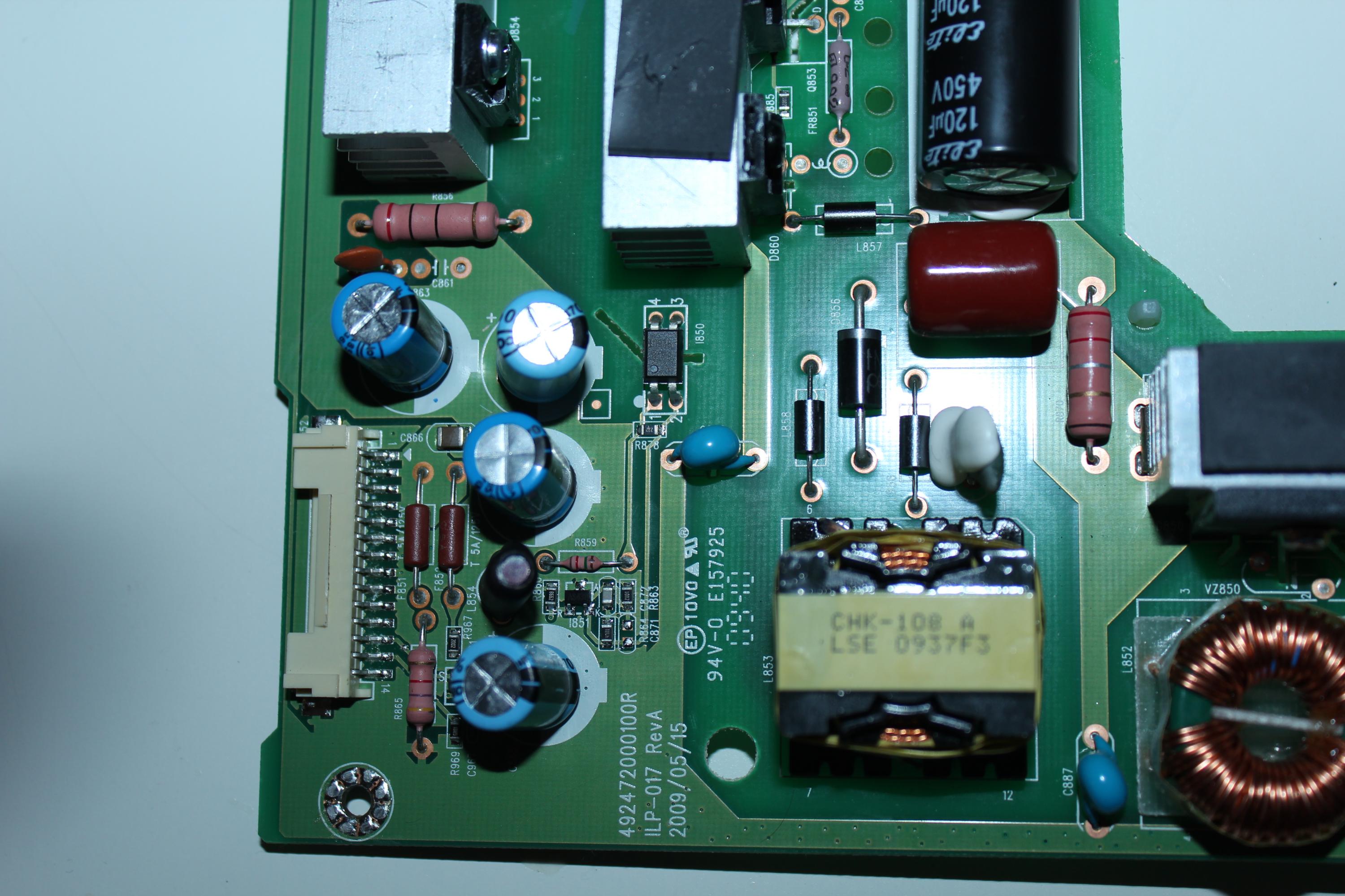

                    ok - here's an update, I went to radio shack and bought 4 replacement capacitors. (probably not the best quality, but didn't really want to wait and if it solved the problem then I could upgrade them at a later point and be happy with everything ) That being said, the issue persists.
                    I could have messed something up when soldering them.. but I don't think I did. I've attached some pictures below of the solder job, as well as some more pictures of the power board and the inverter.
                    This monitor doesn't look to have a single CCFL but instead multiple smaller ones that are connected across the inverter. When you see the picture you should be able to gather what I'm saying. **Edit** The backlight style is known as a "7 CCFL U-type system".
                    I took some measurements off the power connector going into the inverter and some other random points on the board. The huge 450 V capacitor on the power board is measuring 250 V (measured in ||)
                    The two brown resistors read 23.8 V in series.
                    The power connector pins measured in series read (starting from the white triangle you see in the picture by the C866 marker)
                    23.8, 23.8, 23.8, 23.8, 23.8, 0, 0, 0, 0, 0, 0, 3, 2, 0 V
                    When measuring the voltage in || across the capacitors I swapped out I get a 23.8 V measurement across all of them.
                    I didn't take any measurements on the inverter board as I wasn't sure what kind of voltage the bad boy can crank out, and I didn't feel like testing my luck. If it's something you guys think you need then let me know.
                    At this point, I would really like to get this thing fixed with some capacitor/other minor repair as a replacement inverter board for this thing looks like it will run me $70 (which I wouldn't mind doing if I knew that would solve the issue!)
                    (If you want original high def pictures of board let me know and I can try and upload them to a 3rd party site)

                        Can look at the sceen in the dark to see if the backlights even flash on for second, so far the voltage readings are OK for the inverter board, but the reading on the 450V cap is too low, it should be around 390~400VDC due to the PFC Voltage booster circuits. What is an AC voltage in your country?

                              Try checking the fuse on the inverter board. It the small white rectangular component marked F001.
                              • wasmundt
                                • Dec 2011
                                • 32
                                Re: Dell U2410f
                                Yup, just got done measuring that after reading up on some other things. The fuse is labeled, as you mentioned, F001 but also 6.3 A, and 125 V. Measuring the Voltage I am seeing it as 23.8 V (the same as the capacitors, and the leads coming into the board)
                                Also, would like to correct my typo above - the large 450 V capacitor is reading a difference of ~240 V, -56 on 186 on the (-/+) terminals.
                                **Edit** I was trying to measure some of the voltage regulators, and I nicked the small resistor alongside the large 450 v capacitor. Needless to say, I got a nice "pop" for my troubles. It caused the voltage reading across the capacitor to drop by about 100 V. I de-soldered it and attached pictures of the resistor. It's got a 0.2 Ohm labeling. Other labeling, an undistinguishable character followed by 992 and another label of F13? These are the best I can make out of it. Any ideas as to what exactly it is would be great so I can repair my blundering

                                  "the large 450 V capacitor is reading a difference of ~240 V, -56 on 186 on the (-/+) terminals" I do not knopw what you mean, you should measure it at the two legs of the cap, it should have a bour 165VDC when the monitor is plugged in, then it should go up to 390~400V when power up (if your line voltage is 120vac). When work on primary side of the circuit, do not use the chassis as the ground ref, you have to use the negative leg of the cap as the ground ref point.
                                  • wasmundt
                                    • Dec 2011
                                    • 32
                                    Re: Dell U2410f
                                    .2 ohm F1J Fu 992
                                    Those are the markings on the resistor I burned out, but not really sure what I should use to replace it.
                                      Re: Dell U2410f
                                      That may be the resistor for the Source pin of the MOSFET, you need to trace that out, or it can be the protection resistor in the B+ Line. Need to see the closed up loaction of that resistor and the trace on the bottom side to see how it is connected in the circuits.
                                      0.2 Ohm 1/2? MOX (Metal Oxide type).

                                        Ok, so another piece of the puzzle is that it's labeled as a FRXXX on the circuit board, not just RXXX, not sure what the distinction is.
                                        Pictures of the surrounding circuit are attached.
