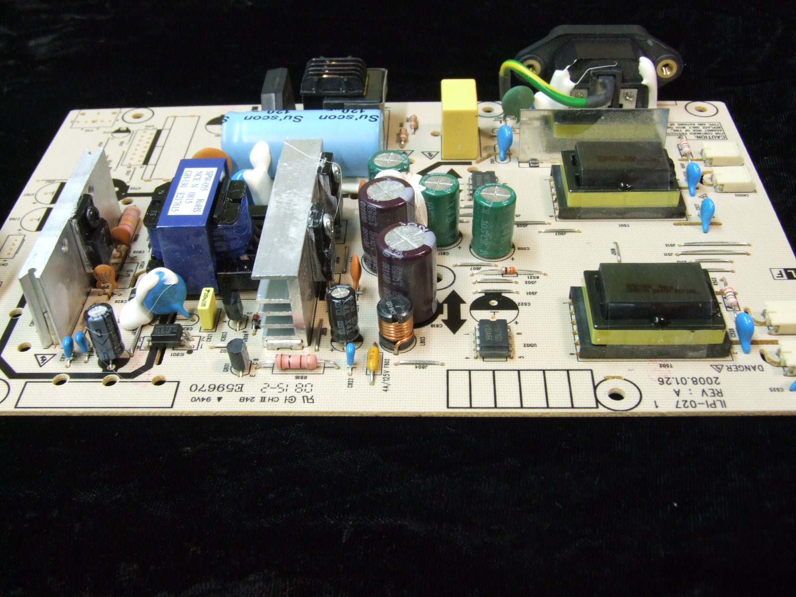

    I have 6 of these monitors and they all have the same problem. They all have over 2000 backlight hours on them based on the on screen menu timer.
    When the screen goes black, the power light stays green and I am able to see faint image on screen by shining it with a flash light.
    I have disabled the on screen sleep mode and power saving mode via screen menu.
    I believe I have isolated the problem to the inverter on all of them. Since the PSU and inverter are on the same board do you think recapping the board will help? All the caps look good. I dont have an ESR meter.
    I have checked the backlights by using my CCFL tester made from a Case mod kit and the lamps stay lit (only able to check one at a time)
    I plug the TEST CCFL from the mod kit into the inverter board and the light only lights half way up on two adapters and then goes out, on the other it lights up completely, but goes out in seconds.
    I have googled and searched the heck out of this problem and have not found much. I do see the board is used on lots of other PSU as well, but in different configurations.
    Any ideas on this problem?

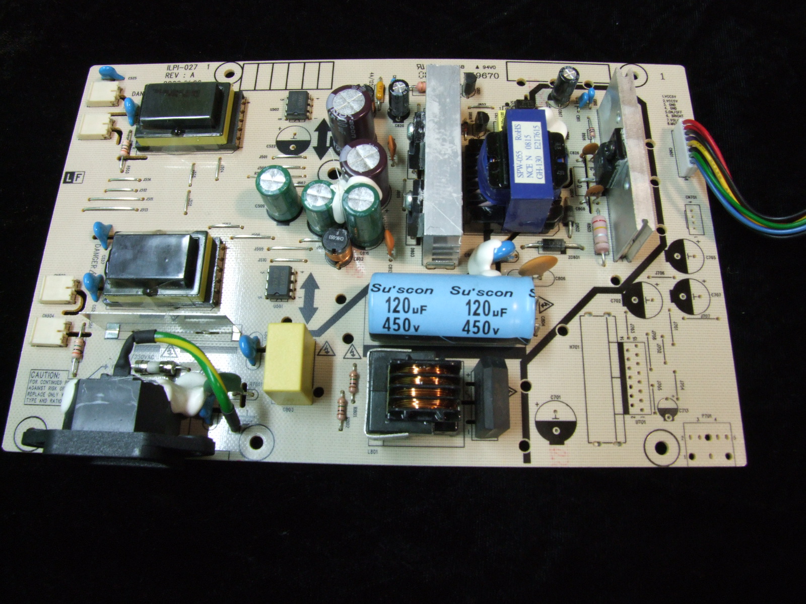

                  I have been lucky enough to see quite a few of these monitors.
                  I will not say all have been CCFL issues, but the great majority has been.
                  The top pair of CCFLs has had problems with solder joints.
                  Even though you have tested the CCFLs with the MOD kit, I am going to recommend you do one more test.
                  Disassemble the monitors enough to get to the CCFL connectors.
                  Do not dissemble the panel, And the ribbon cable does not have to be installed.
                  Try using the bottom set of CCFLs of two panels, see if the 2 second problem goes away.
                  Please make sure everything is insulated so as not to touch ground, This includes the ribbon to the panels there is voltage on it.
                  Edit; even though your problem can take minuets to occur, I would still call it a 2 second problem.

                          Okay after dissassembling 50 or so monitors I have a better understanding of how they work and the test you asked me to perform. With the original top and bottom lights plugged into the inverter, the screen comes on and goes off within seconds. Using a known good CCFL in the inverter in place of the top panel lights, the monitor continues to operate normally. So tomorrow I will do as you have suggested and check the solder connections on the endcaps. I will post my findings. I will be very happy if I can get these 6 monitors fixed.

                            Alexanna: 1 down 5 to go, you were absolutely correct the solder joints are bad.
                            One question for ya...it took me a couple hrs to get the first one done, I had to completely disassemble the monitor to repair this solder joint, what is the easiest way to resoler this, in the light cradle or out of the cradle?
                            I did rip the silicone caps, and during diassembly put it back to gether with an automotive silocone. I read this somwhere.
