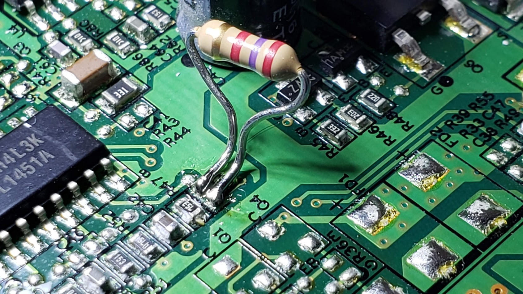

        #43
        Re: Dell 2007WFP Constant On/Off
        Originally posted by POM_MJ
        I've the same issue one, and fixed by myself.
        1. I've remove all glue circled in the picture.
        2. replace the chip resister code 272 (2.7K, 0603, arrow pointed).
        hope this reply could help.
        ps. original pictures are from this thread => https://www.badcaps.net/forum/showthread.php?t=10658
        I had the same issue as others in the thread, monitor would turn off and on randomly. I assumed it was a capacitor. I replaced the resistor as suggested in this thread, and it has been working like a champ since!
        So, thanks guys!
        Pics attached.

            #45
            My dell works again!! Removed that broken smd resistor. Didn’t have 2,7k resistor so now there is 1.2k and 1.5k trough hole resistors in series.
            Used some hot glue to secure those resistors in place.

                  #48
                  This was EXACTLY my problem. My 2.7k resistor was actually showing wandering resistance when measured - it kept changing!
                  I unsoldered it and tore the pad. I then traced the pcb traces and connected the resistor (only 2.2k) to the transistor and IC directly for better mechanical strength.
                  I tore off some of the excess heat sink tape between the power supply and chassis to add back in some thermal mass for those resistors to replace the removed glue.
                  So far, so good. I would have NEVER found that failed resistor. Thank you, everyone!
