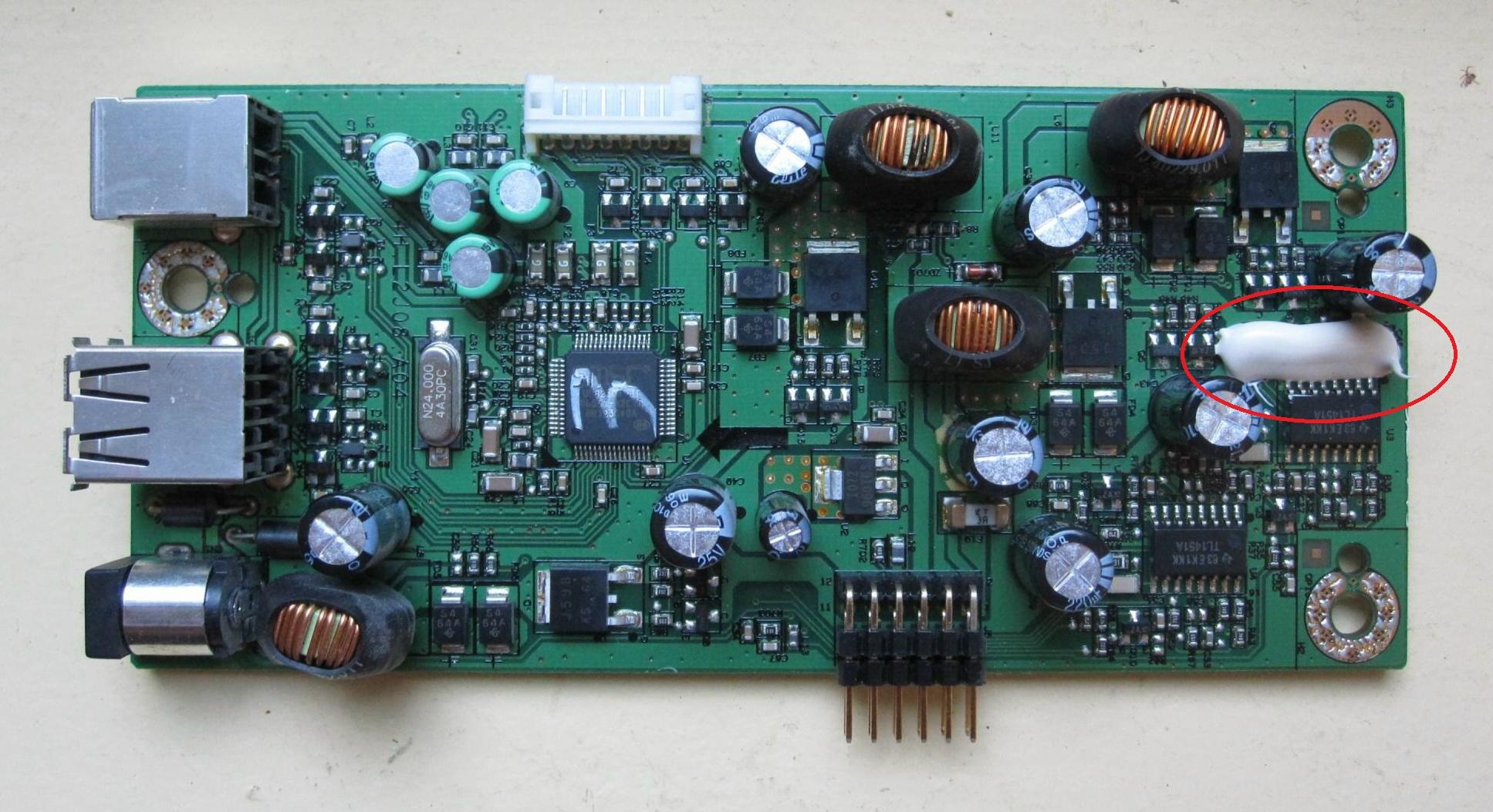

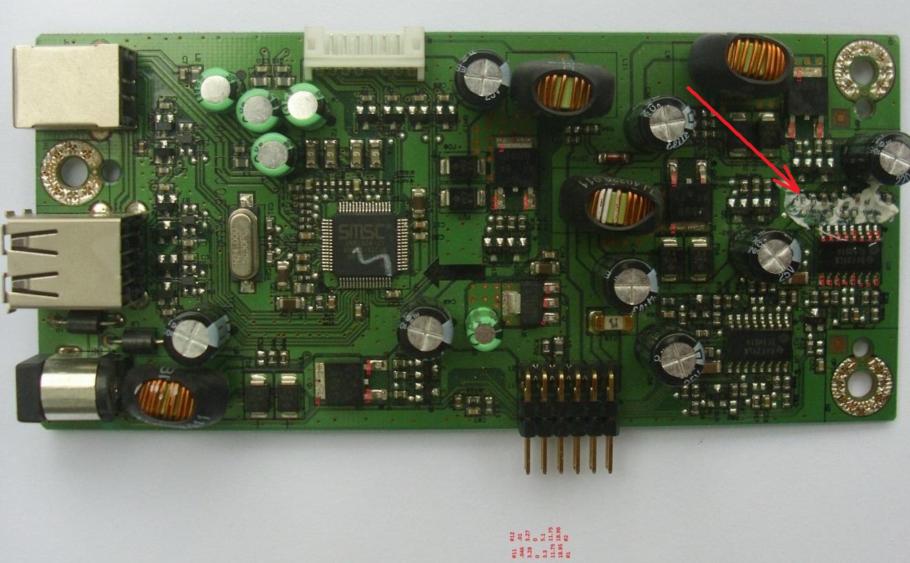

Re: Dell 2007WFP Constant On/Off
Thanks for the tip, POM_MJ, as I would have never figured out that tiny resistor on the USB board would be the cause of the cycling issue. I checked, and sure enough the resistor in my monitor was open. Not having another tiny resistor like that, I carefully tacked on a regular striped red-purple-red 2.7K resistor in place of that tiny one and the monitor is working again.
I don't think that the stuff you have to scrape away is glue, as there is nothing there that needs to be held with glue. I am guessing that it is some sort of thermal compound designed to conduct heat away from those resistors, which must be overstressed, so they tried to correct it with the glue-like substance. Maybe that is why this resistor fails. At least now I have a full-size resistor in there now. Thanks again for the tip.
Dell 2007WFP Constant On/Off
Re: Dell 2007WFP Constant On/Off
And another thank you! I removed that microscopic 272 resistor and tied a 4300 and a 7500 ohm resistor together in parallel to get a 2.7k ohm, wrapped in shrink wrap and soldered it in!
The whole thing took a few hours but I learned a lot and it seems that the monitor is working! No more continuous shutdown and restart cycles.
Thanks!Leave a comment:
Re: Dell 2007WFP Constant On/Off
Have you got a soldering iron ? It might be worth trying to replace the resistor POM also mentions.Leave a comment:
Re: Dell 2007WFP Constant On/Off
Like POM mentioned, all i did was remove the glue, over the last 24 hrs monitor has not given me any issues so far. Maybe it's just that glue and over time it heats up around that area and causes monitor to turn off and on repeatedly. Will know more if after a week or month later my monitor does not shut off on its on!
Also it could be the fact that i have not plugged in the USB ports on the side to the board. Figured i do not use the USB ports anyways so might as well not connect them.
Update: Spoke too soon it seems like its dead again, maybe on ebay i will find one with cracked screen and replace various boards and see what happens.Last edited by IamPK; 12-01-2014, 02:44 PM.Leave a comment:
Re: Dell 2007WFP Constant On/Off
I've the same issue one, and fixed by myself.
1. I've remove all glue circled in the picture.
2. replace the chip resister code 272 (2.7K, 0603, arrow pointed).
hope this reply could help.
ps. original pictures are from this thread => https://www.badcaps.net/forum/showthread.php?t=10658
Before, i changed all the capacitors from the power supply board, without any result.Leave a comment:
Re: Dell 2007WFP Constant On/Off
Thank you POM_MJ, your solution solve my problem random redémarage of my DELL 2007wfpb.Leave a comment:
Re: Dell 2007WFP Constant On/Off
I've the same issue one, and fixed by myself.
1. I've remove all glue circled in the picture.
2. replace the chip resister code 272 (2.7K, 0603, arrow pointed).
hope this reply could help.
ps. original pictures are from this thread => https://www.badcaps.net/forum/showthread.php?t=10658Leave a comment:
Re: Dell 2007WFP Constant On/Off
did you ever get this resolved? I am having the exact problem!Leave a comment:
Re: Dell 2007WFP Constant On/Off
I haven't. but I haven't had time, Ive been busy with christmas, then on business trips, then my hdd crashed and I had to make that the priority to recover. (which was successful!!)
I still need to reflow more components :SLeave a comment:
Re: Dell 2007WFP Constant On/Off
Having the same issue as well. I reflowed all the major components with no luck. I haven't done the small smd on the back of the board. Did you ever resolve your issue?Leave a comment:
Re: Dell 2007WFP Constant On/Off
Sorry about the late reply.
Yep, you're nearly there, but whilst heating each joint add a small amount of fresh solder. Let us know where you're up to with the monitor now.Leave a comment:
Re: Dell 2007WFP Constant On/Off
hey Dumpystig. Just to make sure Im on the same page, my definition of reflow is just to heat the existing solder on a pad until its melted, and then allow it to cool again. hoping that if there was a poor contact, it will be fixed.
If thats about right, then I reflowed all the chunky components, and replaced all the caps. on the power board.
no change.Leave a comment:
Re: Dell 2007WFP Constant On/Off
ING_193 is inverter board, re read this by DumpystigLeave a comment:
Re: Dell 2007WFP Constant On/Off
Thanks for your suggestions, upon visual inspection, nothing looks bad. the caps all look healthy and so do the solder points. but Ill start with klkmaliks suggestion.
I read through dumpystigs post, but what I got out of it was that you changed all the caps, and then re-soldered all the joints and it worked. Im not as practiced at soldering as many of you are and am concerned I'll do more damage than good but Im gonna try.
PS: I took pictures and then realized I could probably just refer to the ones already on this thread. I assume this issue resides on the power supply board so thats where I am going to focus my efforts. The one board has me stumpted in regards to its purpose, I think its also power. picture IMG_0193.Leave a comment:
Re: Dell 2007WFP Constant On/Off
See my recent thread > https://www.badcaps.net/forum/showthread.php?t=17913
Similar off/on loop of Dell logo/Power LED. been working fine now for 8-9 days.Leave a comment:
Re: Dell 2007WFP Constant On/Off
See my recent thread > https://www.badcaps.net/forum/showthread.php?t=17913
Similar off/on loop of Dell logo/Power LED. been working fine now for 8-9 days.Leave a comment:
Re: Dell 2007WFP Constant On/Off
Good suggestion on resoldering the various components. Try that BEFORE measuring the high voltage cap. It will be a lot safer and easier to do.Leave a comment:
Re: Dell 2007WFP Constant On/Off
Last year I had some problem . i resolder invertor tranformer, high voltage side component and suround area , working fine try now i hope this will help u>Leave a comment:
Re: Dell 2007WFP Constant On/Off
For starters, if you have a multimeter with aligator clips, clip the leads onto the large capacitor 180uF 450V and arrange the boards so that nothing shorts out (use cardboard as insulator if required).
When the power led goes on/off, see if the large capacitor DC voltage readings drop or not. If you are in North America, it should be a constant 165 V DC.
If you have min/max feature on the multimeter, now would be a good time to use it.
Warning, this is high voltage and you are measuring the hot side which is why I'm recommending aligator clips.Leave a comment:
by BowlineMy question pertains to understanding the control circuity inside a Dell PT434 type battery used in Dell E6400, E6410 and other Dell notebooks?
I have tried multiple different Dell power adapters. My Dell... -
by master3112I would like to share my experience about charging issues with Dell power supplies with the tech community. I am working on a Dell Inspiron 5590, Mainboard 18778-1 with charging problems. The device can be switched on and works so far, only the message appears at startup:
Alert! The AC power adapter wattage and Type cannot be determined. The battery may not change. The System will adjust the performace to match the power available.
The power supply unit is not recognized in the Bios and the charging process is set to "idle". I use original Dell battery, type...-
Channel: Schematic Requests ONLY!
by diamonI have a Dell Latitude 5530 with a damaged RJ45 network connector. See the attached pictures.
Have already searched on Farnell / Aliexpress / Ebay and had contact with several suppliers on Aliexpress and Ebay, but they cannot deliver this connector.
Is there someone inside the EU, who has these connector(s) or perhaps defective motherboard(s) for these laptop models I have mentioned in the topic title.
Pictures of these boards:
Dell Latitude 5520 https://www.ebay.com/itm/256052956663
Dell Latitude 5530 https://www.ebay.com/itm/125844181534
Dell...4 Photos -
by lalle-Hello!
I have a problem with a Dell G5 SE 5505 laptop that I hope someone can give me a few pointers on.
[OK, it's not really a laptop, I'm running the motherboard on my desktop with only cooling, RAM and an M2 drive attached.]
I had some performance issues, so I decided to update my BIOS from 1.7.0 to the latest version, 1.20.0.
The computer restarted and the update dit not want to continue without a battery connected, even though I used dell's method of bypassing this requirement.
I tried updating to a custom BIOS from Reddit user Satori_Nori https://www... -
by federalhouseHi everyone,
I'm in need of assistance with a Dell Precision 5820 Tower. The BIOS is locked with "Dell Security Manager," preventing access to the HDD-1 hard drive.
**Background:**
I recently purchased this Dell Precision 5820 Tower from a recycler who salvages equipment from abandoned office spaces. The computer was left behind by its previous owner and was password locked. Given that it can run Windows 11, I saw this as an opportunity to upgrade my setup.
**What I've Tried So Far:**
1. I accessed...1 Photo - Loading...
- No more items.
Leave a comment:
