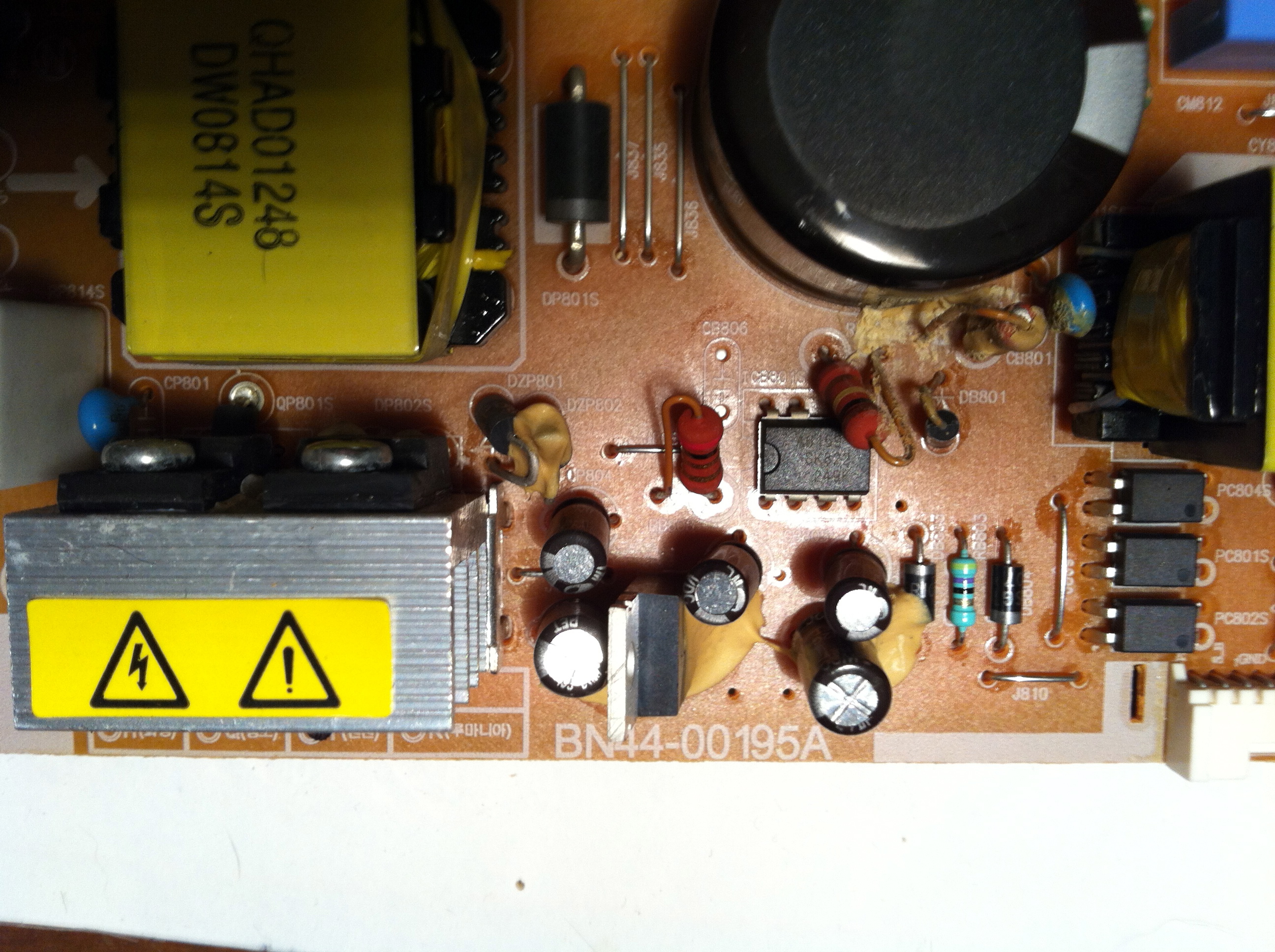

                        My board is different than the one posted here. It is a BN44-00195A. It does not have three resistors. It has a RB808, which resists....It has a CB805 (a capacitor) which may be bad....anyone worked on this newer board?

                          #52
                          Re: Samsung Syncmaster 245BW
                          Hi!
                          I have the BN44-00195A too, and I too am looking for some answers... Can't find anything about that board, and most of all, mine is covered in yellow rosin, I can't even read the value on the capacitors...
                          My screen is behaving a bit differently : it works. And then, it shows a black screen, sometimes just for 1 second, and then it works again. And then, suddenly, it's black for 10 minutes (or more), and then the image comes back. Sometimes it's when I switch it on, sometimes it's after a few hours...
                          The power button is acting exactly like if the screen was working. Blinking when the computer is in sleep mode and the monitor still on, solid blue when it's on (even when the screen is black), and the menus and such are not appearing on the screen when I have the black screen problem.
                          The problem obviously comes from the screen, since I tested the cable on another monitor and it worked perfectly.
                          Right now, I've disassembled the power board, I tested the three resistors that looked a bit like the ones on the 245BW board, the values are correct, I cannot test the capacitors since they are covered in this solid yellow rosin that I can't get off, and I can't find any schematics of the bn44-00195A board, so there's no way I can just remove them all and replace them, since I don't know which goes where.
                          I was thinking about buying a new power board, but I'd like to be sure it is indeed a problem with the power board and not something else... I don't feel too confident putting everything back together (and especially soldering back the resistors I've taken out), but if there's a way I can save money and not order a power board for nothing when the problem is somewhere else, I'd rather do that ^^
                          Thanks a lot

                            #53
                            For us to help you are going to have to put back the resistors!
                            You HAVE to get the yellow glue off - it it going dark? it will becoming conductive and shorting components out. You also need to post pictures of your boards - see signature
                            EDIT Also have you read this thread
                            https://www.badcaps.net/forum/showth...-00195A&page=1

                              #54
                              Ok, resistors are back on. I need to ask my neighbor for some solder because I can't find mine (and it's past midnight here, so it will have to wait until tomorrow). I took a few pictures. I tried to take the rosin off, but it's really, really hard, and I fear it might damage the capacitors.
                              The stuff is yellow, and isn't darker in any place.

                                #55
                                Ok - maybe the glue will soften (but only slightly)with IPA isopropanol alcohol. and perhaps make a plastic pick from a toothbrush handle. It takes a lot of patience.
                                Did you read the thread i linked to as an edit. Maybe removing the glue will be enough
                                "since I tested the cable on another monitor and it worked perfectly." which cable??
                                Is there an inverter board in your monitor - between the power supply and the
                                screen. The symptoms you describe (pic goes black but power remains on may suggest
                                a problem with the inverter board or with the bulbs/wiring. When it goes black does it flicker at all? When it is black with it connected to a pc can you still see an image on
                                the screen - it will be very dark - perhaps try shining a flashlight on it at an angle.

                                  #56
                                  Yeah, I saw it, thanks! Might come in handy if I end up trying to replace the caps on the board.
                                  There is indeed an inverter board. And no, the screen doesn't flicker at all. I can try the flashlight thing, I'll first put everything back (except maybe the back panel, no use putting everything back together to disassemble it right after) and try it.
                                  What I meant by cable was the DVI cable from the computer. I unplugged it from the monitor and tried it on my other monitor when the screen went black. The other screen showed the image. When I put it back on the samsung, it was still black. So the DVI cable isn't the issue.
                                  I hope I can still get it to work now that I messed with the yellow rosin and the resistors...

                                    #57
                                    Ok, good news is, the screen still works. I actually put it back together entirely, right now it's sitting next to me, plugged to my iPad so that I can have a constant image and be ready with my flashlight when the problem occurs. Desk is getting a little crowded right now with the three huge screens and the ipad ^^

                                      #58
                                      Hi!
                                      Sorry for not coming back sooner. I plugged in the iPad in VGA connection, and it worked flawlessly for hours. I was pretty sure either it was fixed, either the problem was with the screen's dvi plug (which I could totally live with).
                                      Today, I plugged the screen in dvi mode to my computer. After about 5 minutes, the screen flickered, and then went dark. I tried the flashlight thing, I can't see an image.
                                      I tried the iPad in VGA mode again, and nothing. Black screen. Blue led is steady, not flashing. I tried changing the source (even though I can't see what I'm doing), but nothing worked.
                                      So now, the screen is black, I left it switched on with the iPad still plugged in and I'm gonna wait to the image to maybe reappear...
                                      Turns out, I actually did good buying a new one last week...
