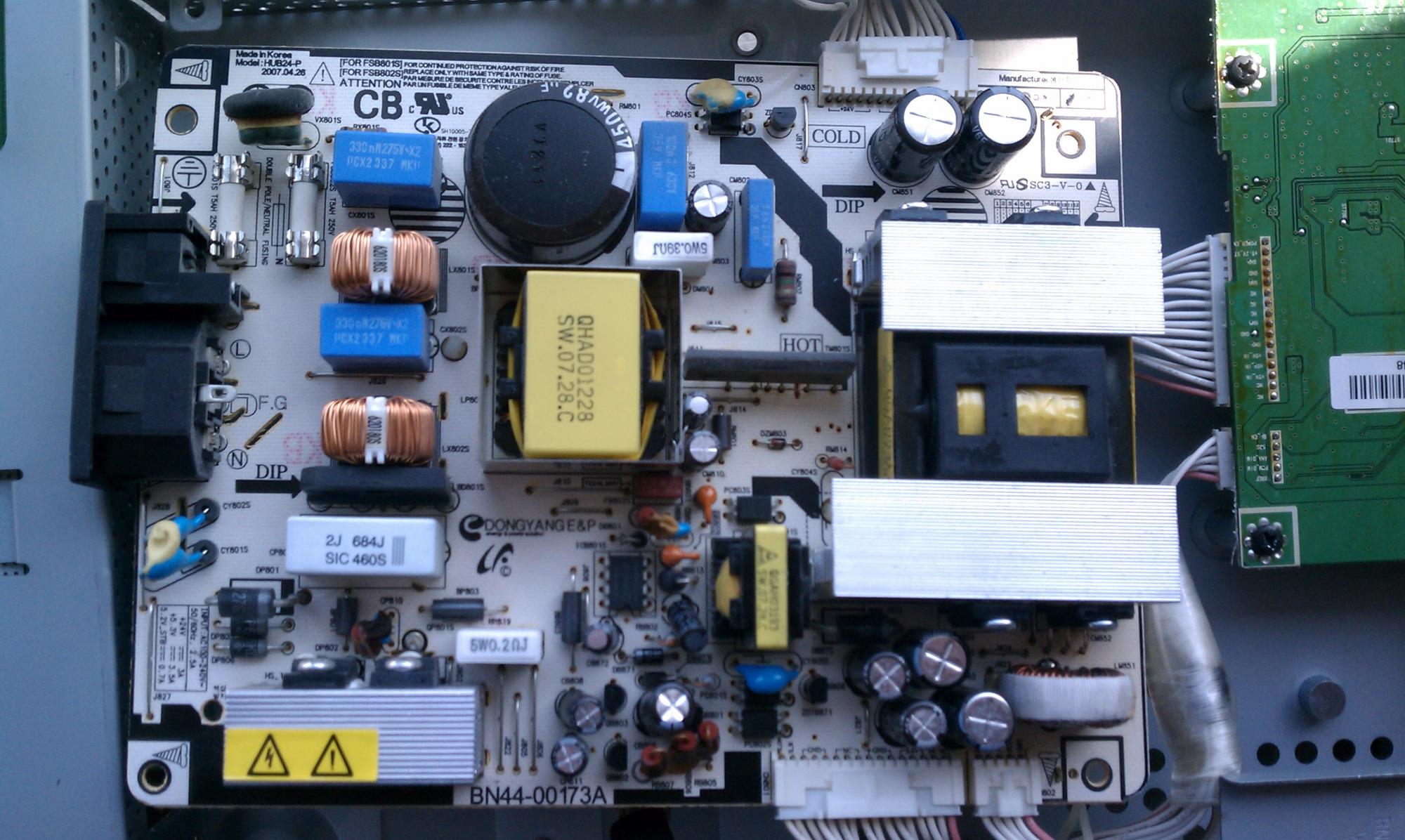

    I have what seems a common problem. I have no picture at all but the power LED lights. The failure was sudden. The monitor worked perfectly then the next time I powered it on, I had no picture. Pushing the menu button has no visible effect. I connected it to a second computer to confirm that it was the monitor and not the PC.
    I assume the inverter has failed but don't know how to test that hypothesis. I have disassembled the monitor and did not see any bulging capacitors.
    Can anyone suggest next steps? I have a multimeter but am inexperienced in its use. If you suggest testing components please explain the testing procedure, e.g. power on/power off, where to place the probes, etc..

          As I mentioned in the original post, the power on LED does turn on when the monitor is turned on.
          You'll see two white fuses side by side in the upper left corner of the front side photo. Unfortunately they aren't transparent and thus can't determine by looking whether they are defective.
          Hopefully the photos are adequate. My digital SLR got doused by a wave and died. These were shot with the 8 megapixel camera on my phone at the highest quality setting.

            A common failure on your model board are resistors RB805, RB806 and RB807 located in the middle at the very bottom of your board. They each should read 68 ohms.

              Good call. 805 reads 400k. The others read 67 or 68.

                Excellent quality pictures. And glad to see you have already identified the problem.

                            Nevermind. After I took the inverter photo, I examined the plug from the power supply to try to figure out which lines to test and noticed the plug slightly askew. I clicked it into place and the monitor works.
                            The resister -- $1.19 for five at Radio Shack -- was the only problem.
